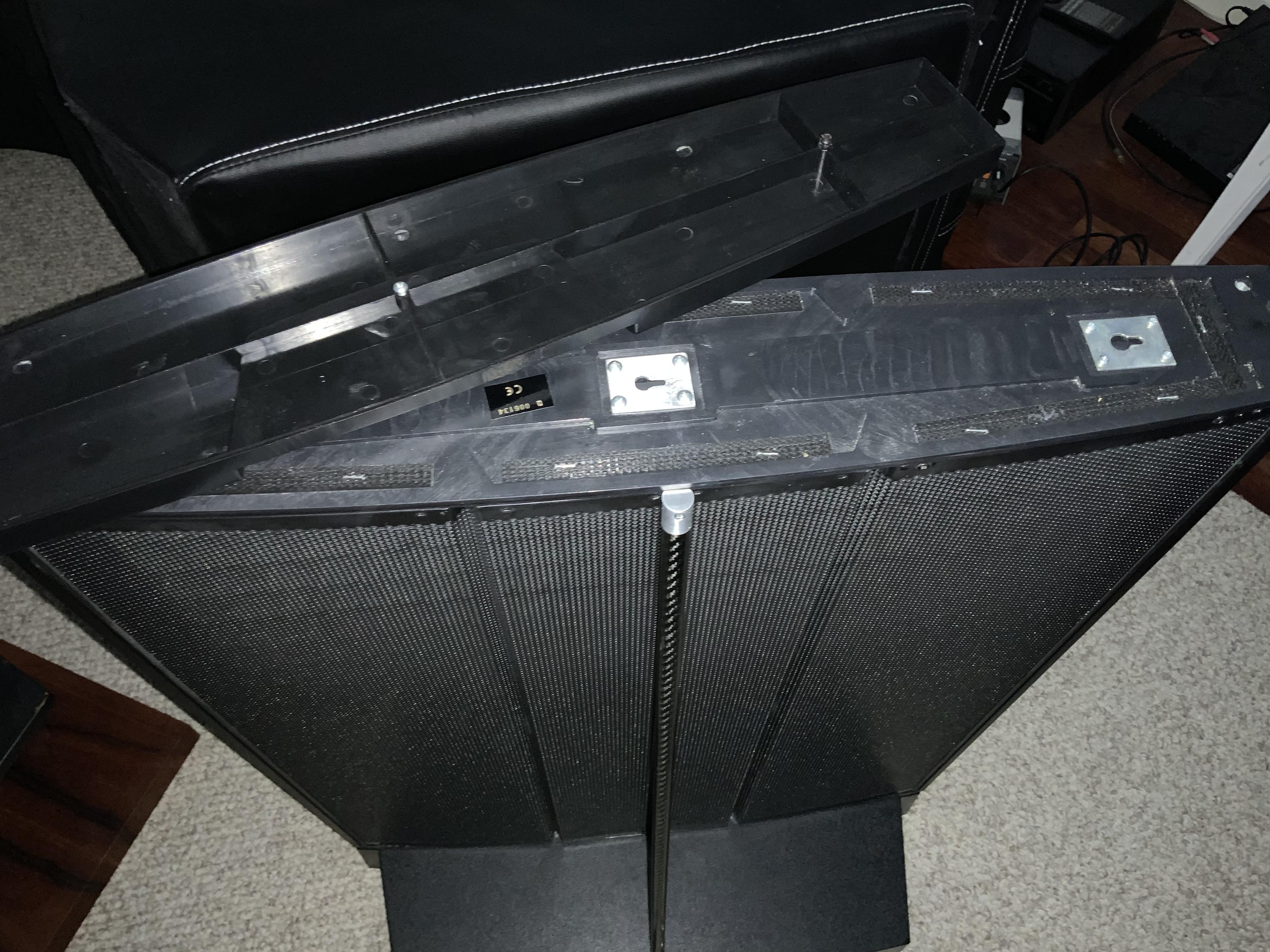

Cloth on ESL 989
Having progressed via 6 or so '57s, NS1000M, B&W P2H, IMF, Kef 105, Klipschorn, JBL 4343, I have now landed on a pair of Quad ESL 989 speakers
To say that the WAF is low is an understatement. Right now I am negotiating on cloth colour and perhaps even respraying the rest as it really looks like the monolith from 2001.
OK....but I am hesitant about damaging these speakers and so far I cannot even see how to remove the cloth!
I am told that you slide the top to the right and off it comes, but mine is black plastic and sits on top like a cap...so it cannot slide.
So, before I take a mallet to it, can anyone advise on how I can, safely, remove the top cap and then proceed to remove the cloth?
I am prepared to go through all of this because these speakers sound just great 🙂

You apply some side pressure and it will slide off.
You will have to go inside the base and loosen the upper section since it’s sandwiched underneath and captured by the bolts.

AVwerk is right, they slide to the side. You don't need a hammer, just the heal of your hand. The bottoms are held in place with 8 nuts. But first you have to unsolder two signal wires to the delay lines, and an under-insulated high voltage wire that goes to the circuit board. You then pull out the antenna wire that slides into the delay line PCB assembly and then you are ready to remove the 8 nuts.
The grille cloth is a hoop of fabric with a seam up the back, it is held to the top and bottom of the panel assembly with velcro unless you have the classic 989's with the tweed like fabric in which case it's stapled to the top and bottom.
I've had a local wood-working shop make new top panels for the 988's and 989's upon customer request. It's amazing how much better that speaker looks without the plastic top and a nice walnut top slid into it's place.

Thanks...that is exactly what I needed to know..so I am encouraged to push the plastic top just that bit harder.
I removed the base on these speakers and found that they had been serviced in August 2014. So far all I have detected as a problem is an intermittent popping sound from one bass unit, with or without an amp connected and after music has been playing for around an hour. Overnight, still powered on, they are totally quiet in the morning, so it is the music signal which activates the popping.
