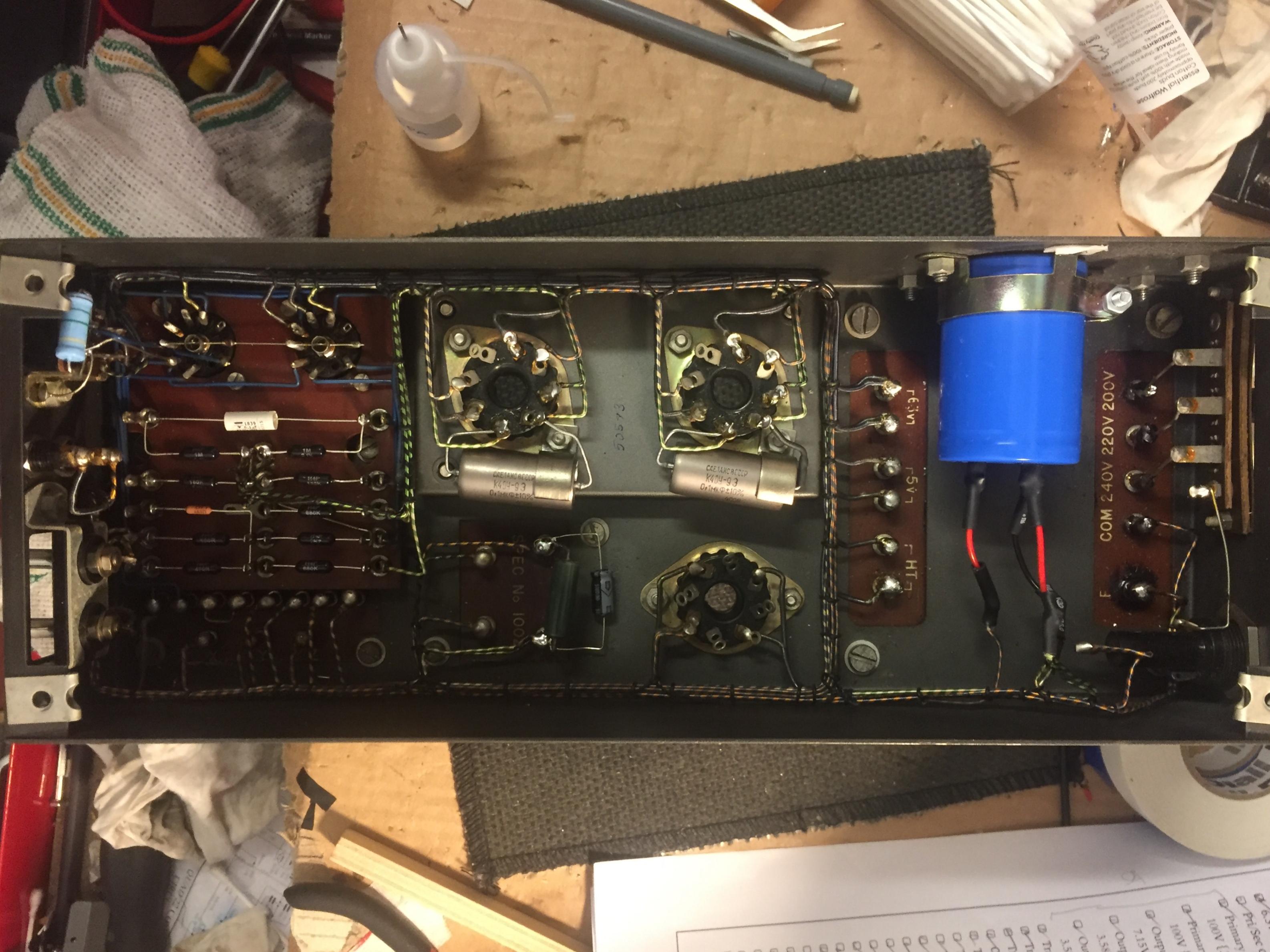

I've gone a bit mental on my par of Quad II's (and 22 preamp). I replaced all the passives as I typically do. But I replaced the very aged filter caps with a PCB and a set of film caps. These amps will now run for another 100 years. I didn't do anything with the IO, and I never cut metal. I left the Jones plugs since I typically run these amps with the companion preamp. I did make a custom set of standoffs for my PCB that are 8-32 on the PCB side and BA4 (british association) on the amp side so I can use the original screws.
Heres a few pics of my madness:

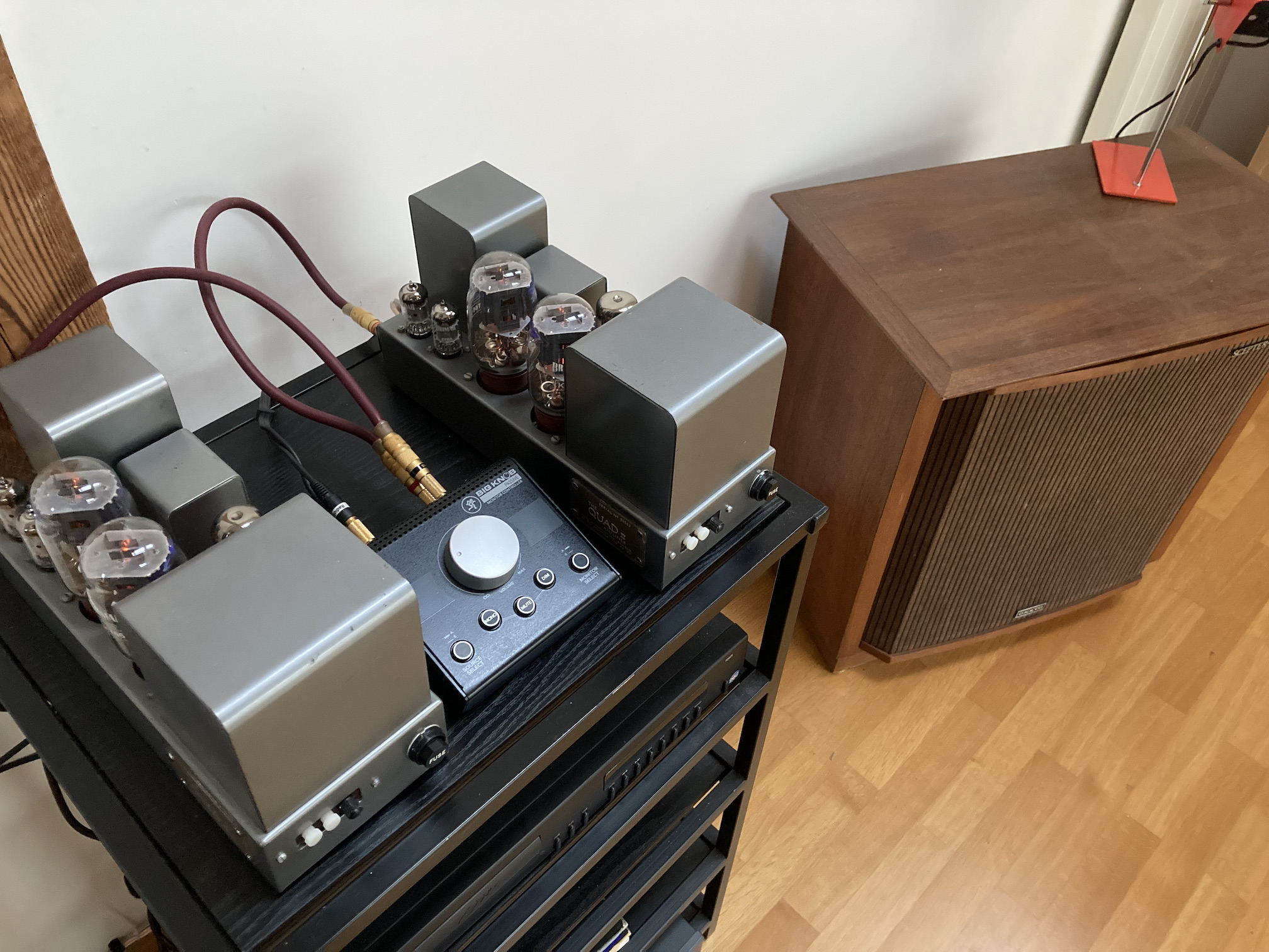

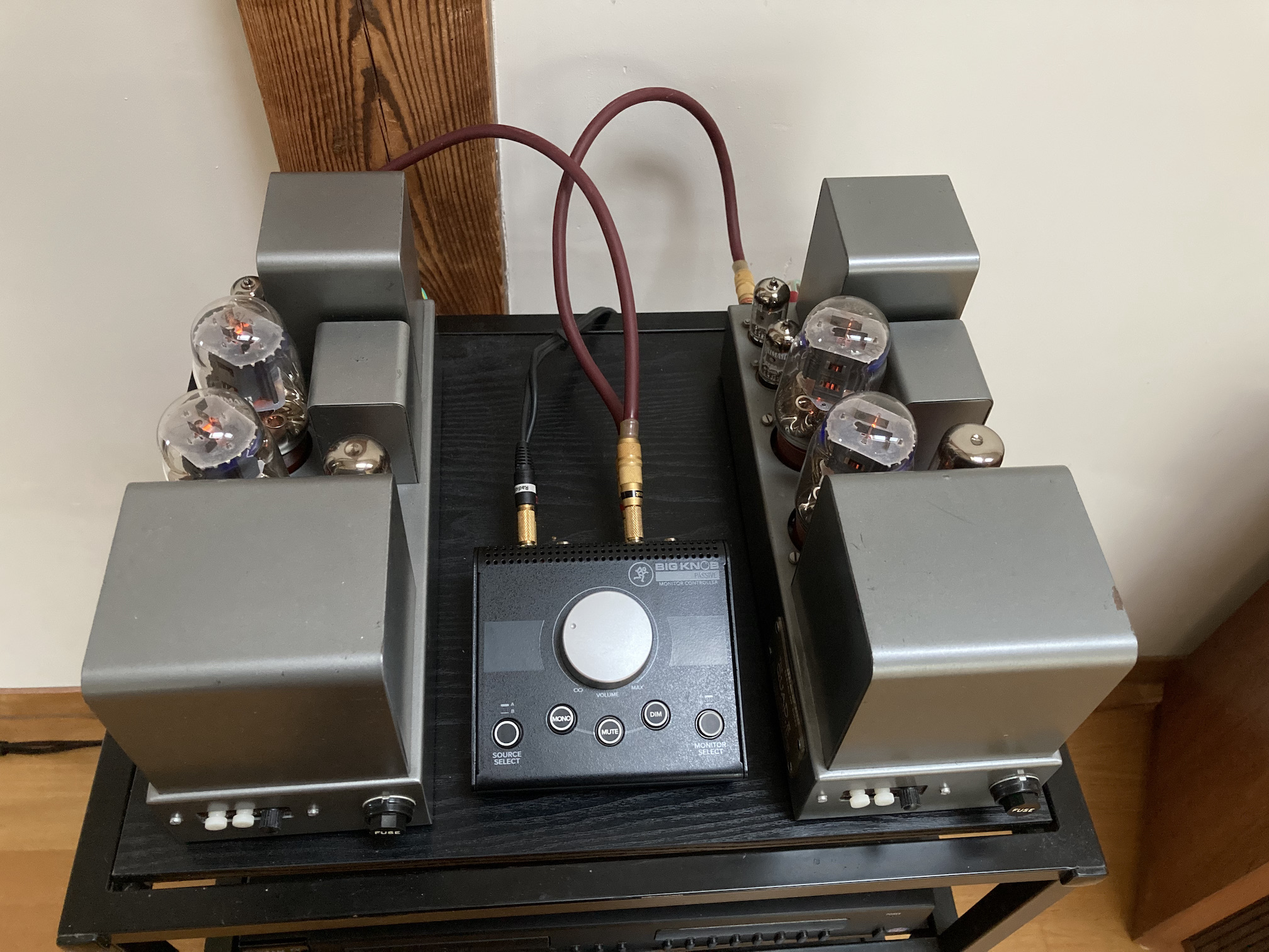

And testing with my rebuilt 22 preamp:
The Quad II's into a rebuilt set of original Quad ESL's and a good high res source shows just how little we have advanced in 60 years in terms of sound quality and musical transparency.

Wondering about main caps.Have spent many years on tranny amps with 10,000uf and higher(Fixing a Musical Fidelity F16😉 that I forgot about small caps.So not sure if 2 x 16uf-22 uf polyprops would be better than say my fav lytics(Mundorf) 16uf x 2 Mylitics HV
I think you can change the sonic character in bad ways by using good parts. My goal in restoring mine was to use good quality parts, but nothing that quad wouldn’t have used if they had had them available at the time. That was how I felt I was being true to the original sound, but giving the amps another 30 years.
You can put exotic parts in it, but the bits that matter most - the transformers, tubes, and circuit - remain the same. So I’m not really sure what you would gain?
For what it’s worth, here’s the inside of one of mine after I finished it. My one exception to the “exotic parts” statement was the Russian coupling caps I found at a vintage audio sale and thought I would use. The big filter cap is F&T.

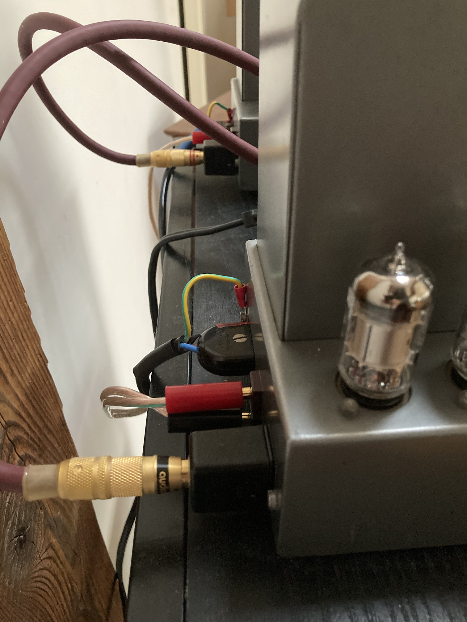

Thanks for putting up the pics Ahankinson.It never occurred to me to just use the bulgin 2 pin plugs with 3 core wire and tag the earth to the chassis.Now there is no reason to cut the chassis at all.Do you turn them on and off via the mains socket switch?
Yes, I have a little two-socket switched power plug that goes directly into my power-bar. One switch turns them both on.
