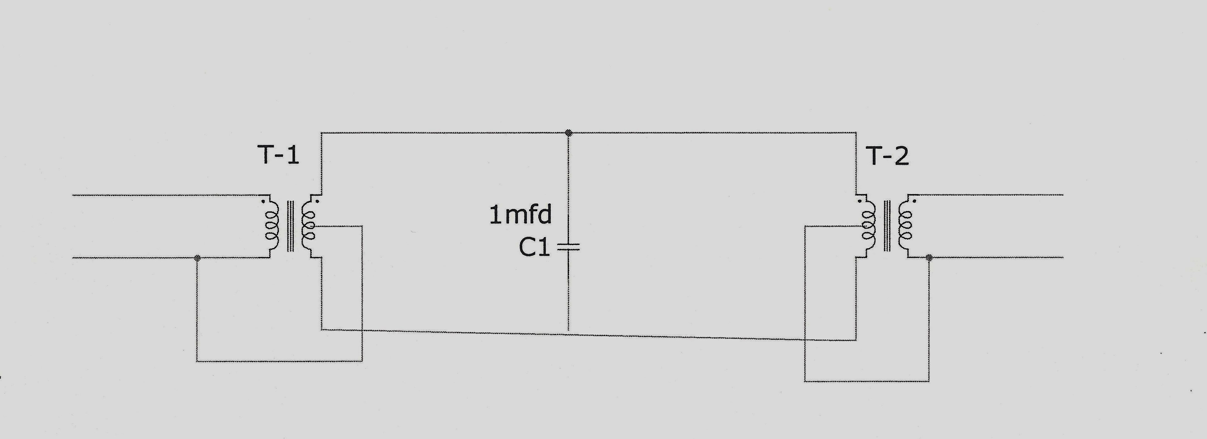

Now I checked (the transformers) and they are Amron P287's 220Vin 2 time 20-24-30V 2.5A. I could connect the secondary's in series, lets say 60V from the input transformer and 54V on the output transformer. Between the 60-54 connection an common mode filter could be added. Would that be worth a try?

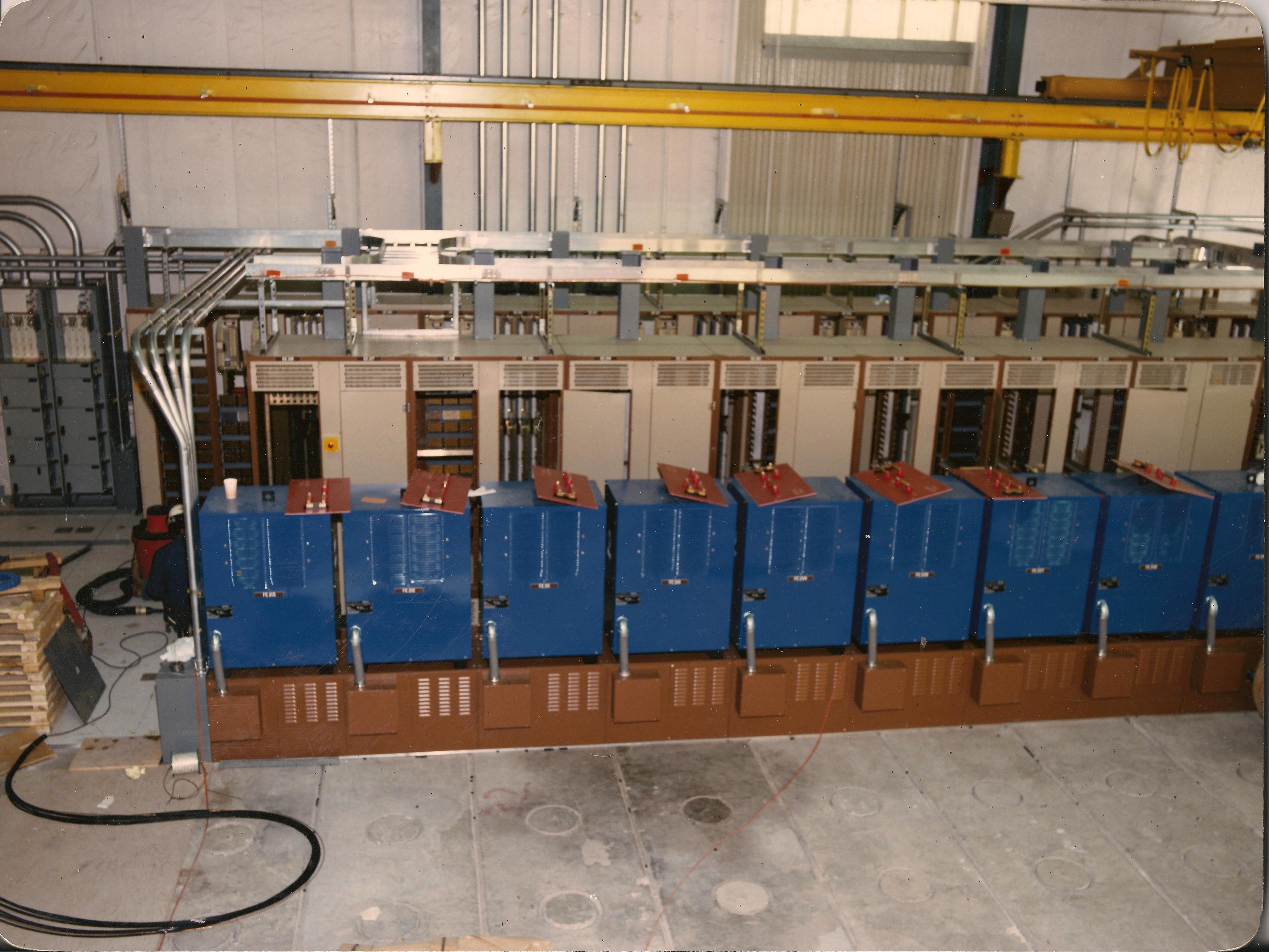

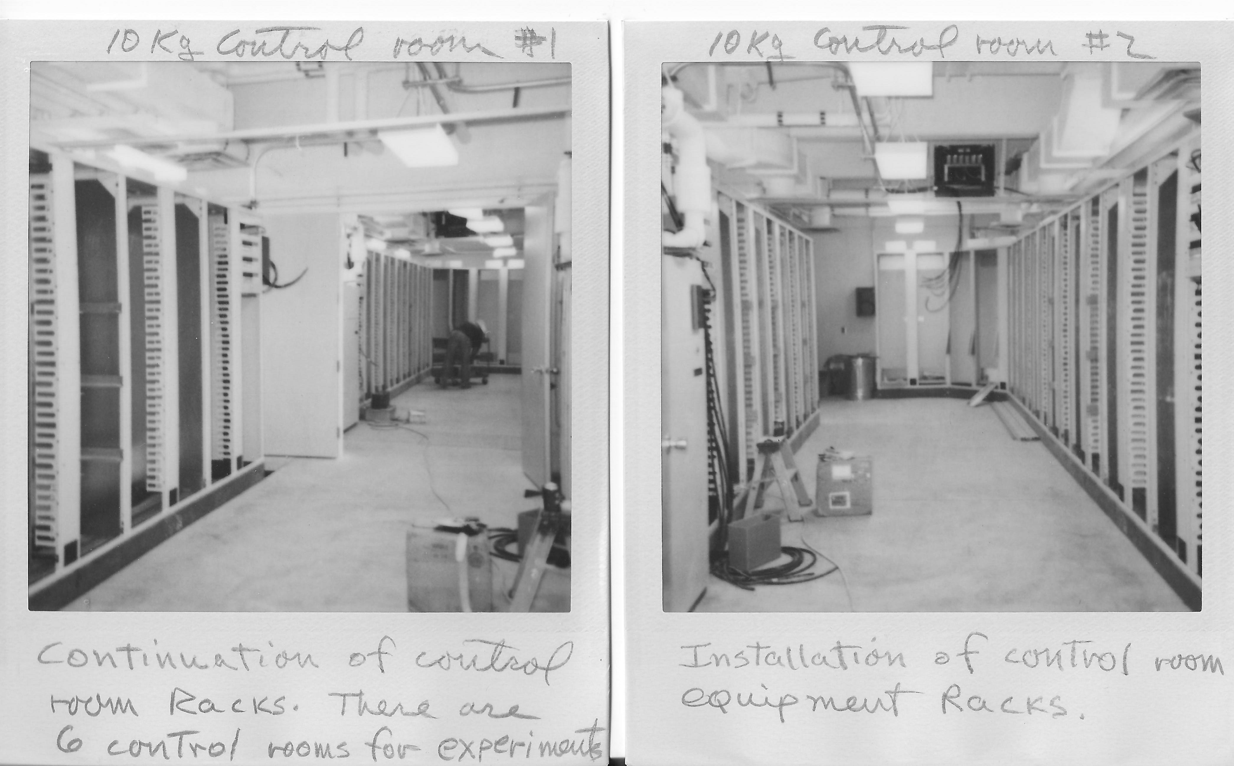

I did have responsibility for several major projects which had massive potential for ground problems. The equipment in the Operations/Control console, multiple high speed number crunching computer room, high power supplies, diagnostics/measurment equipment, etc. And, it better work right when you are done --- or You are done. Take a look at the left-right isle of equipment racks to be filled from floor to ceiling with electronics... thats a 10KW ultra-isolation transformer hanging from the ceiling to power the racks. Computer grounding, power grounding, signal and control routing, grounding, shielding. Shielded cables/routing/grounding/isolation. Those row of power supplies are high power Arc welding supplies pressed into service for the experimental machine. You had to design several grounding systems and shielding etc.

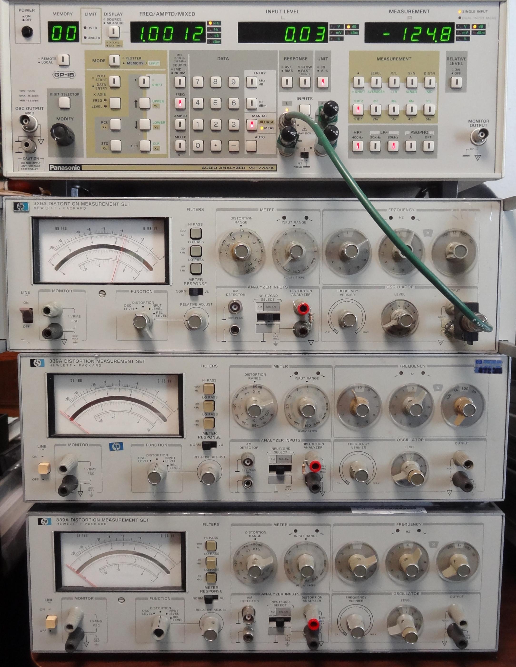

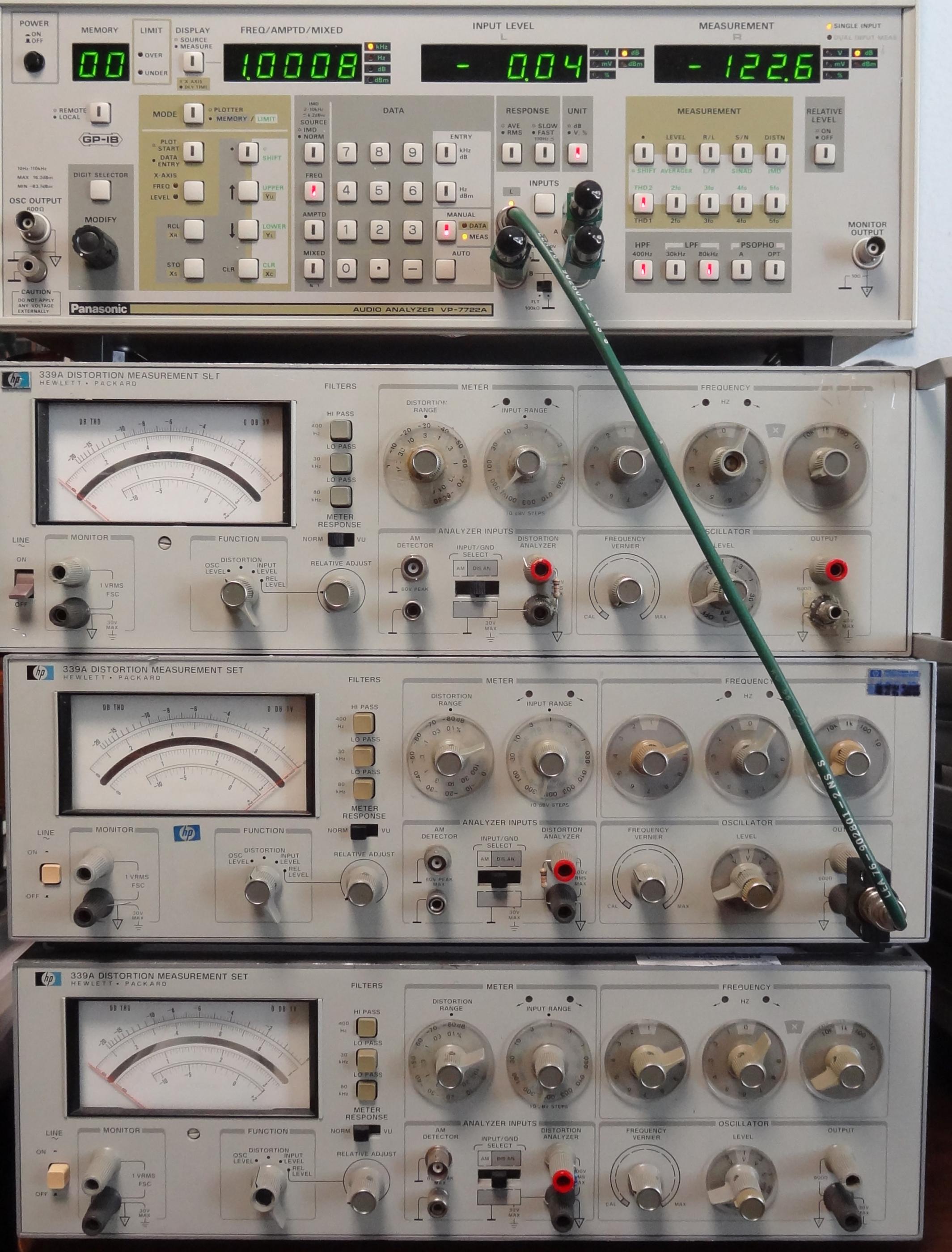

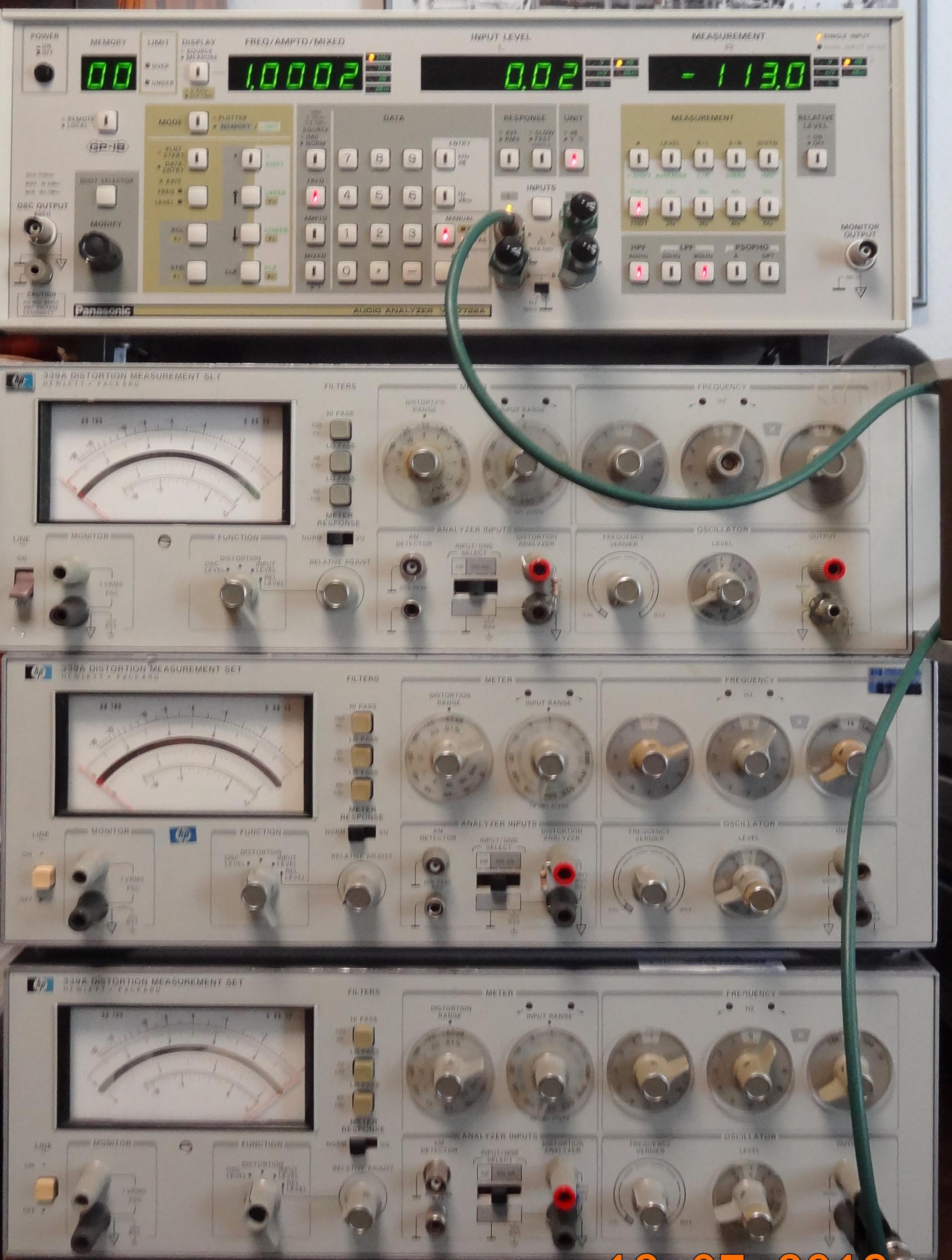

Three levels of changes to the 339A oscillators. Level one is replace most everything and get an average of what is shown for THD is -125dB. The last one has only has the oscillator opamp and driver/buffer opamp and a cap and trimmer R. All else stock. The middle osc had a few more opamps/capacitor changes and the analyzer section had opamps and parts changed.
If you just want an oscillator with a minimum of changes, it gets you over -110dB. The design has its limitations.

You could use the transformers back-2-back but the output 220V will be (significantly) lower I'm afraid.

The common mode and other filter parts are ordered and I will report on my progress with this test (most probably after the next weekend). The transformers will be coupled: line 220-in 60-out common-mode-filter 60-in 220-out to the scope. The output voltage will be lower than 220V but that is no problem, the scope, a Tek 2252, is specified for 90-250Vac 150VA 100Watt, and the transformers are 60V 2.5A (that is 150VA).

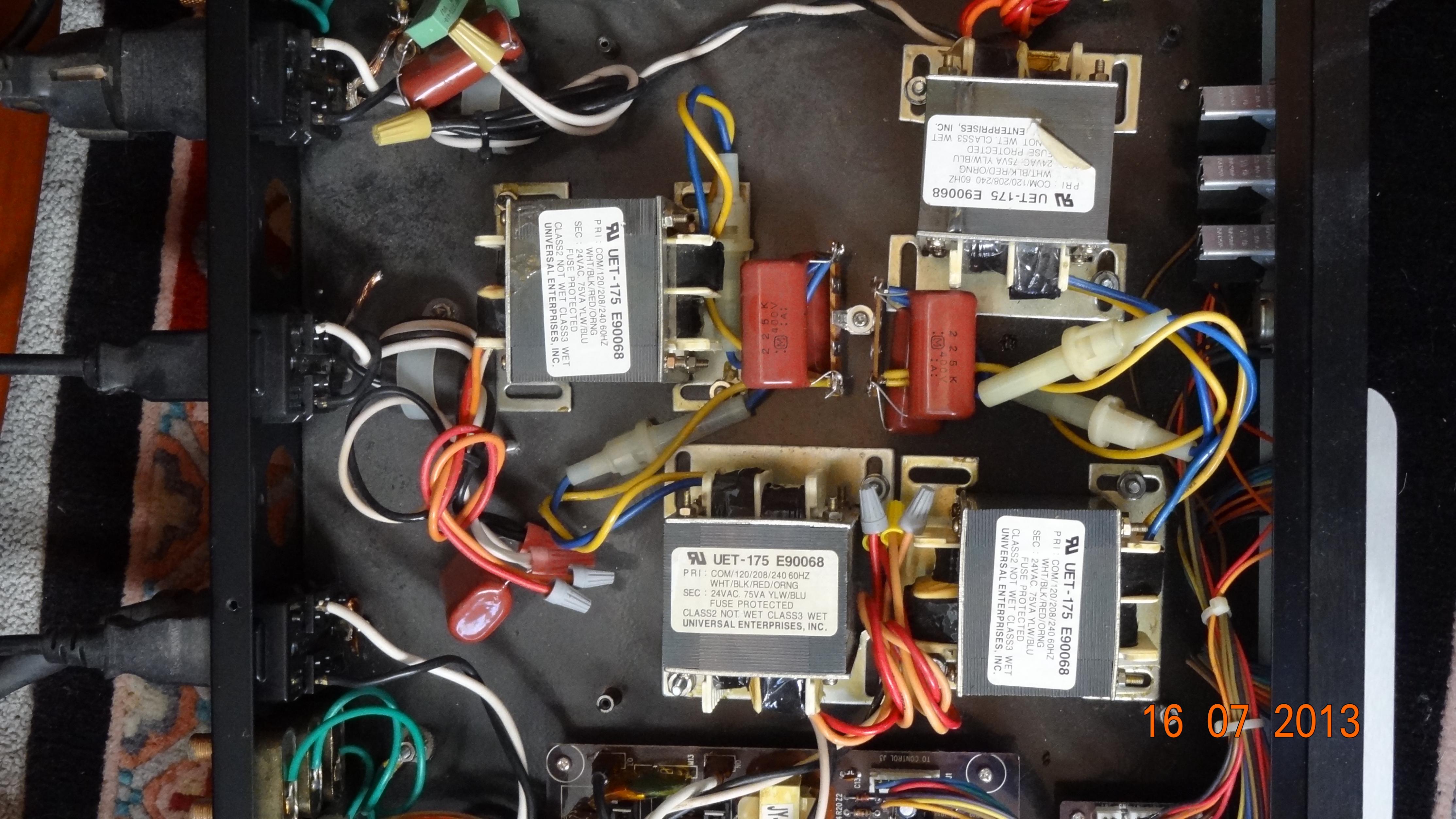

I have filters on the input and output. The primary benefit to going low voltage step-down/up is to have a filter that can be in between the back-to-back secondaries and use low voltage parts. Here I am using 4 mfd of film between the xfnr's. Your values can vary depending on the transformers used (L).
Shown is the unit I made... gutted a commercial ac line filter -- using its protection circuitry and other features and placed two such Isolation-Filters in it. One for the DAC and one for the source. The whole thing has been in continuous operation for at least 10 years. I power my super Iso-Filters, as I call them, with a super line regulator {Mfr by ELGAR].

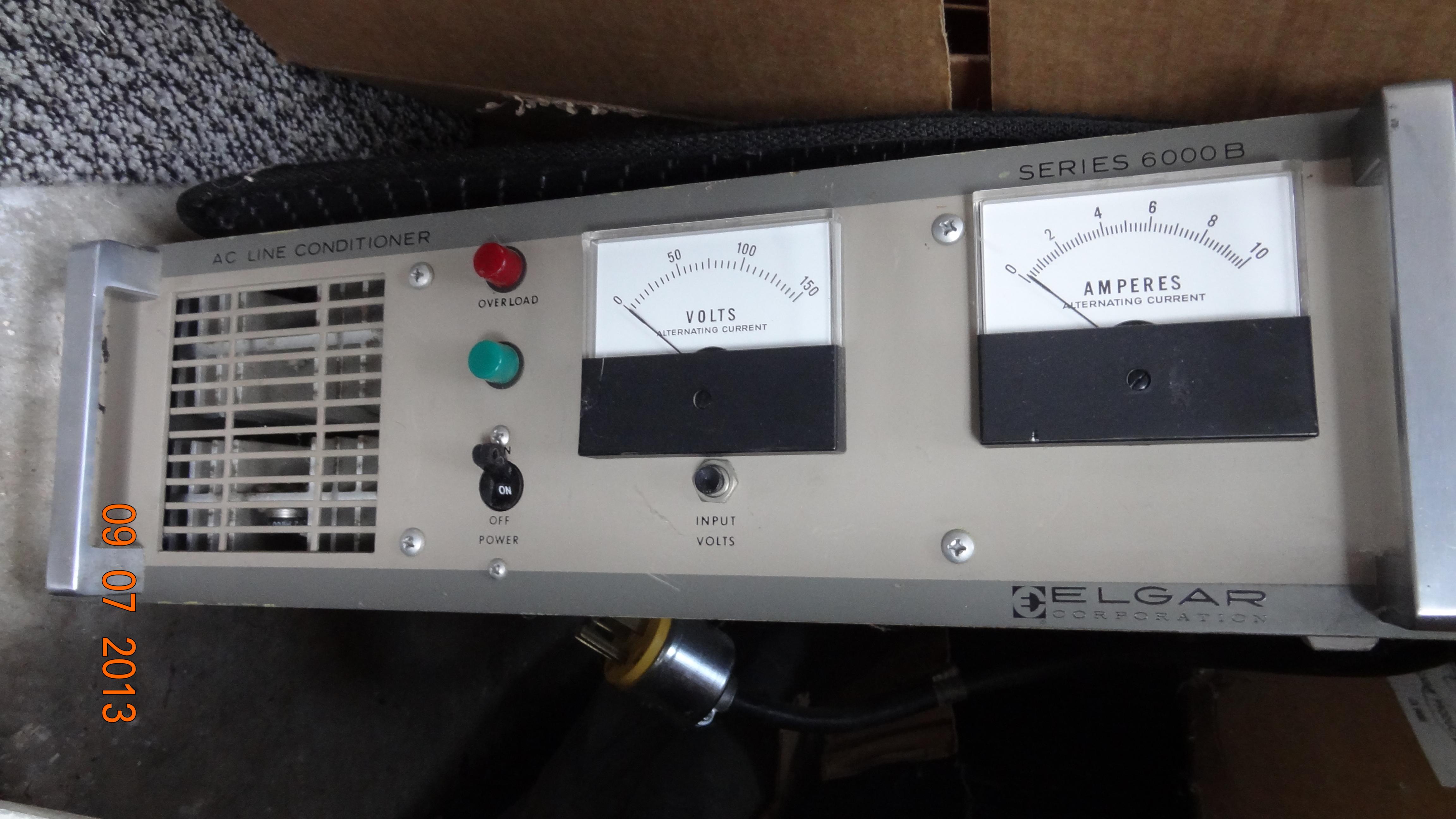

Source for Isolation-Filters:
![ELGAR (1).jpg ELGAR (1).jpg](https://www.diyaudio.com/community/data/attachments/323/323948-5c900f40ef63bf2efcb30aec2fd68b29.jpg)

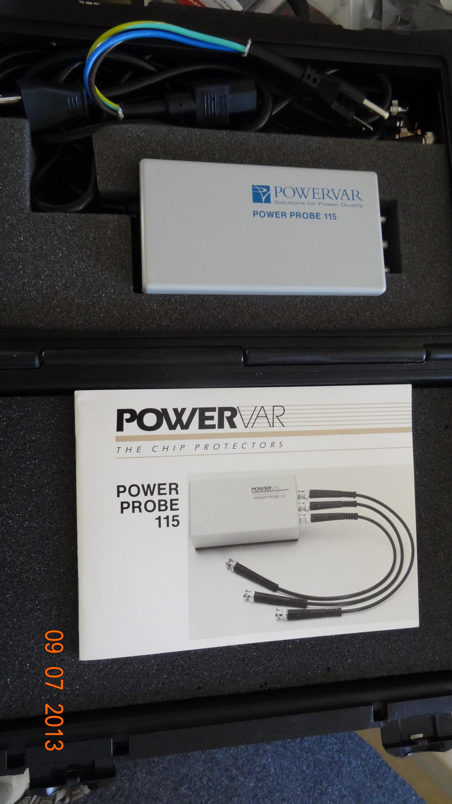

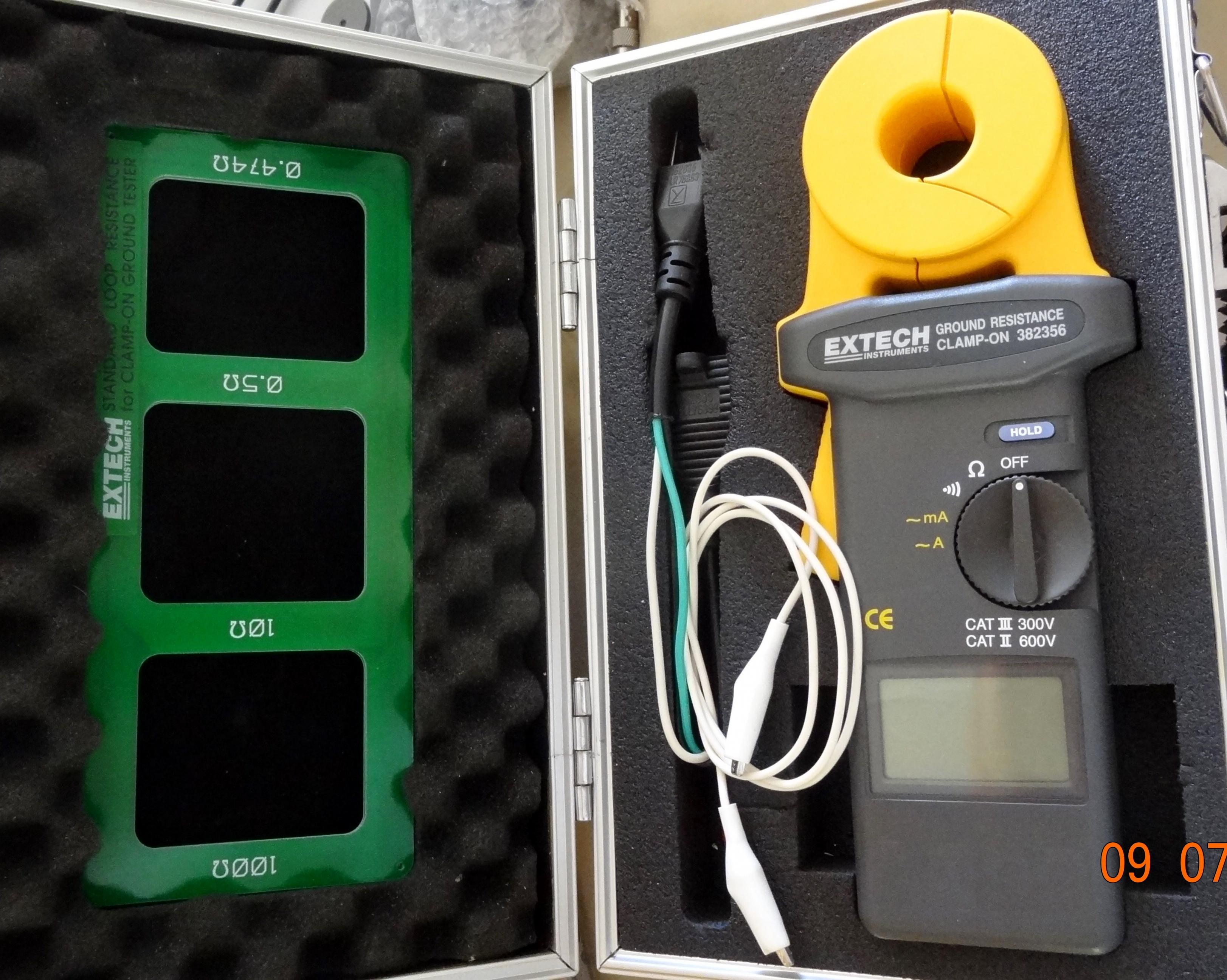

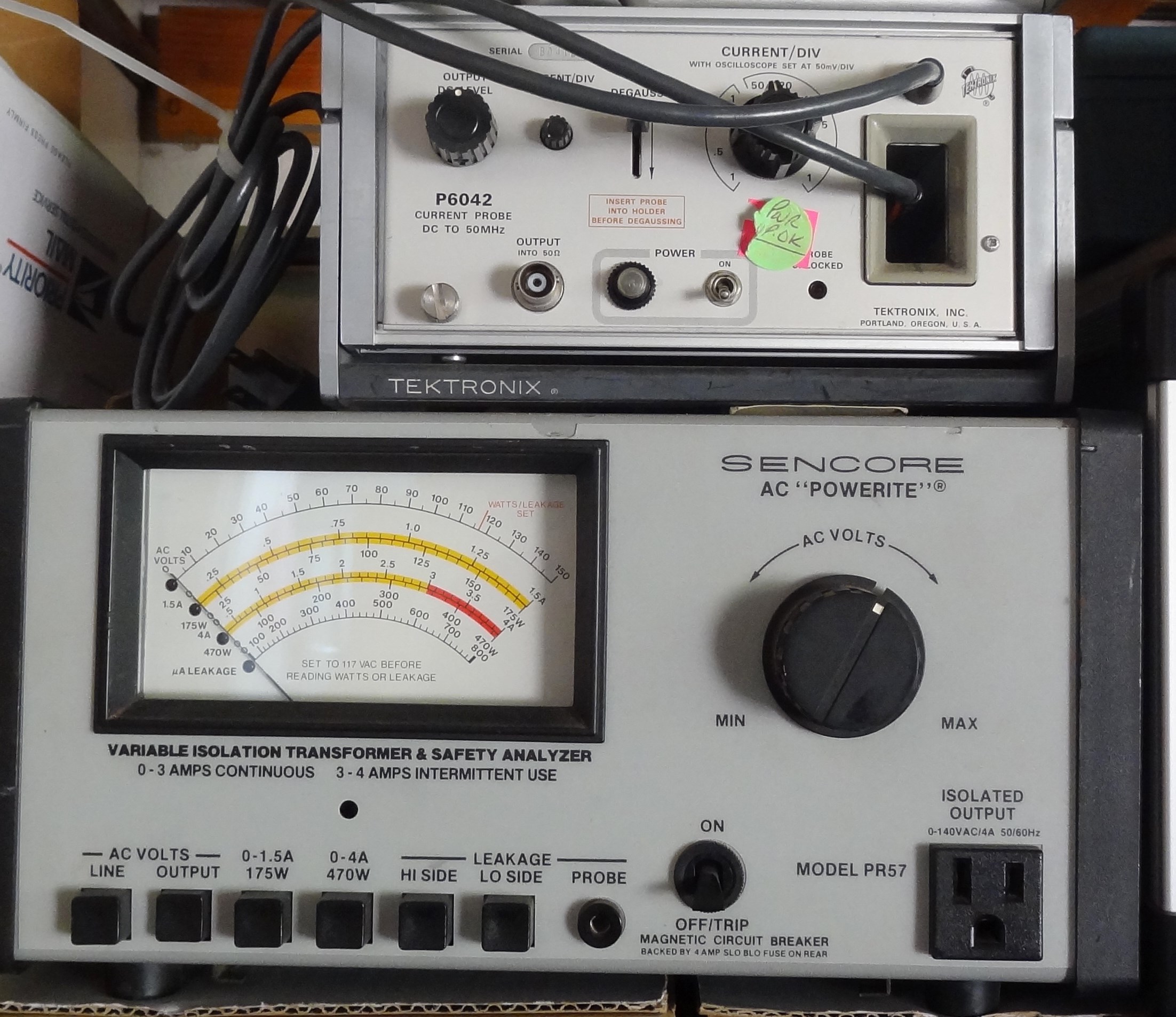

For those who really want to get deep into it, you will eventually need a network analyzer, and a spectrum analyzer. Plus: some HV probes and at least some idea of what your ground is actually doing, regarding leakage current to ground, Z of earth and Z of ground paths and types of noise (CM or DM etc). Such as:
