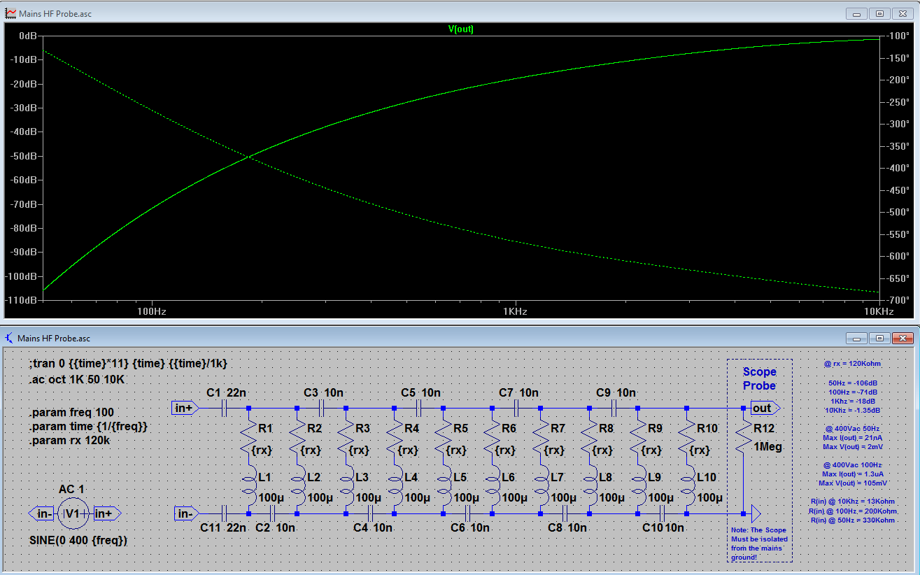

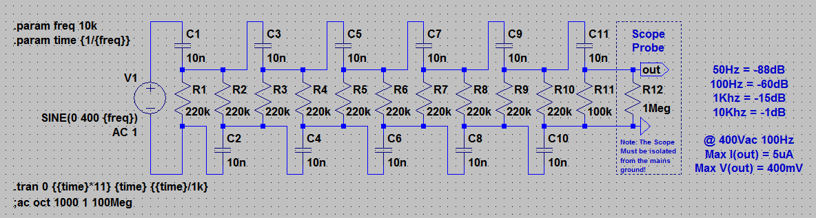

interesting read here http://www.raylectronics.nl/pdfs/Balanced_thinking.pdf
and a schematic here: http://www.raylectronics.nl/pdfs/Balanced_filter.pdf
on balanced mains filters (240V)
The schematic has a typo or error.
It labels the output as 'L' & 'N'. Yet the circuit does not have a Neutral.
The circuit output does not have a 'Grounded (current carrying) Conductor' aka 'Neutral'.
It should be:
L1
PE
L2
On second thought:
There may be more labeling problems than that.
Let me think some more.

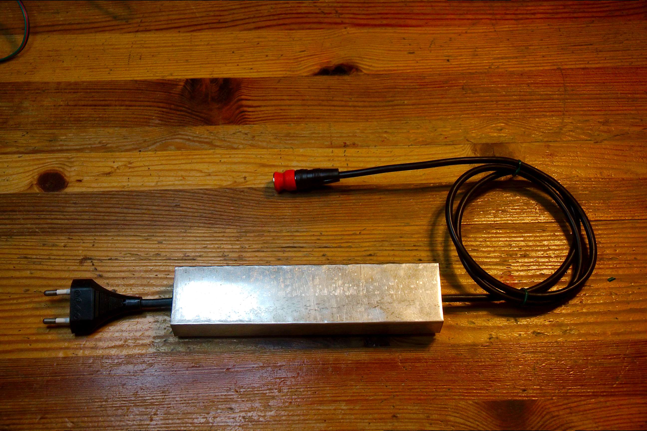

Be careful of the common BNC ground on the secondary of the PowerVAR BCN connector and make sure it doesnt connect to the input side AC ground thru leakage or direct but inadvertant connnection; Your scope or meter connected to the monitor output(s) must still float and not get connected back to the input ground.
It should be:
L1
PE
L2
On second thought:
Kevin,
In my part of the world it is common to use the labels L and N for what you call L1 and L2. (Might even be an EU directive, not sure).
So it's not a typo, and in any case, your linked circuits are clear to what's what.
jan

Very nice work. Be careful, the scope chassis will be at 1/2 the line voltage (120V) and has low enough impedance to give quite the jolt. I would strongly recommend a transformer coupled output before you are finished with this.
The circuit looks kind of like a Kelvin Varley divider for AC.
