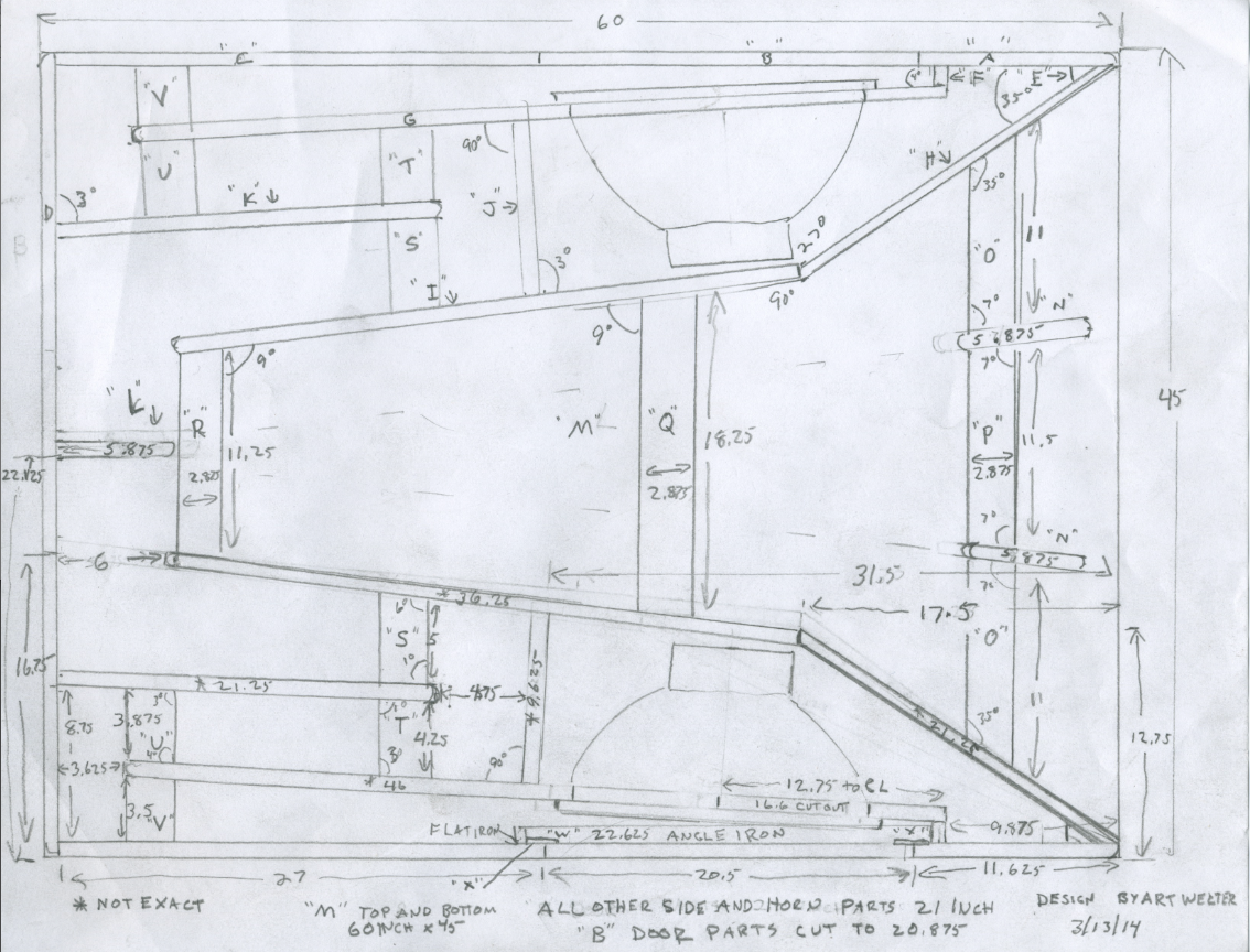

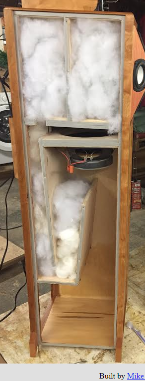

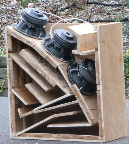

One thing I don't understand yet is why the different positions of the back of the driver being exposed to the path of the TL like as seen in these pics with some deep inside, while others are near the mouth.
But I do realize now that in general a TL is any enclosure with a significantly long port or perhaps even sealed dimension.
It's because you posted the wrong examples, as those are all horns.
The long one has a resonator chamber, the fluffy white sound absorber and the slits right at the sides of the throat seems to indicate that.
So you don't have the so-called direct radiation but ...
Ahhh, that's because you posted in the subwoofer sub-foeum!
View attachment 1476965 View attachment 1476966
None of those are really TL designs. The last one is a tapped-horn, which is similar to, but not the same as, a TL. The others, I'm not really sure what they are.
