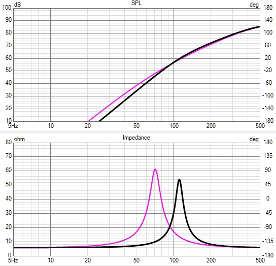

More related to using midrange drivers with higher Qts.
Monotoks example was using a low Qts driver around .3 so it is rather friendly to small boxes.
The actual response from a .5 to 1 Qtc didnt exhibit a huge peak in the lower response.
Modeling a higher Qts driver from .4 to .6
Going from .5 Qtc enclosure to a 1 Qtc enclosure.
The resulting peaks that result will be rather obvious or at least more obvious with .5 to .6 Qts driver
Shouldn't be to difficult at that point to decide that lower Qtc or larger enclosures are required for high Qts midranges.
Rather simple, real world there is a peak in the lowend response. Showing non ideal overdamped enclosure at low frequency.
