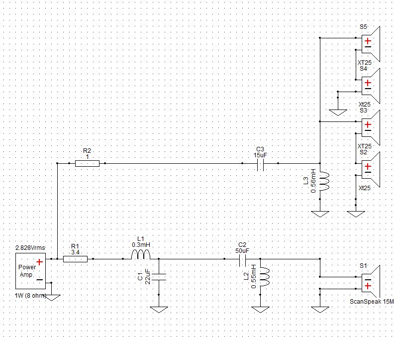

Its a second order design, with the LP portion being a 0.3mH Air-core in series and a 22uF shunt to ground. The air-core is a Jantzen 20awg and the 22uF is a Aerovox Polypropylene 400v. I have used /heard that cap before and it does not sound bad, but in combination with the inductor, its ringing like a doorbell.
(The HP filter is a 50uF cap in series with a 0.55mH air-core shunted to ground. This 0.55mH is 14awg)

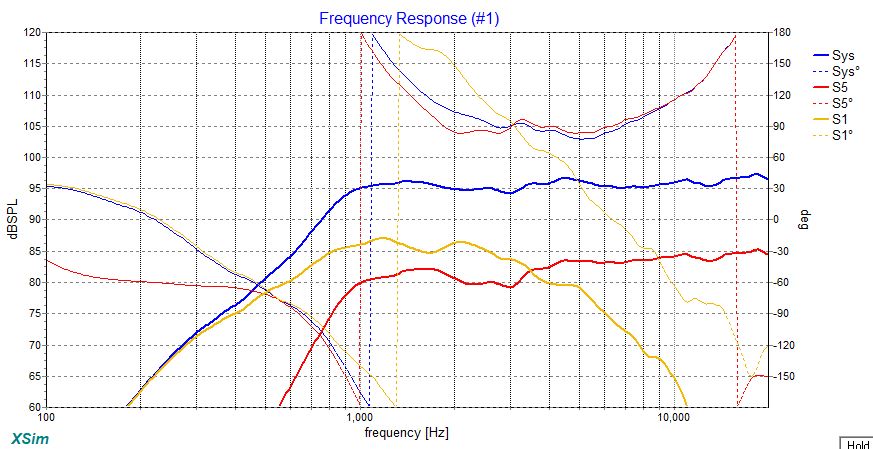

Here you go. The schematic and the FR with phase.

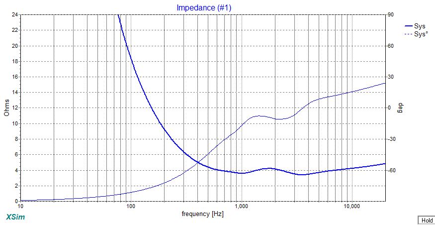

and the impedance is close to 4ohms at the lower end, just dipping slightly.

Schematic below. The Mid is 4 ohms as are all 4 tweeters. but given the series parallel connection of the tweeter, they represent a 4 ohm load overall as well.

You will get easier help if you upload the whole XSim file. There has been a provision made recently to allow directly attaching such a file extension.
It is not accepting the frd and zma files but allowed the dxo file (attached)
ok so what are those resistor values in the schematic u posted
1 ohm in series with tweeters.
3.4 ohm in series with the mid.
The values are there on the schematic posted on post #8.

ok so u have a 90 db mid thats reduced to about 87 db with resistor, mated to a tweeter array with somewhere between 93 and 96 db sensitivity.
serious shrill
to test theory quickly u could increase resistor to tweeters to about 8-10 ohms
this just to test by ear if sensitivity mismatch is at least most of issue. It looks like there may be other issues with crossover values and your resistor at amp output, but the tweeter resistor test is simple easy and can tell u in a min if on right track
BTW take that tweeter cross upto about 1.5k and u may blow less tweeter with little if any negative in sound. Might even be better

The shrill I hear is from the mid. I have not even assembled the tweeter crossover yet. As soon as I remove the mid crossover, the shrill is gone. It sounds clean and open. So the issue is with the mid crossover.. or one component, since the simulation looks fine to my untrained eye.
Even after I do connect the tweeters, with 2 of them being in series, that's 1/2 voltage or 1/4th the power into each, or -6db. with 2 sets, it gets me an additional 3db, which is about par for the 15M which is rated at 92.5db 2.83v

Which SS 15 driver exactly? But in general, the xo values for its' bandpass look like the resulting curve is most likely an inverted "V" - very peaky and narrow.
Discovery 15M /4624G00 (5.25" Midrange @ 4ohms)
well that low pass inductor on mid looks way too small for 800 hz cross
as far as sensativity goes, I see 15M rated at around 90 db. The tweeter is 90 too, however two in series will give 90 also BUT 2 in series and then in parallel with two more in series gives a 6 db boost
The 15M shows a sharp rise in output above about 1khz. If that lowpass inductor on mid is too small your going to sound way bright. This may seem strange as it sound ok w/o cross, BUT sometimes sharp level changes in FR at crossover can sound especially bad with the crossover but almost ok with the driver run full range

My theory is borne out by the frequency response I posted above in Post #8 which looks very flat to me from 1k onwards where the mids and tweeters would take over from.

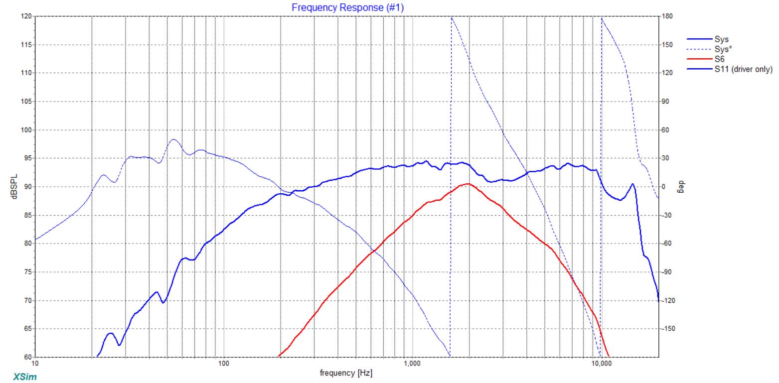

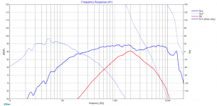

This is a simulation of a 15M only on a baffle (blue) and filtered with a bandpass filter of yours, the 3.4R padding resistor included. I did my own frd and zma. Is 900 Hz where you want your woofer crossed, and 3.3 kHz for the tweeter?
