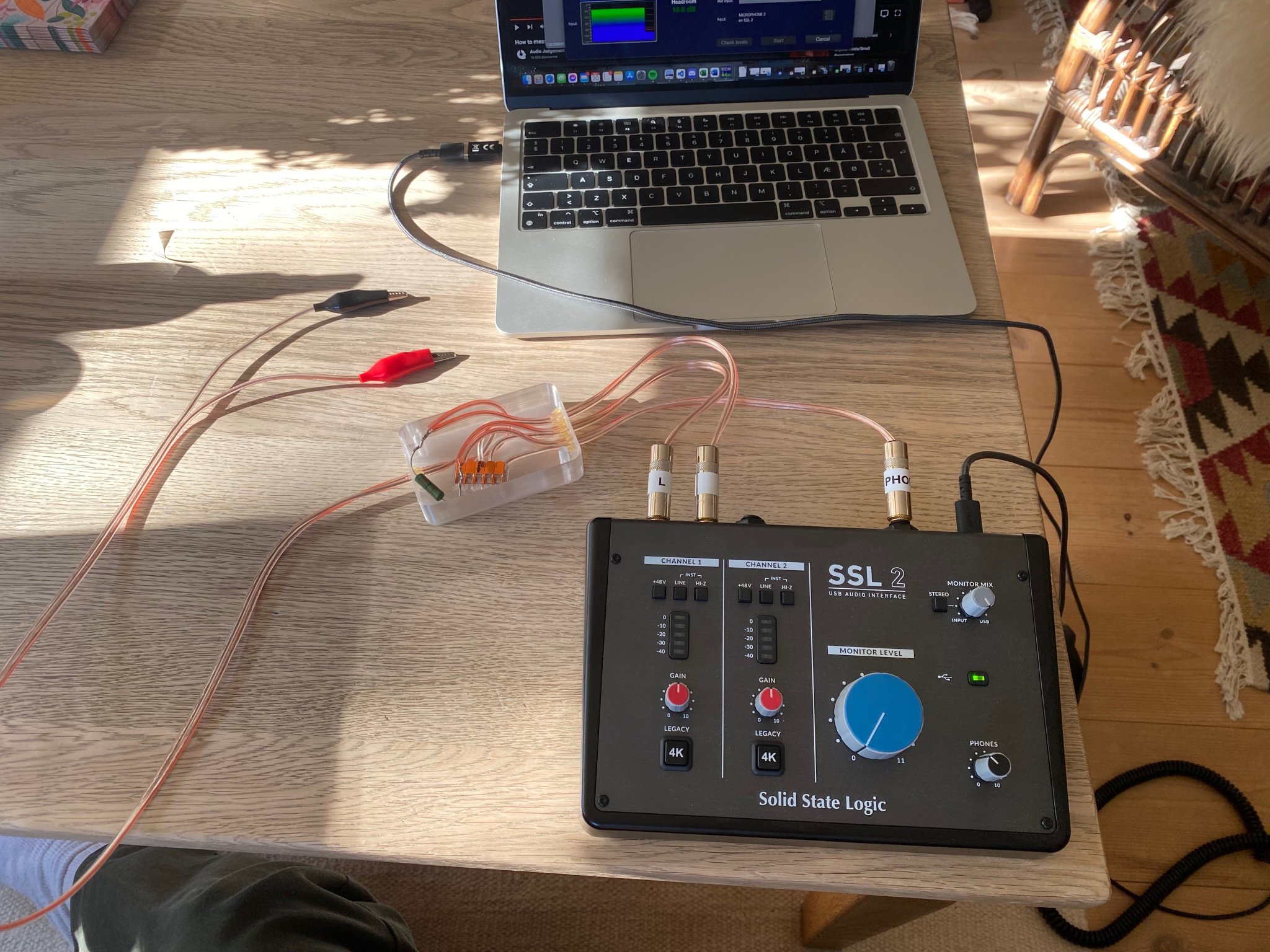

So today I put together an impedance testing rig for REW. I am pretty certain that I have put it together correctly according to the schematic REW supplies, but when I try to do the open circuit calibration I get the error that can be seen in the attached screenshot.
I have everything set as can be seen on the other picture, both inputs set to the exact same 12'o clock position and the headphone output set to give me about 20dB of headroom.
A thing that is confusing me is that it says "If the input channels have individual gain controls they need to be the same.", but the measurement input is passing through an 82ohm resistor that the reference input is not, so doesn't it make complete sense the the level on the measuring input will be lower? Can anyone explain this for me?
