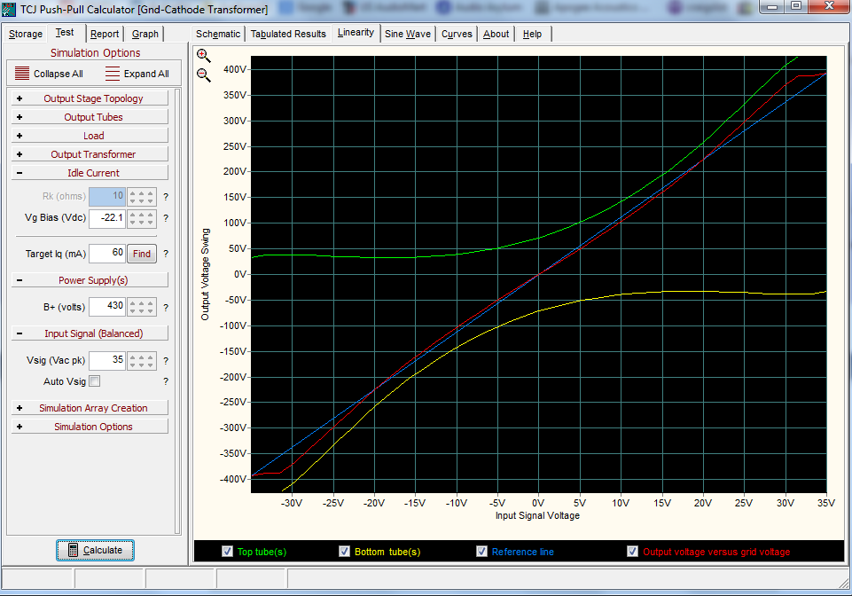

I finished this amp a while back and used a NOS set of KT120s from Tung Sol. Sounded good. Got better after time. I had 420v on plates and 60ma per tube. 12AX7 into a 12BH7. grid resistors are 47k and left the .22uf caps (still need to raise these to .47uf with 47k grid resistors)....I used the KT120s after I initially had an 8417 flash/die on initial bias up. These 8417 were just too expensive to lose.
Last night I was feeling a little bold and decided to try the 8417 again (I have a stash of 10 now). they dialed up to 60ma each fine and I monitored the bias for another runaway event. Plate voltage is 430v. Everything appeared stable. I set up a listen and it sounds great. It sounds very clear and detailed. I think I may like it better than the KT120s.
I am running them at 74% of max plate dissipation. I also ran PP TubeCAD PP calculator and the curves look very good at this operating point.
The thing that worries me if turning my back on the amp and having it go into another bias runaway. Never had to worry about this with the KT120s....

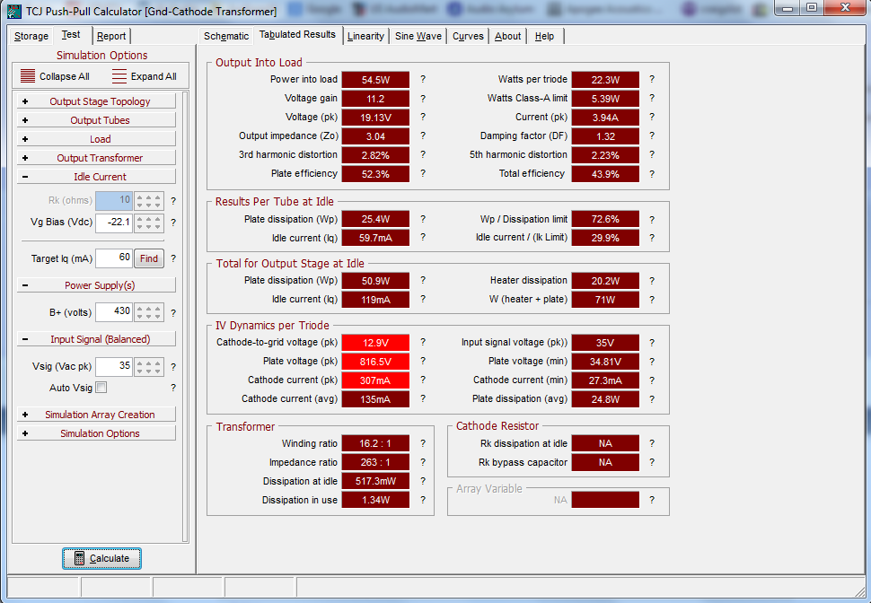

From PP Calculator, with 430 B+, 60ma each tube, and 4200 output tranny, I am getting 55wpc with 4 ohm speakers with the 8417...I am using them on Acoustat 2+2. Sound great, even better than the Tung Sol KT120s.
The 8417 has 35w max plate dissipation, and a max plate voltage of 660V.
Yes, I could do 550V and 50ma each tube for a Class AB1, but my PS caps are rated for 450v...and according to the calculator, the curves look best at my operating point of 430v, 60ma.

I need +/-30v to do the full 54 wpc on the 8417, while I plug in the KT100, and the same 430v B+, 60 ma per tube and the +/-30v swing gets me only 20 wpc...meaning the 8417 is really easy to drive and remain linear. It takes upwards of +/-50v to do the same 55 wpc with KT100.
So maybe a 6922/6DJ8 or 12AU7 with less gain than the 12AX7 would be more than enough to drive the 8417. I have 12AU7, and 12AT7 I could try...
