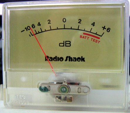

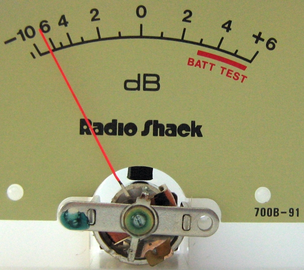

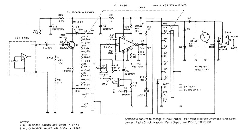

I have a Radio Shack (Realistic) 33-2050 sound level meter that is on the blink and it looks like something is wrong with the analog meter itself. The schematic on Eric's site is a bit hard to read (http://mysite.verizon.net/tammie_eric/audio/rsmeter/33-2050/rs_spla.gif), but it looks like the meter is rated for 135 uA and 2k ohm. This one measures in the megaohms and putting a 9V battery across it (9.22V) only provides about 15% movement on the needle.
The only markings on the meter are TEC M-700B. The card inside is printed 700B-91 (assuming that means 1991).

I found a slightly more readable schematic that was uploaded by Salas in an old thread.
http://www.diyaudio.com/forums/multi-way/27704-spl-meter-corrections-2.html
So, it looks like the 2k ohm meter is in a voltage divider with R19 (82k) for the battery check circuit. That means I should be getting full-scale deflection with less than 300 mV.

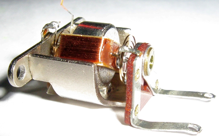

Hi Conrad, yes I understand the meter should blow by having 9V put across it. I was trying to find out why I could not get any significant deflection on the meter, even for the battery check (2k/82k voltage divider with a 3k load across the battery). Like I said, the meter measures in the megaohm range so putting 9V across it has little effect.

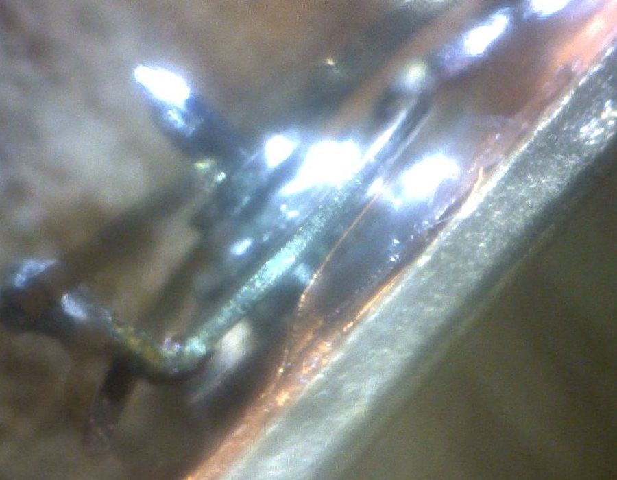

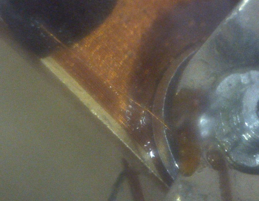

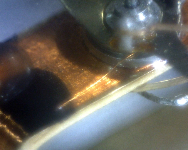

I'll try to post some pics, but so far everything tests out as I stated. I can get the meter probes right down to where the tabs connect with the coil, but it's still reading 1-3 megs. I can't see the wire connections with the bare eye, so I'll see if I can get some macro photos to post.
Nice photos & you have as good access to the coil as you're going to get. About all I can suggest is reheating the joints where the wire attaches, otherwise the open must be in the coil somewhere. Try to get it under a low power stereo microscope- when working with hi-fi always try to use a *stereo* microscope.
If that doesn't work, I'd look for a meter movement from whatever you can find, and try to adapt it to the case. If it's the same sensitivity or more, you can just scale it with a resistor. If less, more fiddling is involved. Probably sacrilege, but you could also make an adapter plate and put in one of the little inexpensive digital meters various places sell.

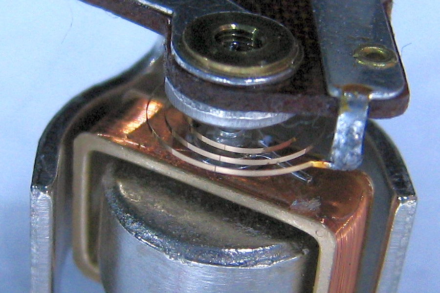

I pulled the coil out to have a better look at things. Even with it out, it's impossible to see the coil connections with the naked eye so I did some snooping with a cheap USB microcam. I managed to get some up-close visuals on both ends of the coil, but I can't detect any problems or see the actual connection. I think a proper microscope would definitely help.
