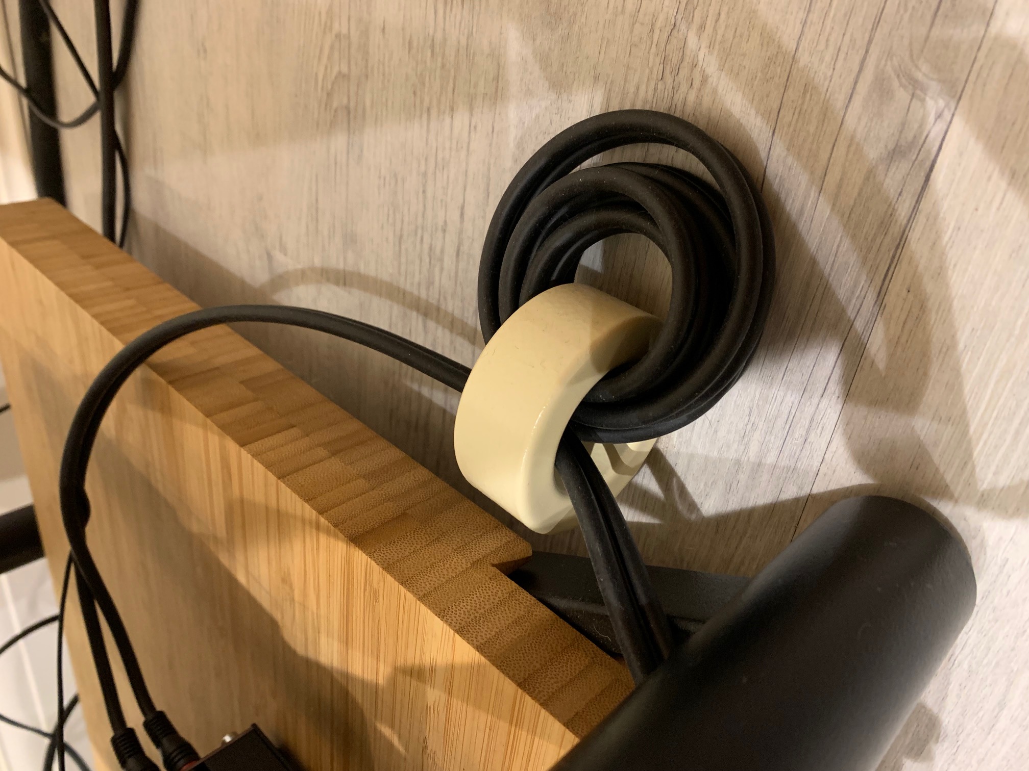

Radio station comes through phono stage, only fixed when I grab the wires??
No, they shouldn't. The shields and metal enclosures should form one big conducting box around the circuitry. When you connect the shielding of the input and output signal wires anywhere else than straight to the enclosure, the shield that sticks into the box is a coupling loop that couples outside RF interference into the box.

Loading an input with a capacitor is a poor solution that may not work at all. The problem is that the input is a very low impedance at RF frequencies vs the ~47K audio impedance. The best solution is a series impedance like maybe 100 to 1000 Ohms. You just have to reduce the RF current below the rectification threshold. For meg Ohm tube inputs, I use 100K but that would be too much for a phono input. A ferrite bead might also work and have zero effect on the audio. But the description implies some kind of grounding problem, but RF problems cannot be solved with "electrical" logic since any wire is a choke and an antenna. If you want to use a capacitor, the first place to put a cap is between the phono ground and the chassis, ie directly and not separated by a lot of wire. The cap should not be too large, or it may cause ground noise at audio frequencies, say 0.01uF.

Many phono amps bring the screen and signal hot into the amp and attempt to solve the problem with an series mode RFI filter (lossy ferrite + Cap 'L' type pad) in the signal board. Often that is too late to try to fix it.
Its almost certain the the RFI is coming through common mode and its being picked up in the cable shield and then demodulated by one or more semiconductor junctions in the preamp.
On all my phono amps (and many commercial products designed with RFI mitigation in mind) I bring the cable shield and signal hot into the board as described above, but right at the connector, tie a 2-5nF (I've seen up to 10nF) cap from the shield to the chassis. This effectively shorts the shield to the metal housing at RF and makes it one 'enclosure' that very effectively keeps the RF out. In stubborn cases - ie high field strength situation, you will still get RFI coming through - clearly in your case, you are near a Tx. The high gain and use of bipolar input devices mean you have a ready AM receiver.
If you add a Fairite toroid as I've done below you now create a very effective common mode filter that will almost certainly resolve your issue. Without the toroid and with the RFI cap removed on my MC preamp, I get a load of European and French AM stations. With the cap and toroid, nothing - absolutely quiet.

The Mani is not grounded, it uses a two-prong AC transformer brick. I’ve tried running the ground wire to ground directly, but it did not improve things.
I’ll continue experimenting. I’ll have to order a ferrite ring big enough to go around both cables. I might have a capacitor that will work, I’ll have to check…
