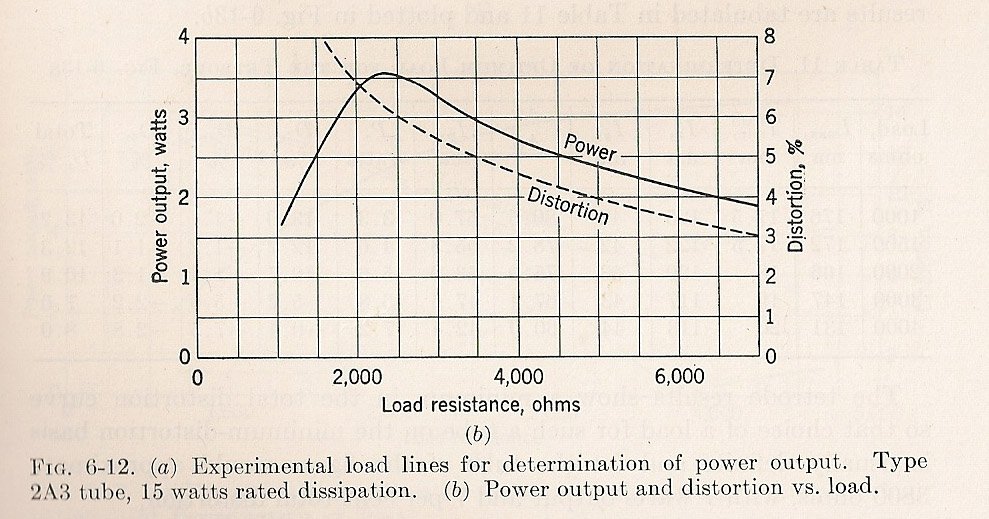

What is the Damping Factor of a common 2A3 SE amplifier?How many great system designers have I met at my many jobs over the dacades . . . only a few.
How did you arrive at that number for DF?🙂
jhstewart9,
and interested parties,
1. My varioius SE 2A3 amplifiers had a damping factor of about 2.5 to 4.5.
For many, that is nothing to write home about (sorry for the american trite expression).
I measure the small signal damping factor.
Starting with a 1kHz signal applied to the input volume control, and with the secondary Un-loaded, I set the volume control until the amplifier secondary output is 1VRMS.
Then, I connect a non-inductive 8 Ohm load resistor across the secondary and measure the loaded output RMS voltage.
If the loaded Volts rms is 0.8V, than the amplifier's internal voltage is divided 0.2V across the amplifier's output impedance, and 0.8V across the 8 Ohm load..
0.8V/0.2V = 4.0
The damping factor, referred to an 8 Ohm load is 4.0.
2. A builder used a 2A3 at 60mA, the plate impedance, rp, is 800 Ohms to drive the transformer he wound himself.
He wound a turns ratio of 20. 20 squared is 400. And 8 Ohms x 400 = 3200 Ohms
He expected the damping factor to be 4.0, according to 3200 Ohms / 800 = 4.0.
But it was less than 4.
He forgot to account for primary DCR of 5% of 3200, and secondary DCR of 5% of 8. The DCR total: 5% + 5% = 10%.
The effective primary impedance is is 3200 Ohms + 320 Ohms = 3,520 Ohms.
The effective secondary impedance is 8 Ohms + 0.4 Ohms = 8.4 Ohms.
The result is that the 800 Ohm 2A3 plate is driving a winding of 3200 Ohms, that is in series with an effective DCR of 320 Ohms (3520 Ohms total)
But that will cause a loss of voltage into an 8 Ohm load resistor; 90.9% versus a lossless transformer.
The transformer loss at 1kHz is about -1dB.
And the damping factor is about 3.6.
I hope my late night calculations were done correctly.

Early in the study of vacuun tube electronics, most of the text books of that era would take us thru the calculation of the maximum power available from a triode. And the resultant distortion. For the case using an OPT the max efficiency is ~25%. Need to be careful the loadline is not too steep.
Damping Factor is Rl / rp. So DF of about 3 is possible at max output. The distortion can be reduced quite a bit by choosing a higher Rl, say 4-5rp. This leads to the interesting conclusion that the DF of all triodes is the same under similar conditions of load vs rp. Rp can be lowered by increasing cathode current, but there is a limit to that.
In a practical application the circuit will need a matching device to the load, most often a transformer. Now there is resistance (& other) in the path to the load. This will lower the DF still further no matter what the quality of the OPT. Spend your money wisely.
Many of the common triode SE amps we see here have a DF of about 3. Or less. And that is OK, it is what produces the kind of sound people expect to hear from their system. Often referred to as ‘not to tight’. Like a NFB amp!
