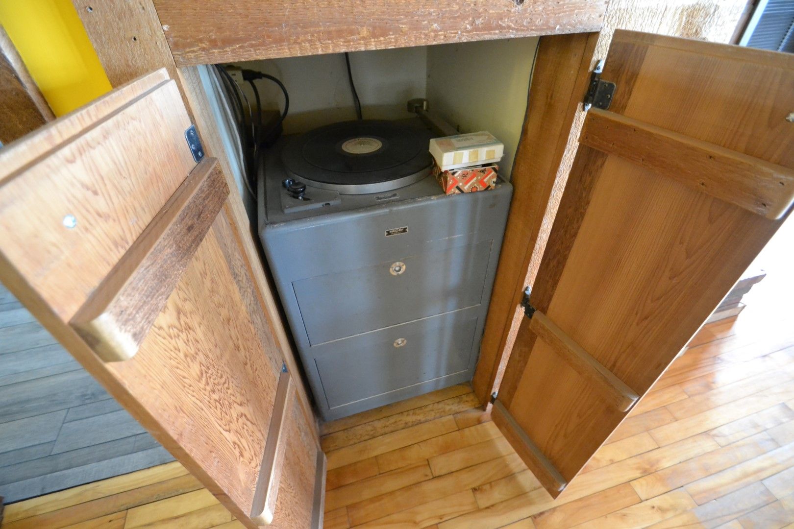

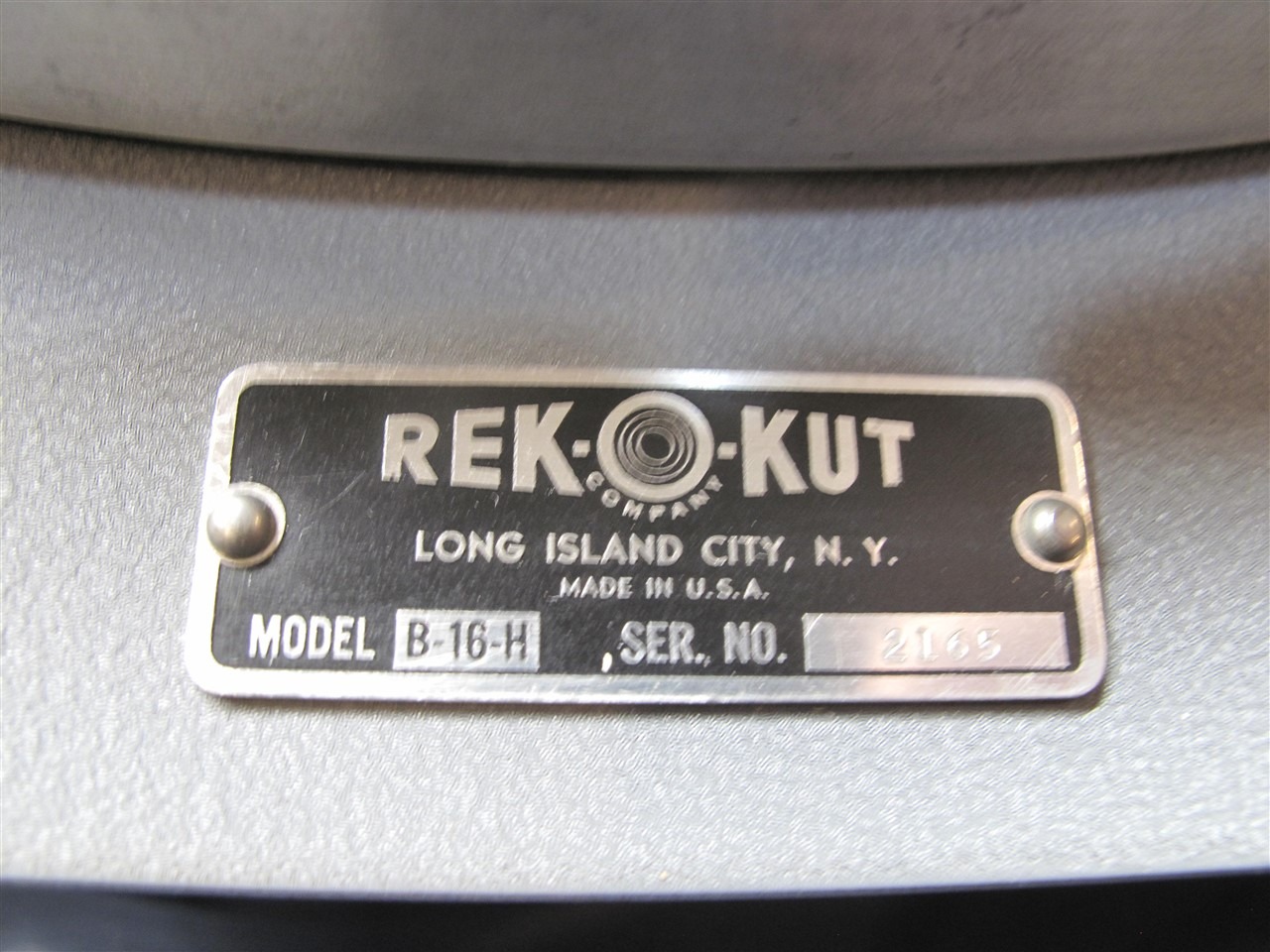

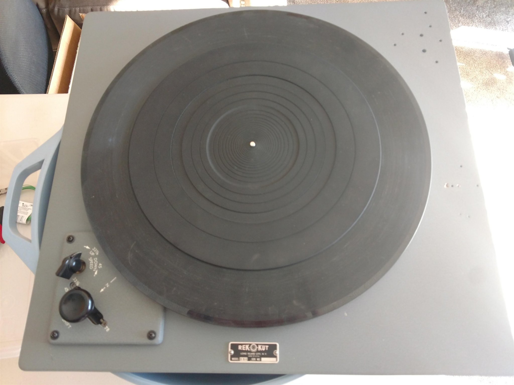

I finally got started on the Rek-O-Kut B-16H resto. Very interesting tank-like unit for sure. The cabinet will have to wait for warmer weather but I have made good progress on the TT itself.
Here it is peeking out of it's resting place where it has been for decades.

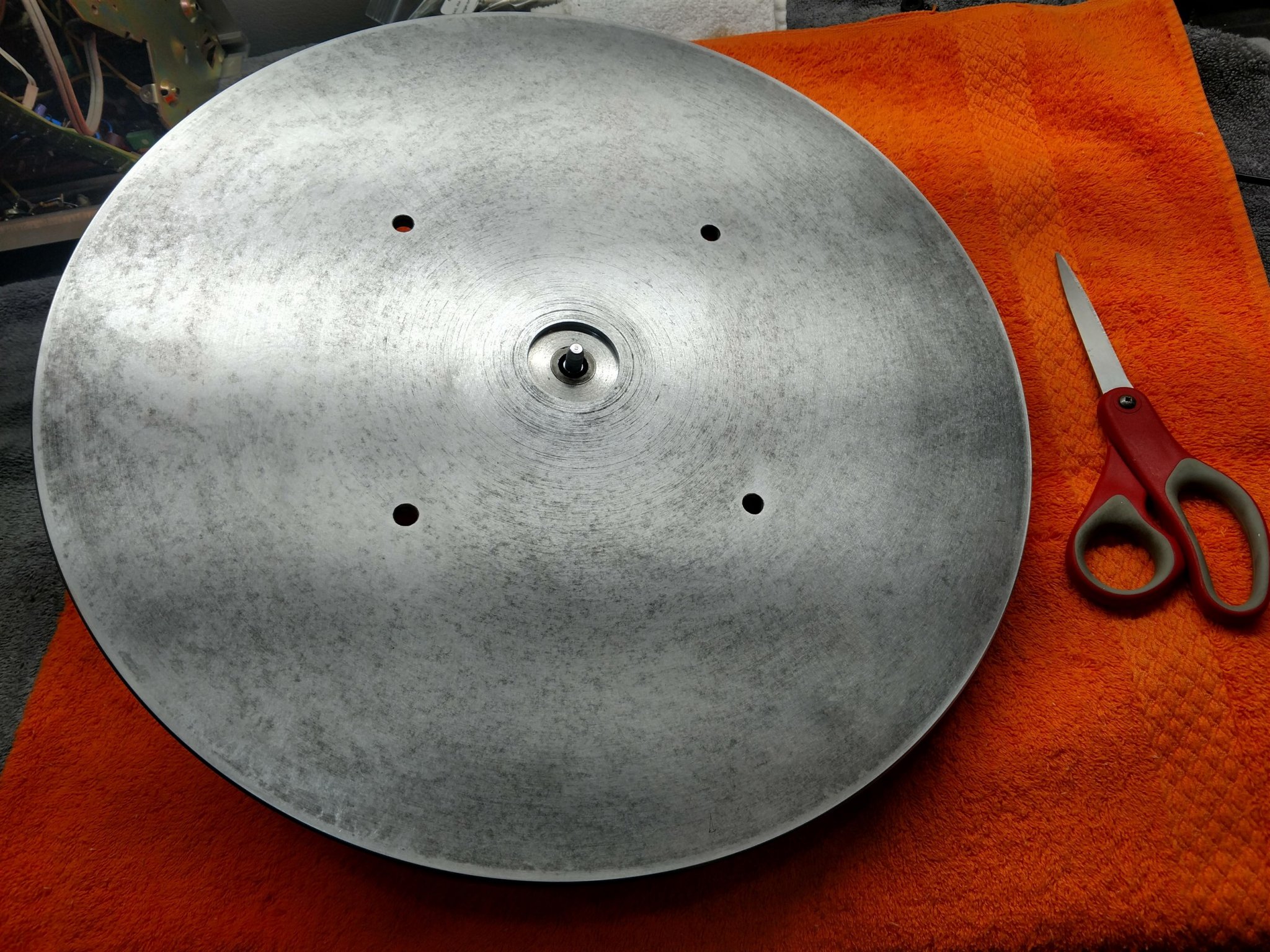

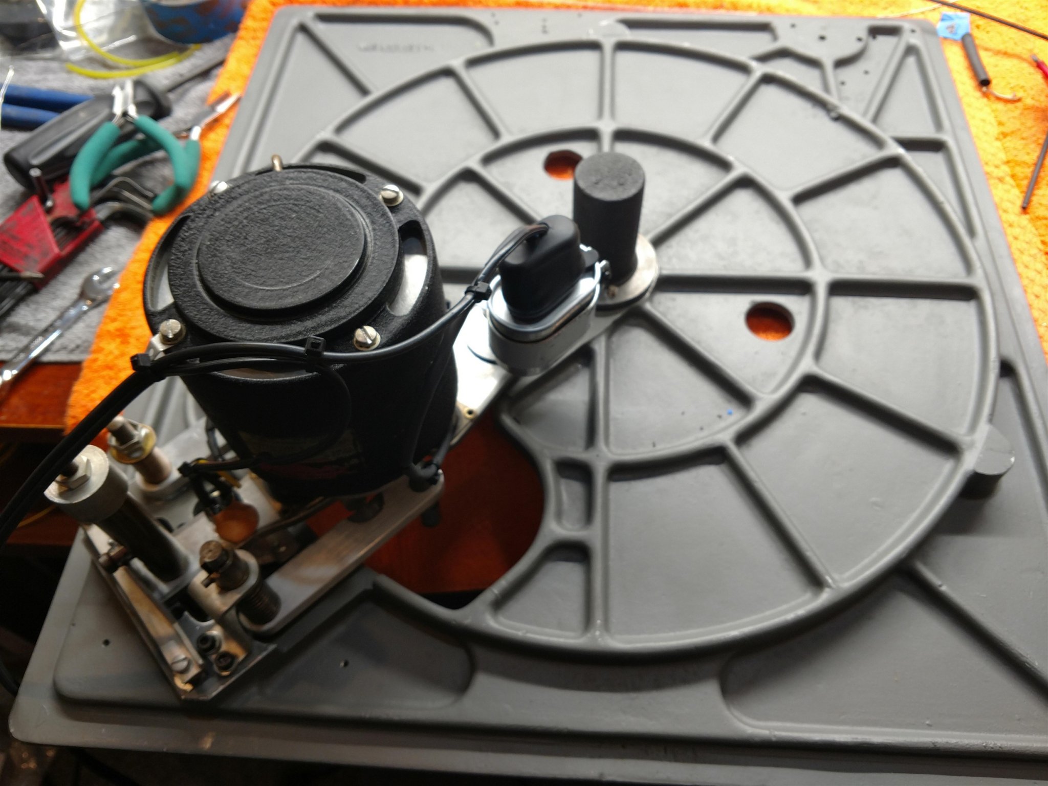

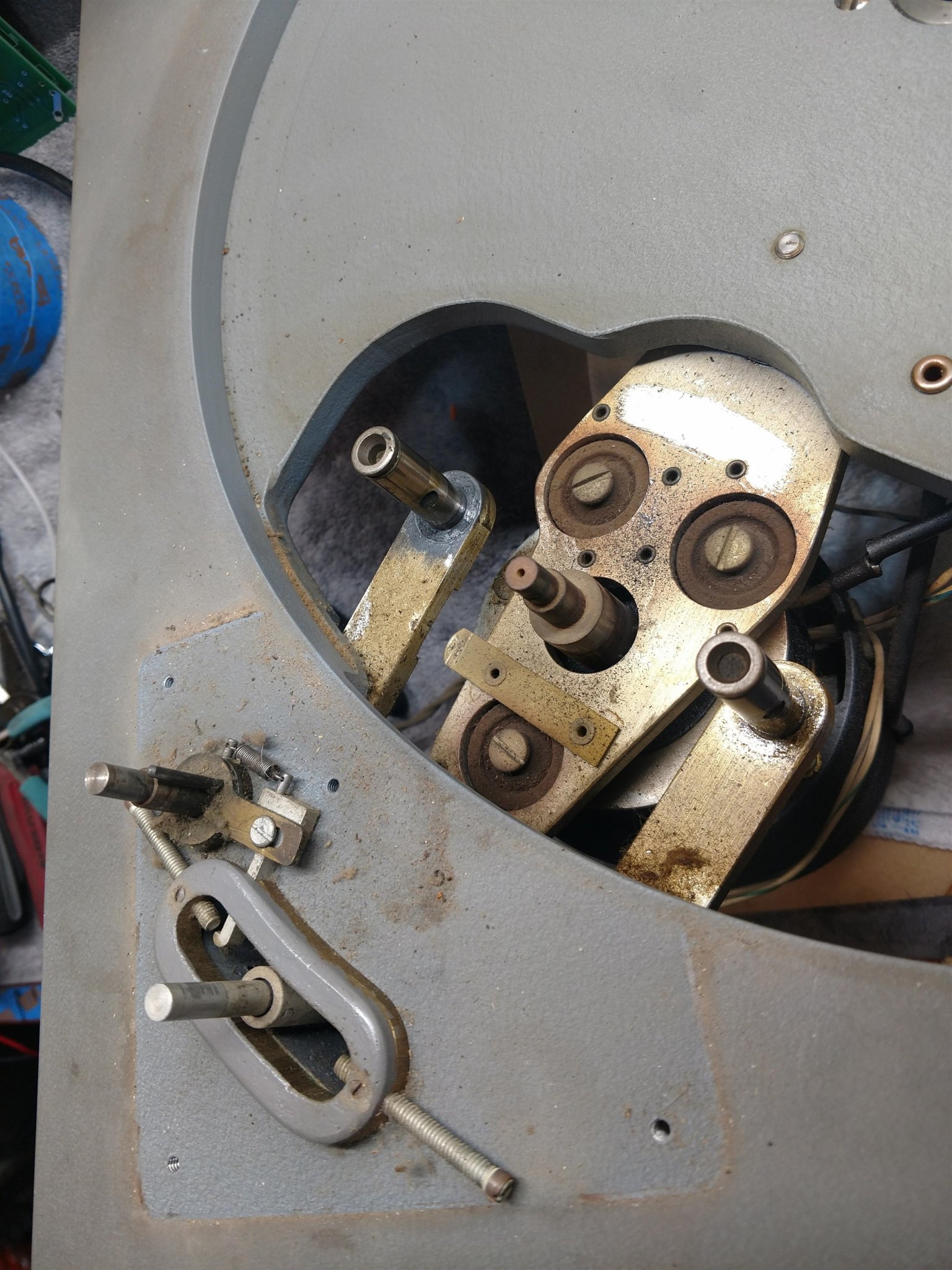

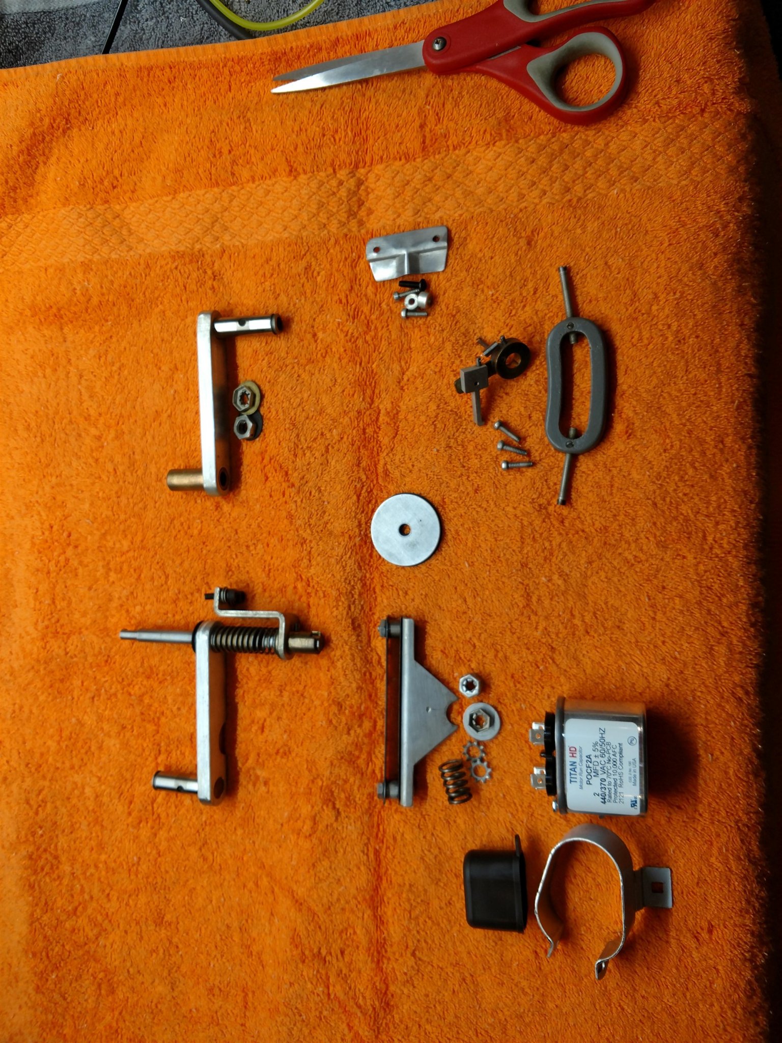

I have been scrubbing/cleaning/lubing parts for what seems like months. But here is some shots of the guts. This will be going up for sale soon. I don't have the room for it. As you can imagine, a 16" Studio Transcription TT can take up some space.

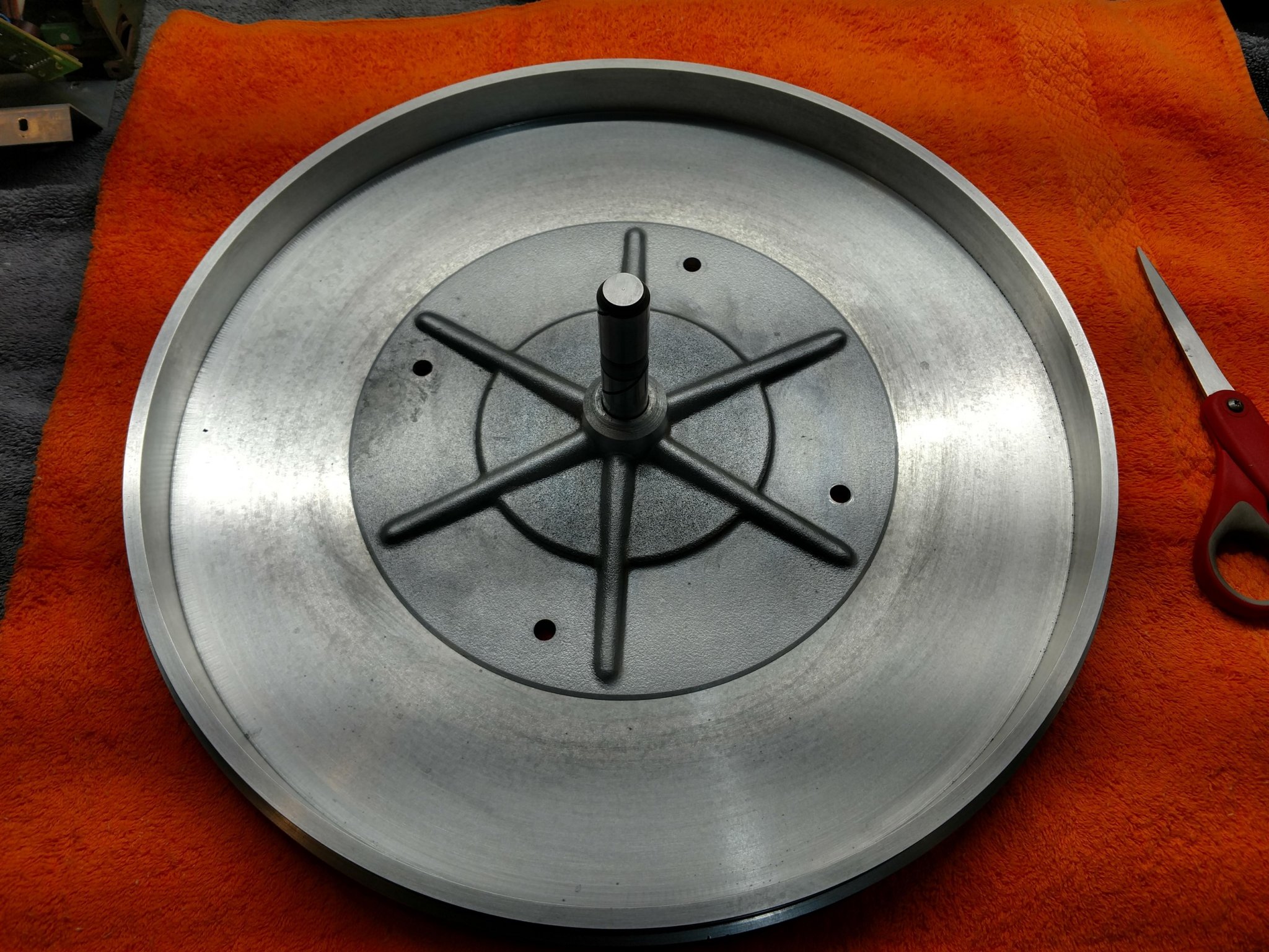

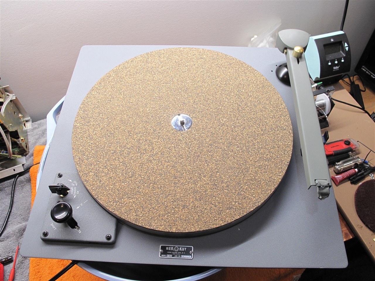

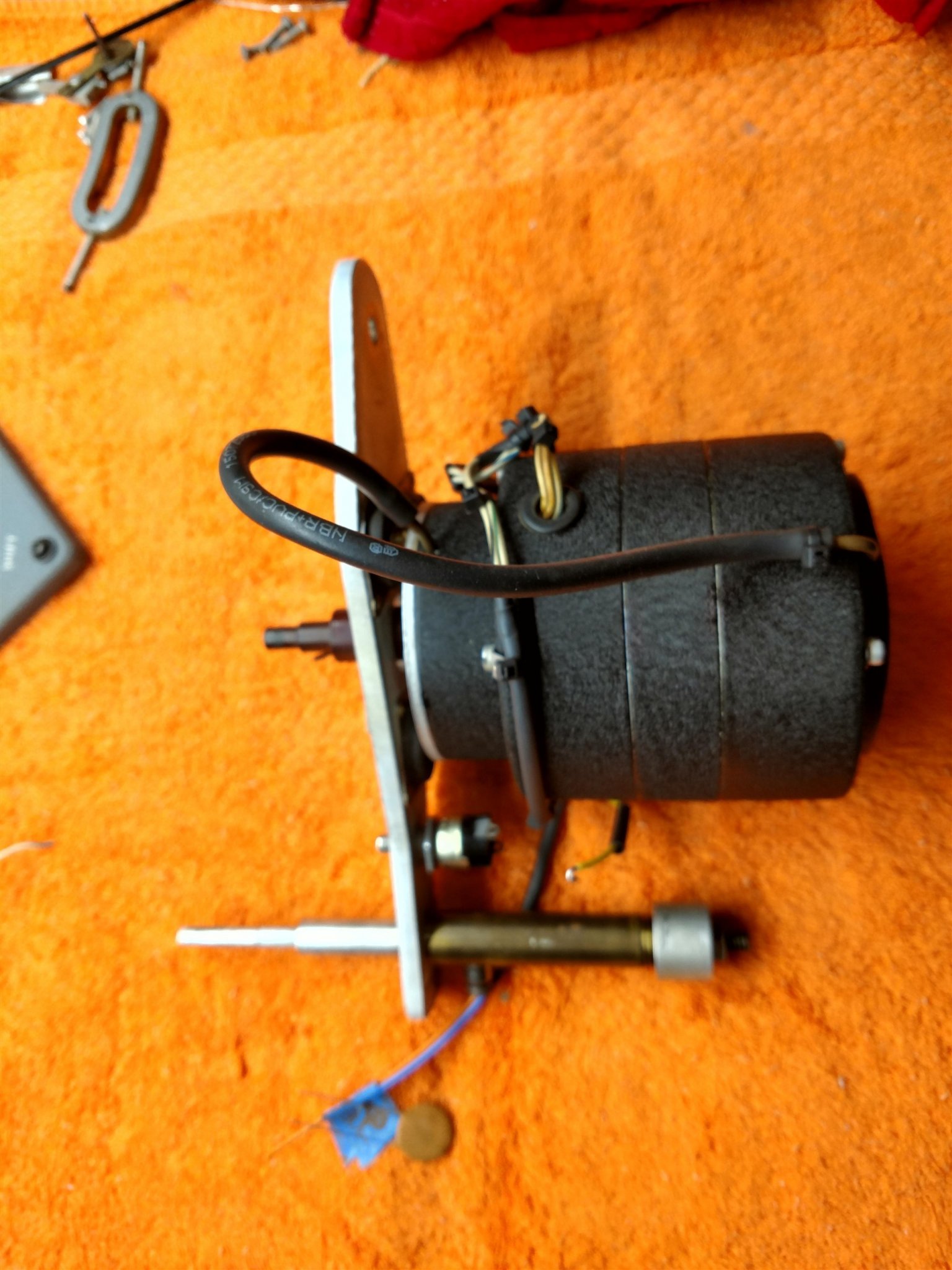

I got the motor disassembled/cleaned/inspected/lubed. Cleaned up the platter and should have the mat in hand in a day or two. Had to order the 16" cork mat from the UK.

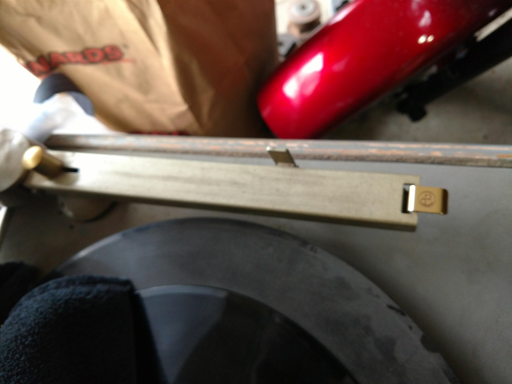

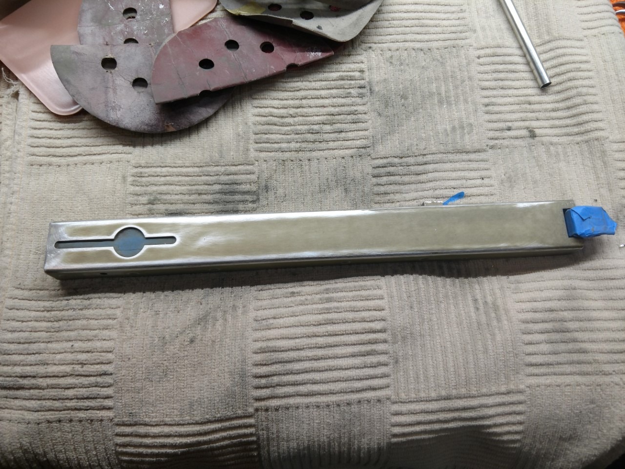

Here is the Pickering 190D tone arm going through resto. It is going to get a little bit of color on it. The industrial look is OK if you like it but I decided on something else. If the new owner doesn't care for the color, it can be altered. This will get a fresh coat from the air brush in the next few days and then I can rewire it and get it complete. I have some carts/stylus for it but may opt for something else.
The first pic is before, second during.
I would have left it stock but it had a few chips in the paint.
Shame it didn't come equipped with the Rek-O-Cut 16" arm.
That old Pickering arm is nasty, I did a restoration years ago on a system with that arm.
I used to have an old Rek-O-Cut Rhondine B12 model back in 1976 that I used for DJ duty.
Luckily the B-16H has enough room for a couple more arms. What didn't you like about the 190D?

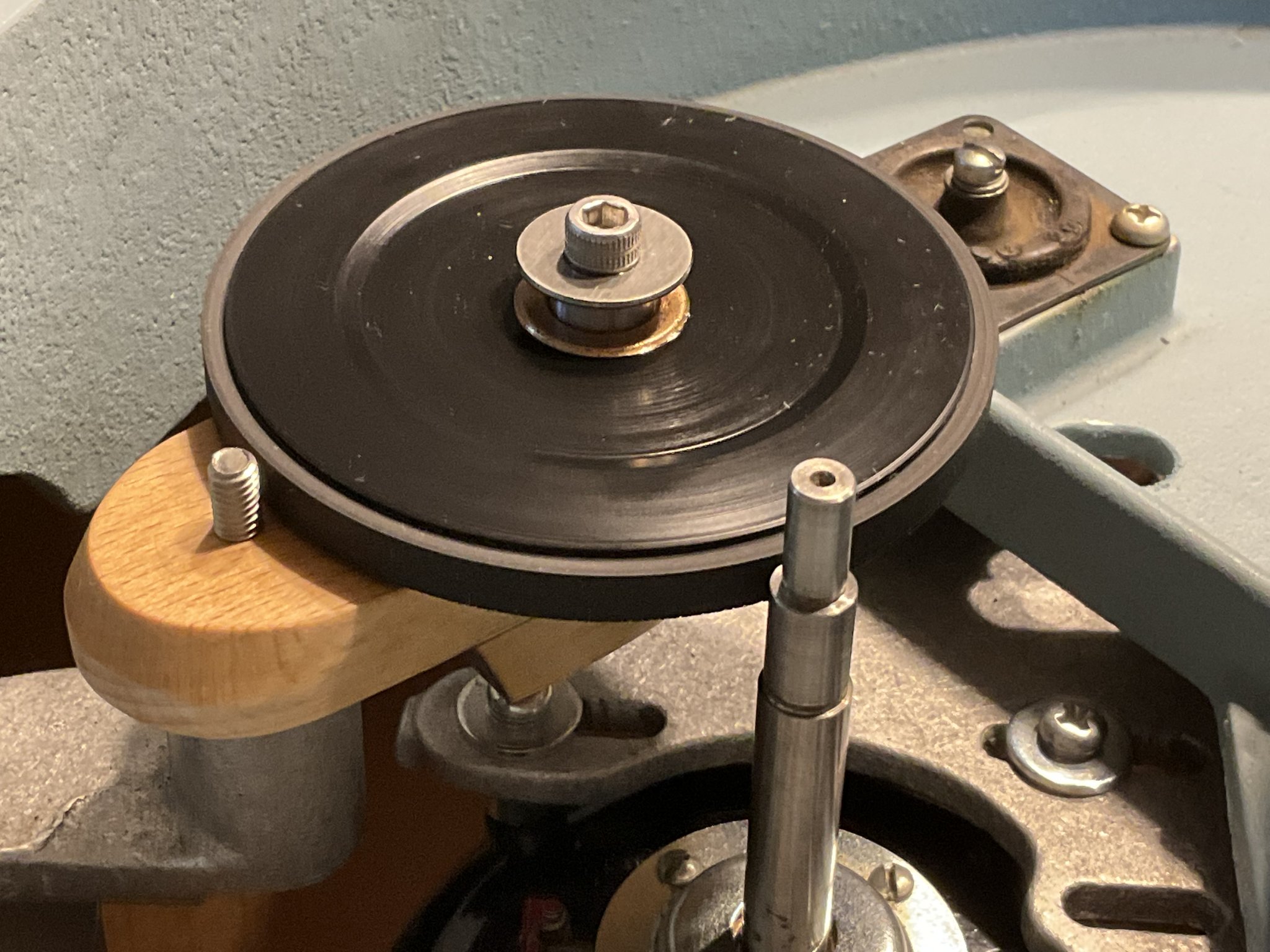

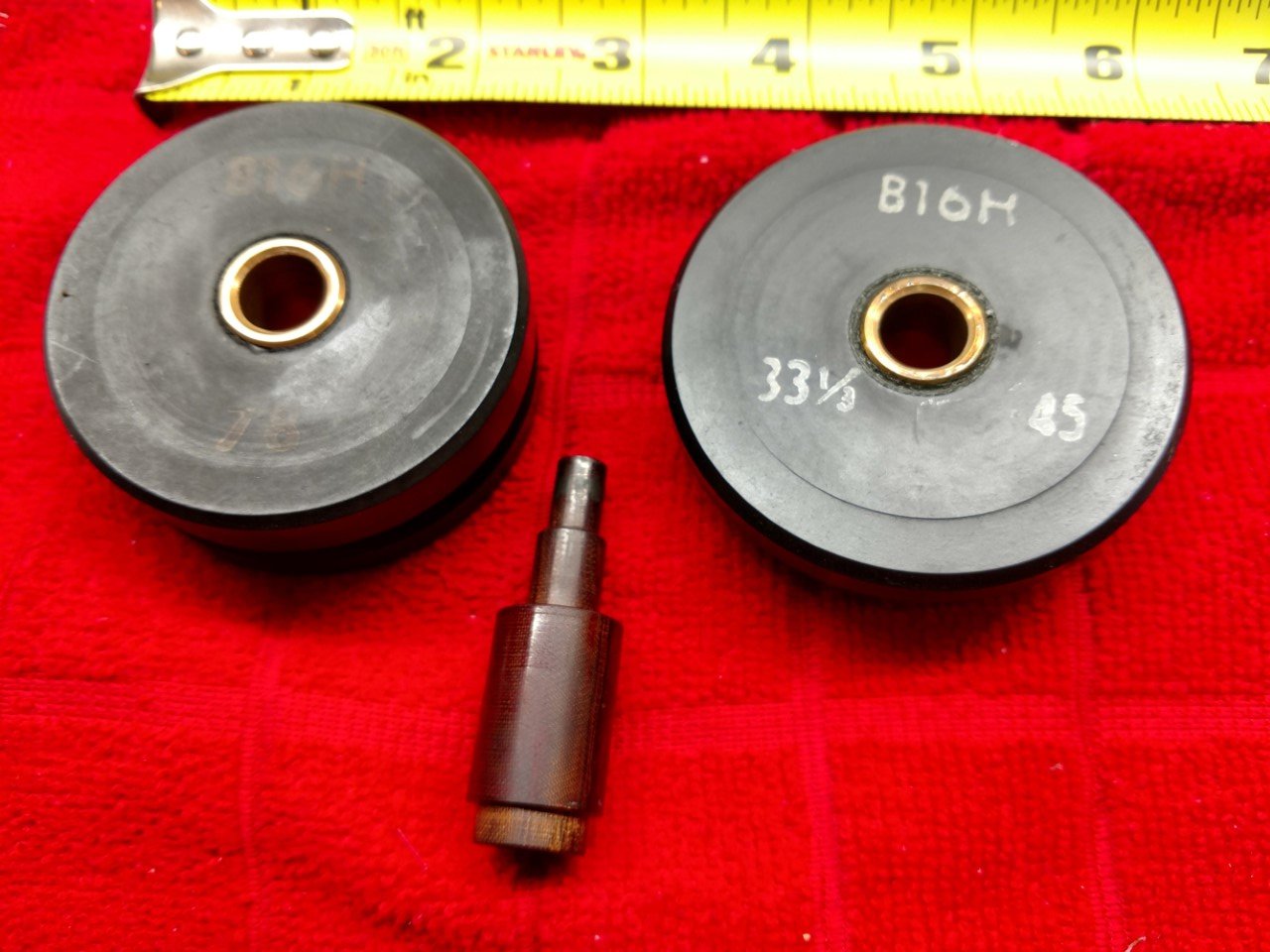

I just ordered the idler wheels (they'll rebuild mine) and I used Gary at https://www.thevoiceofmusic.com/ as he has helped me with a few jobs on my Reel to Reel machines. He has great prices and turn around times so it was a no brainer. This will be the last items I need as the rubber motor mounts will be here in a couple days. The weather is turning so I should be able to get the cabinet sanded and painted soon.
Wanted to let you know, there’s a gentleman named Abe who makes new, custom idler wheels out of Delrin which use a square section O-ring and new Olite bushing. They go for around the same price as a re-vulcanized rebuilt one but his Delrin wheels run a bit quieter. If you’re interested, PM me for his contact info - he makes a really nice idler.
Here’s one he made for my Russco Studio Pro table below.. BTW - it’s on an unfinished wooden idler arm I made just to test the arm material.
