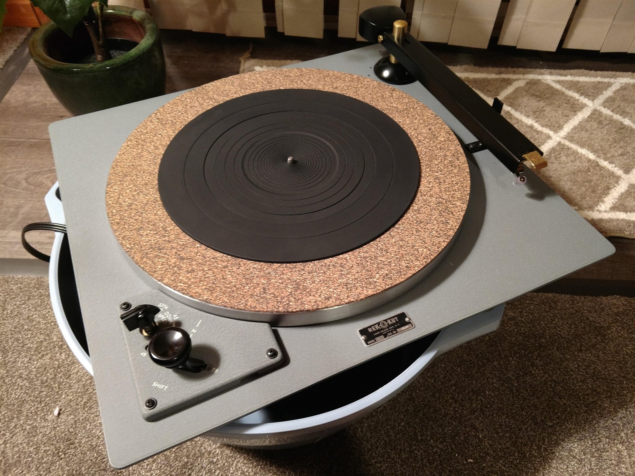

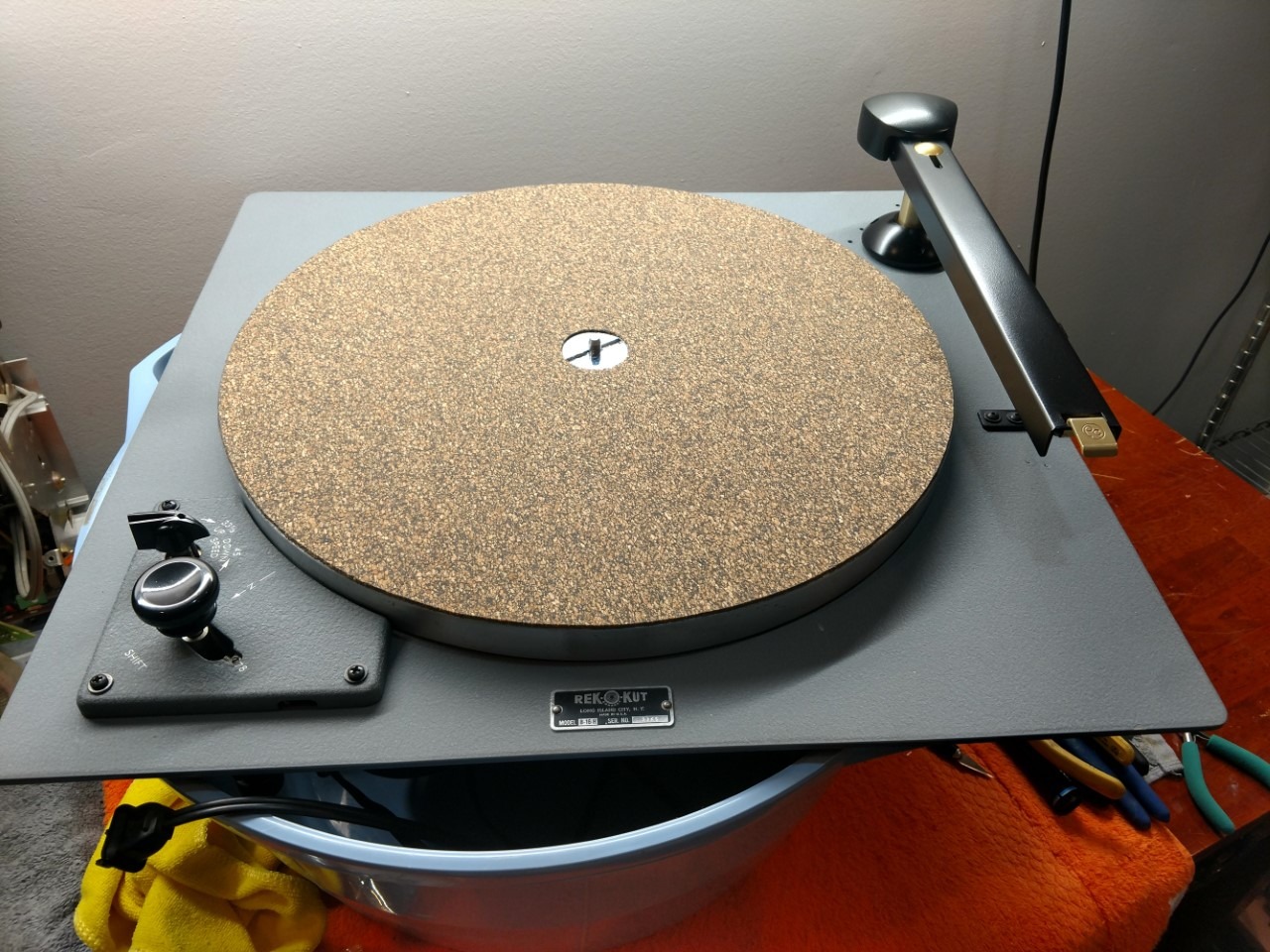

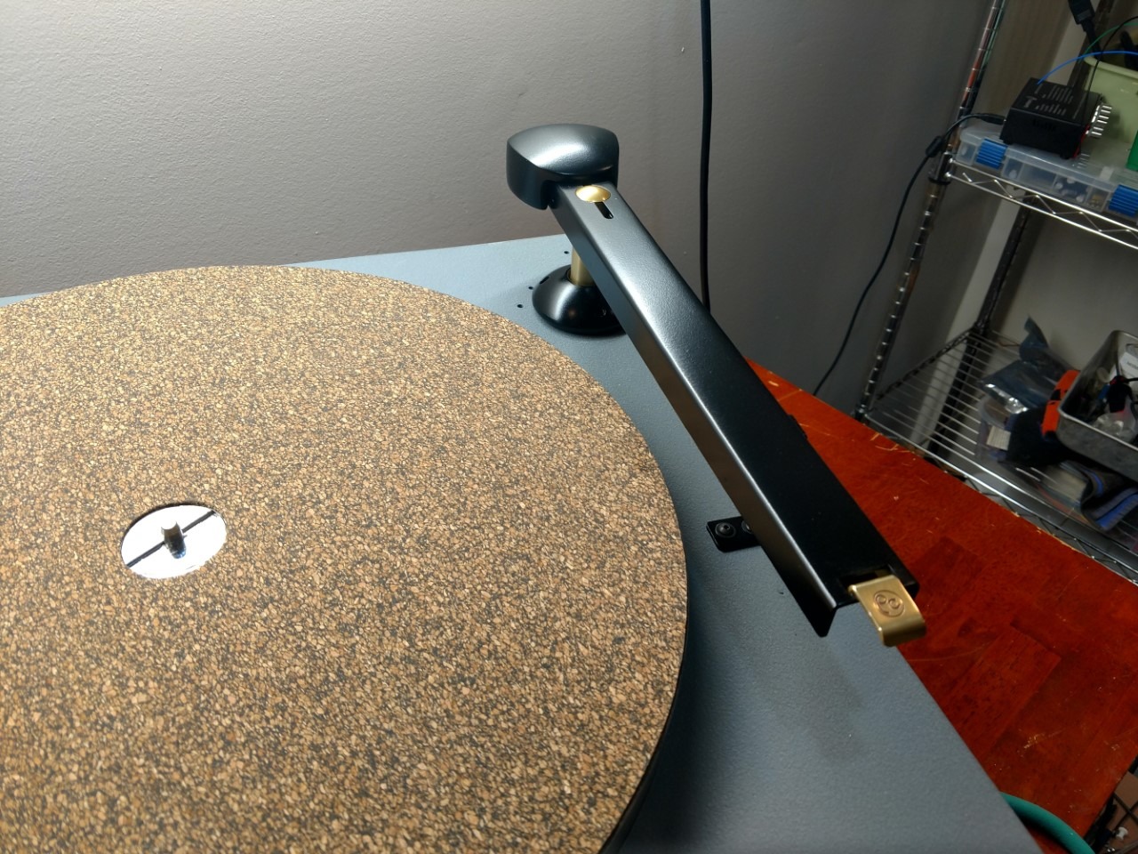

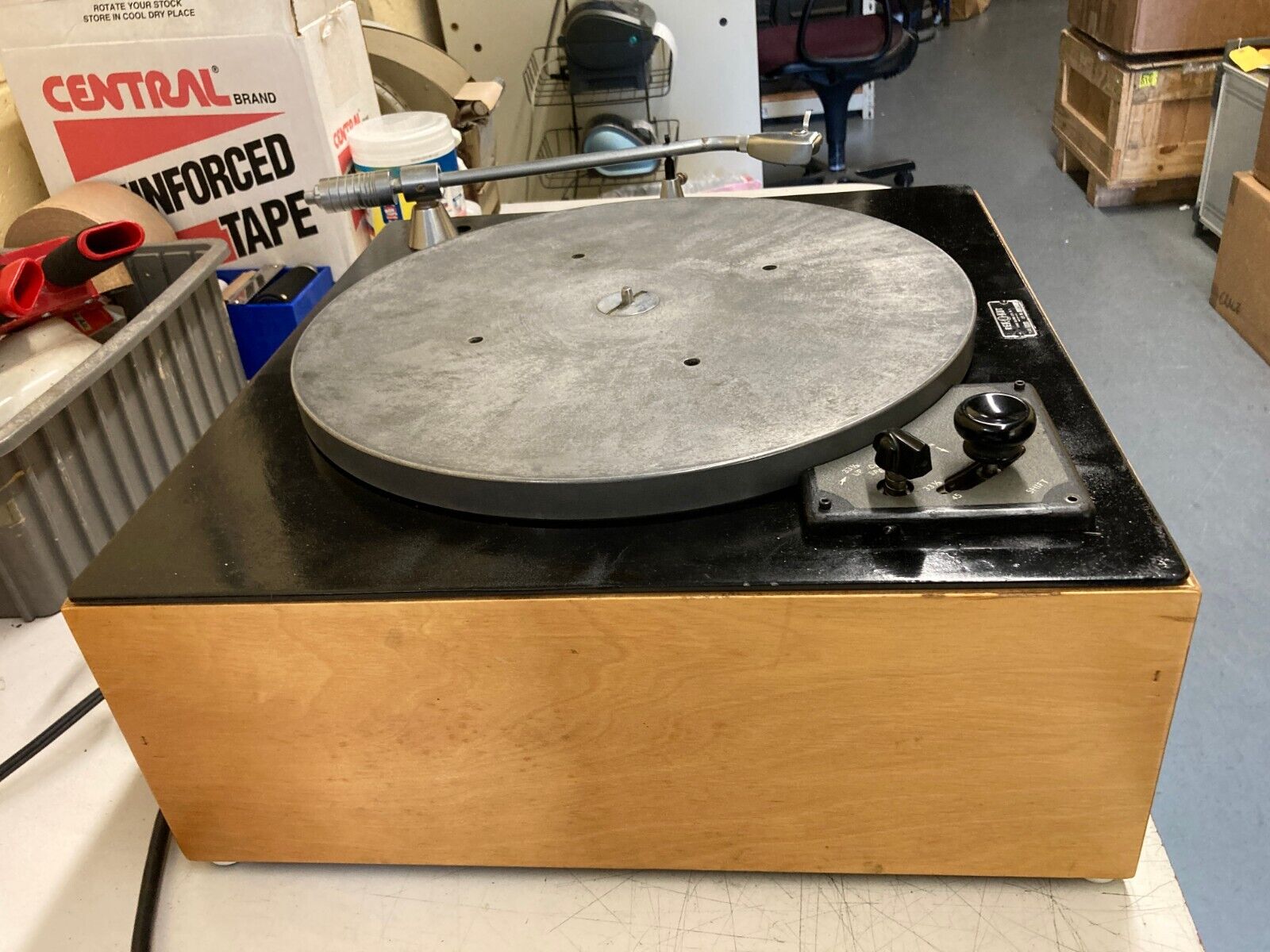

Air brushed the tonearm and cleared it. Its satin black. I set it on the table to see how it will look. I think it will pass. Looks way better than how it looked when I pulled her out of hiding. I got the new Pickering XSV5000 cart too.
Reactions: 2 users
I have wired the arm and finished putting it together so the turn table portion is about done. It turned out nice and when I sell it soon, the new owner will have a nice 70 year old Rek-O-Kut B-16H TT which should be good for another 50 years. I just have to decide on the cart I'm going to use and level everything and set the arm height after it get's perched back on the C-7B cabinet. I would have loved to put a second arm on the table but I'm not brave enough to drill into this rare TT. Let me know what you think. I'll be taking bids on it soon.

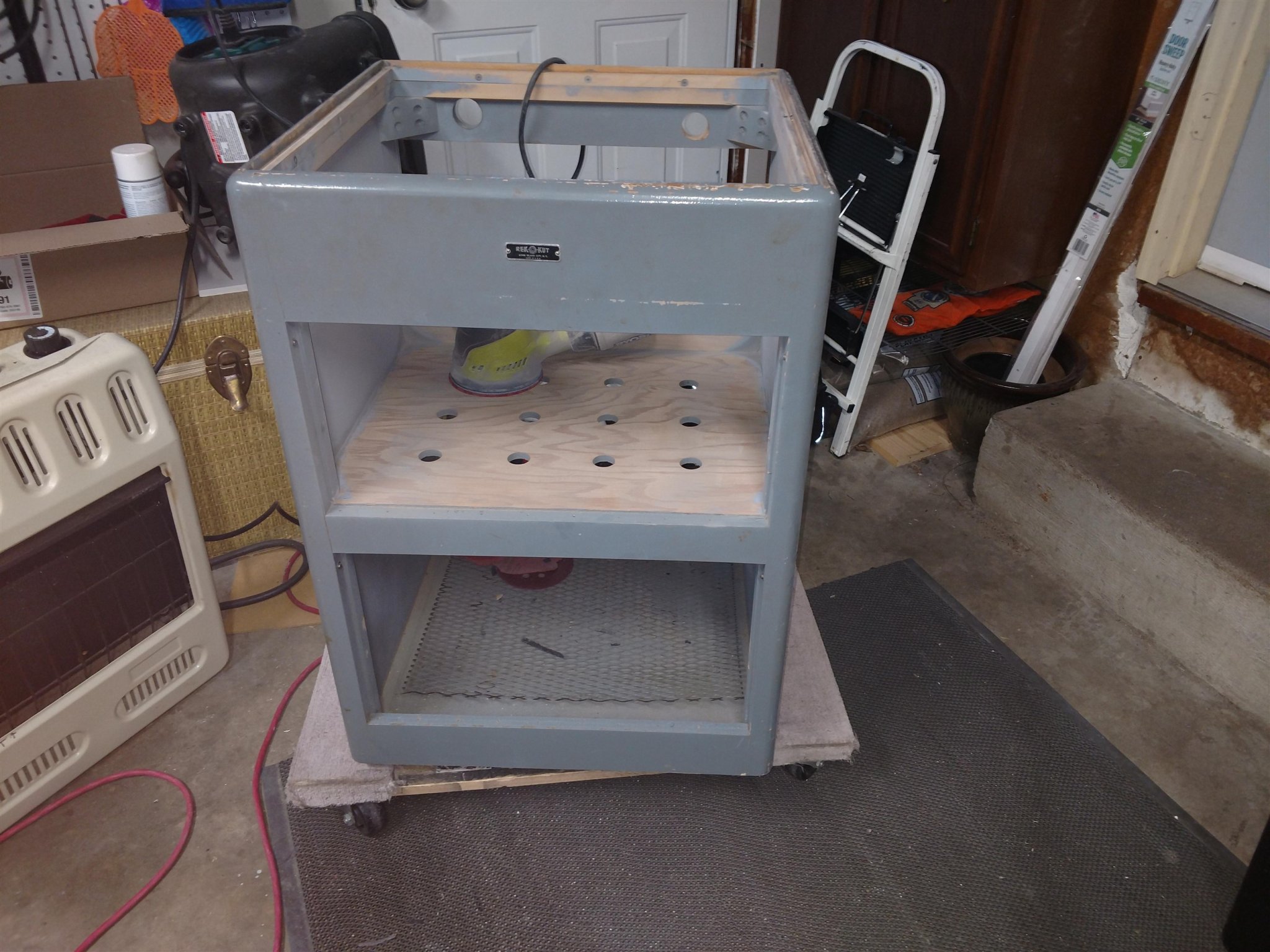

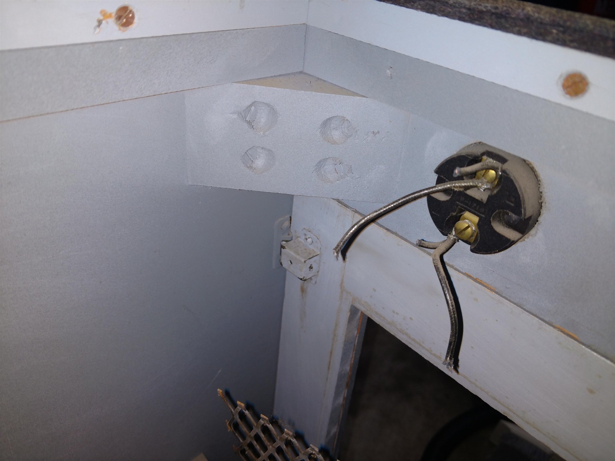

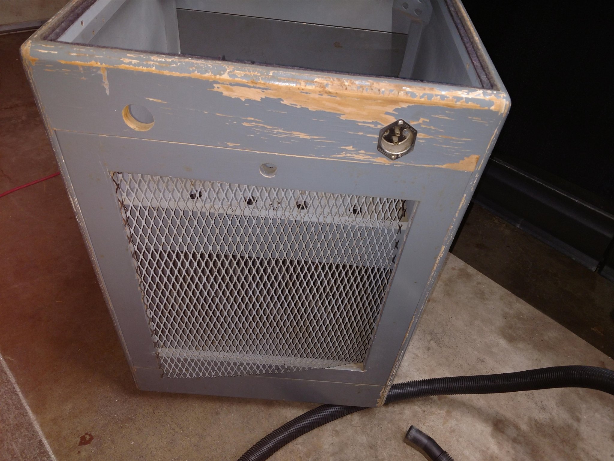

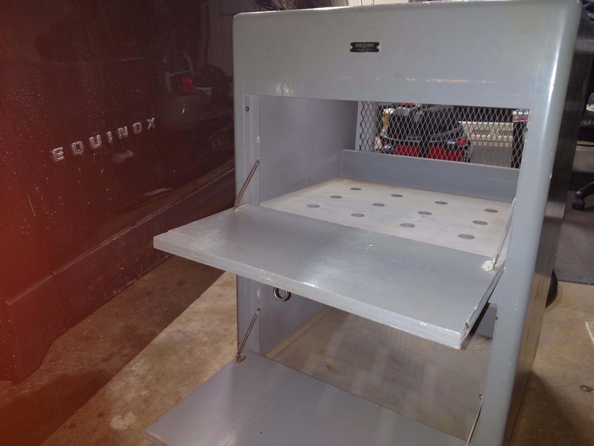

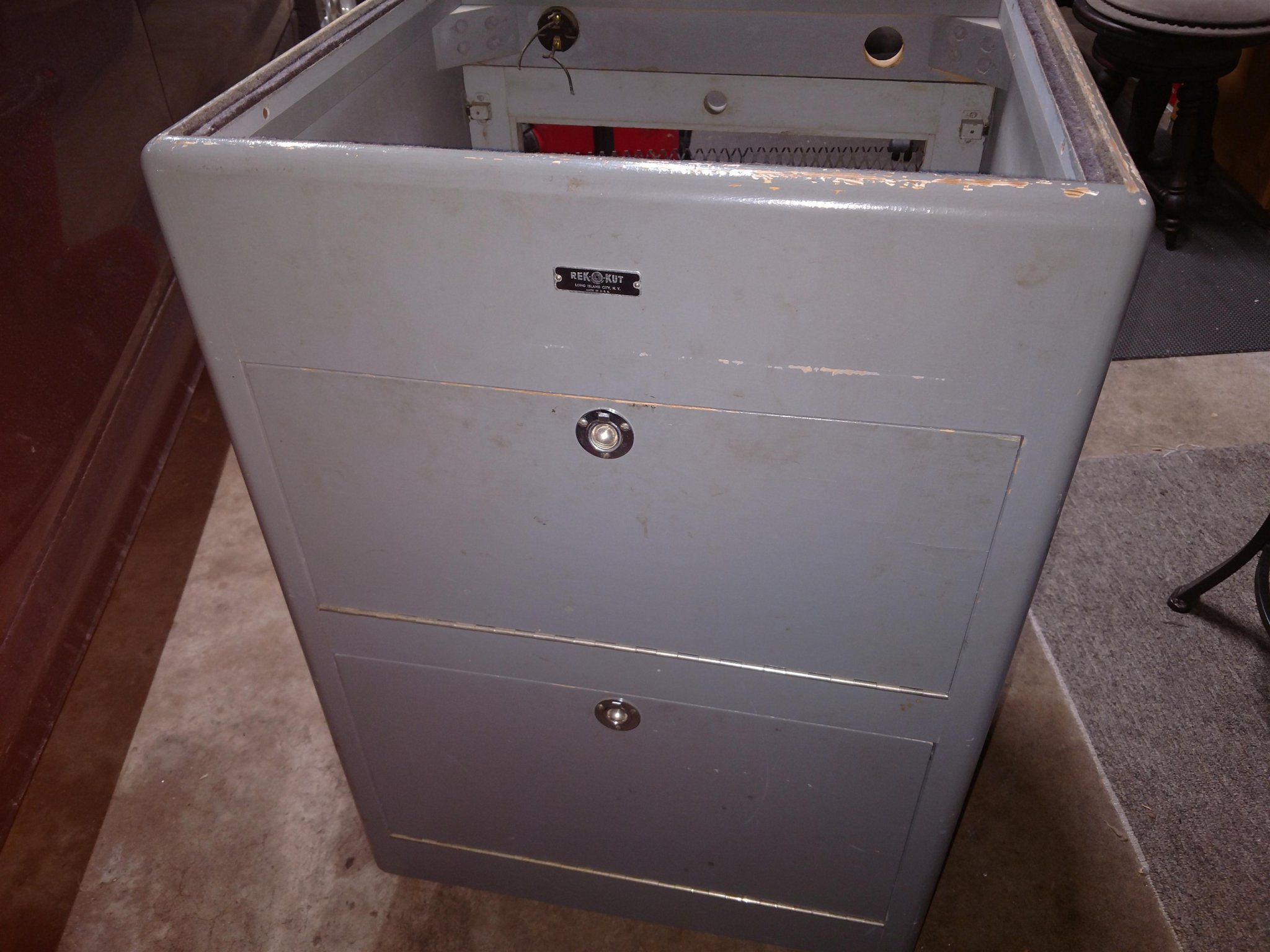

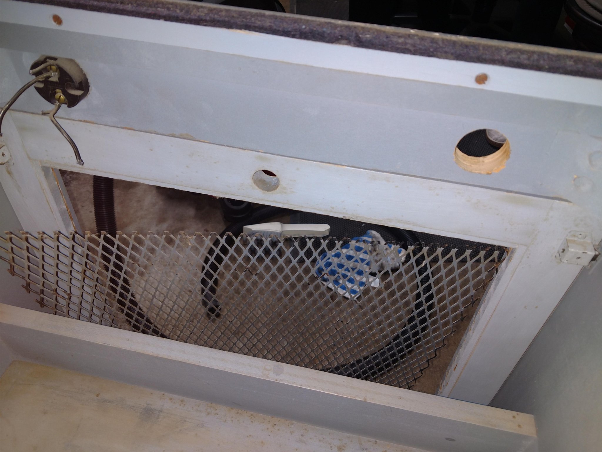

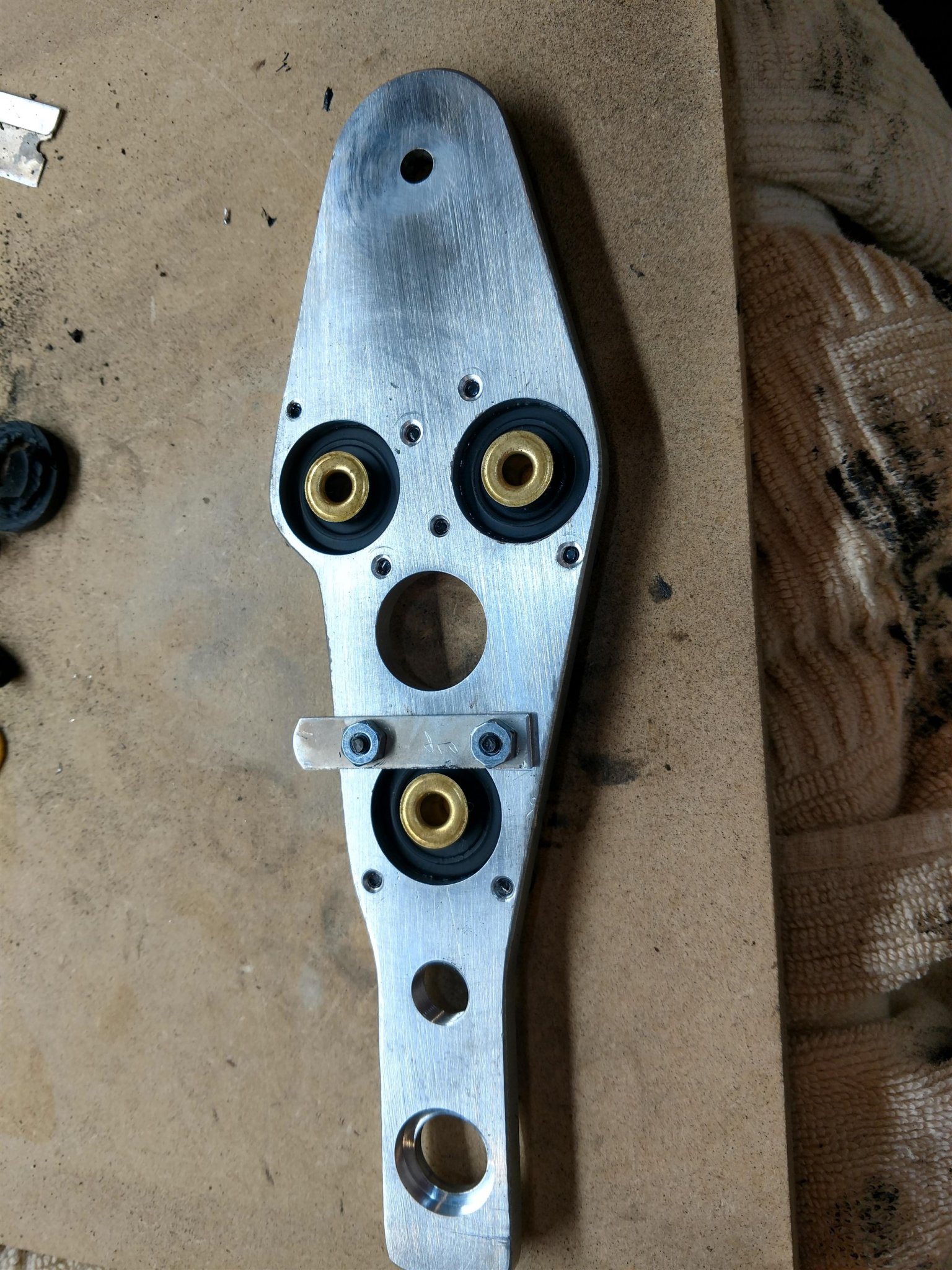

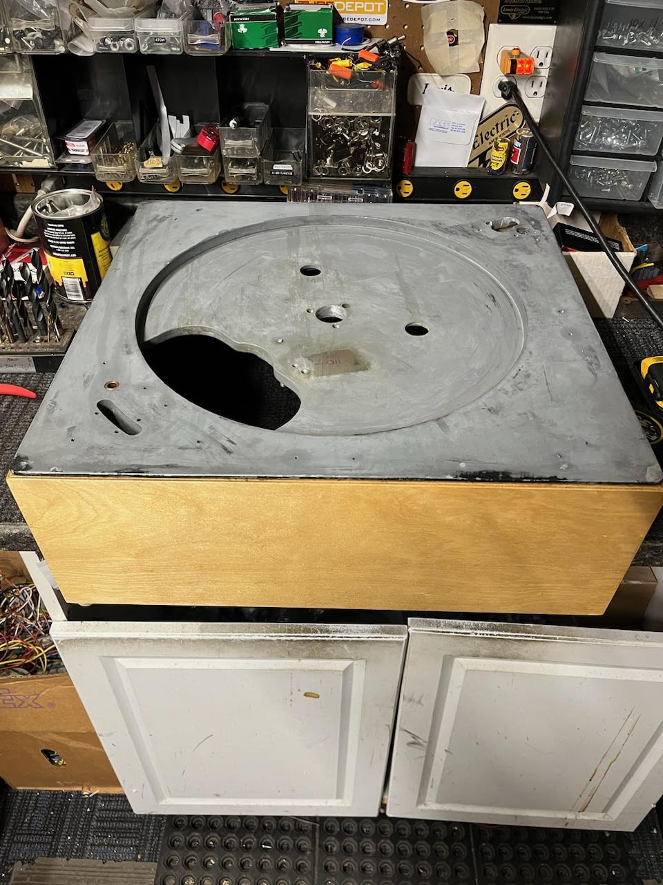

I started working on the C-7B cabinet last weekend and I had to get rid of the old flaking paint. Haven't picked out a paint color yet but satin black outside and a real light gray for the inside. I want the cab inside to be brighter and maybe a battery powered light so we can see things. Here are some pics of the process with disassembly. I hate winter, it gets too dirty sanding in the garage and I can't have a door open to get the dust out. I had gray sanding dust in my ears, nose and eyes even with protection.

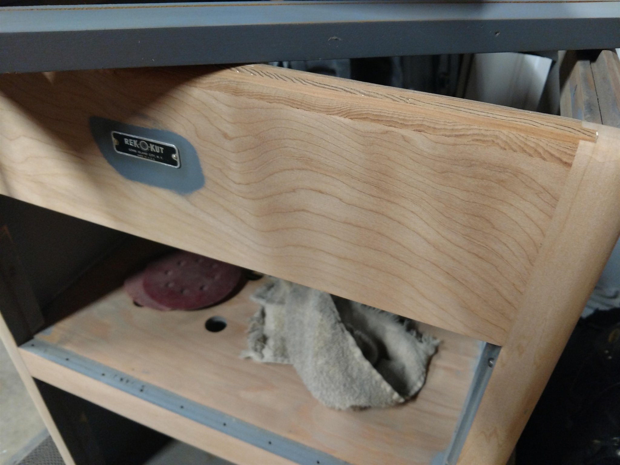

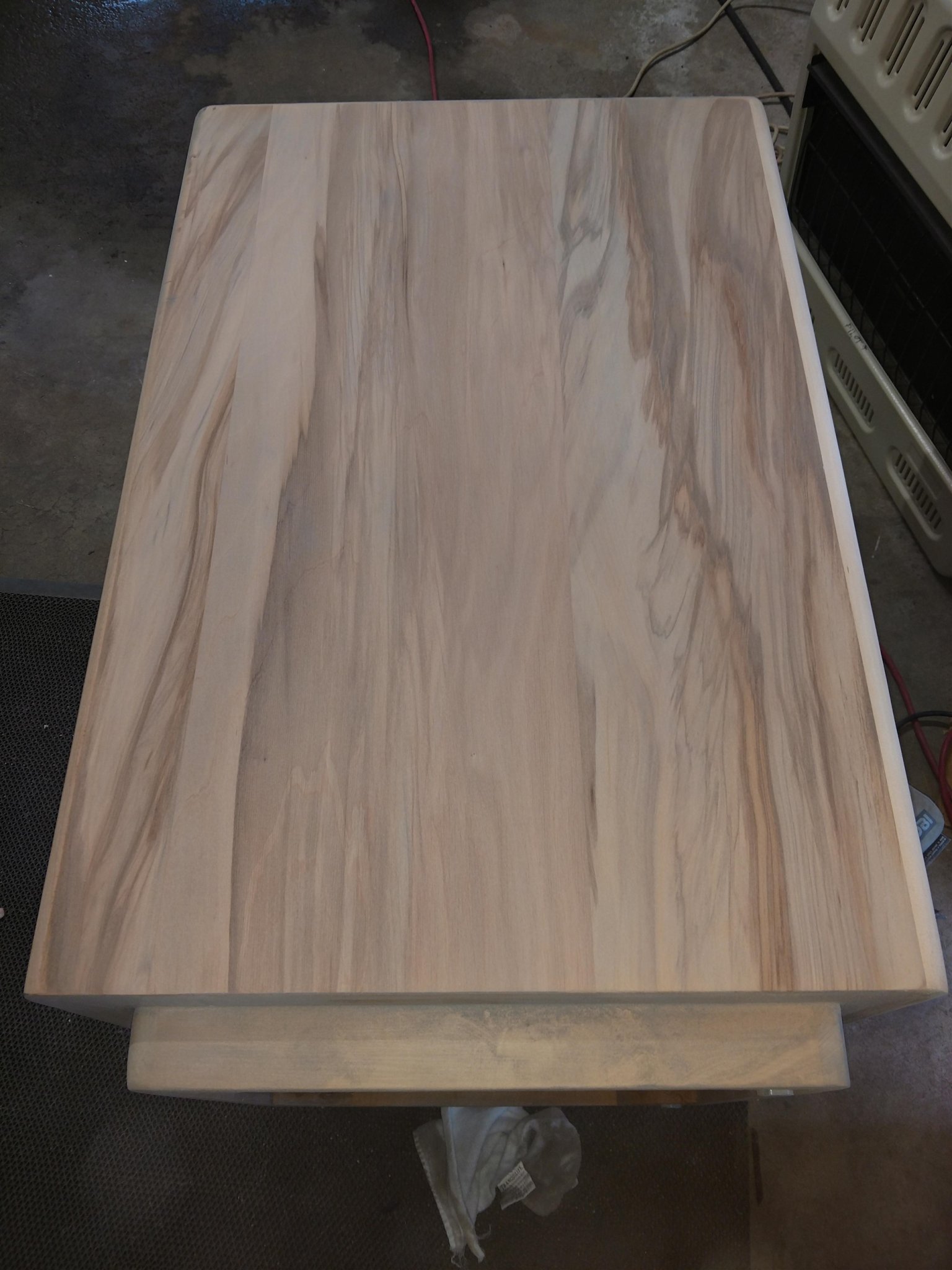

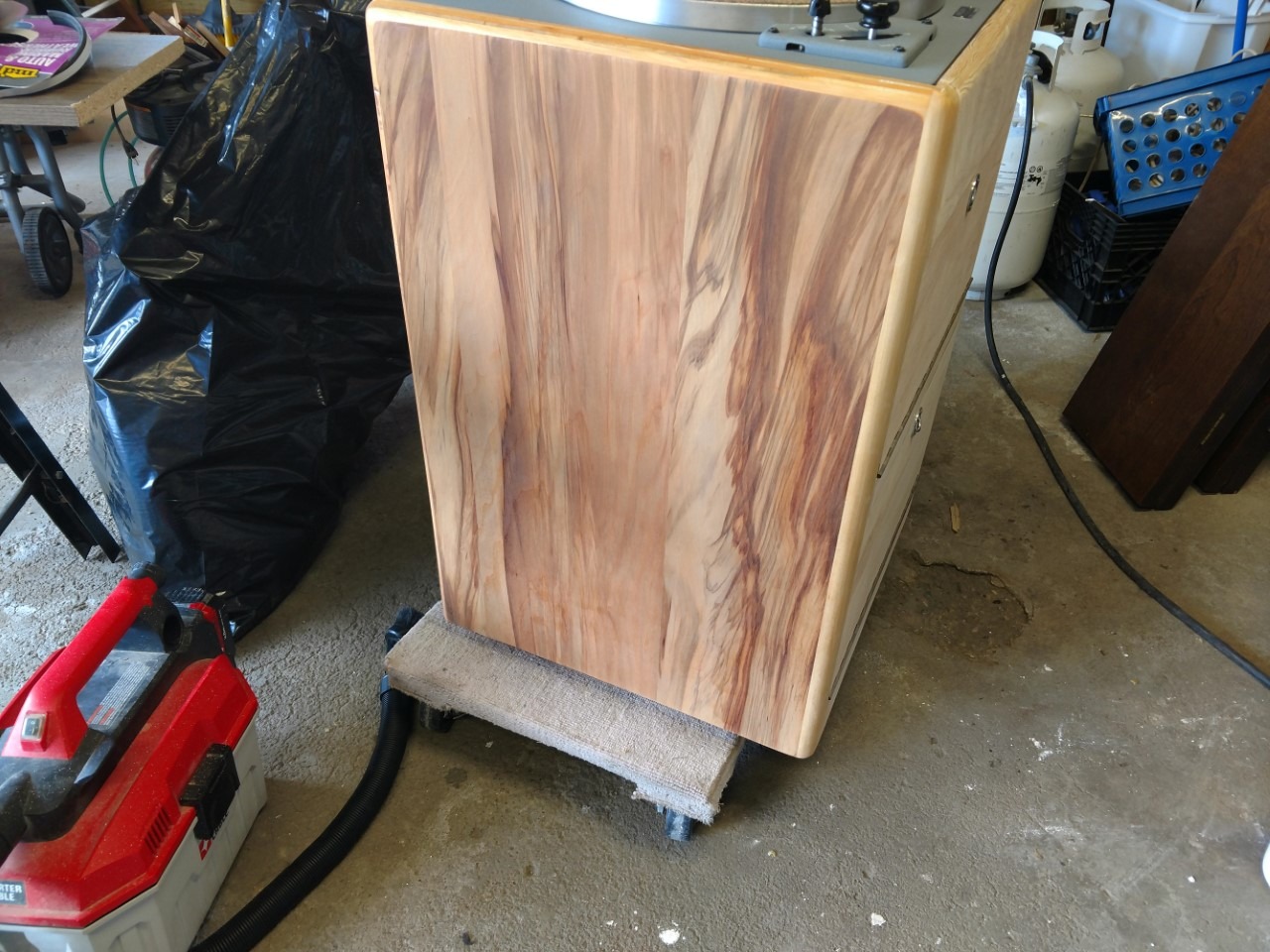

OK, Here is the kicker. I was going to go for the satin black/satin charcoal saint on the cabinet until I got through the original paint. It was so pretty that I think I will satin CLEAR it instead. The cab looks killer under the finish. If the next owner want's to return it to Industrial Gray, fine but I can't cover this beautiful 70 year old grain. The next post will show the beauty.
Reactions: 1 users

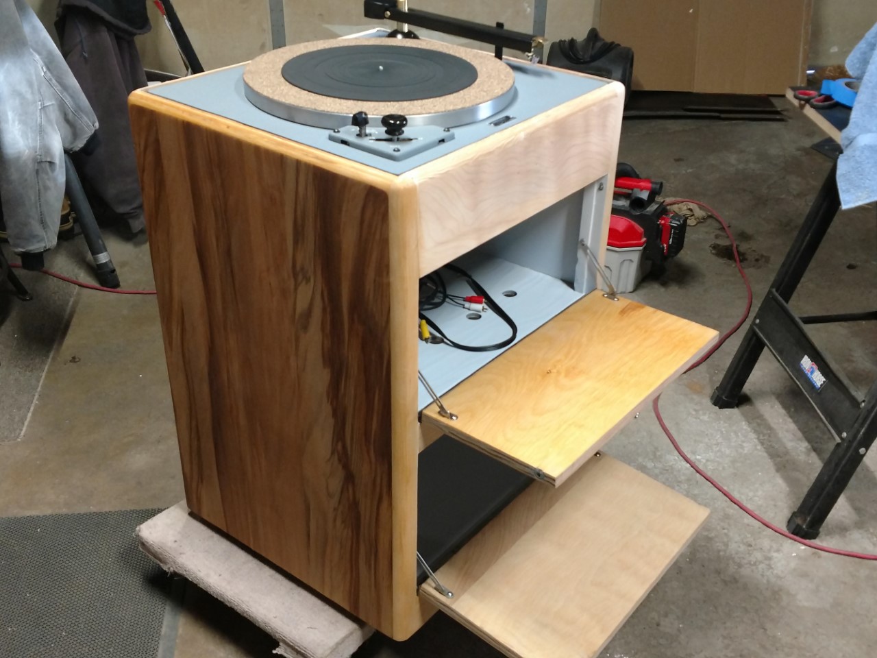

OK, here is the money shot. I didn't know what species it is but Joe at Joewoodworke says it's red gum and after looking around, I have to agree with the veneer expert. The new owner will be proud to display this piece.
So, satin Clear outside, light gray inside.

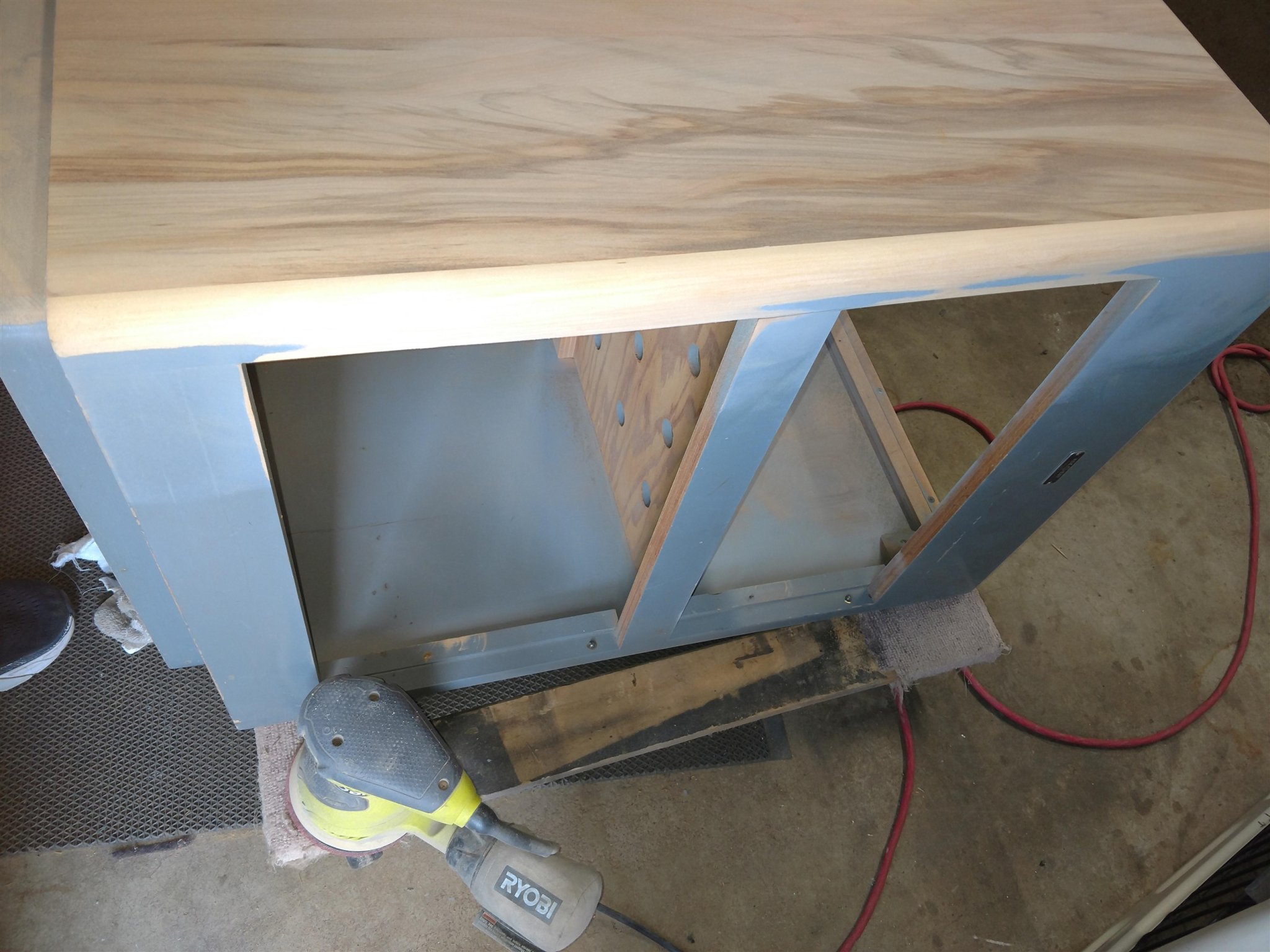

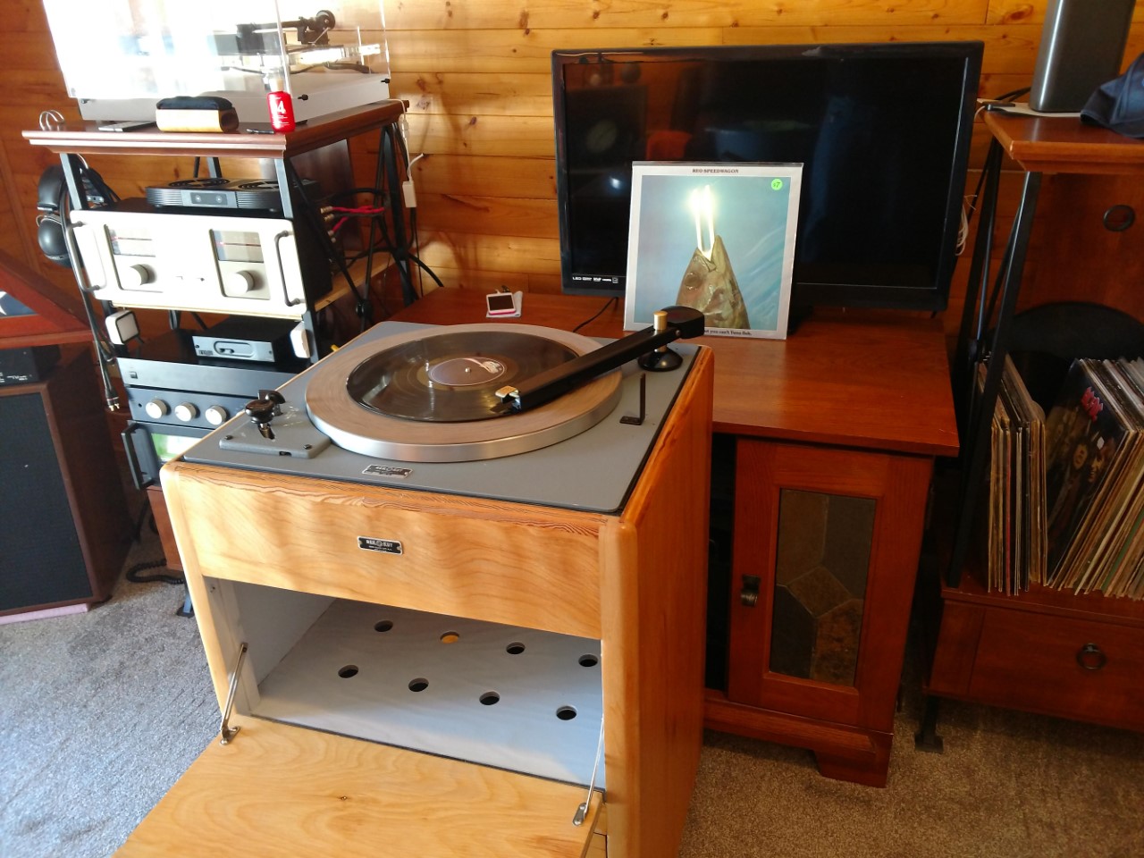

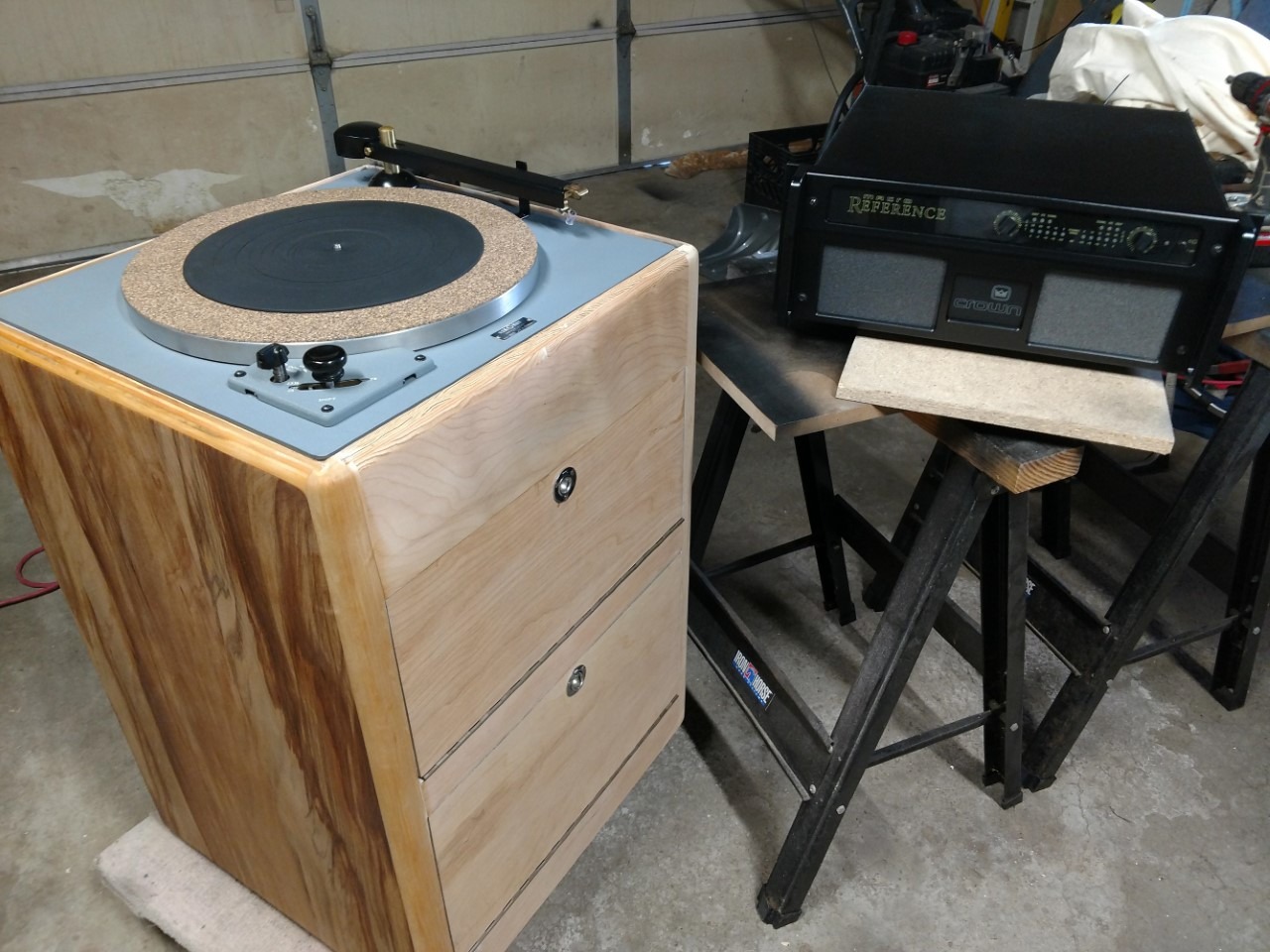

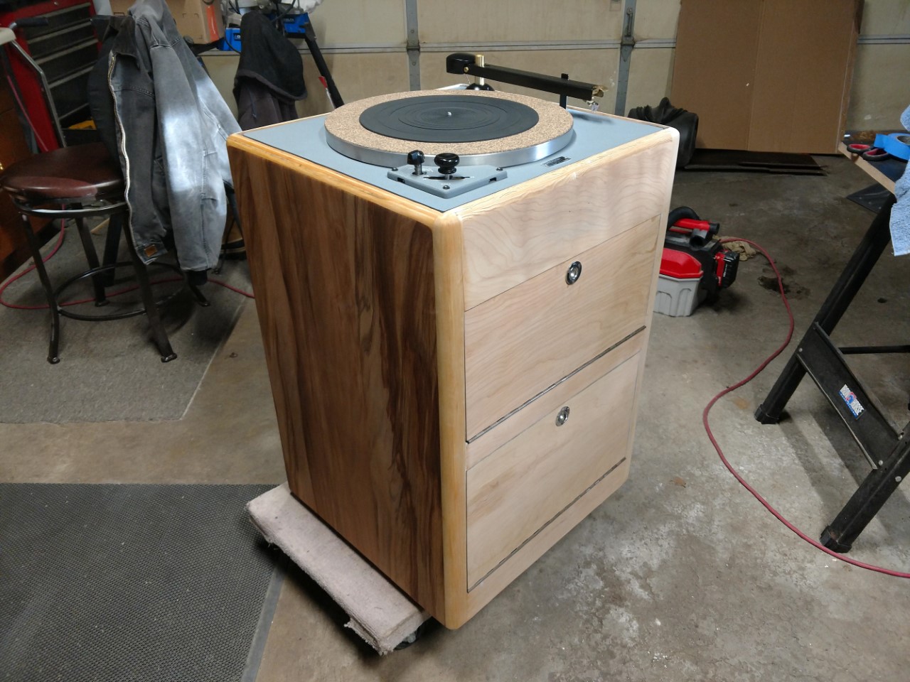

Nearing completion, just a few more hours of work and then it will get posted for sale. I hit the side with 320 grit and gave it a quick shot of satin clear to see what it will look like. I also test fitted the TT to the cab. not sure I like the clear on the inside of the doors but the rest of the interior is Sherwin Williams Lazy Gray.
