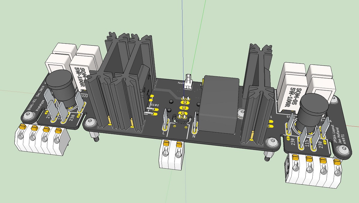

We are working on a soft start now. The SSR protection is a separate circuit - as the soft start is a totally different functionality - it is tied to the AC mains. You don't want your speaker level signals anywhere near that. There are two versions, a simple one for a single trafo with two primaries and a double one that handles two independent trafos, 4 primaries total. They will use SSR's to bypass (short out) a set of 4 parallel 100ohm resistors that will be 25ohm load for the soft start. There will be a programmable time delay 0.5s, 1s, 2 sec period where the SSR will then shunt across the resistors to allow full current to flow to the trafos. The double one will have an added feature of a SCR to permit remote turn on/off via a logic level. We were almost ready to make prototype boards when jhofland found some more optimizations on the circuits so it was back to the drawing board. Maybe another 2-3 days and we can release the schematic and 3d renders.
In the same philosophy as the SSR's, it will be very easy to connect and use. Basically connect 3 wires from your IEC capsule (L, N, E) on one end, then connect your trafo primaries on the other end (AC1, AC1', AC2, AC2'). There will be a way to select 115VAC or 230VAC mains (parallel or series) connections on the primaries.
Hope that answers some of your questions.
Some teaser pix (this is the dual trafo version):
It is meant to mount on the amp front panel (where the trafo normally resides) and has and indicator bi-color LED and remote power switch. You will have your choice of faston spades or screw terminal blocks. The single trafo one only has spades and no remote on/off capability.
