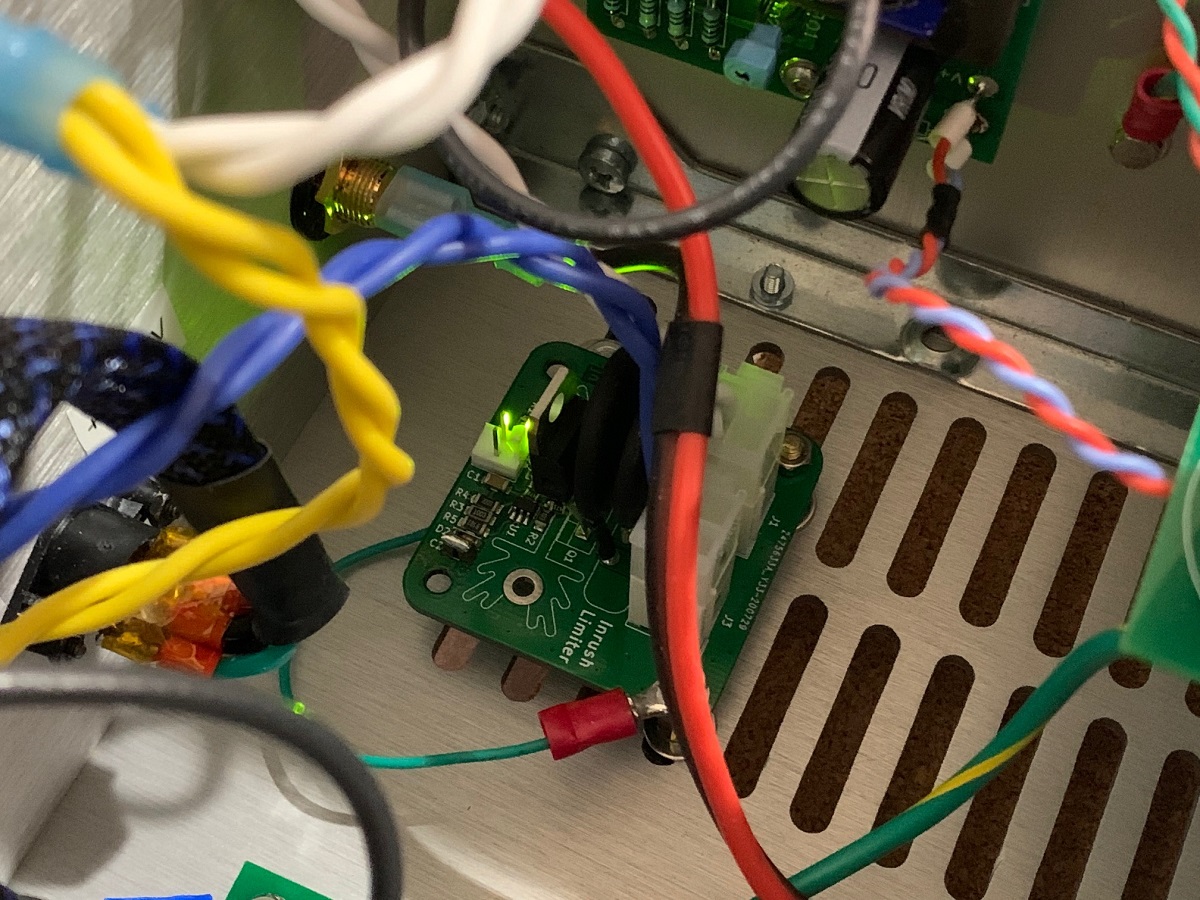

As a relay, I suppose it could work but as it was designed to shut off after sensing DC, that would cause it to not work. However, the same SSR mosfet topology driven by an optoisolator can be used to switch DC can work and we do that all the time. You would only need one mosfet and not a pair back to back for DC.
Here is such a circuit that Jhofland designed for a DC soft start and it can be controlled using +12v or logic on the Molex KK jack. If you want instant turn on, just make the RC time constant on the comparator fast. If you don’t need a soft start, eliminate the NTC.
In my case, I used it in a self-activated mode from its own DC that it controls to act as a soft start relay. This was used in between a SMPS and the amp (the Sony VFET).

As the designer of both the soft start and the SSR I wouldn't recommend them for the DC power switch. Something similar could, in fact, be designed. I would need to know what the supply rails are, the typical currents when on, what levels you want it to trip off and if there are any desired turn on time delays. I would expect you want it to trip off and not automatically turn on again.
Thank you for your answer. Many circuits, including smooth switching on of acoustics to the amplifier and protection against constant voltage at the output, are made on relays or powerful field-effect transistors, and in the event of a malfunction (constant component at the output), the speakers are disconnected from the amplifier. I think it's better that the circuit cut off the power of the amplifier and did not participate in the sound signal at all, even if it was not visible from the measurements.
It depends on what you are trying to protect. If it is the speakers, then it would be preferable to disconnect them from the amplifier, As the speaker protect SSR does. If you disconnect the power source from the amplifier you still have whatever reservoir caps are present in the amplifier output stage providing undesired current to the speakers. If you also choose to disconnect the rails, that may keep the amp itself from sustained damage.
So you would need to have a detect circuit connected to the amp output like the usual RTR SSR, but you want to disengage the +/-DC rails to the amp with a SSR. It will take two MOSFETs, one for +ve and one for -ve leg rail. It needs a latch and reset function. You would not want a feedback loop to turn the amp on / off to oscillate.
