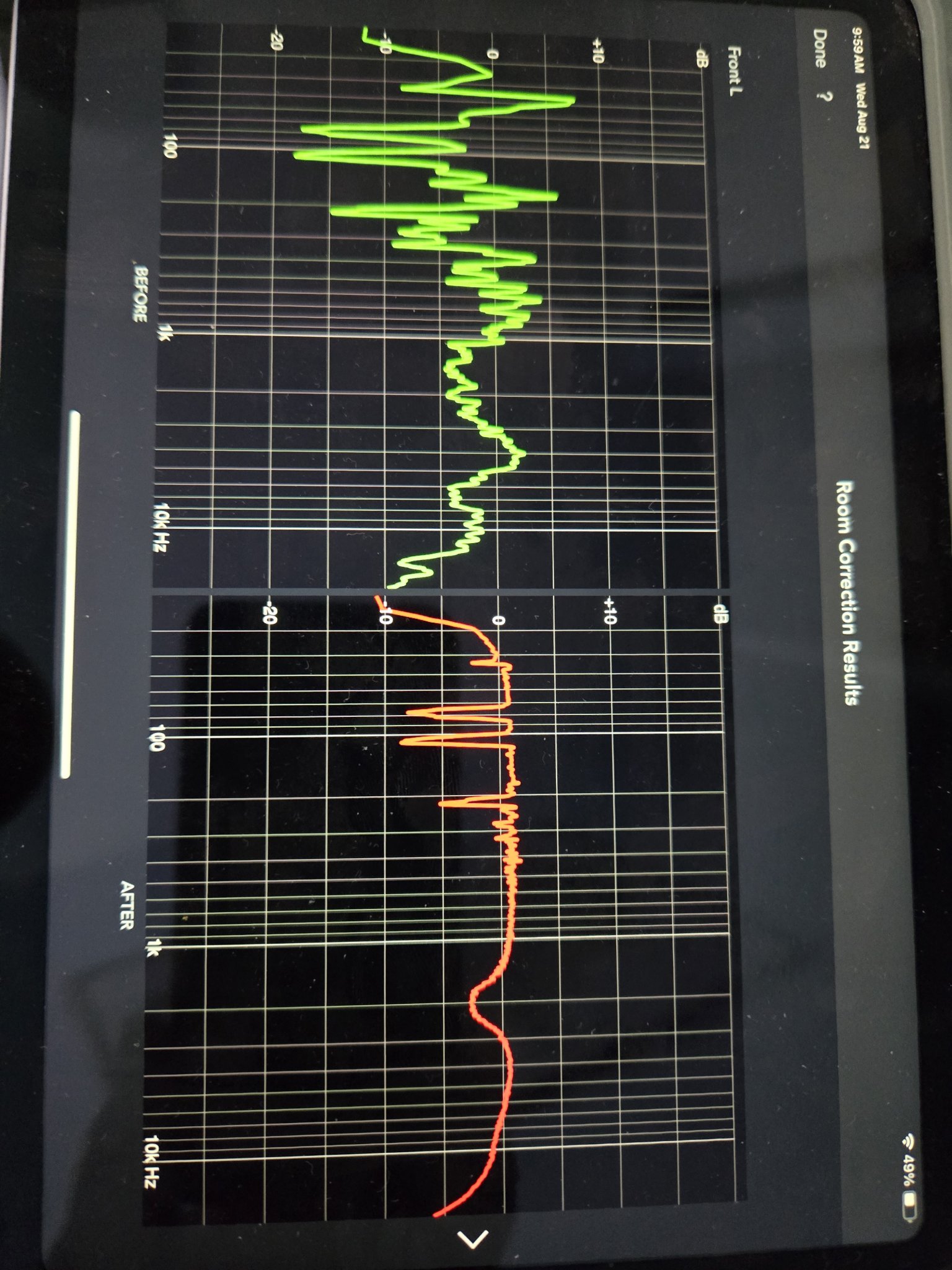

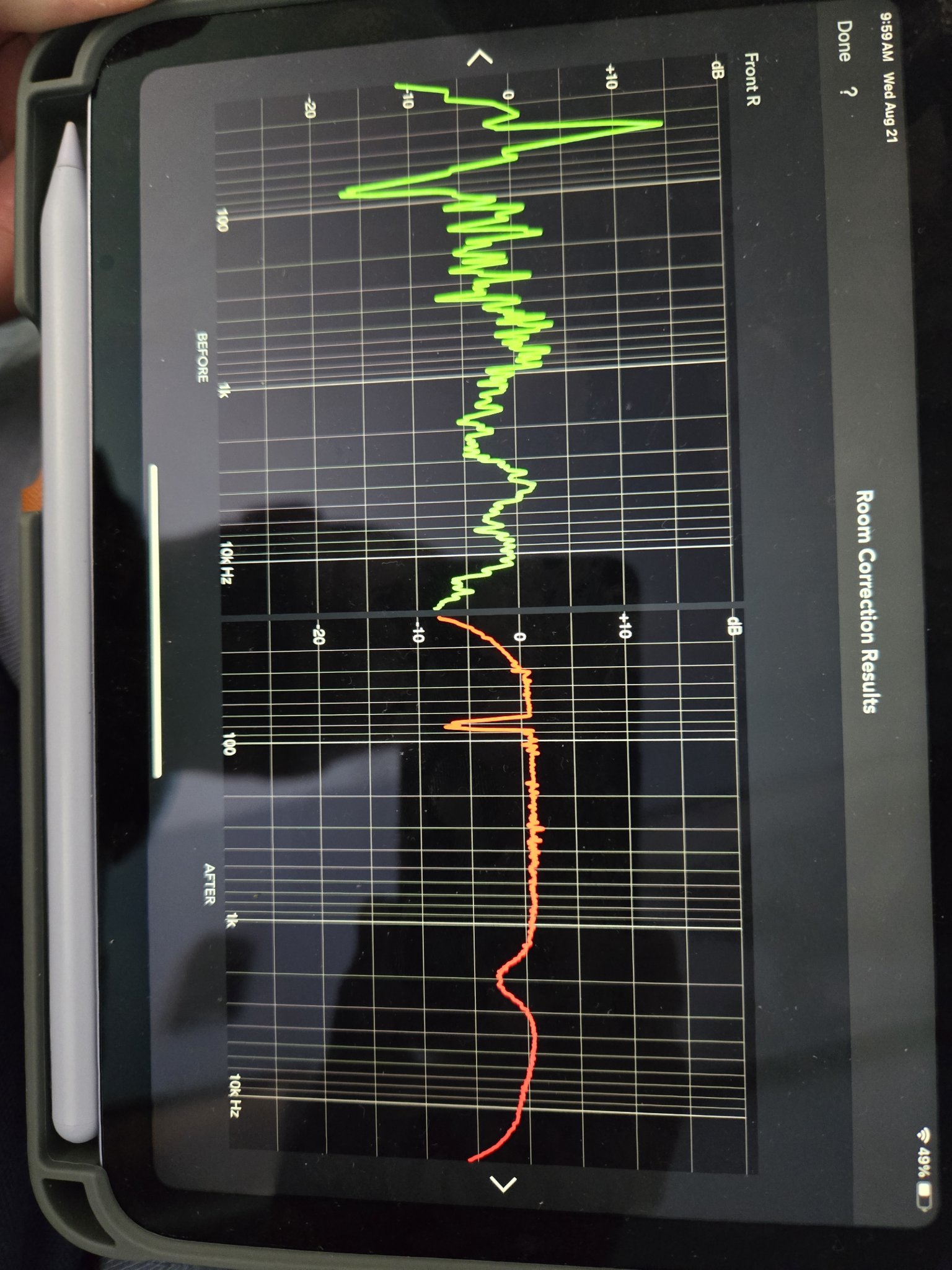

Quick update here: the drivers (and binding post cap) are glued on to the cabinets and I didn't feel like using chisels or putty knives to get the woofers out.
I did take measurements earlier and the in room response curves are telling. Ignoring the ridiculous bass response curve for a minute:
The drop above 5K, especially in the left speaker right above the 4K peak, along with the early roll off starting at 10K aligns well with what I've been hearing. This can probably be EQ'd somewhat but the difference in response amd SPL between the left and the right tweeter seems to further hint at a problem in the driver or x-over.
You didn't mention the measurement details, but if the two speakers were not placed in exactly the same position, with the mic exactly on the same axis and distance, their response will measure different even if identical.That said, I am fully considering that the tractrix waveguide tweeter on the RPs, even eq'd, will have much more directivity, especially at my MLP at 18ft out from my front stage. That said, my observation remains: the tweeters or crossovers in these Contours are either not operating at 100%, the speaker was voiced way differently or this model simply doesn't perform nearly on the same level as the Esotar 3, as implemented in the Heritage Specials.
The direct to reflected ratio at 18ft from the RP280f horn tweeter would be far higher than the direct radiator, far less room influence or difference in upper response would be noticed at a distance.
The measured variations in the response below 1kHz ("the ridiculous bass response curve") makes it appear the speakers are located in different room positions, and the room response is not symmetrical.
That said, your measured response of the tweeters are within +/- 2dB (or less) of each other, I'd consider that deviation in the normal range. Assuming the deviation is from the speakers, rather than the room, I'd be fairly certain the drivers, not passive crossover components are making their response different.
Those frequency deviations and the +3dB 4kHz peak can easily be corrected with EQ, but their directivity won't change.
If you have become used to the horn tweeter's higher direct to reflected ratio, a direct radiator tweeter will lack "presence", the sense of the original recording.
As your wife said, "they sound dull" 😉
As an experiment, you could make a little cardboard 40 degree conical horn like the RP280f's initial expansion and gaffer tape it around the Dynadio tweeter, and you'll hear a big difference in "presence", even when EQ'd alike.

The speaker location and toe in of the RPs was marked with tape and the Dyns are in the exact same spot, but just to clarify: "presence" to me was less about hearing the top end "in the room". I had listened to the Dyns at the same distance I'd heard the Esotar 3s (8ft) and the delta in SPL in the mix, clarity and detail was still far too large to sound normal to me. I know this is "DIY Audio" but cardboard waveguides were fortunately not necessary, after all 😉
After measurements and just a couple of target curve tweaks, I'm happy to report:
HUGE improvement in frequency response and upper frequency (tweeter) presence in the mix. The Esotars blend so much better with the woofers now, the soundstage is improved without the various dips and peaks. Night and day. I still can't dismiss with certainty the possibility that there is some level of degradation in the tweeters or the crossovers but it's a non-issue now with help of EQ.
To me, the Esotar3 is still a clear step up and I think the technical progress behind that was covered elsewhere but these speakers are no longer a "must sell" now. The Dyns do sound "smaller" (vertically) than the RPs and I'm reaffirmed that the former wasn't a bad purchase either (after EQ) but the Comtours sound pleasantly clear, detailed and smooth now and I prefer the mids in them over the Klipsch.
In summary:
(1) I no longer want to sell them (but still might).
(2) RC and EQ = the real MVP and will probably save my marriage 😉

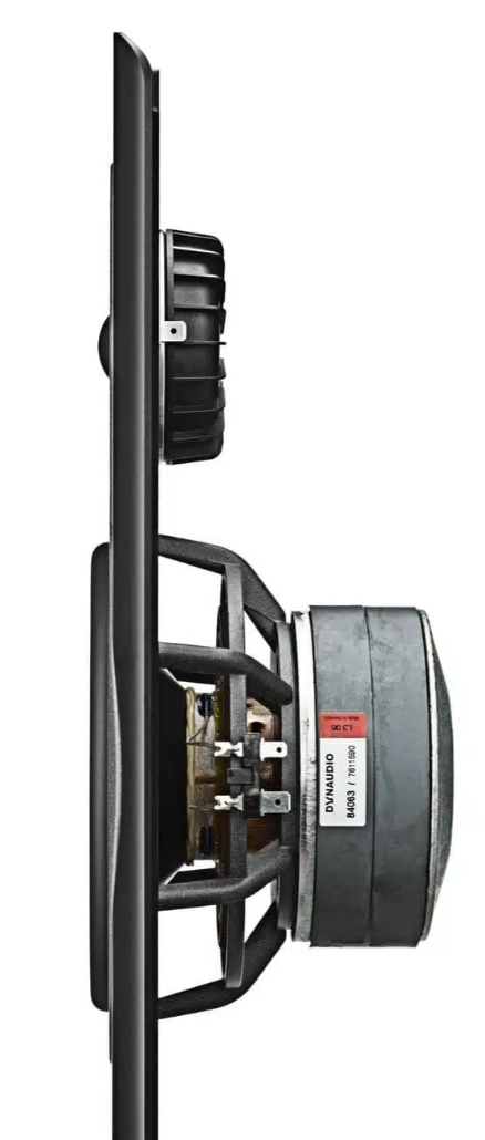

These are the Contour 30i drivers - two bass/mid drivers per enclosure:
I do know that the top-of-the-range Esotar 3 tweeter has a neodymium magnet. Your guess is as good as mine re the loss of magnetic field after a while.
