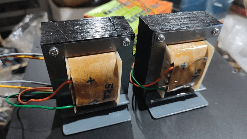

These were well under $200 ea a couple years ago.Probably $250 to $300 today. They were 3.5W UL output using 6P1P-EV and low end Edcor Iron. I believe they were actually better than the iron in the Magnavox amps I have worked with.
CSXE are $42 ea, Power is just over 100, so 250 is probably reasonable for someone who is resourceful.

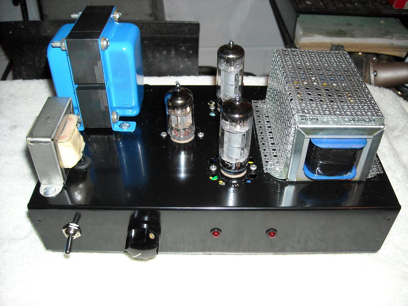

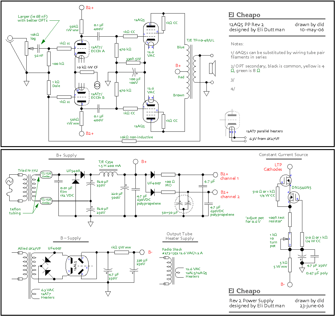

Cheap amps? How about Eli Duttman's El Cheapo design, using 12AQ5 output tubes (basically a 6V6GT in a 7-pin mini bottle with a 12.6V heater), 12AT7 LTP driver, cheap Allied power transformer and whatever output transformers you can find.
The 12AQ5 tubes are still relatively cheap.
12AT7 is the same thing as ECC81. You only need two good ones and they're available from JJ, Sovtek, etc.
You could use an Antek toroid power transformer that would be up to the task.
https://www.antekinc.com/as-1t250-100va-250v-transformer/
$42 (not including tax and shipping) complete with two 6.3V 3A heater windings which could be wired in series to make 12.6V. Or use Russian 6P1P output tubes, which are 6V6GT in a 9 pin mini bottle.
The output transformers are going to be a challenge. You want something like a 6.6k plate-plate primary to 4 and 8 ohms secondary (16 ohms optional). 8k or 10k primary could also be used. 6.6k would give the most output power but at higher distortion. 10k would give the least output power but with better damping and lower distortion. Maybe one of the cheaper Edcor open frame PP OPTs would do, like this one for $58 each: https://edcorusa.com/products/xpp25...utput-transformer?_pos=4&_fid=ce4e8f6f0&_ss=c
For the filter choke, you could use an Antek 3H 250mA part $42 - https://www.antekinc.com/lk-3h250-toroidal-power-choke/
or an Edcor 2H 200mA choke for $34.50 - https://edcorusa.com/products/xc75-2h-200ma-2h-200ma-choke
The rest will add up, of course.
The other problem will be that this would not be a kit with a PCB for you to stuff, etc. You'd have to create the parts layout and hand-wire it point-to-point. It's a lot of work. Make sure you use a nice, big chassis and leave yourself plenty of space.
