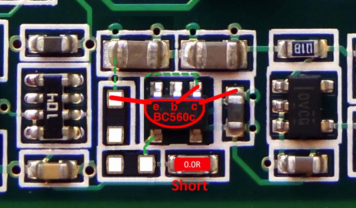

DAM Super Regulator

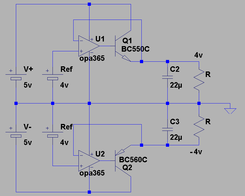

I can make a super regulator simply adding 1 transistor. Is better than a separate power supply and Floating mass.
It is similar to that proposed by AECM but short in the R sensor Instead in feedback capacitor.
The output impedance similar that a Super-Regulator Jung. And haven't oscillation, is stable.

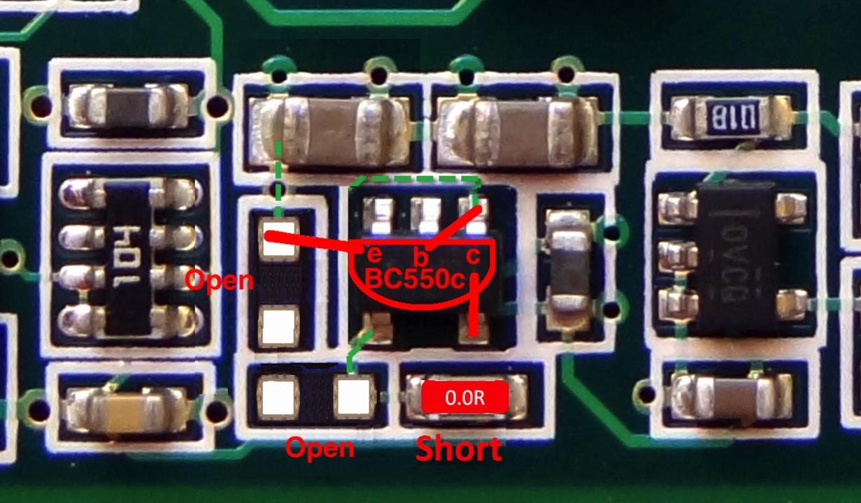

The feedback at the emitter of transistor is a Sulzer Super-Regulator. Provides +4 and -4 vol. Vout Instead of +3.4 and -3.4 vol. Vout proposed by AECM circuit.After several transistor based schemes, I came to a final one. And from my point of view it looks the best one in my oscilloscope. Even better than Soren’s mod proposition.
The last scheme
I used the original buffer scheme, but modify it to become as a pure follower.

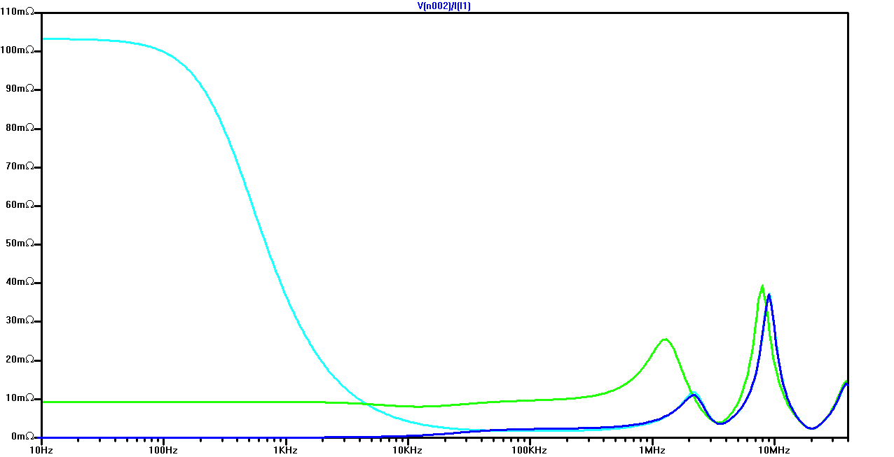

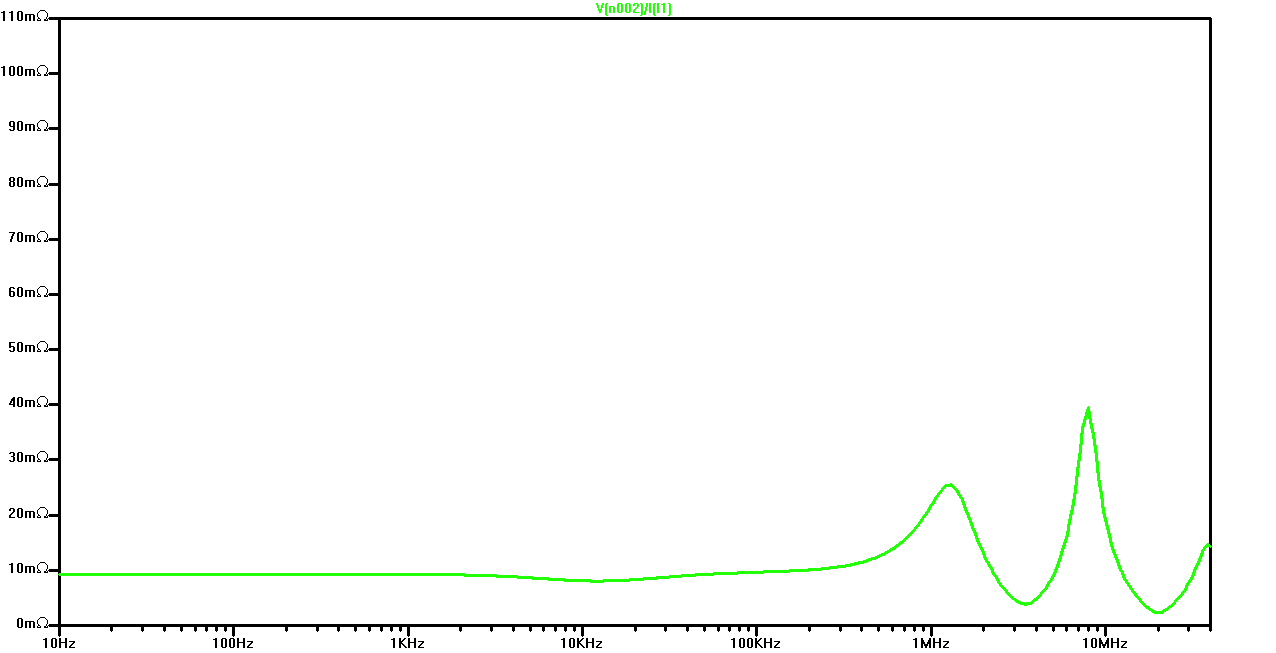

3 MHz. Impedance is made by capacitors.It would be interesting to have the power supply related plots up to 3MHz, as the load of the ladder heavily fluctuates (in a nonlinear way) with the final sample frequency.
I look through the oscilloscope and does not oscillate.

@Oneclock, did you also try simulation with the original 500 ohm sense resistor still in place? It should lead to better balancing of inverting and non inverting input bias current. Also one less component to change...
Yes.@Oneclock, did you also try simulation with the original 500 ohm sense resistor still in place? It should lead to better balancing of inverting and non inverting input bias current. Also one less component to change...
In the impedance simulation is identical result a short or 500 Ohm. Then you do not have to do anything, resistance is OK. Short is no necessary.
This is the correct image.It would be interesting to have the power supply related plots up to 3MHz, as the load of the ladder heavily fluctuates (in a nonlinear way) with the final sample frequency.

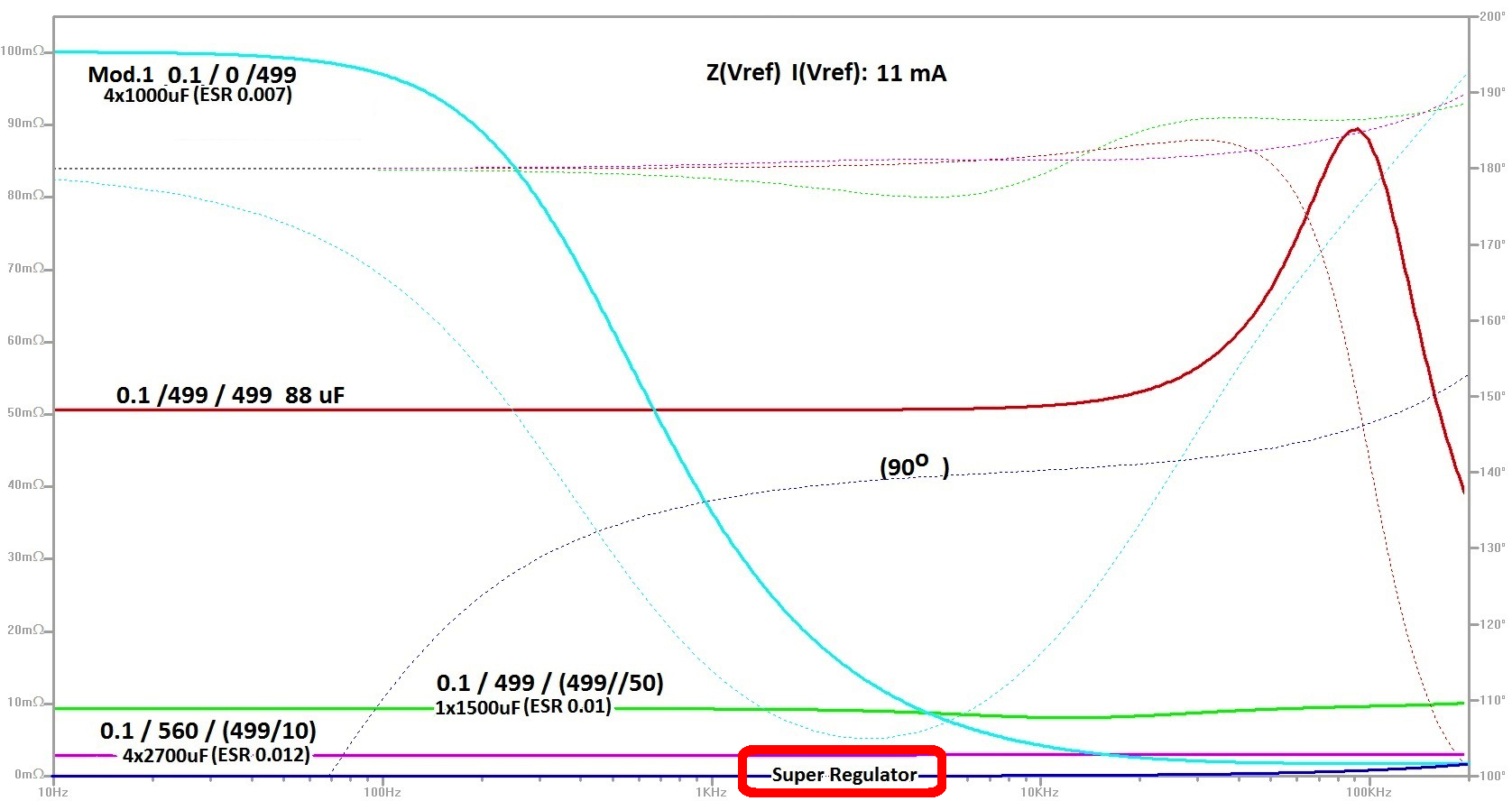

Oneclock,
How is the sound after mod with transistor, if compare it with other mod. Big Step or only improve in figure?
I think it's an improvement.
I will compare with other DAM1021 mod.1 0.1 / 0/499 4x 1000uF (ESR 0007). It has spectacular treble that mod.1. Now also has spectacular bass. But I hope to compare with other people. It may be suggestion.
