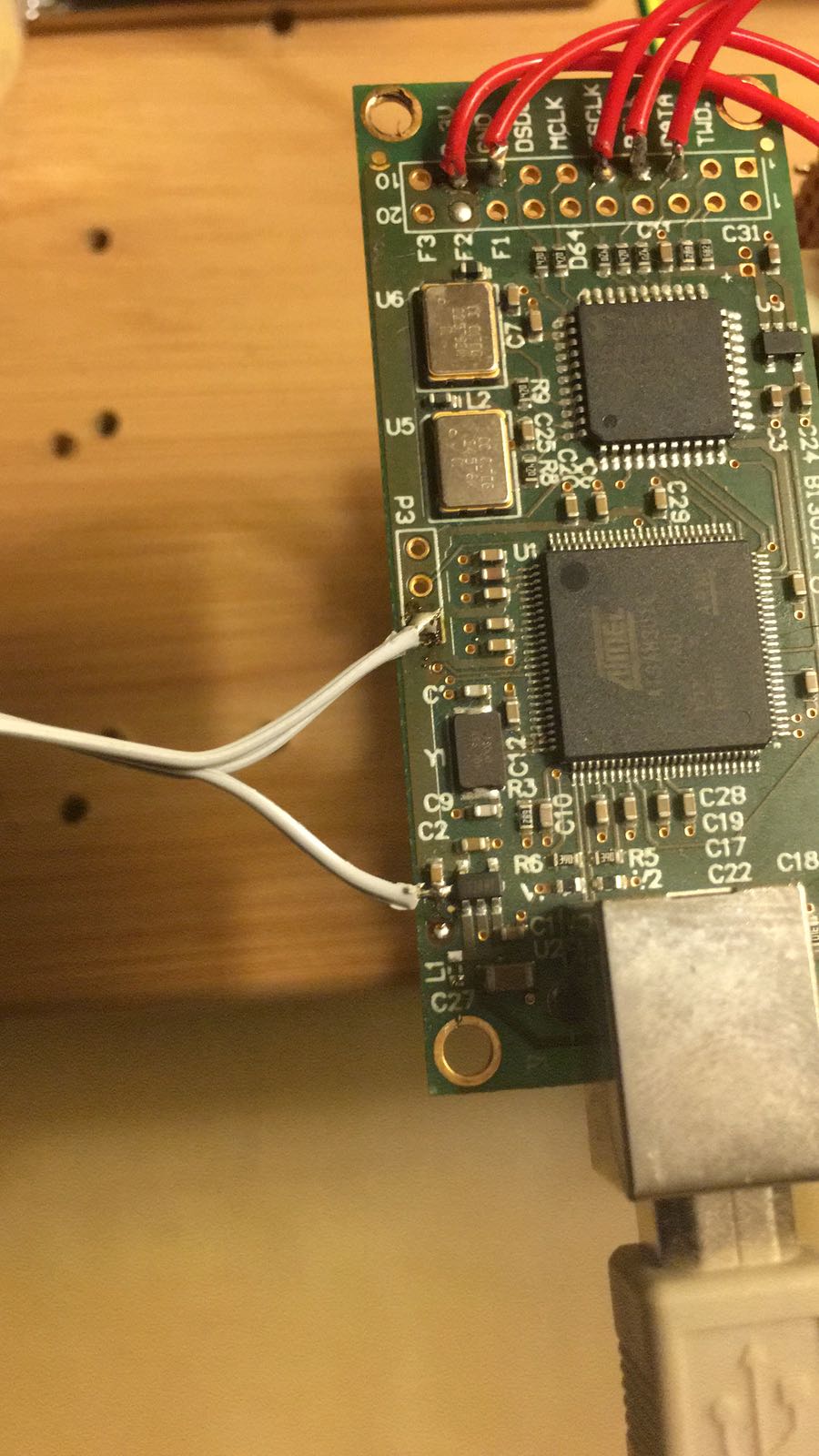

when i connect a 3.3v source to the ISO 3.3 in pin on the Soekros 1021 everything goes haywire. the Reflektor-D stops functioning and the amanero board disappears from the computer. both function alright when not connected to the soekris board 3.3 in. what does it mean?
Do not connect a 3,3V to Soekris.
If you want to power amanero froma separate source, Remove L1 from amanero board and power as you can see in attached picture.
The wire that go to C2 is the ground from aux 3,3V regulator.
Using a low noise regulator for Amanero improve performance considerably.

as soon as connect the 3.3 volt from amanero to soekris iso 3.3 the amanero disappears from the computer. similarly as soon as i connect the reflektor-d to thd soekris bord iso 3.3 the reflektor d's led turns off and reflektor-d stos functioning. there is something abou the 3.3v iso on the soekris board.

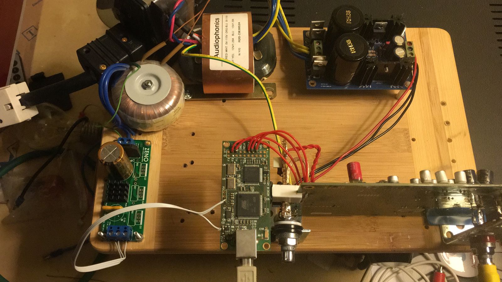

I doubt there is a problem with the dam1021, they're tested before leaving us and my experience is that 99% of problems is due to cabling.... Sounds like you're shorting something.... Check your wires, maybe post pictures so we can look at your setup....

absolutely. i have no doubt that the boards are tested well. it is possible that i made a short without knowing sometime in the past. in the etup now i dont see any shorts or problems and i have checked everything. I will post picturs soon but if there ss in fact damage to the board. is there any fixes or repairs or should i just throw it away?
i double checked. i removed eveery connection except tge 3.3v and as soon as it is connected the amanero stops functioning so the short has to be on the board. all the voltages at j2 are correct. so i only have the +-12 provided at j1 and i read the voltages at j2 and all are correct but when i provide the 3.3 to pin 13 at j3 it is a short.
physically i see no imperfections or problems. and my soldering joints also look very good if i may say so i i have to conclude that i probably made a short at some point that fried or killed the isolation board without any ohysical evidence. soren is there any solutions or is this board beyond hope?

i removed the board from every physical connection. just the board itself and pin 13 on the j3 boards in a physical short with every other isolated ground pin.

You could sent it in for repair, but I would probably have to charge you....
Since there are so few parts on the isolated side, you could try debugging it yourself.... If possible, connect a low voltage high current source (could be a 1.5V battery) to the power pin, then whatever get hot is defect. If that's not possible, lift the power pins on the three isolator chips one by one, pin1 on two of them and pin8 on the middle one, until there is no short anymore, then you have the defect chip. It could be a shorted capacitor, but that's not that likely.
