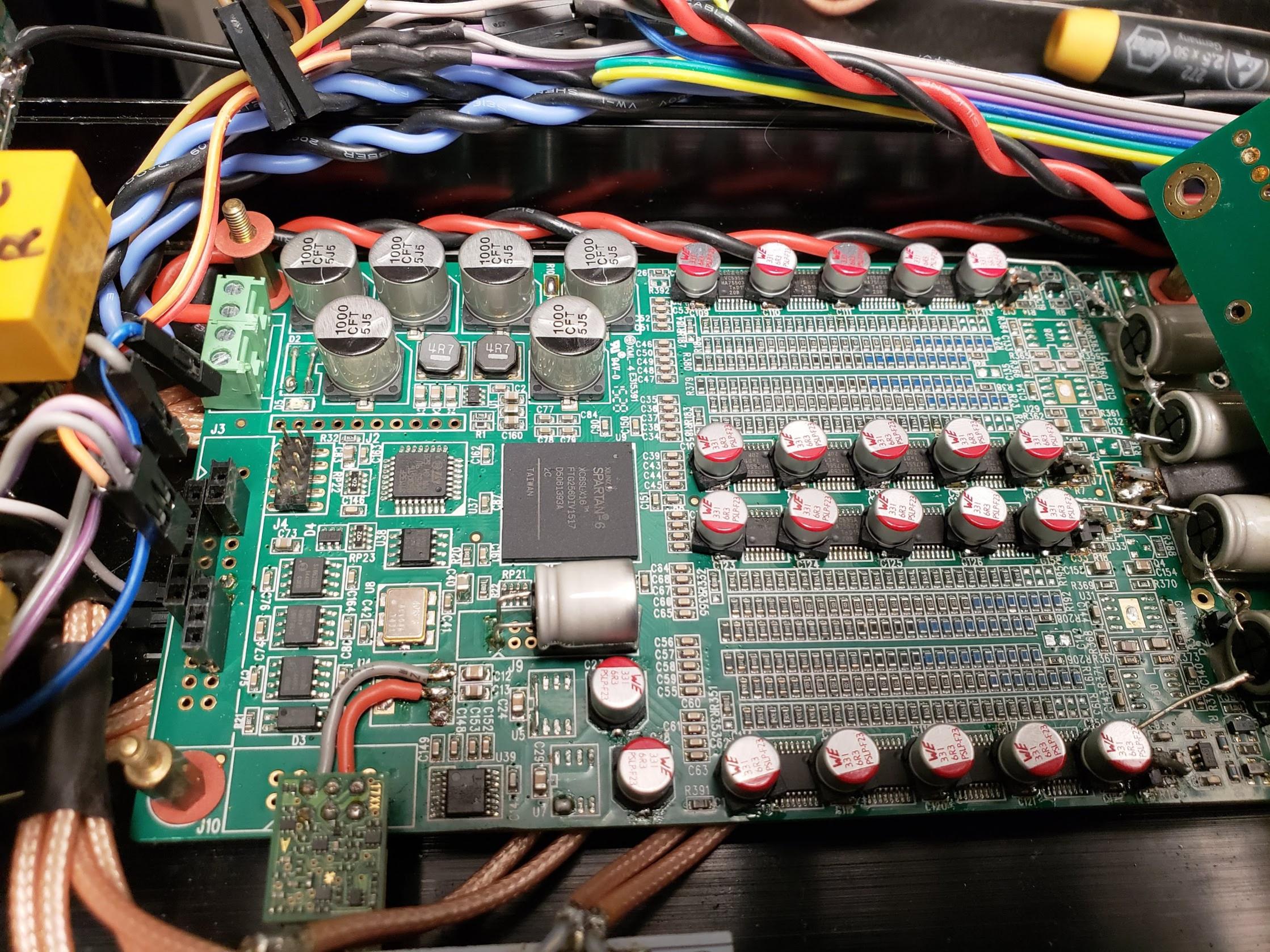

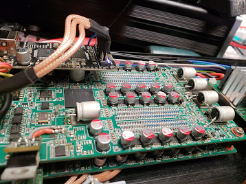

Everything you said, I only did one board so far for the left side, and already there is a significant imbalance in response across the board that I can tell. The bass is definitely more tighter!

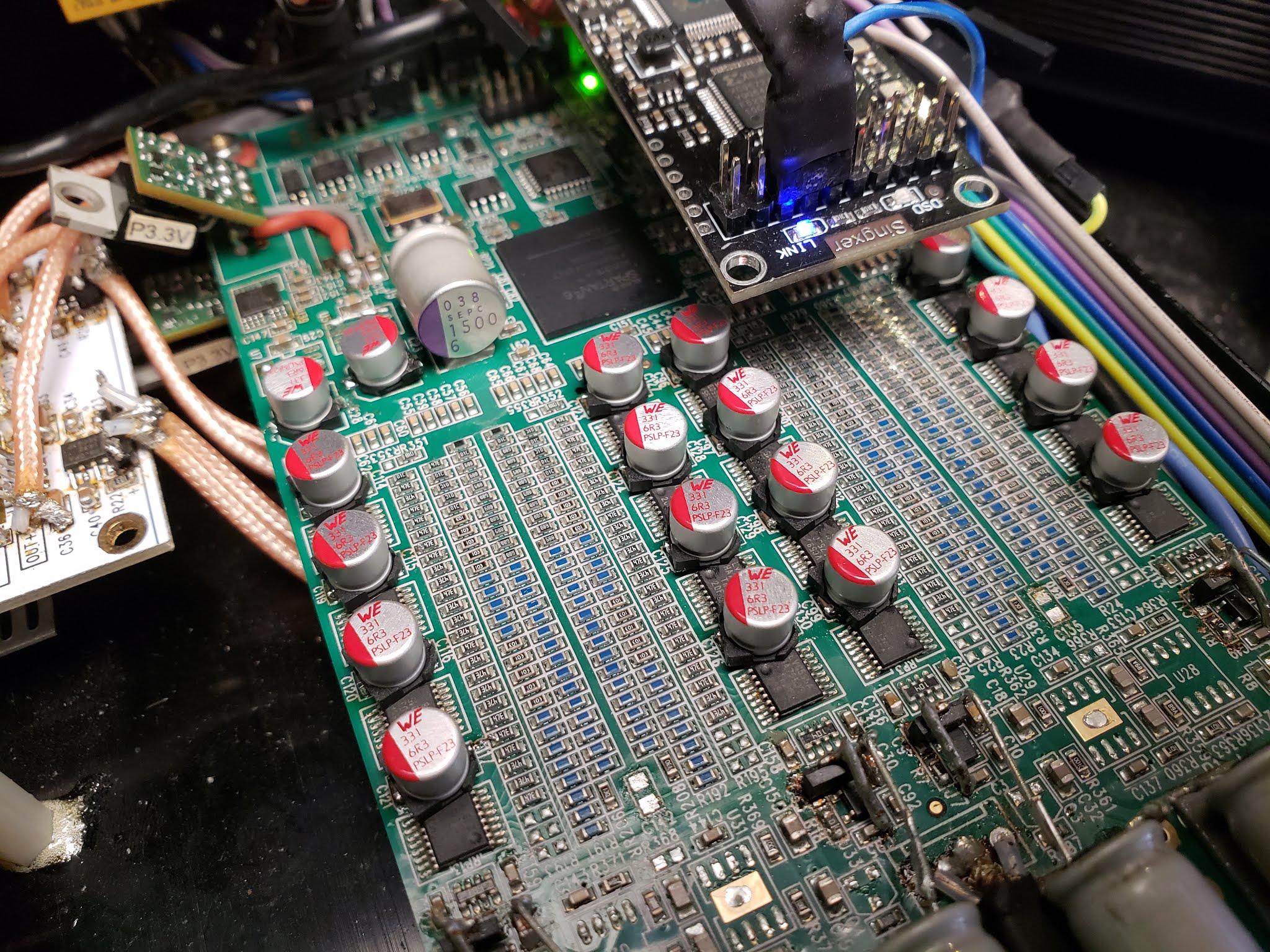

Each cap is soldered directly to the bypass capacitor of each shift register (had no room for the 5th cap due to the vref series pass transistor. If you use the standard 6.3mm spacing it fits perfectly, and the bypass capacitors are slightly taller than the resistor arrays next to them, so the caps never touch anything other than the power pins and substrate of shift register.
Time to do the 2nd board.

Nice! Great to hear that others are benefiting from adding extra capacitance. Am I right to assume that you added 4(now 5)*330uf per rail in addition to the 47uf Soren put in rev2 and a larger electrolytic per rail? Did you also have to do the transistor mod or is that something else?....
I have rev4 so went from 347uf to ~5000uf per rail - the change was nothing short of dramatic. I don’t have a lot of experience (and frankly interest in...) evaluating equipment. But the bass quantity (and at least mid-bass quality as far as I can tell on HD650) has greatly increased. Both continuously powered on for multiple days, the pre-mod bass was very tight and lean, feeling quite wanting, slightly artificial and attracting attention. The mod eliminated all those problems. The deep bass sounds ever so slightly loose with HD650 but it might have nothing to do with dam1021. Like I said earlier, everything is more natural and smoother. It might not make sense but I feel like I’m just hearing the headphones and recording now. If dynamics can be said to be somewhat lacking, it’s not the case anymore, possibly with the help of a much more engaging and natural base.
