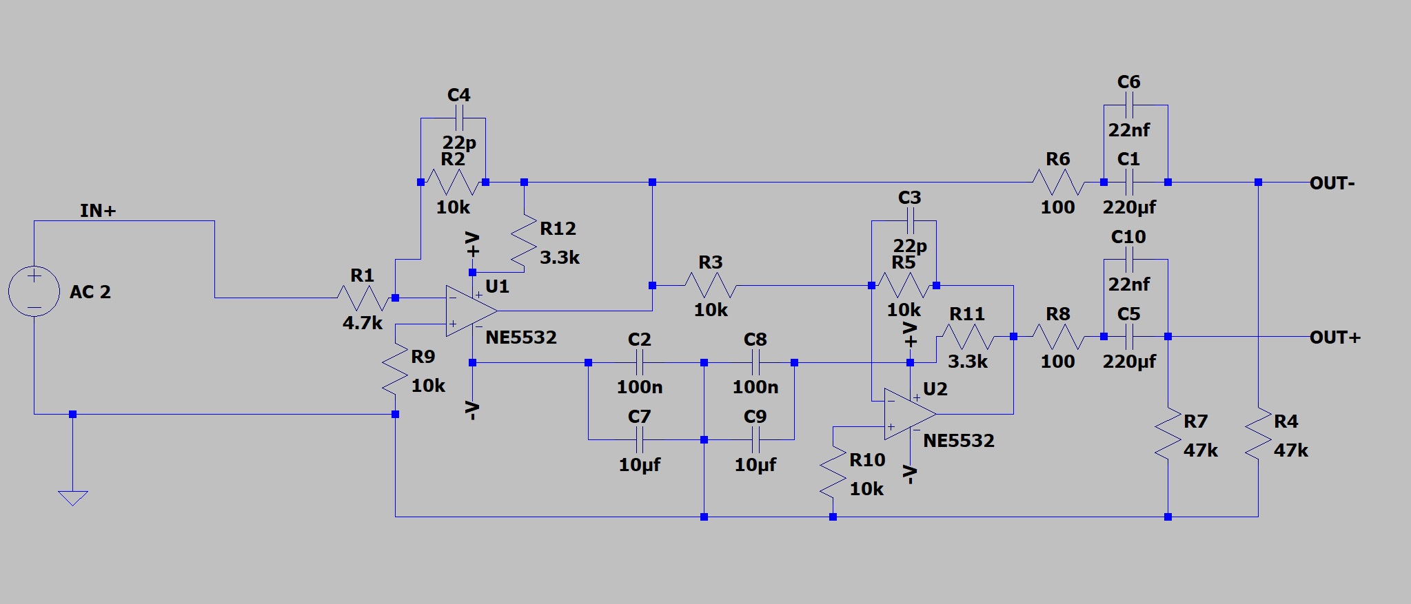

Vital upgrade to the output stage: Resistors to pull the op amps into Class A.
In theory this results in a small reduction in measureable distortion, far below THD of the DAM1021.
But in praxis this gets rid of any trace of harshness and makes for even better dynamics.
My DAM1021 now officially eats for breakfast every other DAC I have ever heard.
Thanks Soeren for the DAC and TNT for the filter. :)
