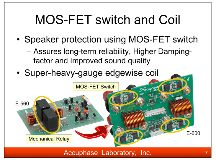

contacts may melt in a fault and short together
the relay you put in place to protect your speakers from amp failure might fail itself, thus taking out the speakers
dc protection with relays
Guess what?
Shocker of shockers, any device you use can fail, Mosfets included. I have seen relays fail to open, but the energies involved were extreme and the relay not selected properly. So let's not point at rare occurrences. You are obviously invested in supporting a Mosfet solution. What I am interested in is recommending the most appropriate solution for this situation.
Show me a great Mosfet based solution and I may use it in new builds or problem situations as long as the price is within reason. Otherwise, relays are exactly the right device to use. It's also what was originally installed, lasted decades and an easy repair.

music, lets say 2 to 3 amps peak, your relay cant cope? no issue with mosfets.
when the amp fails, the current could be 10 amps continuous - how will your relay fare breaking that? no issue with mosfets.
output relays
It seems that the use of MOS-FET transistors is that they need a special PCB to be fabricated, and the parts sourced.
As with any modification, it may need to be modified / tweaked for optimal response, which I feel is above the OP's level of competence.

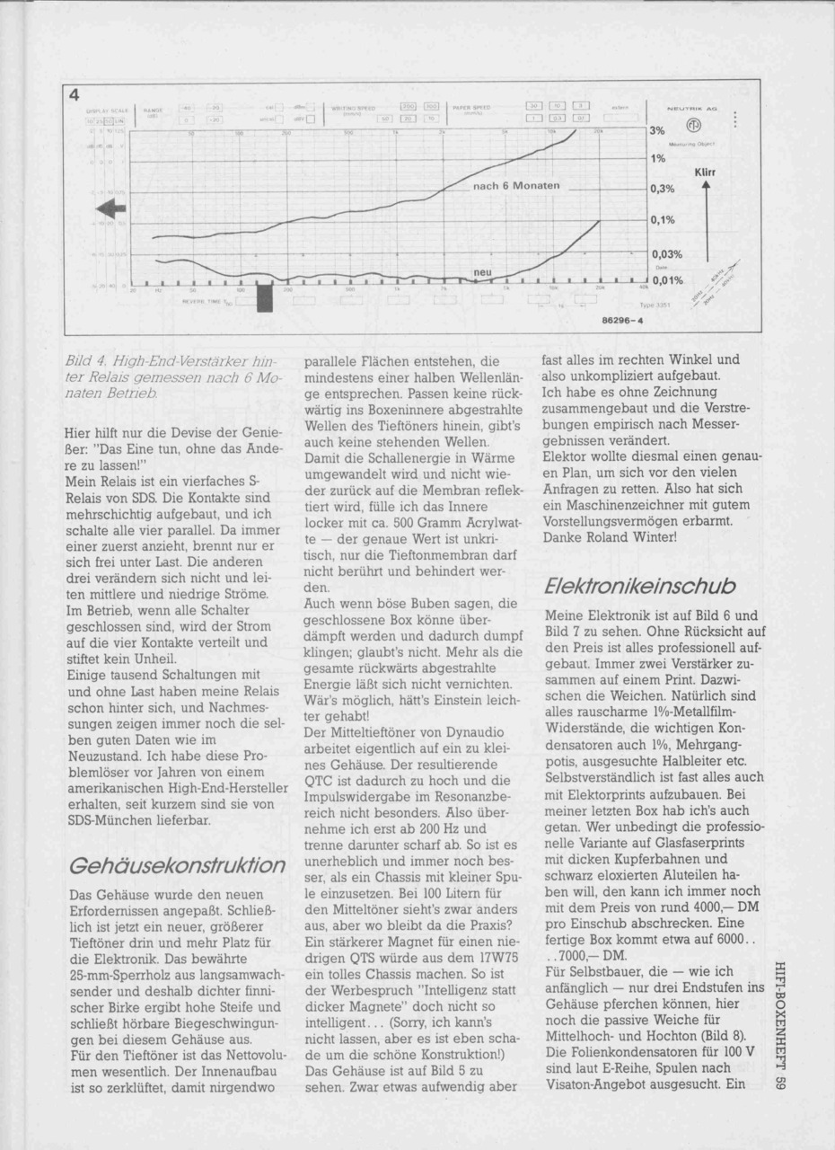

I want to have a good and not too expensive universal speaker protect relay for good replacement in old amplifier stuff (top design solid state relays seems to be the royal way, but mostly too expensive).
If one want to deal with classic designs, i. e. with mechanical contacts, is a version with two contacts necessary, as already recommended 38 years ago in an Elektor magazine - this special edition with diy project: "Die Grönemeyer Box" (author: GJW = Guido J. Wasser) - go to
https://www.hifi-selbstbau.de/index.php?option=com_content&view=article&id=33
In the amplifier-part (German's Elektor "Sonderheft 4" from 1986) was recommend at those days a SDS relay for speaker protect with two different contact materials - one for large signal and one for small signal requirements.
Who know the exact naming of this no longer available relay from SDS and the successor type ?

For new diy projects or more complex modifications on old amp stuff there is the possibility of using two or three independend relays (with its own driver transistor) with different contact materials and with different time delay for contact shorting - or as mentioned before, a top class solid state relay without audible distortion.
But I want for easy replacements in repair service a single relay compare to the old mention version from SDS.
The only current available relay with two different contact-material, which I know, is this one:
https://www.aktives-hoeren.de/viewtopic.php?t=3095
is to find the genuine part of the mentioned article, which you will find in the attached file.
The part of this article from post #1 here in English (some of what I wrote in my previous post from memory wasn't entirely correct in several details):
Guido J. Wasser claim : Relay Contacts: the weak point
The loudspeaker relays are more important than many electronics engineers think. This engineers usually claim:
"Thick contacts - if possible a car relay - for high currents, and gold plated to prevent oxidation."
Looks great but works only at the beginning in the right manner.
After a few weeks or months, the amplifier's damping factor goes down from 100 to 5 or worse.
The distortions have far exceeded especially at high frequencies (Figure 5) and low levels.
When switching under load for the first time, the tiny electric arc burned away the extremely thin layer of gold (check out fig. 2 first datasheet in my previous post).
If you continue to switch at currents of a few mA to amps, the contact will oxidize, but it will burn itself out again and again until it fails completely.
But very high currents does rarely flow; in most cases small currents are present.
Example: A drumbeat with full amplifier power reaches the peak value of 65 volts.
Around 11 amps then flow at the minimum impedance of 6 ohms.
A strong contact with low internal resistance is therefore required.
If internal contact resistance get high value of around 1 ohm, e.g. due to burnout, approximately 85 watts of power loss occurs at this contact;
This means, it becomes hot, resistance continues to rise, and oxidation continues to increase.
Contacts with internal resistances in the milliohm range with currents of around 10 amperes are now easy to create and also remain cold.
However, they only stay clean because the high current constantly burns them free.
At medium volumes of around 80 dB, however, only a few hundred milliamperes flow; In quiet areas the current drops to a few microamps.
Gold-plated contacts would be ideal for this, but unfortunately they burn away immediately at high currents.
The only thing that helps here is “Use both advantages without the disadvantages!”
I recommend a S relay from SDS. All four contacts are realized in multiple layers and I connect all four in parallel. Since one always pulls on first, only this contact burns freely under load. The other three contacts do not change and conduct medium and low currents.
During operation, when all switches are closed, the current is distributed across the four contacts and does not cause any harm.
My relays have already completed several thousand switching procedures with and without load, and subsequent measurements still show the same good data concerning the contact resistance as when they were in new condition.
I have heard this approach years ago from an American high-end manufacturer, and SDS S4 relays in the meantime available from SDS-Munich.
Ref.: Guido J. Wasser, Wasserwerk, Elektor-Plus 4, 1986, page 56 ff
I do not believe for one second the claim of higher damping factor is factual. Same for improved sound quality (true only if the relay contacts are damaged).
What a Mosfet actually does is remove a service item. In my experience, something like this may get close to the performance of the original part, but it is never better. It can only be equal at best. To be honest, the only thing that performed better for sound quality was a direct connection to the speaker with a shorting element to ground for protection (called "crowbar protection"). This does normally short outputs, blow fuses and I have seen it remove large areas of copper PCB traces.
So far any mosfet type connection I have tested has added distortion to very high quality amplifiers. For an average amplifier they may be good enough these days. If I ever test one that does perform as well as a relay, I will report it, and I'll also install them in my own equipment. Haven't seen this yet.
