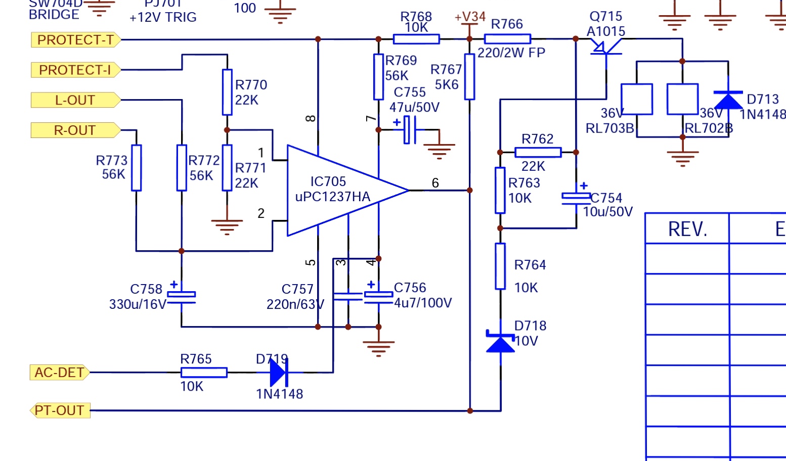

Did a recap in my Nad c272 and after that everything works perfect except the turn on delay... i turns on after 1/2 second and before recap it was perhaps 3-4 seconds. In my opinion too fast.
What component is making trouble? I’ve triple check everything (especially caps around the protectioncurcuits etc)

It will be the cap on pin 7 that sets the delay from power on to relay engaging.
This was 47uf jianhong cap and i replaced this with a rubycon zlj with same value.. hmm.

You should measure the cap which is used at present and make certain its polarity is correct. Of course a bigger cap will increase the delay but apparently something is wrong and needs fixing.

It sounds like that cap isn't discharging after turnoff, or discharging much too slowly. That could explain the symptoms. If it retains some charge then the delay won't work properly. There should be a path to ground through a high value resistor to bleed off the charge, but I'm having difficulty reading that schematic. Possibly that path goes through the "PT-OUT" connection?

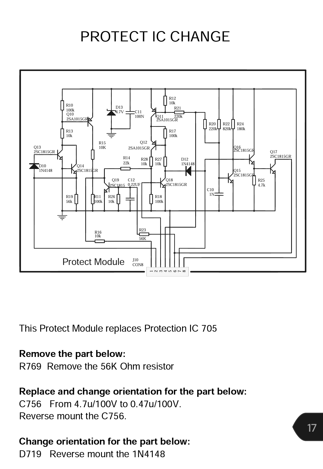

The replacement module eliminates timing resistor R769 (56K) and replaces it with an on-module resistor R24 which is now 180K. The timing resistance has increased by a factor of 3. So the circuit's ability to tolerate leakage in the timing capacitor just decreased by a factor of 3.This unit doesn’t have the 1237 pr chip, its a new replacement from nad
I think it might be a good idea to purchase an 0.47uF 50V electrolytic capacitor which is specifically designed for lowest leakage. Such as the Nichicon "KL" series. Mouser sells them: 647-UKL2AR47KDD.
And as long as you're placing an order anyway, you might as well buy several different capacitor values from the KL series. This gives you the opportunity to experiment with different capacitor values to achieve whichever turn-on delay that YOU like best. Perhaps these seven different capacitors (mouser short-link below). It's completely YOUR choice, of course!

C756 is there to 'lightly' smooth the raw AC from the power supply, it is not a used as a timing cap as far as I can see. It is just to provide an indication of AC being present or not and presumably allows a fast drop out of the relay on detecting power off.
I notice they say that if the module is fitted then the diode and cap will have been reversed in polarity... however the PCB is possibly marked for using the chip.
Have you fitted C756 correctly with regard to polarity?
C755 is the timing cap and Mark does makes a valid point over leakage although I wouldn't really expect an issue with good quality parts.

Why not refit your original electrolytic cap back in place for C755 as a test. It has to be something you have changed during the recap that it objects to.

The cap voltage has to reach a certain value before the relay will operate and thinking about that I would expect leakage current to slow things down and not increase how quickly the relay cuts in.
Don't overlook other issues such as open print at that cap. Check continuity from the leads to the parts of the circuit it connects to. It is very easy for a solder pad to come away from the print with a hairline fracture.

Check if the main supply capacitors are fully discharging when powered off. If there is any residual voltage on the main supply, C755 will not discharge giving the short delay that you are seeing. You might need to fit bleed resistors across the main smoothing capacitors or wherever the +34V is coming from

Maybe the original cap wasn't all that good and the new cap is actually giving the correct delay.
It's a bit hard to work out exactly but around 1 second or less looks about right the more I look at it.
Here is a quick simulation showing the rail appearing at 1 second in and the final transistor turning on at 2 seconds in. So 1 second delay in a basic simulation.

The formula for working out the delay is in the datasheet
With the values present, it should be 2.45 seconds
