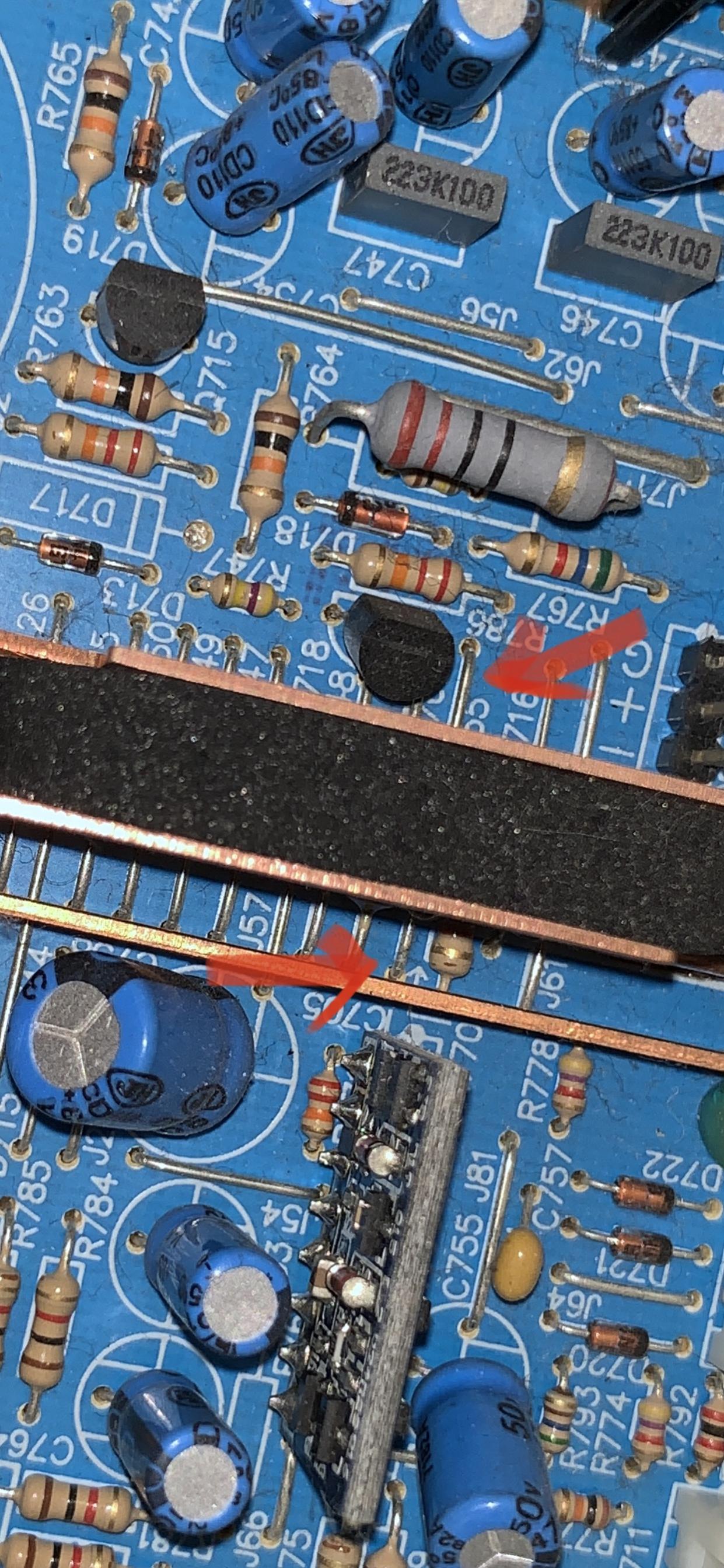

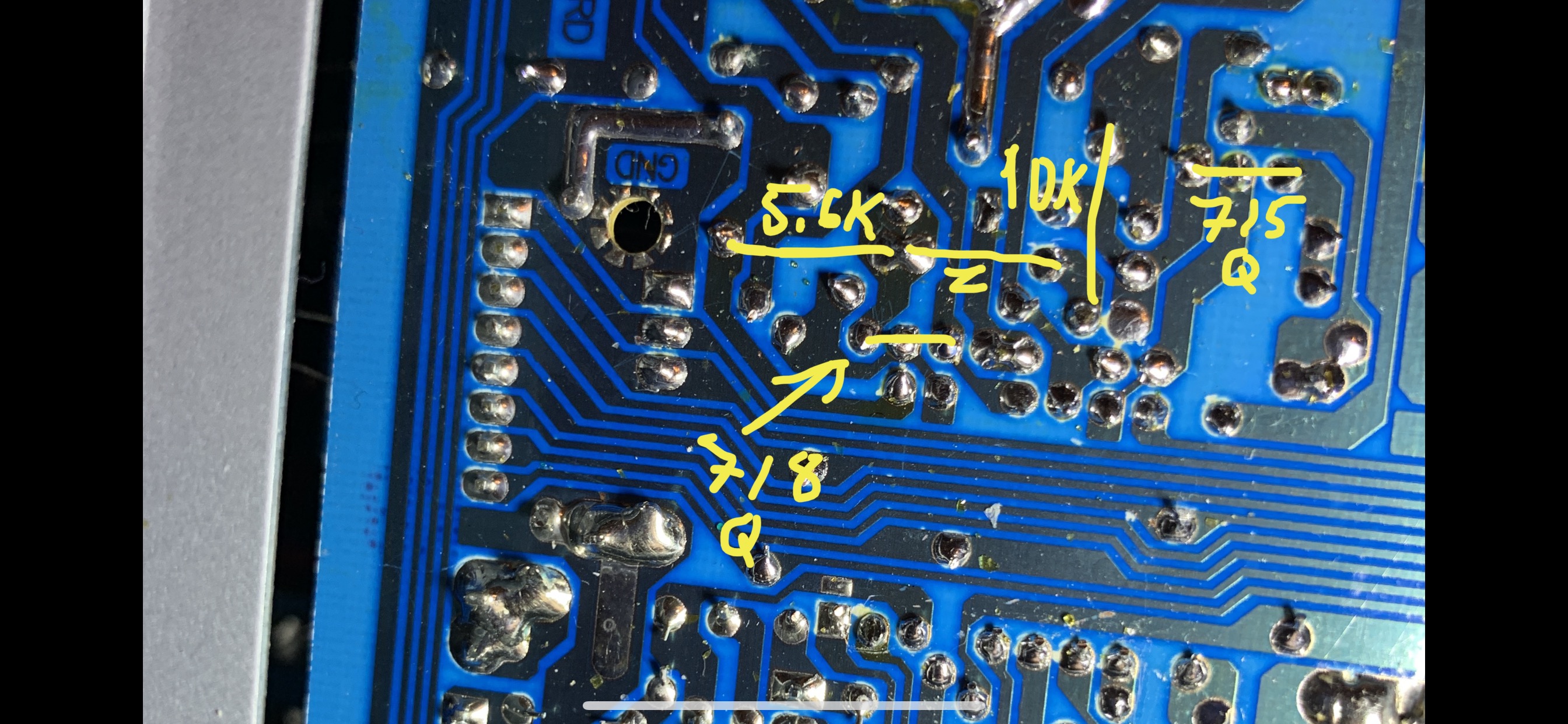

I can’t see another path for pin 6. It just ends there. The ”arc” is from my soldering/ solder wick.
It can not work as it is 🙂 Try and trace the Zener and see where that goes. Does it go to that empty pad?

It's not easy working from pictures I'm afraid. I can't easily decipher much from that tbh.
That looks a different board anyway... is that just off the web? I can see pin 6 is isolated on that one as well which if so I agree is very very odd indeed.

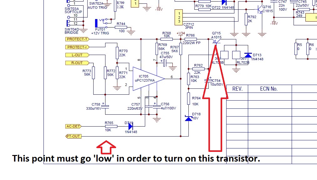

I know my theory is good on this 🙂 and that as drawn in the circuit diagram the line marked PT-OUT must go low. Pin 6 performs that function.
If pin 6 is left open then all that circuitry does nothing. The DC offset inputs, the overcurrent inputs, AC detection and so on. All these feed into the module and the module operates the two relays in response to the correct conditions being met. Does that make some kind of sense?

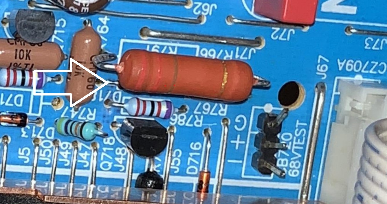

Yes it is D718, thats ”Z” i made in the upper picture. An now those pics i’ve taken myself

Old pic but only i had to show the jumper... found a jumper to that pad (i think) will check more soon! That connects non ring side with a 5.6k (R767) but in between the jumper goes down to pin 6 but really the other side on the pad it looks kinda flat.. hmm have to check that really closely
Yes, prove by continuity checks and visual inspection and see where the junction of the Zener and the 5k6 go.
The circuit clearly shows they go to pin 6. I looked at the chip data sheet (the manufactures sheet, not NAD's) as well and the pin outs match for the chip and discrete module match as they should.

Yes there is a jumper going from that ”pad” over to junction 5.6k and 10v zener. Just checked it
So does pin 6 of the module have direct continuity to the Zener? That's what I need to know.
Yes or no 🙂 Everything hinges on that.

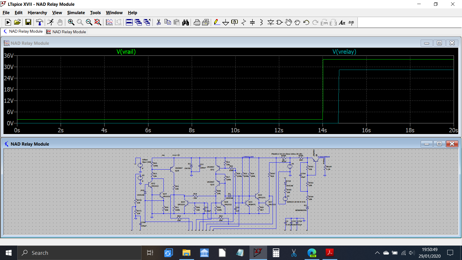

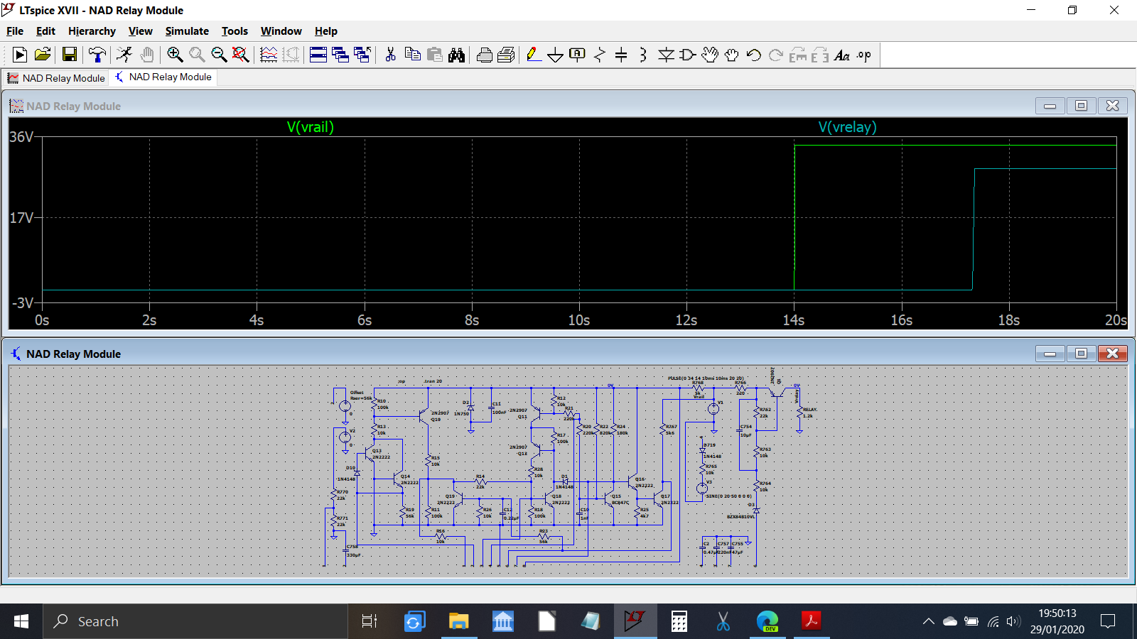

Just for curiosity... and this is very interesting... I tried the simulation beginning with the rail voltage at 2V and and then switching it to 34V. The initial charge that the 47uF gains while the rail has a small residual voltage absolutely kills the delay time to about 0.7 seconds.
Here are the two charts. On the first the rail starts at zero and then comes up to 34 volts. On the second it starts at 2 volts before coming up to 34v.
You can see the difference in delay time very clearly.
The big big question though has to be WHY the recap has altered the behaviour. Did you stick to the original capacitance values?

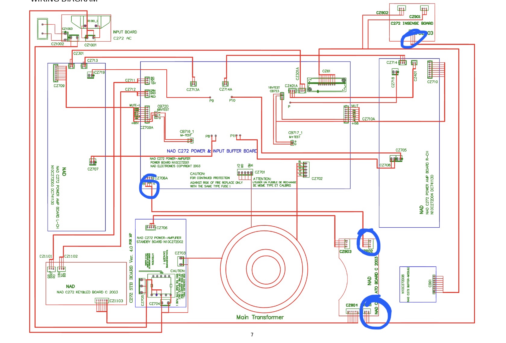

Also discovered something else regarding that main power switch (or vacation Nad likes to refer to)
I attach a pic to show what i did. Back in my head somehow i think this relates to that Ato board and how it interacts with the process.
If i pull the cables circled with blu and then attach the powercord without touching anything else the amp will start up and relays will click on. Also the ”sense” led in front will shine. �� how the heck is that possible.
Tried to measure voltage from standby board but only reading i could get was +2.5v. Went through it and replaced the regulator, (7805) zener, well everything actually. Carefully checked everything. Same thing, same voltage. This is when connected to ato board.
On the ato board i saw a resistor that was wrong value, suppose to be 10k but it was 1k. (my mistake) This was R819. Now the delay is somewhat shorter. Perhaps0.3- 0.5 sec slower.
I have rechecked everything along this but nothing. Can somehow this big ic (74hc14?) be damaged from esd?) or the other 2 big ic’s?
On the older Nad c270 there is no ato or sense board but everything is thr same and there the 5v supply from standby board will go directly to main psu baord (aka protection curcuit) thinking trying to hook that 4-pin directly there but afraid i will screw something up.
Update: If i pull only the cable to sense board the standby relay will click. Also weird.
