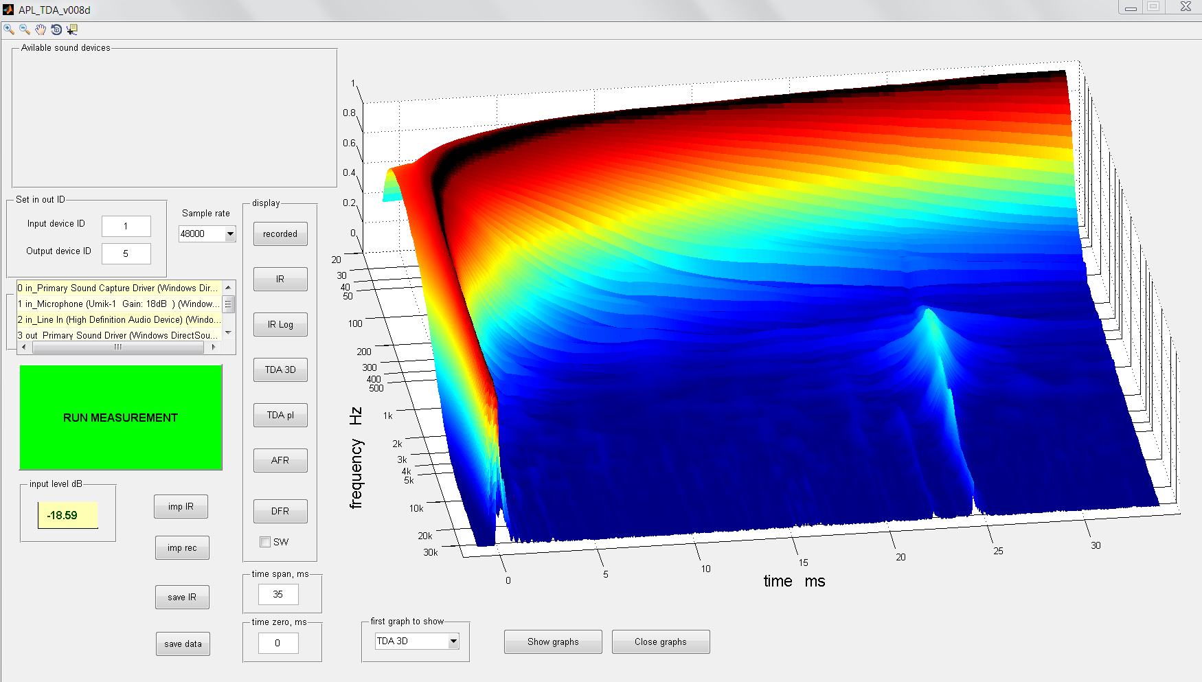

The end result as seen in APL_TDA is this:
Measured with a stereo pair, not at 1 m, but at the listening position.
I tried more than one phase correction, this one is a band pass correction that I ended up enjoying the most. Flat phase down to DC sounded weird on a couple of songs. The sense of timing was best if I followed the band pass behavior of the frequency response.

APL_TDA is developed as a timing tool. It shows the peak energy curve at the microphone and it's timing. I would not call it a CSD graph specifically, though one can see the arrival of the frequencies at the microphone and the later arriving reflections within the room.
As is, it sort of presents a map of the room seen from the perspective of sound arrival at the mcrophone. The APL_TDA graph I posted was measured with the demo version (screen grab) at a time when that software was introduced on DIYA by it's creator.

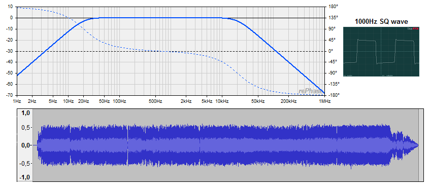

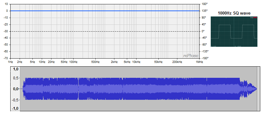

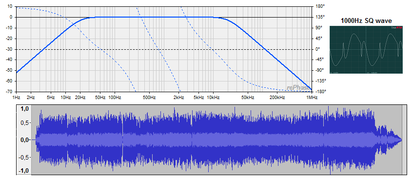

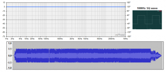

Regarding phase distortion talk yesterday and the hand waving 🙂
Try listen this youtube track on flat phase verse with rotating phase caused by XO points, as pos tell its not night and day in AB tests but for me the flat phase is more real like when i play guitar myself.

Original 5dB dynamic track run thru neutral Rephase convolution filter just to investigate Rephase filter is clean and dymamic range stays exactly the same 5dB:
Original 5dB dynamic track run thru Rephase convolution filter that expose track to stop-bands at 20Hz / 20kHz, which increase tracks dynamic range from 5 to 7dB:
Original 5dB dynamic track run thru Rephase convolution filter that expose track to stop-bands at 20Hz / 20kHz plus 4th order LR XO points at 300Hz and 2kHz, which increase tracks dynamic range from 5 to 11dB:
Above observations was done using JRiver "Disk Writer" tool to convolute tracks, and "Analyze Audio" tool to get DR numbers, and before process had to lower track level in Audacity by 6dB else processing would show red overloads in Audacity window, which in a way scare me and makes me think i wanna start my first point in DSP engine by lowering level by 6dB, pos is welcome comment on that point and what is happening : ).
Can we conclude from above that if final mix engineer or users monitor track via multi way speaker we have 11dB DR and if we monitor via head phones or nice system as wesayso's line arrays we listen 7dB DR ?
