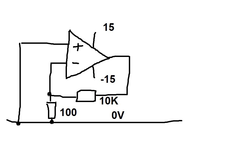

This is understandable. I want to check 4562 for originality. Is it possible to do this using this scheme by looking at the offset?A 4562 should work in your original circuit
Originality... things to check are the current consumption into each supply pin which should be around 10 to 12 milliamp. Some lesser opamps like the 4558 or 1458 are much lower.
A check on bandwidth is an essential really using a scope and signal generator with the opamp configured as a proper gain block. Square wave testing is very revealing.
Another check is DC offset with the opamp configured similar to your circuit but with the 100 ohm removed and the 10k shorted out. The offset should be really low. Now add a series resistor to the + input (such as a 1 meg) and check the offset. I would have to calculate what to expect using the data sheet but it should be much lower than for example a 5532. The offset is caused by the input bias current developing a voltage across the 1 meg and the 4562 bias currents are magnitudes lower than a 5532 for example.

In general, I measured my 4562. The supply voltage is +/- 15 volts. The positive inputs are closed to the zero wire through a 1 MegaOhm resistor. The negative inputs are closed at the output. The current consumption in such a binding of both op-amps = 10 milliamps.
Offset at the outputs:
Op-amp No.1: 1st channel: -2.3 millivolts, 2nd channel: +4 millivolts.
Op-amp No.2: 1st channel: -9 millivolts, 2nd channel: -17.6 millivolts.
What do you say, dear ones?
It sounds in the right ballpark.
Data sheet gives 10nA as typical input bias current (but can be up to 72nA worst case) and that would develop 10E-9*1E6 across the resistor which is 10mv. I just tried it for real with a 4562 and got +8mv and +6mv at the output. I would have expected the polarity to be consistent though.

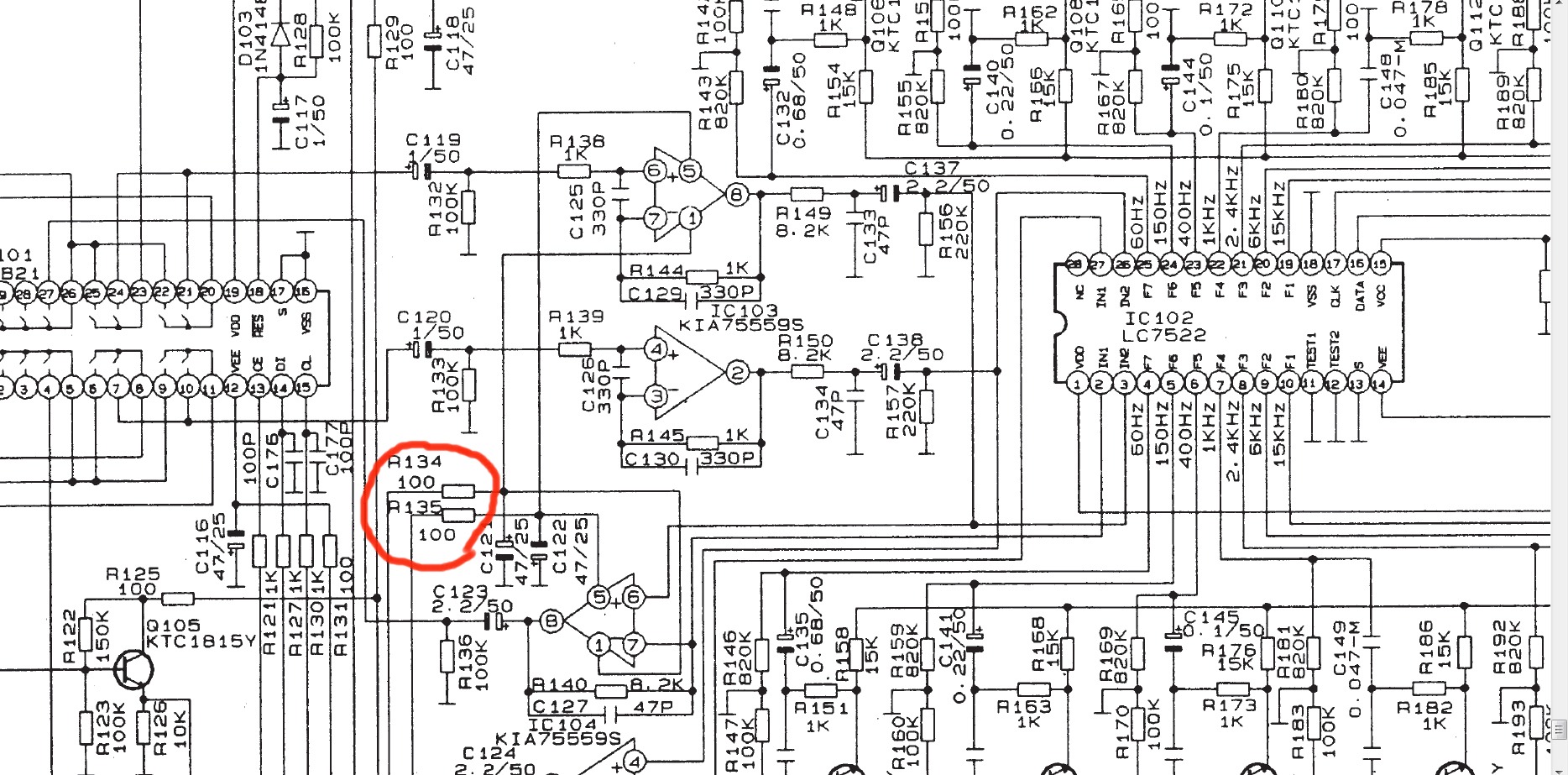

Ok, thanks.Yes, it's a low pass with F(-3dB) ≈ 34Hz so it will reduce supply ripple significantly.
Hm... Is it possible to increase the capacitors C121/C 122 to 100-220 uF?Yes, it's a low pass with F(-3dB) ≈ 34Hz so it will reduce supply ripple significantly.
