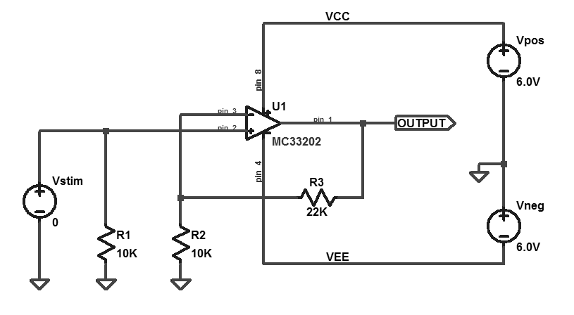

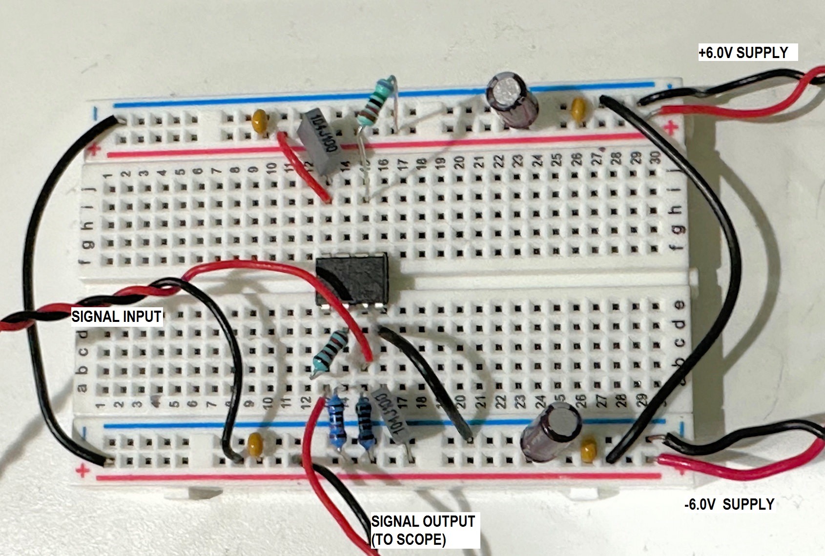

I happen to have a dozen MC33202 dual opamps in my parts drawer. Datasheet attached below.

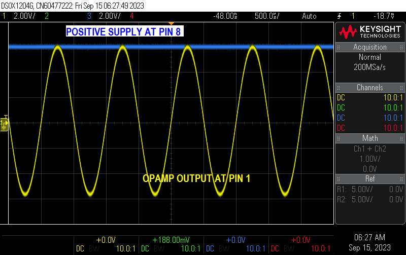

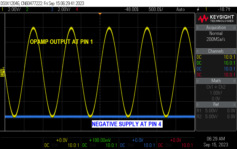

I got out my solderless breadboard and put together a little noninverting amplifier with a gain of +3.2 volts per volt; schematic and photo below.
A bit of fiddling with the signal generator's amplitude setting, allowed me to take the two scope photos shown below. The output signal on my solderless breadboard swings all the way up to the top rail, and all the way down to the bottom rail. OnSemi's datasheet talks about this, for example, in Figure 9.
Well - colour me surprised! I really was not aware that a bipolar opamp could do that.

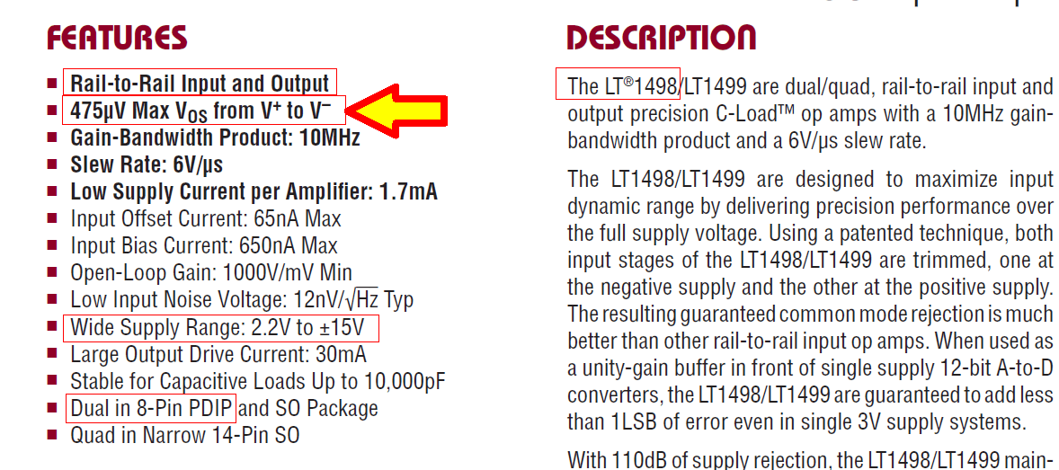

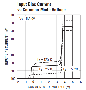

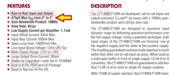

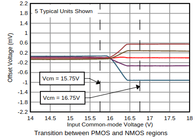

@Mark Johnson, LT1498, not that impressive. They don't even show Vos vs Vcm plot so we don't know how the transition looks like, only Ib vs Vcm which has that nasty step change which will cause trouble with unmatched source impedance.
OPA192 (FET input) looks better and they show the Vos vs Vcm transition:

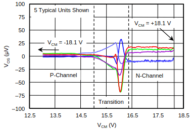

Compared to OPA2156 (R2R-input variant of OPA1656) which would fulfil the LT1498's 1.3mV spec wrt to Vos shift at +-15V:
