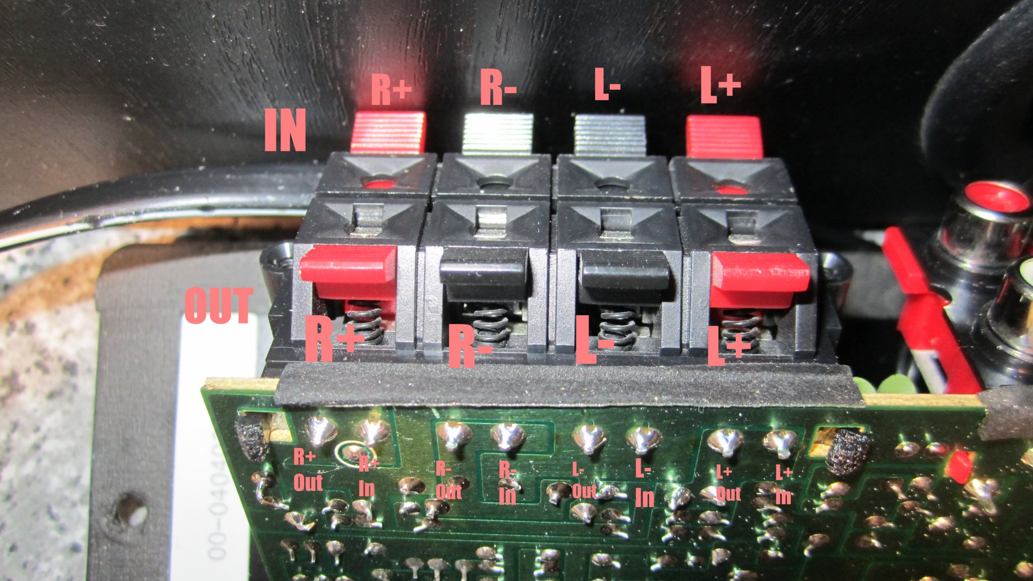

I'm planning to replace a snap-on spring-clip speaker terminal(picture attached) with binding posts. Do I just simply desolder the spring-clip terminal and then with jumper wires connect the in/out points on the PCB to the relevant binding posts? Reason for asking is that when I looked at the metal connectors on the back of the terminal, each one is connected separately to the PCB. However, when I checked, with continuity by a multi-voltage meter, each insert hole with the solder points on the PCB, it showed that the +ve and -ve are connected, which had me confused because with binding post terminals, they are separated from each other and should be not connected. So, I may be ignorant of the spring-clip terminal construction or there is something I should pay attention to for such replacement. I'd appreciate any advice. Thanks.

I've attached a picture of the spring-clip terminal to show more information and would elaborate on what "continuity" meant in my previous thread. With continuity test I did, R+ of In & Out, R- of In & Out, L- of In & Out, and L+ of In & Out are all "closed". If this is normal for such circuit, then I think I can just simply substitute the spring-clip with binding posts.

I'm a tad confused by your readings and description, however...
Each individual spring clip appears to have two prongs for strength of connection to the circuit board and which are electrically in common.
I think it is safe to say that you simply take connections to each of your four binding posts from each of the following four locations you have indicated on the circuit board:
R+ Out; R- Out and L-Out; L+Out

2 sets of spring terminals means they are wired to the switch on the front. You need to trace back from that.
I’d (i also did) wire direct from the power amp output to a single se tof good posts and lose the A, B, A=B speaker switch.

Thanks for the response. The terminal connector is the speaker IN/OUT of a Velodyne subwoofer. I believe I can simply connect the four (or eight for in & out) locations on the PCB to the relevant binding posts. It's just that I'm curious why the R+ OUT and R- IN, and same for L+/L-, when tested for continuity they are "closed".

This is Velodyne SPL-10 speaker level input schematic:I used the ohm setting to check and readings are as follows:
Input Output
R+/L+ 2.23 R+/L+ 2.23
R-/L- 117.8 R-/L- 117.8
R+/R- 1.18 R+/R- 1.18
L+/L- 1.16 L+/L- 1.16
There is a 470Ω resistor (R10 and R11) across R+ and R-, L+ and L-. Your ohm reading should be about 470Ω.
There also two 100Ω (R51 and R52) connected to R- and L-. Your reading should be about 200Ω.
If your subwoofer does not features high pass filter, the speaker level input and output will be paralleled. That explains why your meter got same ohm readings for input and output.
Check your circuit board and see what are those resistors value.
