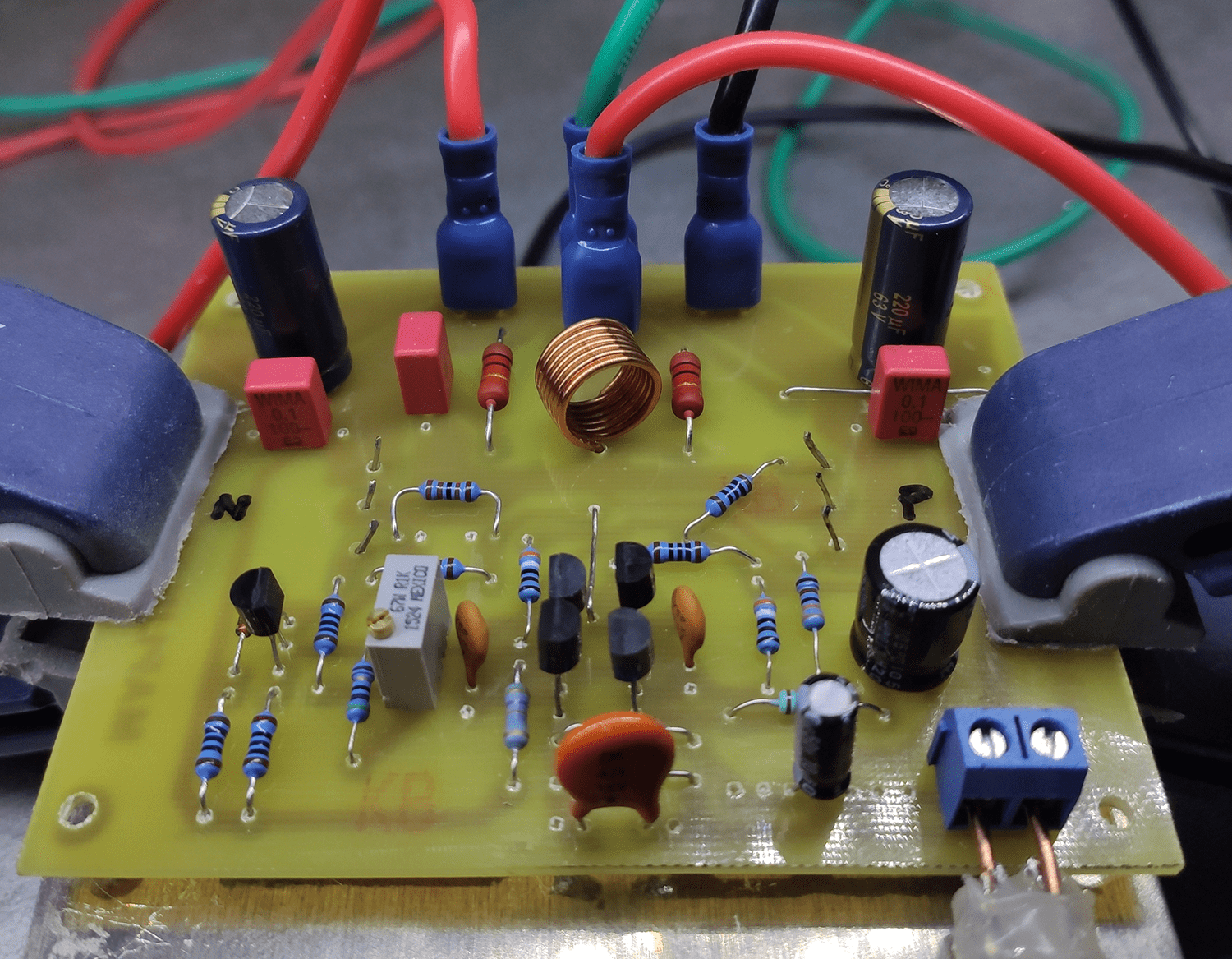

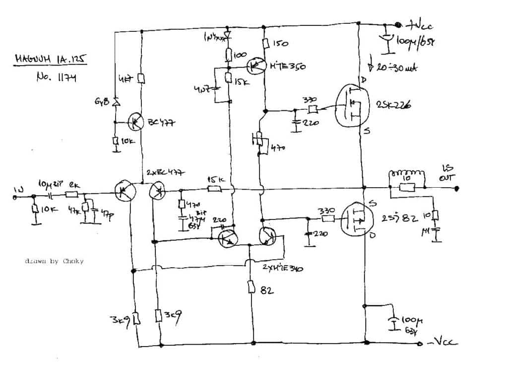

This circuit don't use a complementary front-end like on elektor's crescendo diy project and was close to this circuit under
http://www.stancurtis.com/Downloads/Moth 30 Stereo Amp copy.jpg
This minimal design aka Maplin is perfectly stable and sounds great. Prasi designed a PCB.i like this design a lot indeed It looks quite minimalistic to me And you say that is unstable ? maybe some more small value bypassing caps here an there could solve the issue ? Very very nice schematic

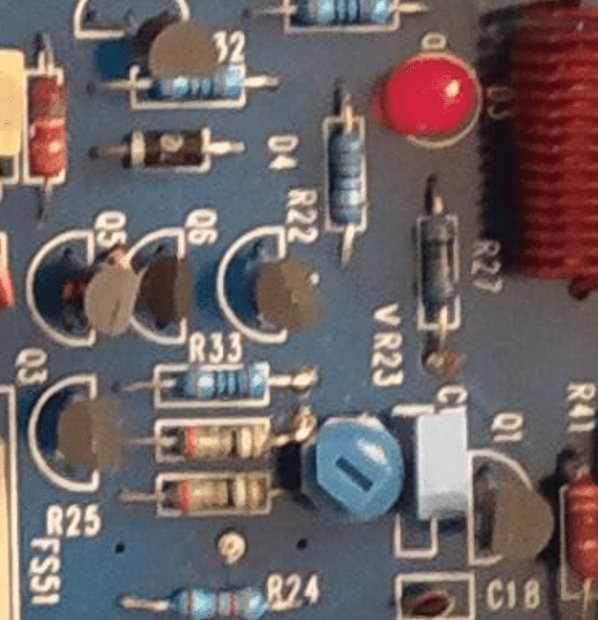

Hi thank you for the very valuable advice I guess that resistors can be measured directly on board without removing them ?Read what you can and at least establish the topology of the circuit, which is the least you need to even start considering meaningful mods and upgrades. If you don't know what the markings in some components mean, share them and we'll help you out.
I think that a viable solution could be to take a picture of upper and lower side of the board, mirror one of the two and try to overlap them ?
The bjts should be quite common I will have the summer to do this
I will try to do and report
It can be possibleIf there are some you can't physically read because of the way they are installed, de-solder them if you can; if you can't or you're afraid to damage them, share what you have and chances are we can figure out what those components should be based on everything else, even easier if it turns out that it's just like one of the schematics with similar output transistors that have been posted above.

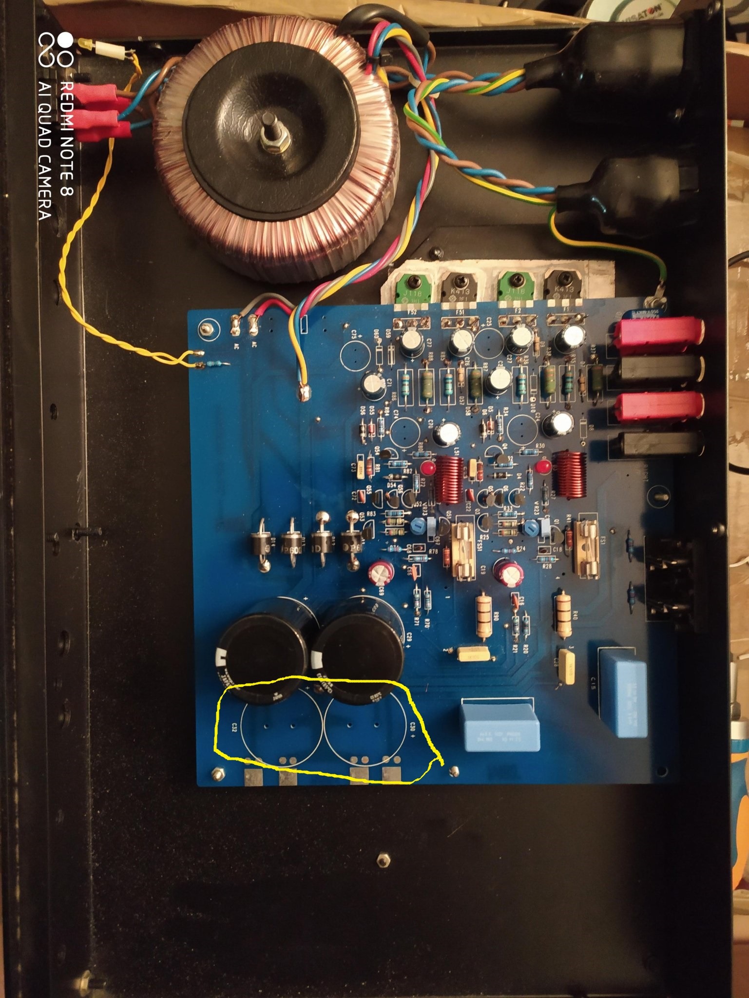

There is another thing that i do not like The output mosfets are screwed to the bottom plate like the mains transformer is Its vibrations are transmitted to the mosftes and this i do not like
I will have to put a rubber mat under the transformer and fix it with some plastic straps Just to keep it in place
I will not move the amp around for sure

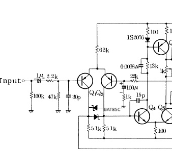

Hi thank you very much for your very kind and valuable advice Mine has one transistor more in the VAS and driver stage (i.e. excluding the output pair)
there are 6 transistors per channel + one output pair
I like your amp a lot I like simple schematics I guess that it can sound pretty good as well

Hi thank you very much indeed I will try to take pics of the board The idea is
1) take pics of the upper and bottom side of the board
2) mirror the bottom side
3) overlap the two pics to show traces and parts
After that i will measure resistors and read the markings on parts I will take some time I have all the summer

There is nothing you can significantly improve there. It's a generic Hitachi schematic for their lateral mosfets, it always plays similar to other such amplifiers, no matter what you do to it. Those transistors cannot be replaced with cheap IRF vertical mosfets. So if you do something wrong, that's the end. I've seen J118/SK413 on ebay for cheap, I just doubt they're genuine. It would only mean adding DC protection for the speakers which doesn't exist so the device is a bit dangerous to use. But that can't be done easily either, because the output connectors are soldered directly to the PCB. So, make something better, and leave this as it is and sell it when you don't need it anymore.

Thank you very much and i have cleared up my mind Can i say that the project is quite good while the construction is poor ?There is nothing you can significantly improve there. It's a generic Hitachi schematic for their lateral mosfets, it always plays similar to other such amplifiers, no matter what you do to it. Those transistors cannot be replaced with cheap IRF vertical mosfets. So if you do something wrong, that's the end. I've seen J118/SK413 on ebay for cheap, I just doubt they're genuine. It would only mean adding DC protection for the speakers which doesn't exist so the device is a bit dangerous to use. But that can't be done easily either, because the output connectors are soldered directly to the PCB. So, make something better, and leave this as it is and sell it when you don't need it anymore.
https://www.ebay.com/itm/362255964346
Because imho a DC protection circuit should be a must And that when well executed it will detract nothing to the sound
It is a pity that good sounding designs are poorly implemented
This amp should undergo a major rework from an expert
