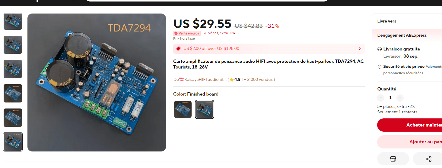

I think I'm going to go with an amplifier based on the TDA2030... I even found a ready-to-use kit here. very cheap ..
What do you think of this solution?
I'll add a DAC to this solution... I also want to control the volume with a remote (I'm not sure how I'll do that) and add a VU meter... etc., etc.
Am I on the right track, or am I dreaming?
I've followed the link, and on the circuit board shown, I can't see a 2030 chip, and it's a mono chip, so there should be two, and with heat sinks. . I've actually got two 2030a boards in transit, and they should arrive next week; they are low power - 7 watt (but plenty enough for what I want, I'm currently using a 2822 3 watt amps) and have low distortion, if I remember correctly, around 0.05% .

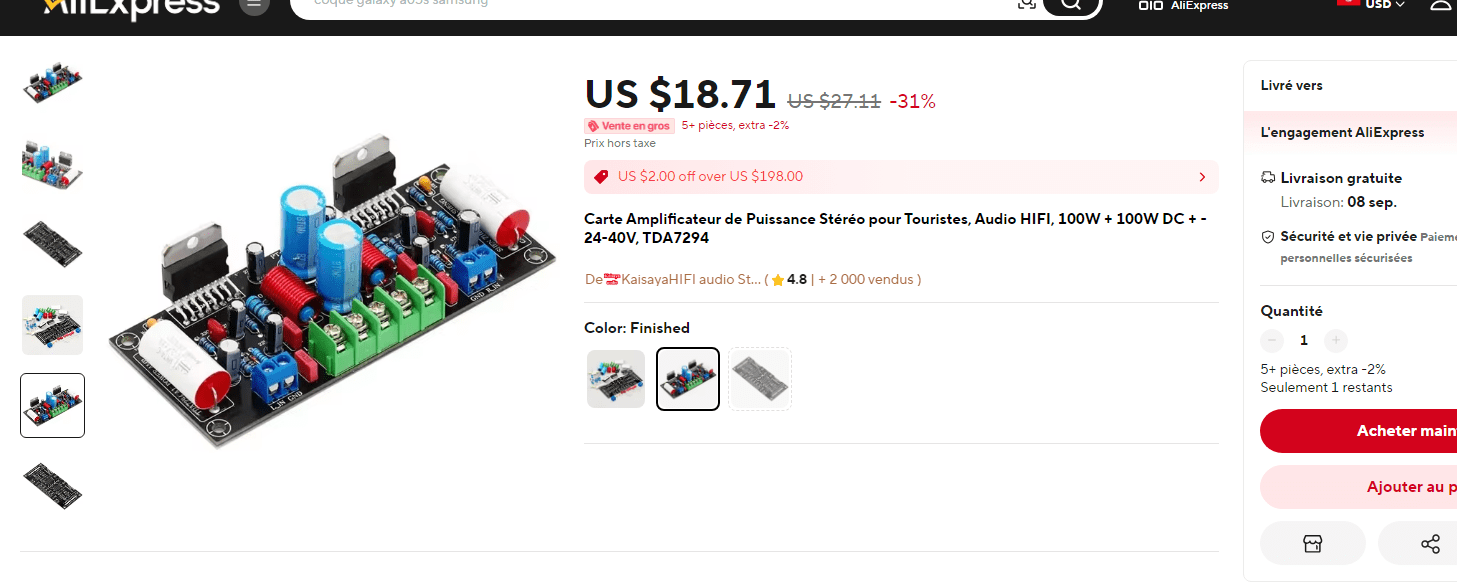

Those stereo TDA7294 boards are perfect to power right and left satellites.

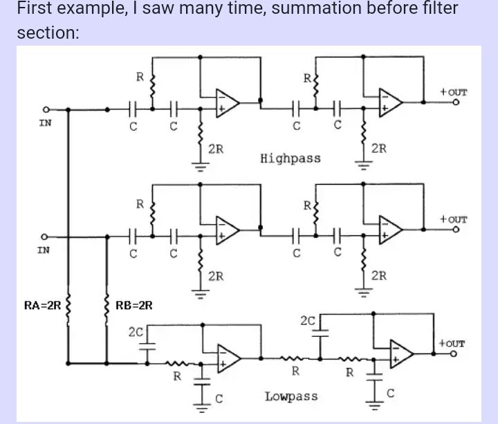

You need to add a subwoofer crossover board which gets left and right, sums them into a dingle/mono output and feeds them into a Sub amplifier.
"Just one 7294 amplifier will do but best is a bridged 7294 amplifier so Sub gets higher power.
Something like: https://www.diyaudio.com/community/threads/active-crossover-design-buffer-and-summation.379163/
There MUST be some such premade board at Ali******
or
some dedicated subwoofer power amp which includes the mixer-crossover which had L and R inputs, mixes them.intrrnally and feeds its own amplifier.
If all use 7294 a single power supply can feed all 3.
+/- 40V (even +/-32V or anything in between) is a standard power supply: say 26+26 to 28+28V transformer, a bridge rectifier, 2x 10000uF 50V caps.
Somebody must be offering them or at least the transformer; diodes and caps are generic..

- the TDA7294 is a good solution for the amplifier.
- Choosing a pre-made solution on Aliexpress is also a good option for using this chip.
