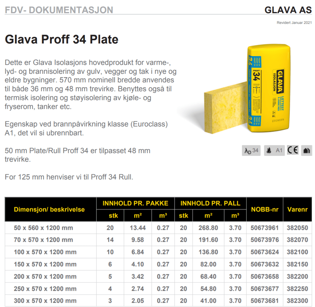

It is 5cm of fibreglass. No compression. I also have a little syntetic wool behind the magnet to stabilize the stuffing. The big difference seems to be in port size. The port is about 200 x 58mm, but the plate I use reduces the open area with more than 50%

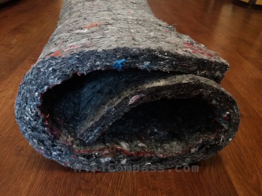

It's strange that I have quite some interesting results using some different types of fibrous materials, including mineral wool and fiberglass and natural sheep wool, but no luck at all with "eco felt" which is some kind of felt made of recycled cloth scraps which consists of majority polyester and cotton. I searched quite seriously, hoping to find the answer why this felt doesn't work here? Does anyone know anything about this? Some kind of adhesive is used in production of this felt, wouldn't this contribute? This is it:
I used 30 and 50kg/cubic meter fiberglass with comparable results but with using more or less thickness. What density of fiberglass did you use?
Sheep wool also works but it's hard to keep it in place and lacks the uniformity.

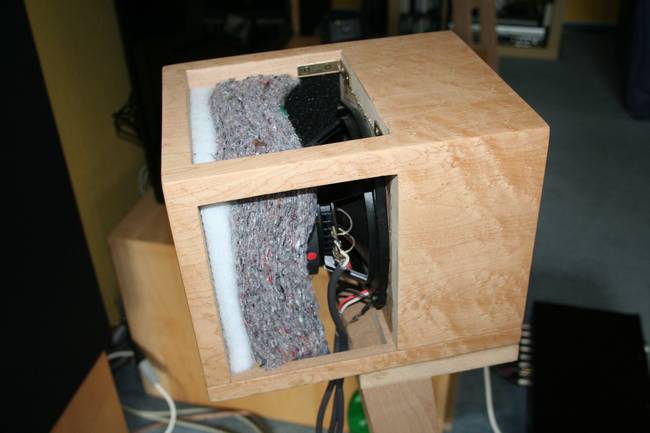

This kind of felt is a very effective absorber, it is most likely too effective to work in this application.I searched quite seriously, hoping to find the answer why this felt doesn't work here? Does anyone know anything about this? Some kind of adhesive is used in production of this felt, wouldn't this contribute? This is it:
Actually, I just found this image that seems to be the same felt material.This kind of felt is a very effective absorber, it is most likely too effective to work in this application.

I am using this type. Sorry, I did not find anything in english, but you get the numbers ;-).I used 30 and 50kg/cubic meter fiberglass with comparable results but with using more or less thickness. What density of fiberglass did you use?
The weight of 20 sheets is 11,56kg. The volume according to datasheet is 0,27cubic meter. That gives about 43kg/cubic meter. On the other hand, the volume of non compressed sheets should be 13,44sq. meters x 0,05.= 0,672cubic meter. That gives about 17kg/cubic meter.

Did some more investigation. The volume of 0,27 is a transport volume. The sheets are compressed about 2,5 times for transport, so the correct density is the last uncompressed one (17kg/cubic metre)That's pretty much the same as the fiberglass I used. Good to know. Thanks bro

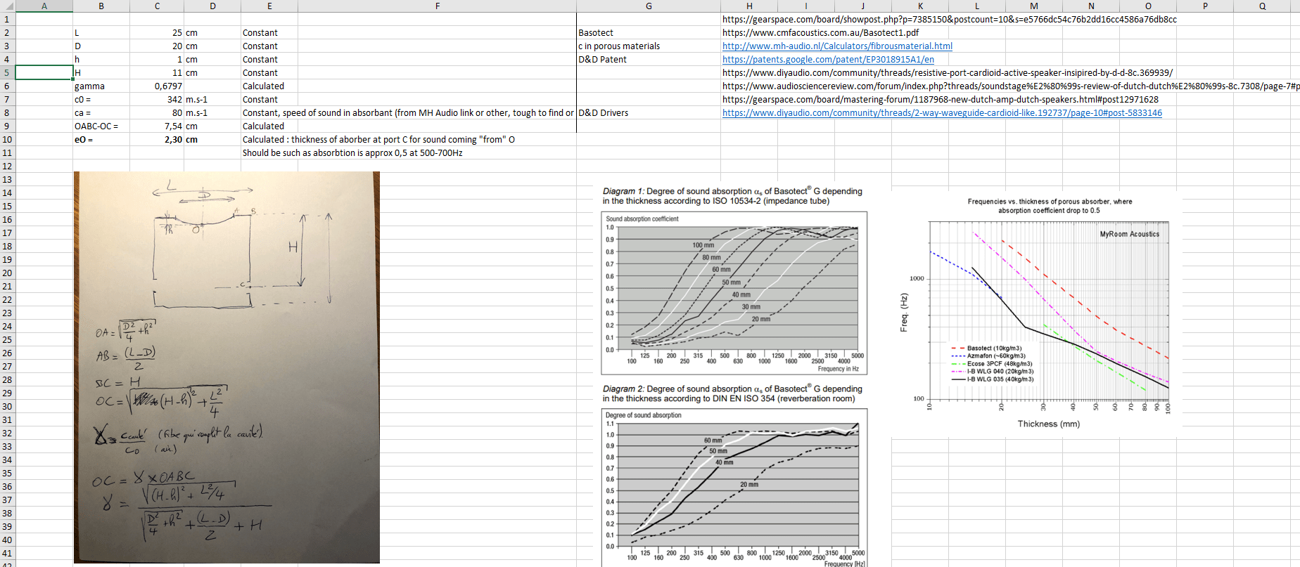

I only recently came across the 8c's. Even though I've never heard them, I am very impressed by the design and the laudatory reviews.
I've built myself a couple of speakers and experimented with DSP. My latest speakers are active 4 way open baffles, DSP is done in Roon outputting to Exasound 8 channel DAC. The result if really OK despite the reverberant room (RT 0,7...) but the speakers suffer from bumpy directivity index over frequency....
I'd really like to prototype something along the lines of the 8C, a 3 way driver :
The challenge is the mids : design the speaker enclosure so that the ports and the insulation actually provide the delay and low pass filtering required for the "cardioid" profile generation.
I have started to play with Excel on a very empirical approach. I have usef a MH Audio calculator for speed of sound, but I am quite perplex, I had bad experiences in the past with their calculators.
Anyway this is really step 0, I guess a lot of experimentation and measurements will be needed ! It's really a challenge to find the material and thickness that provides the right amount of delay AND low pass transparency.
