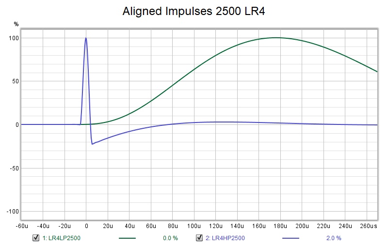

Electronic time-aligning only does a proper job on the measurement axis. And a good crossover design, passive or active, analog or digital, IIR or FIR, incorporates aligning by arranging amplitude and phase relations to a good sum signal. Again, only on axis though.
We have frequency response, phase response and drivers time-alignment. Am I missing something here?
The problem is that it isn't time-alignment, but space-alignment.
I don't get your point. I might be in a language barrier. could you please explain a little bit about this?

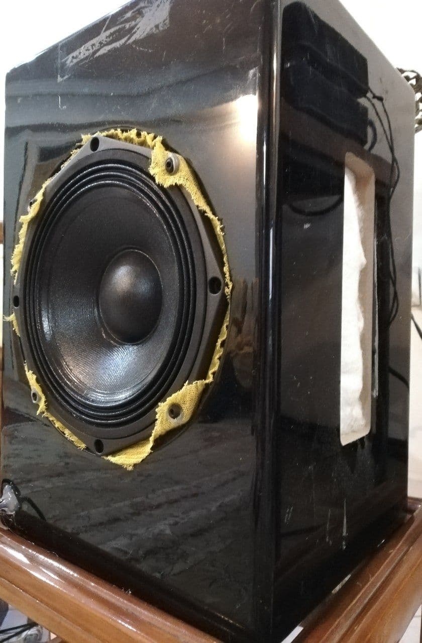

We had a test cabinet lying around that is a good choice to start measuring for now. it's 40cmx27.5cmx24cm. It's a bass-reflex but I closed the ports with cardboard and hot melt glue. I routed the resistive ports/slots on both sides, they are 20cmx5.5cm. I'll start with Faital Pro 8PR200, for now, that will fit nicely on the enclosure. I added a thin layer of cotton fabric at the back of the driver to avoided any particle getting into the driver itself. I filled the cabinet with 30k/m3 density open cell foam and I'm getting 4-5dB of cancellation from 70-80hz up to 300-350hz at 180°. it seems the foam is not a good choice.
I have to measure front and rear responses individually and try to reach a pretty similar response on both sides by try and error and testing different resistive materials. it will take forever though.
I have to find a way to measure port response solely so I can find out how much time delay resistive material is adding in there.

With a textbook minimum phase Linkwitz Riley Crossover the impulses need to be aligned at their starts not peaks, when this is right they will sum perfectly on that axis. There will be a power response dip from the crossover and other changes off axis from the directivity of the driver. In most cases aligning at the crossover point is the most sensible option. You don't have to be in the dark as to what happens but you will need to simulate with good polar measurements to see the effects on all off axis angles.Should we not, whatever the design, slope of the crossover, perform an impulse response measurment with a sweep tone around the frequency where the two drivers are planed to be crossed ? Then according the slope filter typology, adjust the gap to have a straight on lobbing on axis... then cross the fingers for what happen elsewhere ?
Try and plot it in Vituix or something similar that can do polar plots, 4-5dB of cancellation does not sound that bad as a start.I'm getting 4-5dB of cancellation from 70-80hz up to 300-350hz at 180°. it seems the foam is not a good choice.

Are you using this speaker in a house? If so, cardioid doesn't help you below 150Hz because you're below the room transition.

Also, adjust your expectations based on where you measure your speakers.
Don't forget that the 20dB side cancelation was measured in a anechoic chamber. You are never going to measure that in a living room. 8 to 10dB in a living room is a pretty good achievement. Can you share the design?
