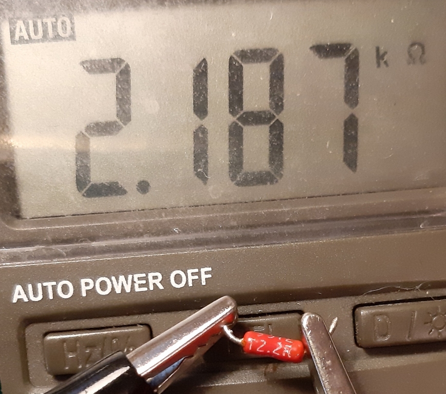

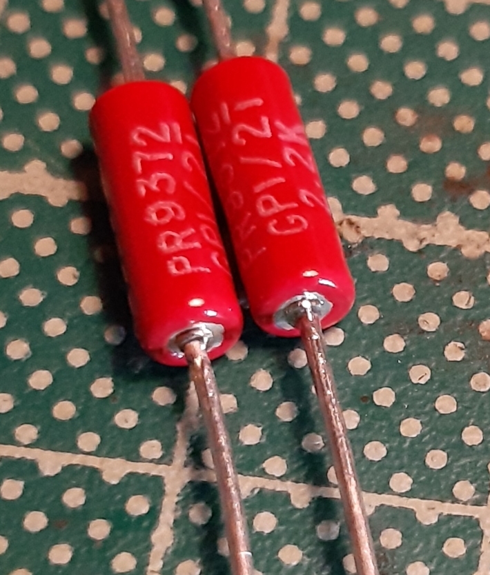

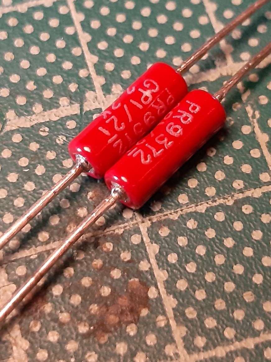

I ordered a few PRP PR9372 Series Metal Film resistors (0.5 & 1 Watt) to use for the first time. They look pretty and some folks claim that they perform well.
I remember coming across your particular post while reading about resistors and the different brands and took notice. However, I decided to go ahead with buying them anyway, since I wanted to try and 'upgrade' a few resistors on a diy kit of mine.

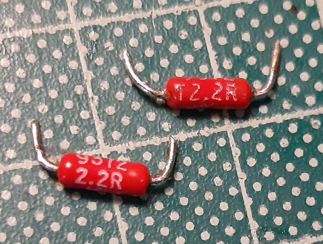

The resistors arrived and I did notice that the legs looked like they were attached a bit flimsily to the caps. I remember what you said and tried to be as gentle as possible with bending them. I was successful in not breaking any of them!
So, I replaced the old resistors on my kit with the PRP ones, without measuring each and every one of them. They all came packed in different baggies, according to value. I only checked the written values on the actual resistors before procceding.
To make a long story short, I encountered a problem after installing the PRP resistors and after a long troubleshooting by a process of elimination, I found out something wierd.
One of the resistors was supposed to be 2.2Ω (2R2 is written on it), but when I measured it I got 2.2kΩ. That is x1000 times more!!
I took my loop out just to make sure I wasn't reading it wrong, or the people that assorted them in the baggies didn't mix them up. It's clearly writing 2R2.
I'll post a picture of it shortly, so as to give me your thoughts.
I'm neither too knowledgeable, nοr too experienced, so i'm not sure if this is a common occurrence. I just though I'd share my story with you since I would like your experienced feedback.
I've never used PRPs, but nevertheless I was just wondering the other day why I test each and every resistor when I've never had one be anything other than what it was supposed to be.
Thanks for reminding me why.
