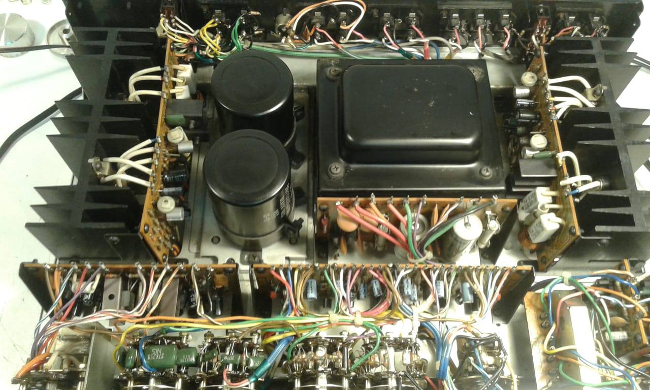

Could you help me with some information please. I have a Pioneer SA-9100 amplifier bought and kept by me since 1973. It needs work to restore it to better performance.
I am in Canada (east coast) and I would like your recommendations on who does this kind of restoration work here, and their reputation.

Most of the time this Pioneer serie from the end of the 70s are suffering of their volume pot, a sort of pot made on a board and soldered in vertical position. It is not hard to adapt a modern pot but perhaps you will loose the Loudness purpose (not sure, to be checked : photographs of the inside of the amps.
Does it have big Elna grey cap at DC blocking beore the binding-posts ?
A little pop in the loudspeakers is normal for these amps. You may needs to replace some caps for better performance but you will loose the nice warm signature of it.
No, diyggy, the amplifier is a bipolar supply direct-coupled type.

I think it needs the caps replaced as I read they go on this amp after these many years.
The protection circuit also needs attention.
A few years ago I sent it to Pioneer in Montreal (I think) and they replaced a transistor, but nothing else. It has lost that beautiful sound, and now sounds hard, cold.

People have gone NUTS over this "recapping craze" and it's NOT all that important.
Yes, maybe some caps might be weakening, but not all.
Too many people have done that nutty "complete recapping" and have wasted time, money, and sometimes did more harm than good.
There are other things that need attention, but the morons don't understand that sometimes adjustments, cleaning controls, etc, are in order - so they putz around with recapping because "the internet" says so.
Enough of that crap already!

I share that opinion, I have seen used amplifiers but in impeccable condition and the "updates" left them without working forever.
"If something works well, leave it as is"
I would start by placing a series lamp (I still have a few old bulbs, many newbies want to use the current low consumption ones, they do not work), connect it and if there are no abnormal symptoms (the series lamp must remain unlit or slightly) check with a mono source (or a bridge on the RCA inputs) if the two channels work identically by moving the balance.
If all is well, to enjoy and period.

This distribution of the components makes it very difficult to measure voltage in inaccessible points ... you have to manipulate the plates with the (rigid) cables connected and short circuits are on the lookout!
I tremble just seeing the photo !
