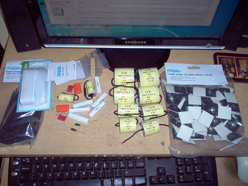

Apologies if this is turning into a BLOG, but good progress on these speakers.
Had them apart, and decided to go with the 8R2 7W Wirewound/680nf Capacitor Zobel:
This leaves the crossover looking like this according to my multimeter, with LP 1.56mh, HP 2R2, 3.3uF, 0.27mH plus the added Zobel Network which is 8R2/680nF:
Quite easy to do since the capacitor fitted exactly in the HP coil:
The metal tweeters are a bit ropey, IMO. 1700Hz Fs is kinda stoneage, but it's sounding extremely good now! The top end has improved DRAMATICALLY with the Zobel. Very smooth and laid-back, a taste of the high-end.

Just an update on this "restore blog"...
Thanks to help from Planet 10, aka Dave, I have reinforced the cabinet front and back panels. Just 4X20cm pine cross battens per speaker on front and back to strengthen around holes. The battens don't even go to the edges, since I decided not to interfere with natural damping too much. Access was limited, so no chance of a proper brace really.
Huge number of crossover bits accumulating, but I'm learning as I go along, so we are not near the finished article yet. A Vifa or Morel tweeter with a 94mm metal front plate is beckoning along with some new coils, and I need to rolloff the bass a bit, I reckon.
