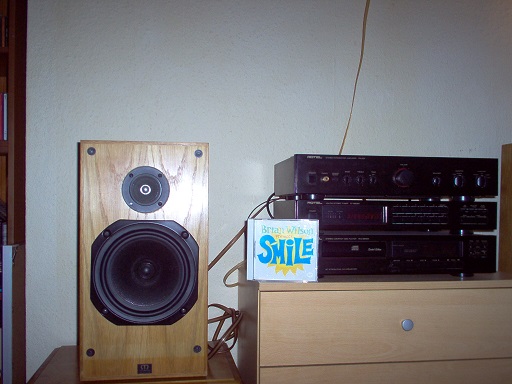

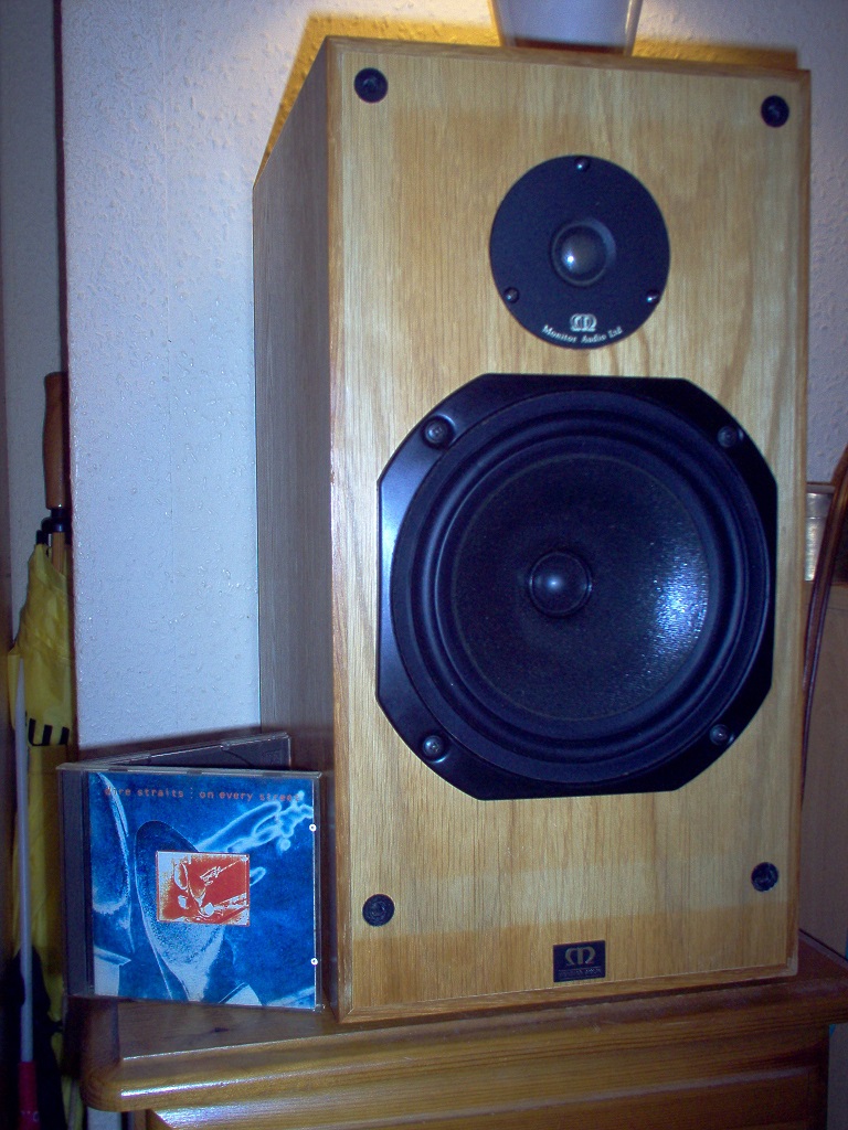

Well, a little update on progress with the slightly dire Monitor Audio R300/MD speakers. 🙂
I was pretty limited by lack of precise knowledge of the drivers here, but decided to go with a better second order crossover over the original poor first order bass. Before:
After:

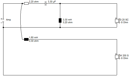

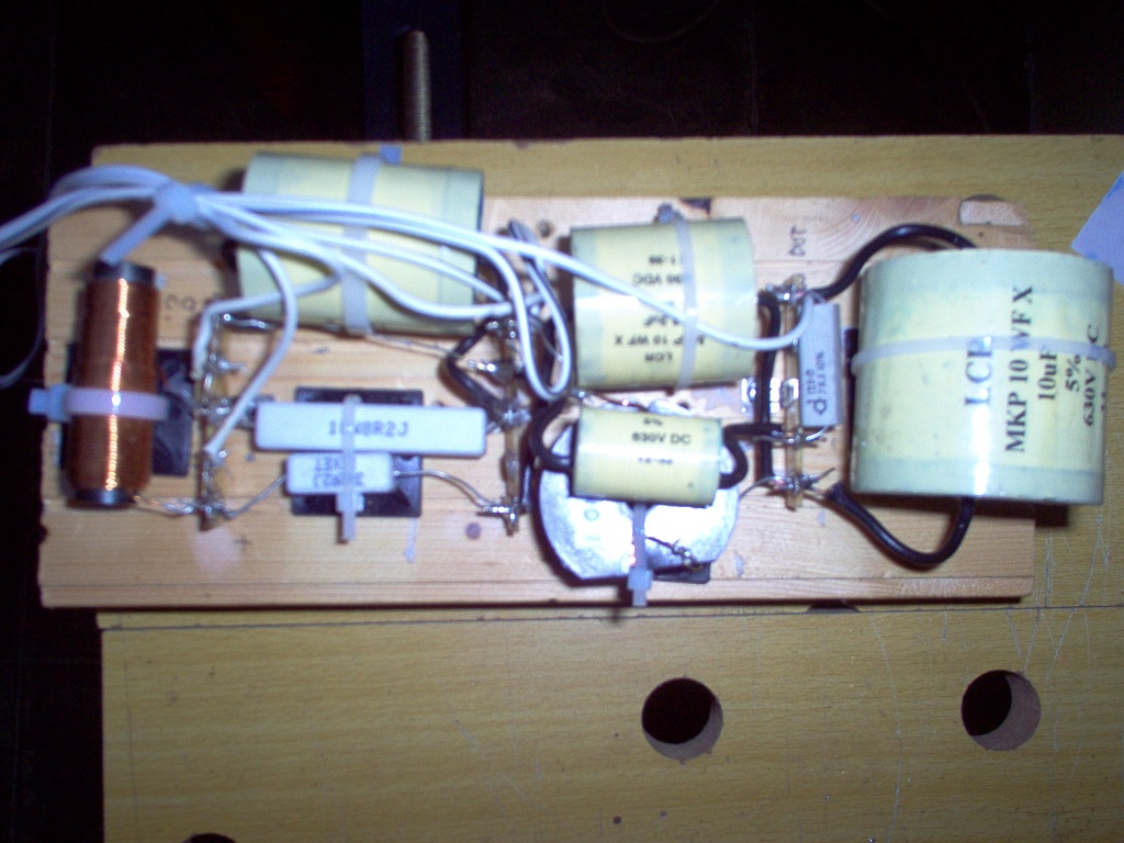

The crossover design:

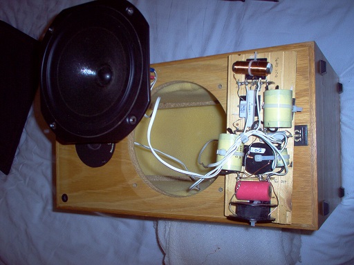

And how it looked:
Polish it all up with some Shiny Silicone Grease on the rubber parts:
What I did in effect was reduce the coil from 1.6mH to 0.76mH to tame the bass a bit, and use really good polypropylene capacitors. It sounds very nice and is now a genuine bookshelf speaker. Imaging is good. Bass and drums is easy to follow, faultless really. The metal tweeters still sound, well METALLIC. They just don't have classical piano sounding right. I must fit soft domes soon. But a HUGE improvement. 🙂

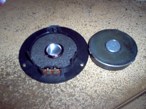

I know this goes back to your first post, & perhaps a topic for another thread, but re: the 'the dried-up ferrofluid gunge' - so does ferrofluid have a 'shelf life', & if so, what are the contributing factors...???
I can't help but noticing the slight peaking at 3k, 5k, and slight dip at 7k...all the woofer's fault.
if you want to add new ferrofluid back to the tweeters, here's an option:

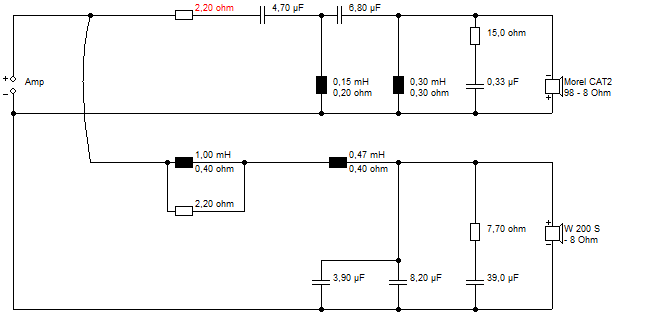

This was a tough decision, Allen. I could have fitted bigger 15uF to the bass and rolled it off faster, but that left me with an unwelcome and ugly peak at 1.5kHz which would have made the top strings of guitar jar IMO. 10uF also worked much better with time alignment (which is where you wire the tweeter out of phase and move it back a few centimetres, or just turn the speakers upside down), and I wanted to leave that option open for experiment later.

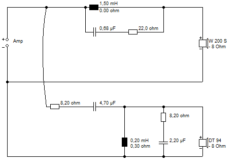

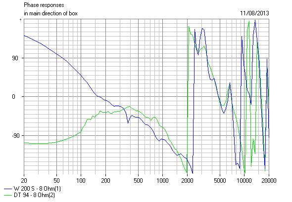

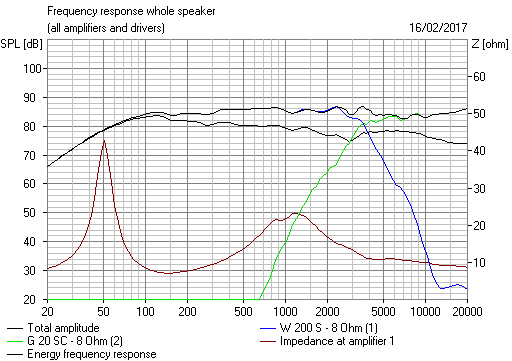

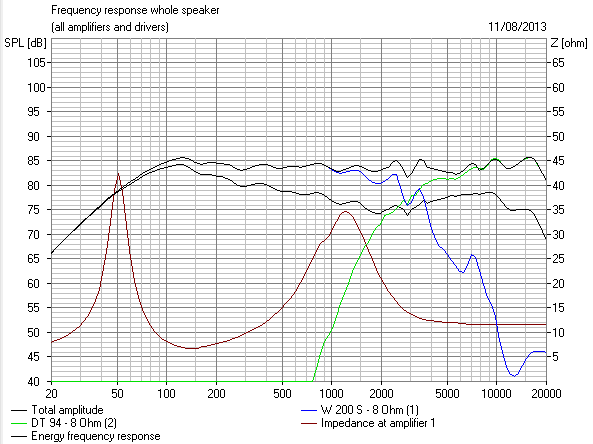

Progress on these 8" bass plus 1" tweeter closed box speakers:
Built a new crossover and fitted a Visaton DT 94-8 Mylar dome tweeter.
This is first order bass plus tank/notch at 5kHz. Second order tweeter. I am getting the hang of doing 8" bass with simple filter. 😎
All works very well, and the tone is very neutral and untiring. Classical piano sounds RIGHT too, not metallic. FWIW, reusing the original tweeter 3.3uF and 0.27mH components will give very similar sound I reckon.

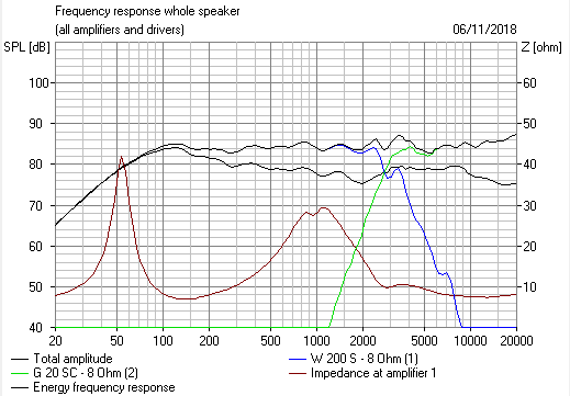

The Visaton G20SC soft dome which is also an easy 94mm chassis to fit didn't model so well on phase.

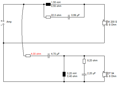

I've been doing a little tweaking of the final result here. I found the Visaton DT94 mylar tweeter lacked a bit of energy, so reduced the input resistance to the HF filter from 8.2 to 4 ohms. I was a bit surprised I needed to do this, since the DT94 was about 6dB louder than the original SEAS 19TAF/G unit by my reckoning. But actually, Visaton say it is 90dB unit, so I suppose it makes sense. The Monitor Audio bass is evidently quite efficient. 😱
Nothing like actually doing it, as we used to say. 🙂
I'd also estimate that the original tweeter could have been slot-in replaced with a SEAS 19TFF soft dome, another 19TAF/G metal dome or a Morel CAT298/94 soft dome if you want to do it the easy way.
Morel Classic CAT298-94
The 22R/0.68uF tank on the bass coil was great success IMO. This is a very good speaker now with good phase alignment. system7 signing off from Monitor Audio land. Thankyou Robin Marshall for the ride. 😎

... so reduced the input resistance to the HF filter from 8.2 to 4 ohms. I was a bit surprised I needed to do this

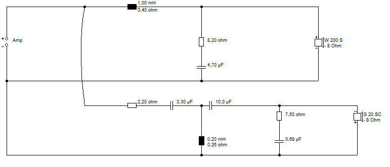

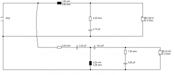

I had a friend round, listening to these BW3 types, and he remarked he thought they were a bit bass light:
That's not hard to fix here, just a bigger bafflestep coil:
Below is the original, slightly woeful 4 element crossover. Next is 4 images of my current super-dooper 4th order LR4. This is actually fairly faultless, we are moving into very high fidelity here. I have a few future ideas to come in a subsequent post.

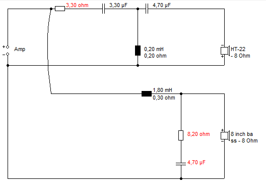

Hi Steve, moving from a 1.0mH to 1.8mH coil, I'd expect some changes are also required in the tweeter circuit to compensate for the rolloff. The Fc will change, phasing will change and tweeter will need more padding as you are subtracting another ~ 2dB BSC?
Are you planning to invest in a measurement setup? It really does help in the tuning / voicing cycle.
A good point about levels, Dave. And I am sure I could benefit greatly from turning my modest home into an anechoic chamber with measuring equipment.
But actually most of my interest is theoretical. AFAIK, all that increasing the bass coil to 1.8mH does is flatten a +3dB peak at crossover. Which to my ears never sounds bad at all. Because it corresponds to flat power response in the room, especially off axis. Tweeter level is a matter of taste IMO.

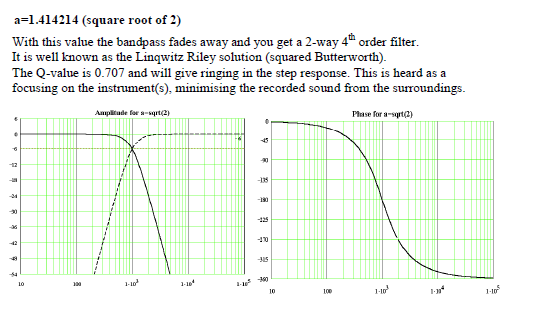

THe whole speaker crossover problem gets greatly simplified by the work of Mr. Steen Duelund. Once you settle on a bass response, the tweeter response in amplitude and phase follows, as in the last image.
