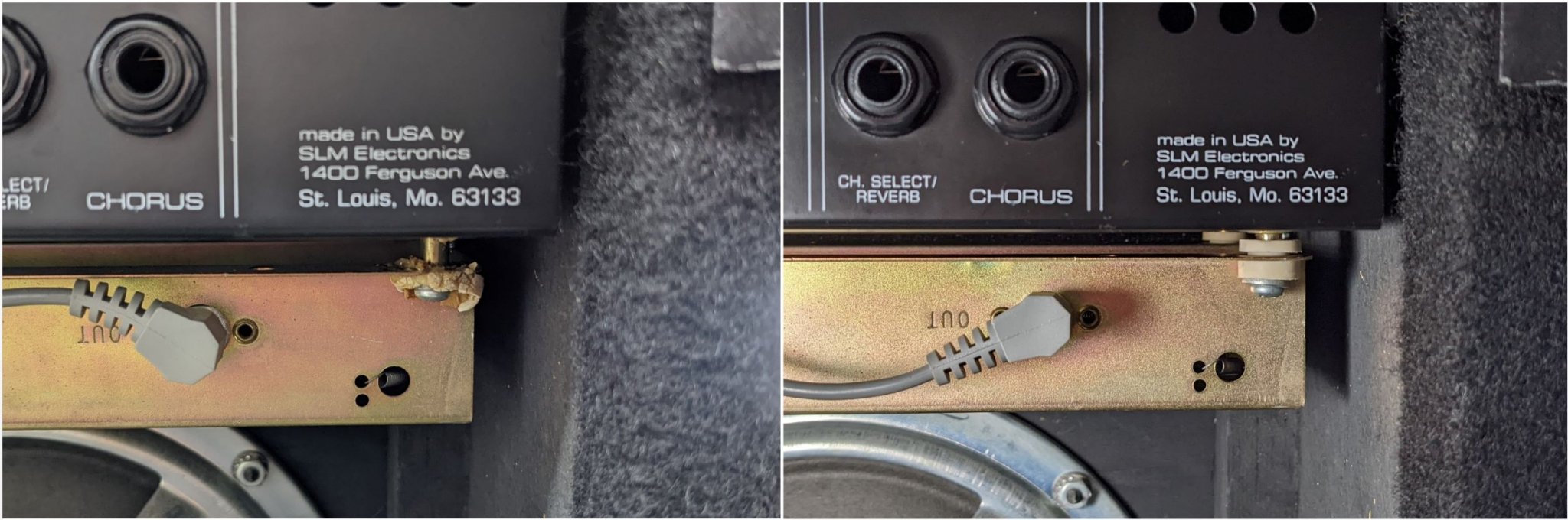

With everything working again I sleeved the speaker wires (yeah, completely unnecessary, but I wanted to keep them from getting snagged so easily, and to me it looks better than just twisting them together) and also cleaned up the cabinet carpet piling (with a Norelco beard trimmer - I stumbled onto that trick at TalkBass.com).
