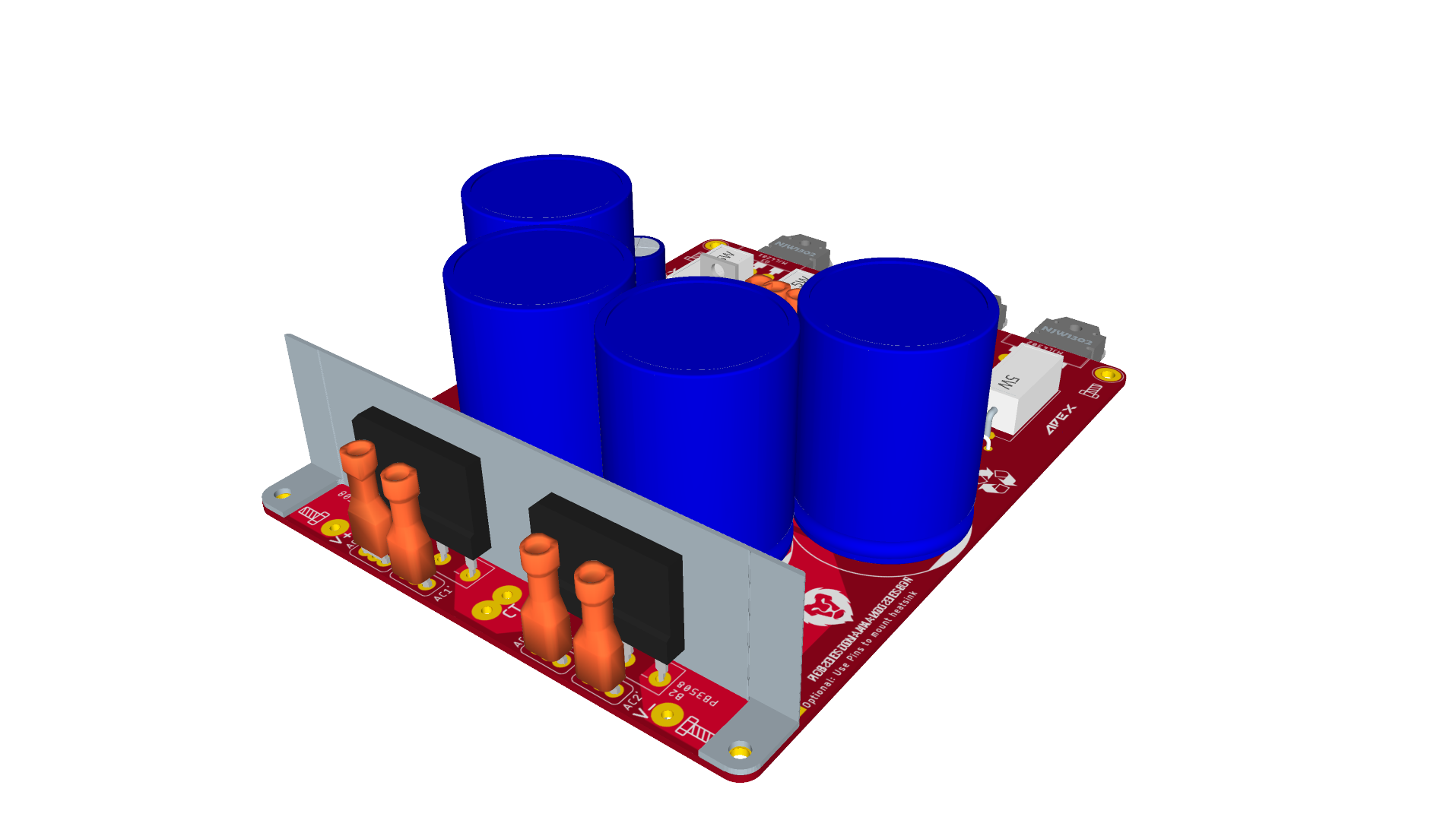

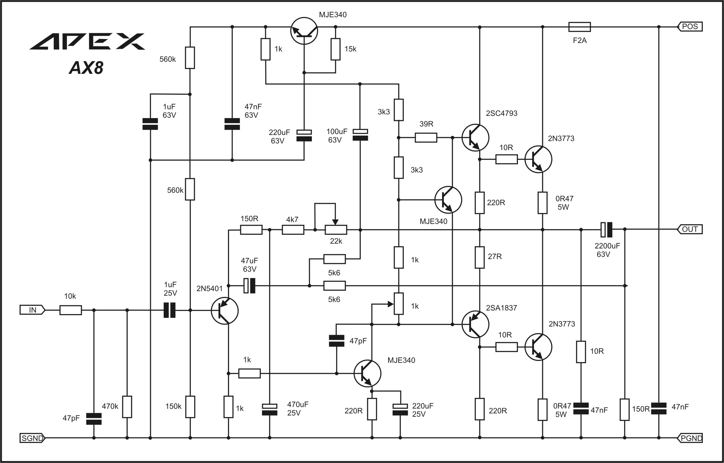

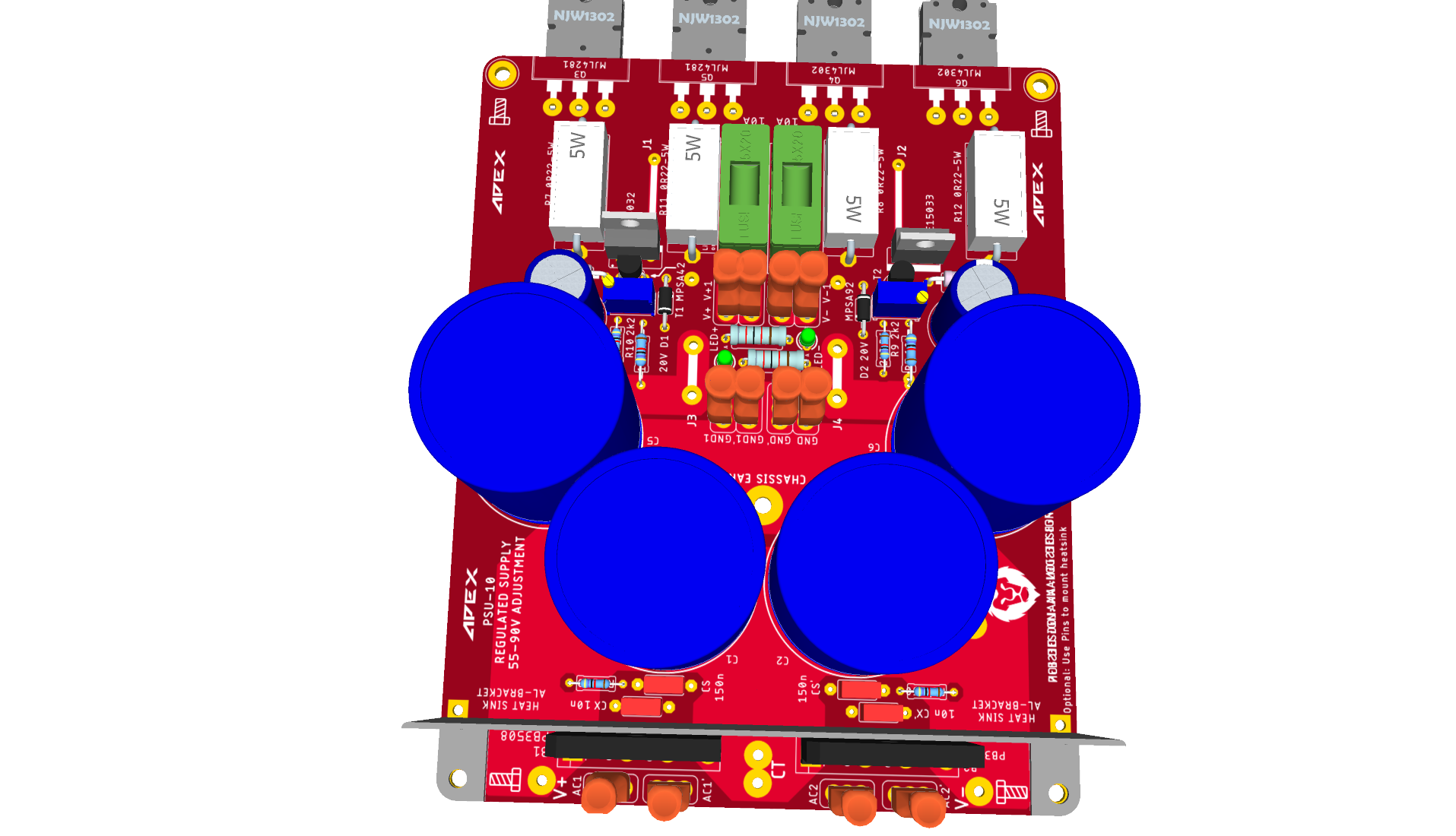

can some one help me set up the sim file for apex regulated psu? I am noobest of noob with spice.
i want to see what is adjustment range with different values...
regards
Prasi
Hi Prasi
Let me know which values you want to be able to adjust and I'll see what I can do.
Hello avtech,
Thanks. basically the 3k3, zener diode and the R7 /R5 combo adjustment (this is actually a trimmer of 2k2 value).
Also the other commands /set up that make it a PSU.... proper.
I also wonder if its possible to see transient response of regulator when the load demand (amp) varies.

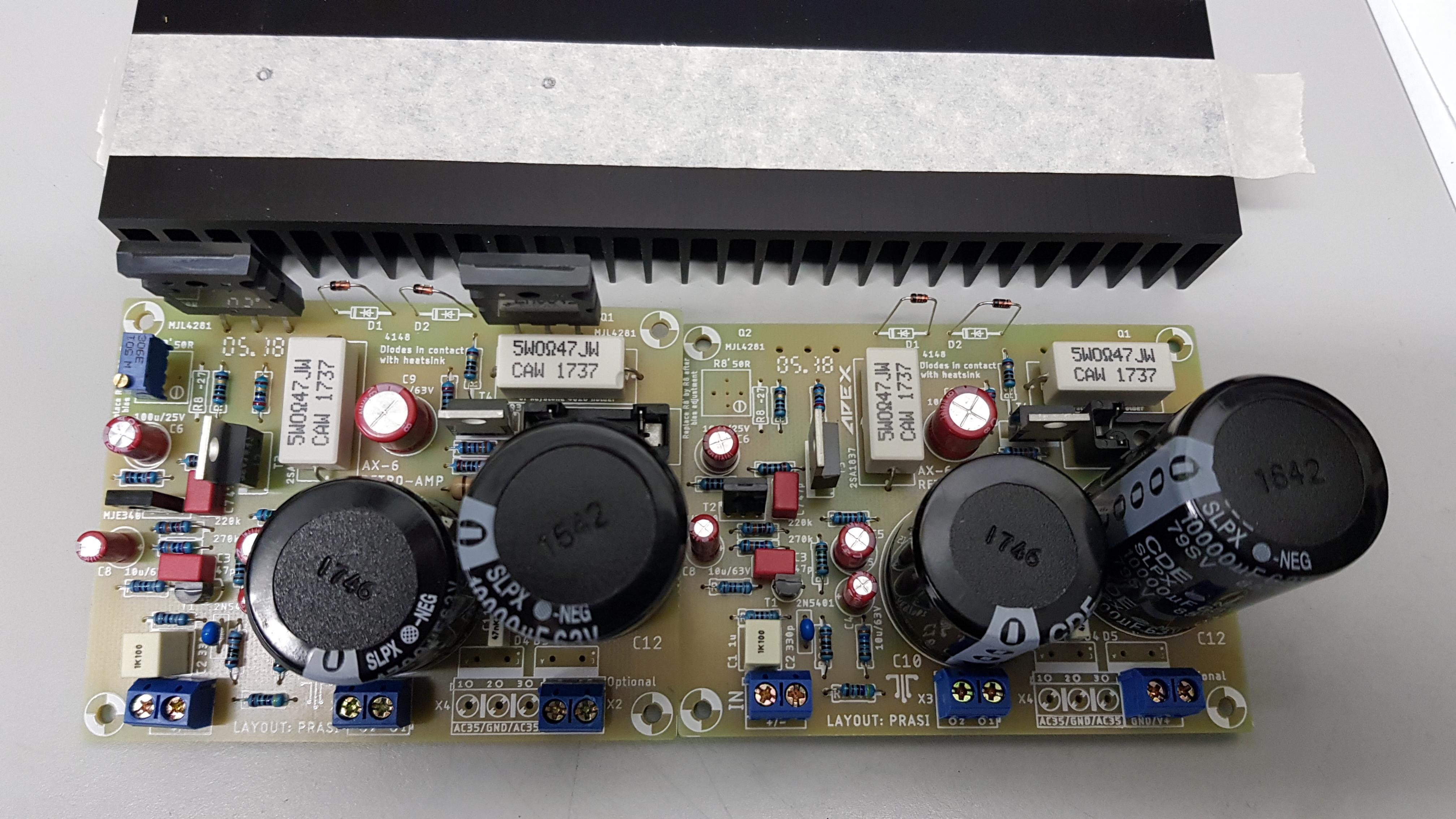

Almost ready to mount on the heatsink and test. Looking forward to getting these boards fired up.
I didn't get a reply r.e. using a 1.6A SMPS but it looks like each board will consume around 1.25A, so I'm gonna try these out on an old 48v 8.3A CNC SMPS I have in the workshop.
Thanks Bix.
I drilled and tapped M3 holes in the heatsink using the transistor holes as reference. An automatic centre punch is invaluable for making the holes accurate and only cost about $5 shipped from China.
The other method I've used is to measure the centres, drill and tap then install the transistor. Then it's a case of soldering the transistors onto the board in position. This is good on cheaper boards to make sure the solder pads aren't loaded up as they can be quite fragile (can be quite fiddly though so I tend to do the first method).

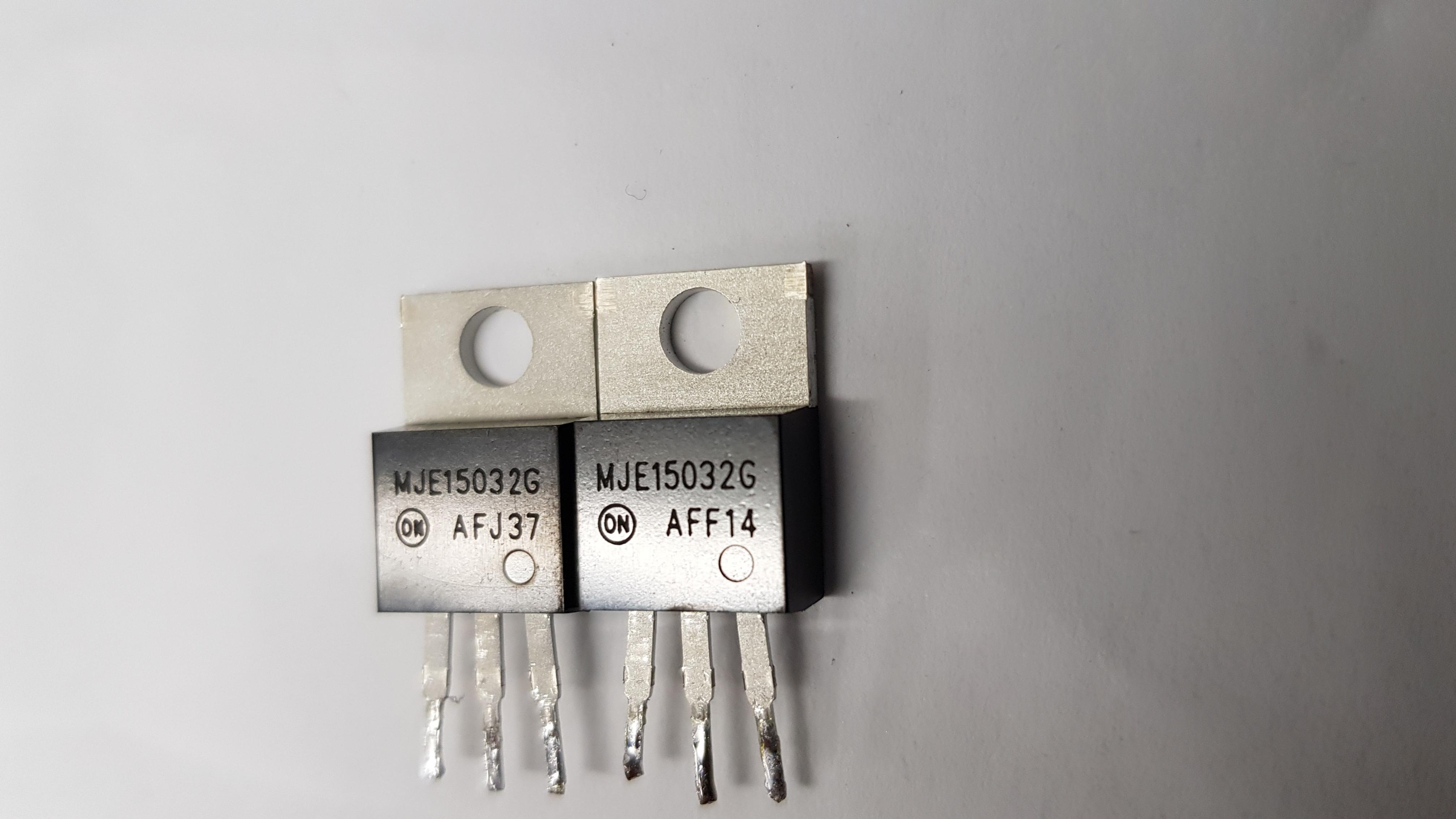

First board testing didn't quite go as planned tonight.
Very unstable bias and uncontrollable runaway. Pulled the plug pretty quick but the outputs got toasty hot...
Turns out that I had 2 MJE15032s on that board.. had a look at board 2 and I have 1x MJE15032 and 1x MJE15033.
So I'd been supplied 3x PNP and 1x NPN. I checked the first transistor of each bag while assembling to make sure I'd identified the correct bag, stupidly trusting that what was in the bag was what I'd ordered.
FFS.
FFS.
I meant 3x NPN and 1x PNP of course. Long day.
