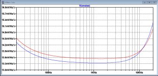

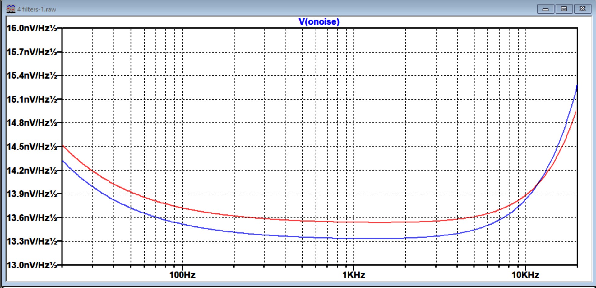

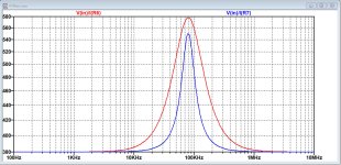

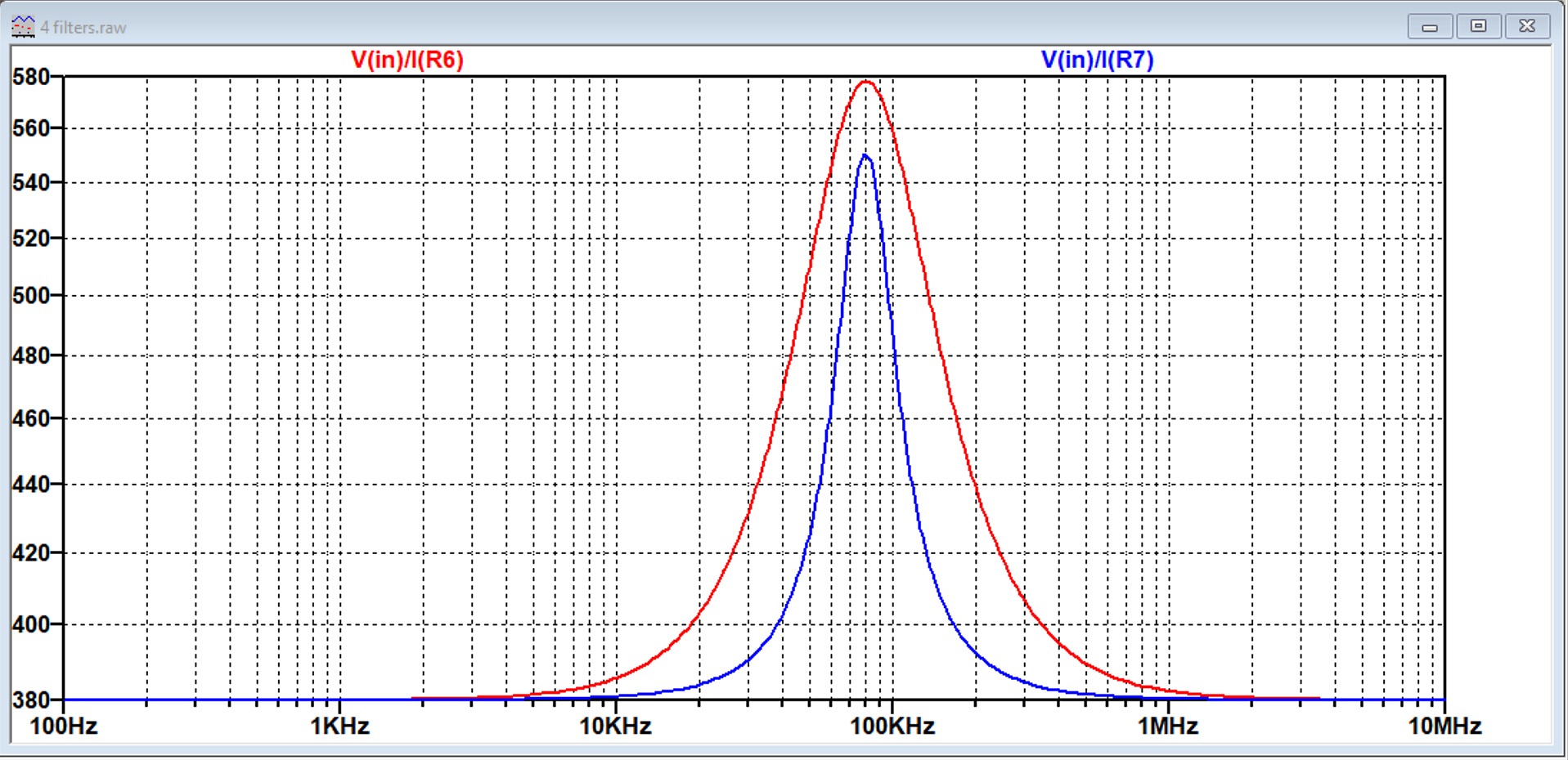

Marcel, I simmed your revised proposal.
FR between old and new is identical.
Impedance as seen from the equivalent Firdac voltage source is slightly improved, blue for new and red for old.
And even the noise generated for the revised version has been improved, also blue new and red for old.
So it seems to be an improvement.

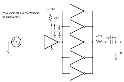

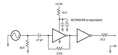

If abandon "canned" single vendor parts, a common solution to driving clocks with terminated lines is a 74XXU04 with 5 gates paralleled. The following assumes a coax cable, high quality connectors (e.g. SMA) and AC coupling.
If we have a 3.3V clock and use 74LVCU04 we get 4 Ohm low and 6 Ohm high, so 45.5 Ohm (2 X 91 R in parallel) series termination gets us right onto 50 Ohm. The output coupling Capacitor should be relatively large.
At the receiving end we use this schematic:
Unbuffered Inverter. A 74LVCU04 or multiple NC7WZU04 could be used to add clock fanout.
A 100 BaseT or 1000 BaseT isolation transformer could be added for galvanic isolation.

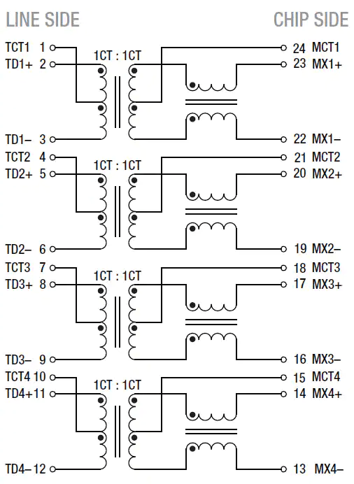

For galvanic Isolation, if we have an RTZ signal, we could just use an isolation transformer (100 Base T ethernet?) with a suitable driver circuit for isolation. Here a Bourns SM51589PEL:
The Transformer could be inserted in Marcel's DAC after the OR Gates that create the RTZ signal (U9/U25) which could possibly directly drive the transformer directly or via a small buildout resistor.
The receiving end might be good enough using the circuit below.
The termination resistor for the transformer should be selected based on monitored waveform, 330 Ohm might be a starting point. As there are RC delay circuits in the original, they should be retained and retuned.

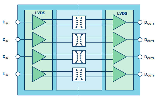

Alternatively adding LVDS Driver and Receiver IC's before and after the transformer is a more proper solution. Quad Driver and Receiver IC's with identical pinout are available from a range of sources, eg. DS90LV031/DS90LV032 and the wide range of parallel parts.
With MCK directly feeding the Reclocker Flip-Flop's and the Shift register chain we send an isolated MCK downstream using another transformer and drive the .

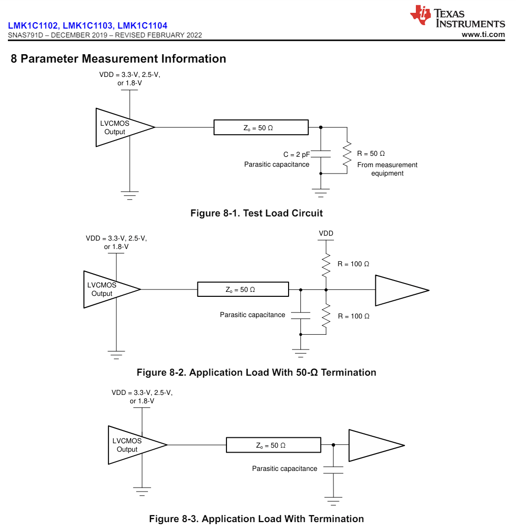

Interestingly, the datasheet of LMK1C110x says it has 50R output Z, and a example is given of using it to drive an line with parallel end termination. Could be its worth trying first before getting into trying to analyze what is going on exactly. Thanks to bohrok2610 for suggesting it.
