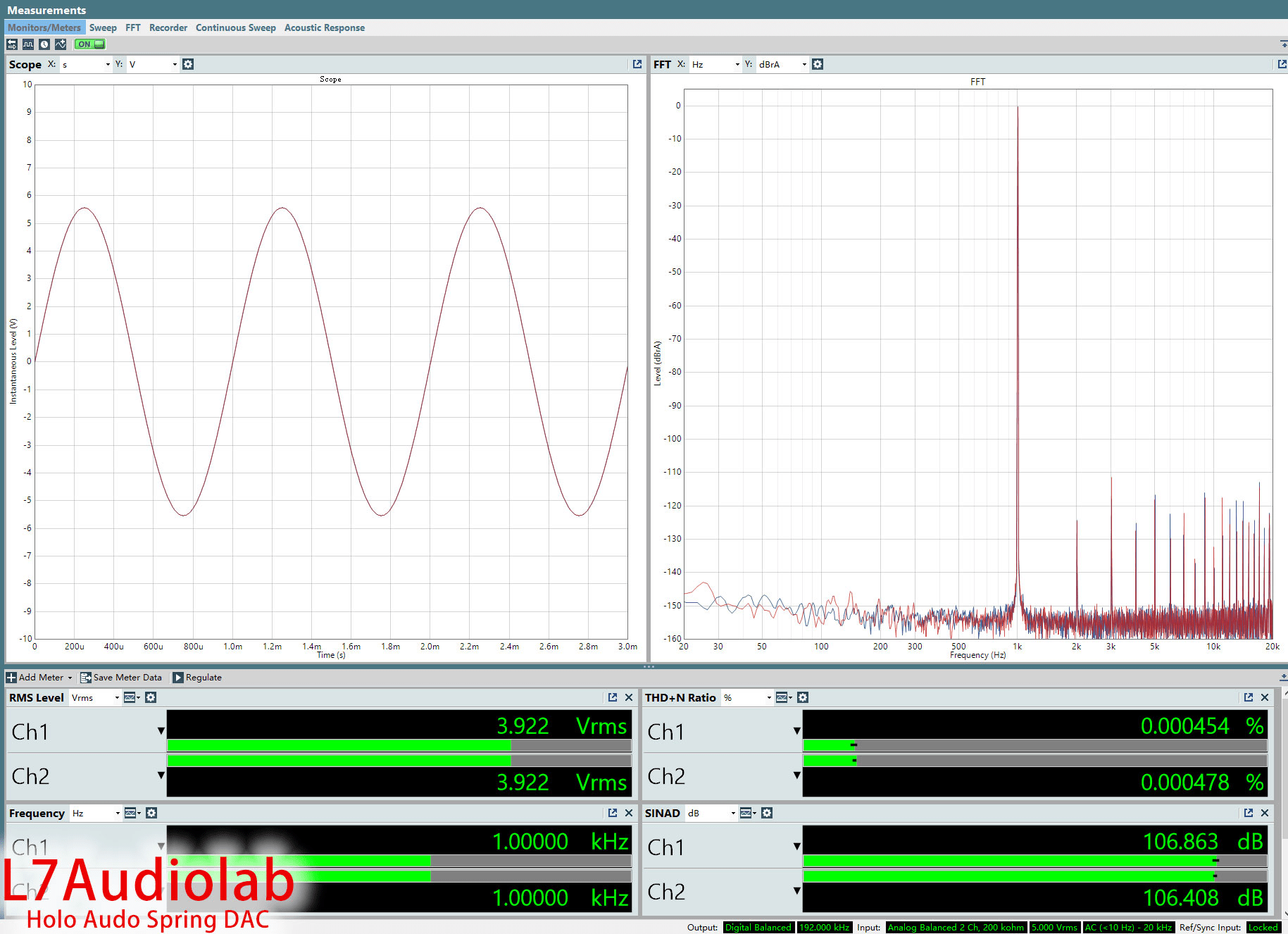

Sort of what I had figured out in relation to the quite high distortion levels of R2R DACs, however, I did not know that Holo Audio uses a corrective DAC to achieve their low distortion levels. Interesting approach ...
It takes a sophisticated calibration system.
Essentially for any given binary input there needs to be specific compensation. Even with that, I'm hardly blown over by results:
Review and Measurements of Holo Audio Spring DAC

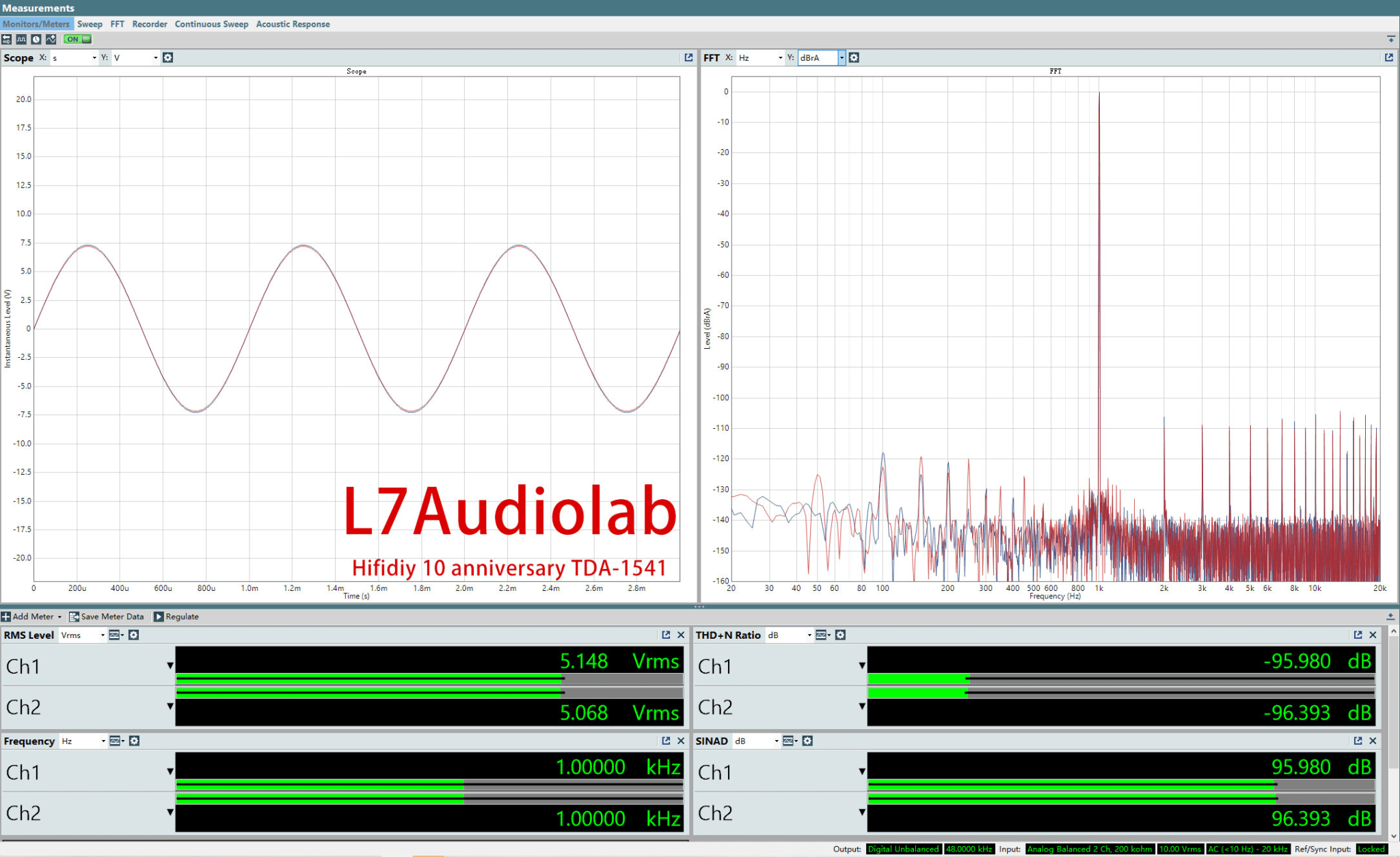

Compare that to TDA1541 - which surely is a total dinosaur:
Measurements of Hifidiy forum Anniversary TDA-1541 My DIY Replica
Hifi Forum TDA-1541A DAC Review

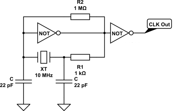

And then, if I may, one question in relation to your #2910 post: You show a "1+5" inverter topology for a sine wave inverter/squarer.
No, this is DRIVER. It means you take your clock (or for arguments sake AES-EBU signal) and pass it through this, to get a low impedance drive with more precisely defined impedance.
The "squarer / receiver" uses just 2 Inverters and is best done as pop-corn logic.
This system would (using 3.3V rails) have a clock with a very tightly controlled 50 Ohm impedance and 1.65V PP driver / receiver system with very low added jitter.
Specifically, it was meant for passing squared or clipped sine clocks, without resorting to LVDS, which I would argue is a better choice.
I have seen this before (e.g. Andrea Mori uses it) and have been wondering if using the same IC, i.e. just one package, would not cause significant inter-gate disturbances as well as a (much) higher ground bounce due to now 5+1 gates drawing current through the GND pin?
Indeed. Hence my suggestion of using multiple NC7 popcorn logic items instead.
However, these circuits are common and well worn and appear to have less phase-noise jitter than what is added by even very expensive crystals. So perhaps loosing too much speel here is a waste of time?
Also, won't the use of 5 parallel output gates cause some glitches on the output that may disturb the clock?
Probably not. We have separate decoupling and capacitive feedback into the clock outputis unlikely, as it would look commonly something like this:
The second inverter squarer usually gets closer to 50% duty cycle and isolates clock and rest of circuitry.
