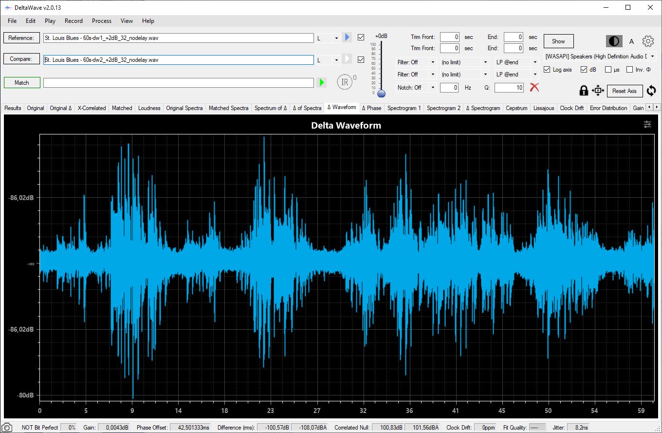

I now had the time to analyze @bohrok2610 's files (the *nodelay.wav's), left channels. After manual trimming and DC offset adjust it already looked like they are extremely close (except for a sub-sample shift) and clock drift is close to nonexistent (despite being not clock-synced?). DW says the same, as does REW. Only microscopic differences within the last kHz or so.
We have the usual trimable gain&DC and a sub-sample offset, but required drift correction is zero.
To my surprise residual waveform is dominated by gain drifts, causing the residual to pump up and down in volume, with peaks reaching -80dBFS. That indicates DC drift and 1/f noise of the reference voltages used for DAC and ADC. This is not uncommon IME.
Otherwise the residual sounds natural and completely ok (and the spectrum does look good as well), no significant spectral differences or other artifacts, as far as noticable within the broadband noise of course.
Now the point is, I would expect to see the same level and kind of differences when just doing two takes of one and the same setup -- actually I think this kind of base measurement is always required to see what's a reasonable resolution limit. Like an A/B/A/B/A/B/A/B sequence (4 takes of each version alternated), after a 2hrs thermal settling period, playing B looped.

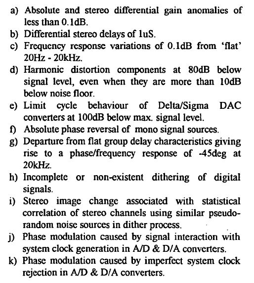

Once again, I will refer to Paul Frindle's list of what was found to be audible, which IMHO is similar to what Bruno Putzeys found about hysteresis distortion: only a few people are going to hear some real differences. That's because there are thresholds of audibility for the AVERAGE ear, not for all ears. 50% of the population will be more sensitive than average, and 50% will be less sensitive.
Seems like some of the less sensitive fraction of the population is always looking for some justification such that if they can't hear it then nobody can. Then they demand ABX for every single reported difference. They expect 10-days of cooperation for each observation they can't hear. Their expectations of what they can demand from other people are not realistic.

I noticed pumping of harmonics when I tested v03 and v04. It is similar in both versions. I reported about the pumping in post #2698. It was even included in chapter 3.6 of Marcel's report regarding low level distortions in post #2696. As this pumping of harmonics is not signal related it will appear at different spots with v03 and v04 recordings.
Similar pumping is clearly visible on the 2 otherwise very well matched recordings as shown in the waveform difference (see below).
At what rate? Is it related to the tempo of the music?
No, zero correlation to the music.
Delta file attached (with 80dB gain applied).
