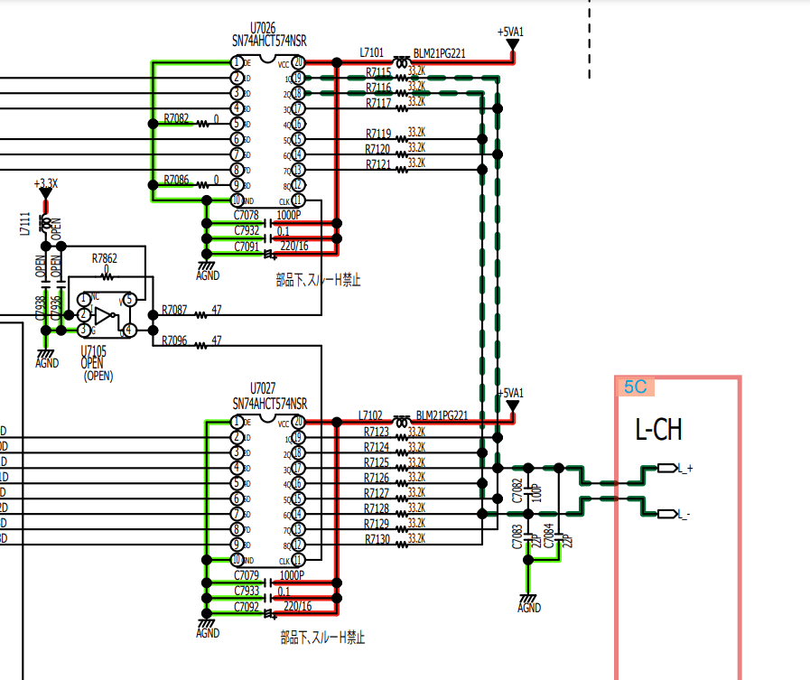

As a data point of possible interest, here's a pic of the output array for a Marantz high end SACD player:
One may notice how the bypassing is done, how each output switch IC outputs a mix of inverting and non-inverting signals. In some ways it has some similarity to the scheme Marcel uses.

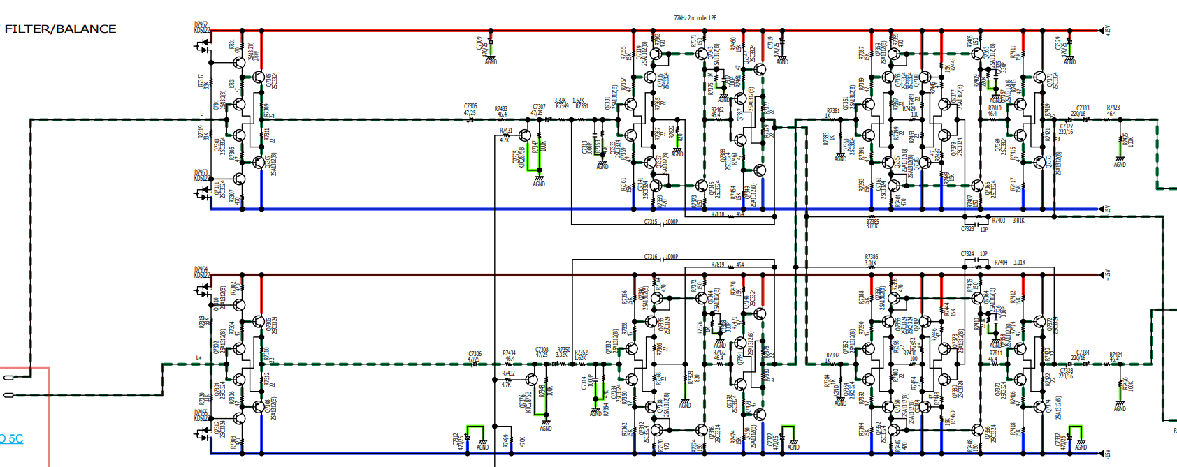

The output of the stage shown above goes to a number of op amp-ish and other circuitry for filtering, etc. The next stage looks like:
As can be seen, its all discrete. Also, there happens to be some differential summing towards the end on the right.
Was it designed by FFT measurements? IMHO probably not.

You are just guessing. IMHO that circuit was both extensively simulated and measured.Was it designed by FFT measurements? IMHO probably not.
BTW are you implying that Marcel designed the output stage for FFT measurements? IMHO it measures well because it was designed well.

When this is from the SA-1, the introduction was in 2000, so the design took place in the ninetieth, 25 years or more ago.

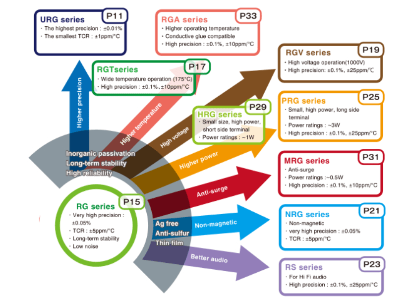

Notice dac resistors called out in BOM are Susumu RR series, which is not recommended for new designs. Reason I bring this topic up is because I think I hear something a lot like a little bit of resistor sound. Has that some of that particular blur to it.
Anyway here is the current selection guide from Susumu:
As can be seen they recommend RS series for hi-fi audio.
When I was trying different resistors in Andrea's DSD dac, one of the types I tried was Susumu RG. IMHO they were the worst sounding resistors I tried. Don't know what else could account for the sound except Excess Noise, most of which is probably current noise. Best resistors were the ones Andrea used, IIRC they were Yageo. We never tried SMD foil resistors because of the expense. However, since this dac uses fewer resistors than Andrea's dac maybe it would be less costly to try enough of them to work for SE operation. About $8/each in moderate quantities. Makes the Rubycon caps look cheap.
