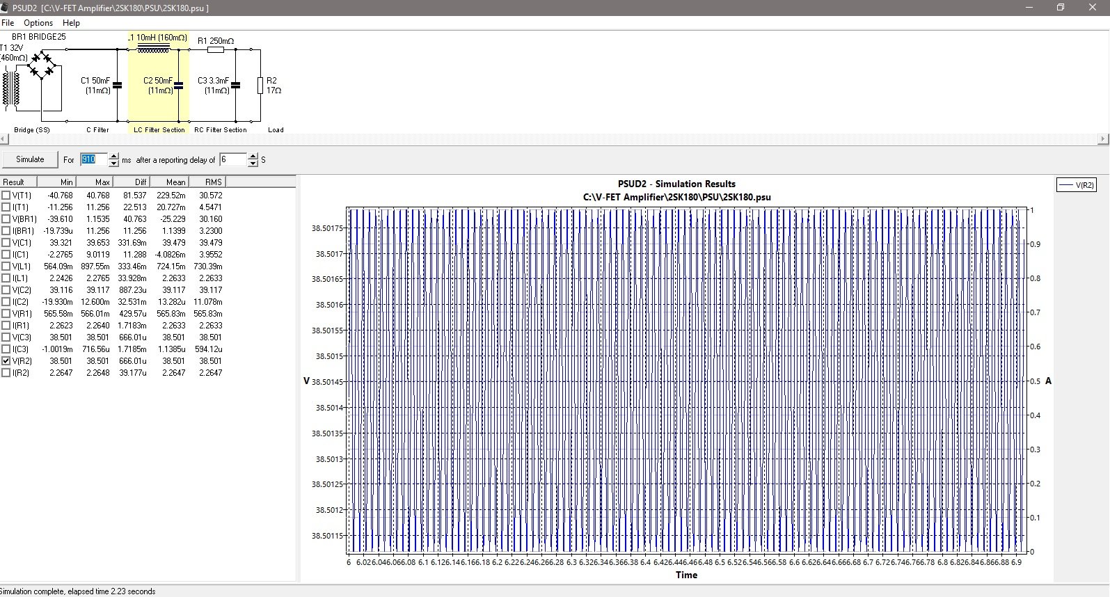

Probably the calculation you used is for a choke input power supply. For a CLC filter, you don't need high inductance but want low DC resistance due to the high current flow (reduce voltage drop). A choke in the tens of millihenries range with resistance under 1 ohm would work. Something like a Hammond 156ZJ.
You can easily model a CLC power supply using PSUD2.

PSUD2 software can save you lots of calculations. You just need to enter the power supply (transformer, rectifier, filters, load current). PSUD2 will calculate the output of the power supply including graphics showing the voltage vs. time.

Here is an example of a PSUD2 analysis. I don't believe the choice of bridge rectifier is a critical factor for the purpose of examining the filter response.

You don't and it makes no difference. I don't know for certain but suspect that rectifier parameters in PSUD2 are there just to generate warnings when exceeded. If for some obscure reason you really need to use realistic models, use a spice program, not PSUD2.

C’mon, it’s not that hard. CLC is a pi filter whose resonance is at 1/(2 pi sqrt(LC)) where C is half the value of the actual capacitors, assuming they are equal. Put this frequency a couple of octaves below 100Hz and you have -24dB of 100Hz ripple ref. the original level.

The Radiotron Designer handbook (4th edition) will give you some formulas page 1182-1185.
Basically, you start by calculating the load resistance RL.
Then divide it by 6 * pi * mains frequency.
In your case, RL = 24 ohms (approx.) => Lc = 24 / (6*pi*50) = 25.5mH. This is the minimum value. In practice, this value is doubled for good measure.
So, you need 50mH.
Now, do not forget that the DC voltage after filter will be about 0.9 * RMS transformer voltage. you need to also take into account the voltage drop in the diodes and the choke.
