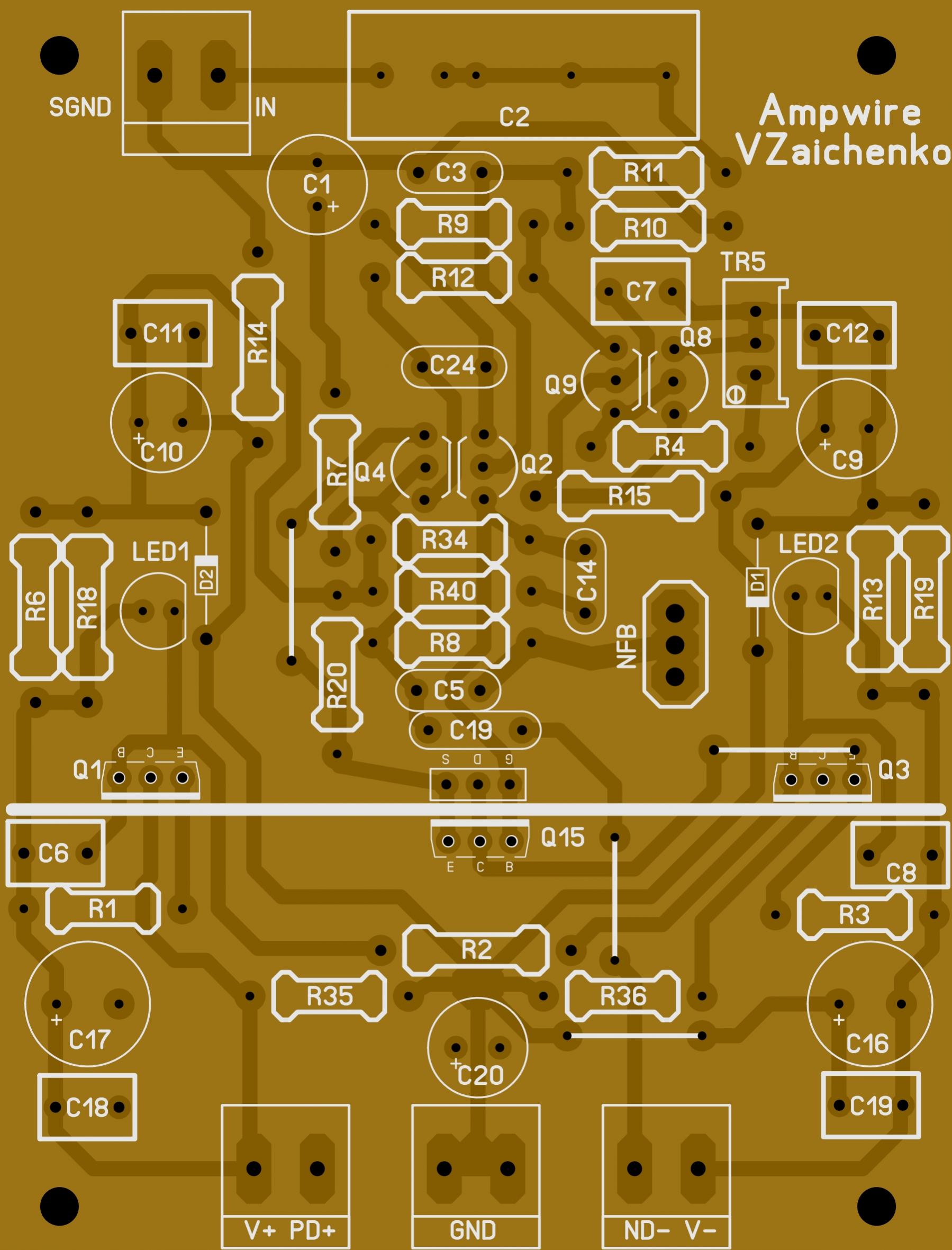

Here is single layer Ampliwire-ECC88-IPS...

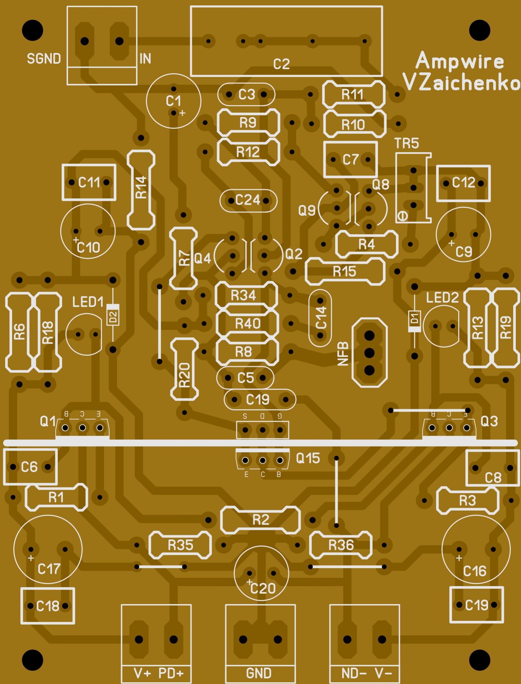

I will try to propose printable files for etching just say me what type you want UV transfert and toner transfert to need different file
Toner transfer please. A mirrored silk would help too.
Thanks, Terry
If you want to cover all bases, post both side as is and mirrored. Not really an issue.
What do you mean by both side? Sorry for my bad eanglish understanding.
Marc
Copper side as is and mirrored. Silk side as is and mirrored. That way anyone wanting to hand etch can decide which format to use to suit their process.

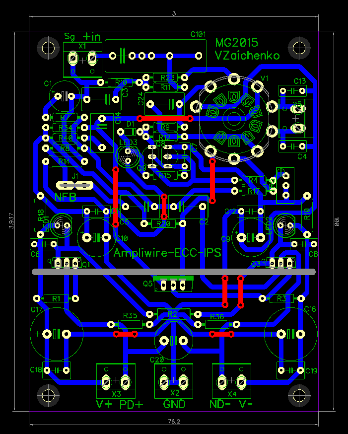

Thanks for answer. Here are files in pdf for ECC88 version...
Marc
Still learning so please take a look. Thanks Marc.
Hi Terry,
Take a look your PD+ is connected to nothing. It should be connected to Q1 collector, C20 and R35 refering to schematic i posted a few post before and not to V+. You have an issue with ND- too : connection to C20 and R36/collecteur Q2 is lefting.
You should take Schematic and follow each your tracks with it. With diptrace you have a direct correlation between schematic and layout.

It doesn't matter if it is mirror or not , just post black traces without parts on it.So let me know exatly what you need : mirror....etc

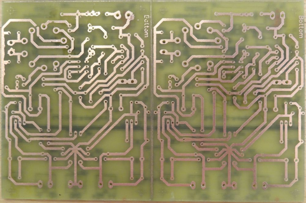

Hi Marc,
Thanks! I think I have it now.

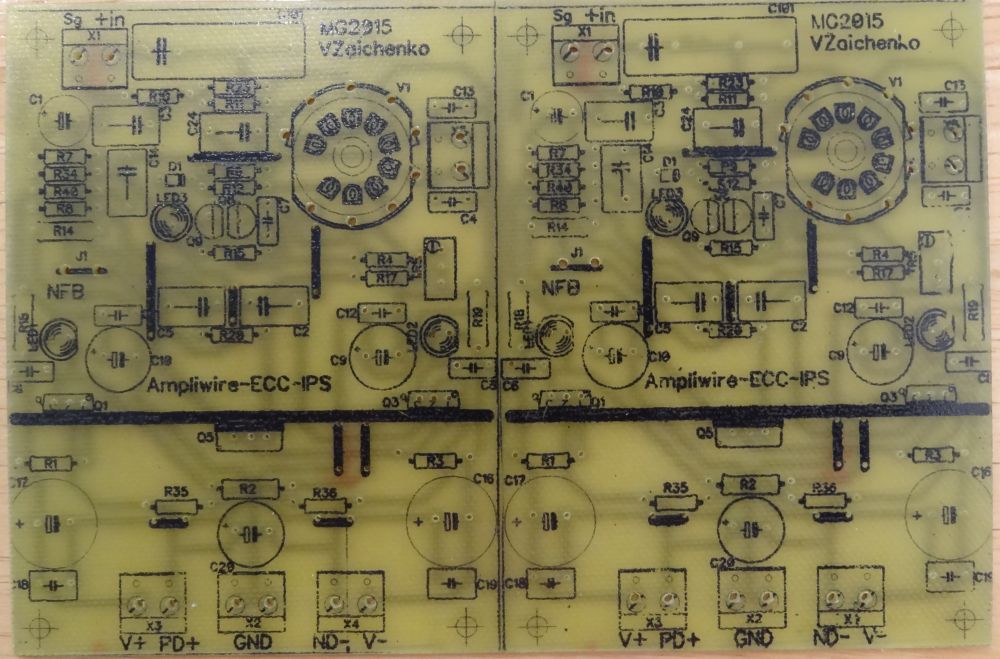

I etched a pair of the ECC88 boards too.
Blessings, Terry
