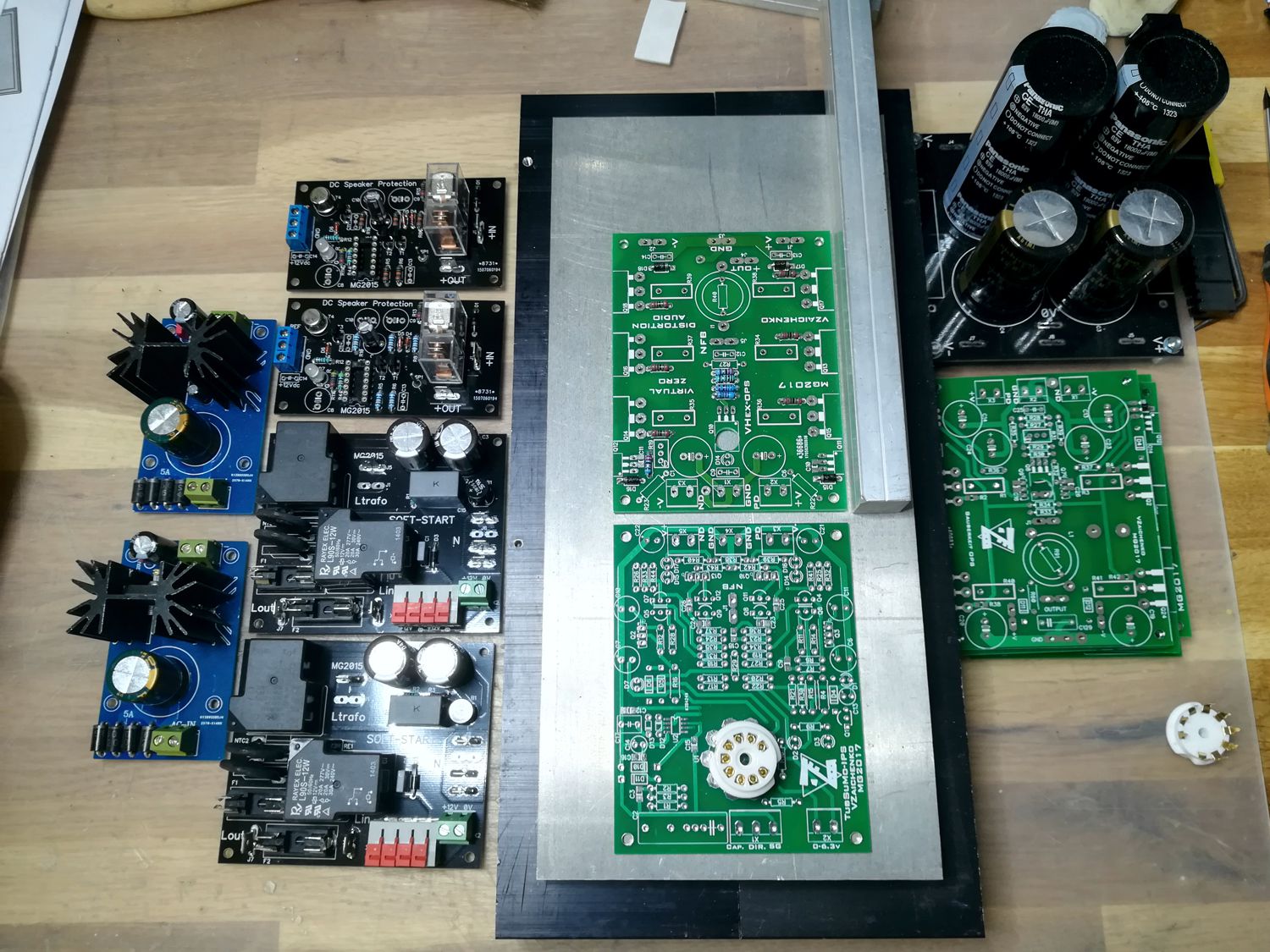

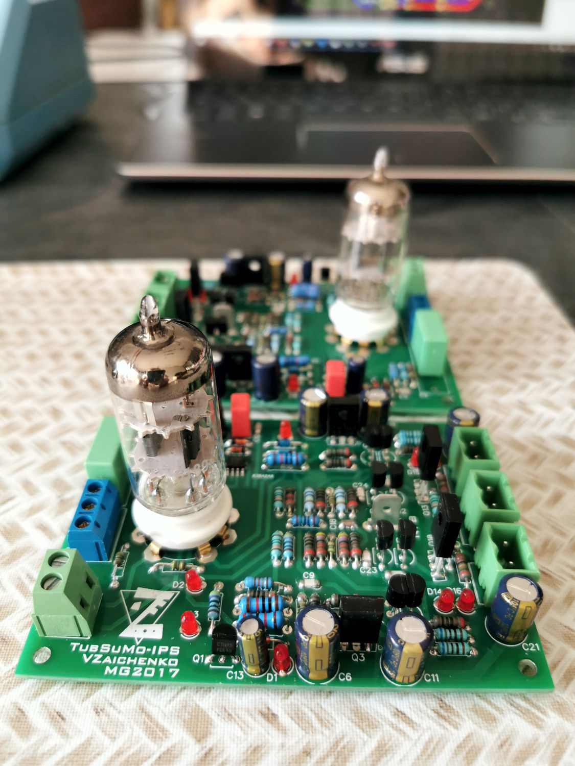

Hi all after long very long time of diyaudio desert....in favor of staying home due coronavirus.....time was to use solder iron.....
Tubsumo Porn in combo with NS-OPS. All are onw adaptation from Valery's work in same shape (76*100mm) as Slewmaster IPS.
On IPS-OPS combo their is 2 NS-OPS version : one with 3 pairs MJL/NJW and one with 2 pairs in the background.

You will need some type of delay on your speaker protection. The 21st century protection that Valery designed is perfect. The Tunsumo has a huge offset at initial start up.
Yes i have a delay/dc speaker protection board that i will tweak (condo value) to have 30s delay because of tubsumo...

Great work!Hi all after long very long time of diyaudio desert....in favor of staying home due coronavirus.....time was to use solder iron.....

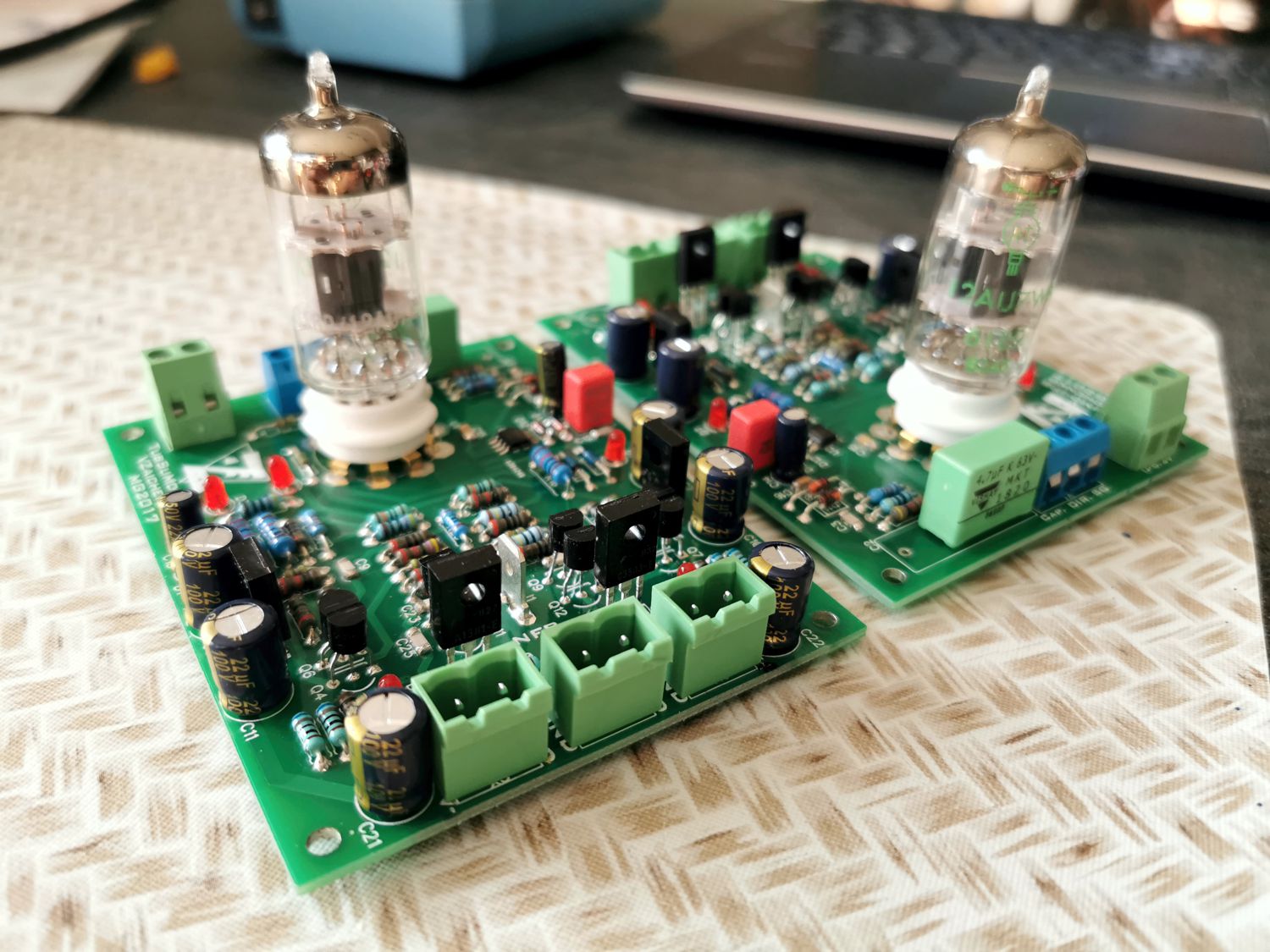

Are these different color body resistors tantalum type?
Great work!
I hope that you will enjoy!
Hi thimios,
no, those are differents 1% metal resistors brands out of my stock and coming from differents projects. I have no exotics parts on project, only good industriel parts

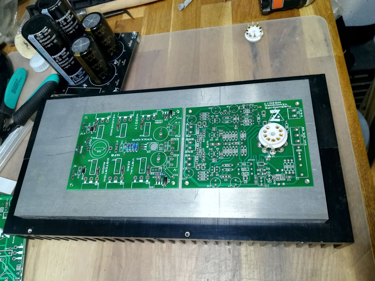

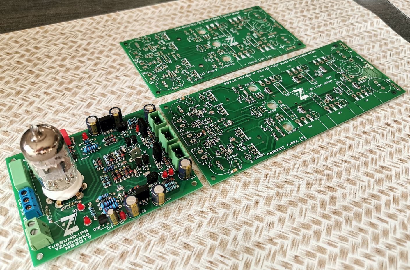

Super-clean build I like the compact boards
I like this small boards too, because the original NS board was a little big.Super-clean build I like the compact boards
I have the original board too but when i decided to do my own routing Tubsumo IPS didn't exist in Modular shape. Additional in 76*100 shape it can be use with other OPS board as slewmater, VHex, Sauberkeit. I have the two latest in same 76*100 shape (2 pictures below)
