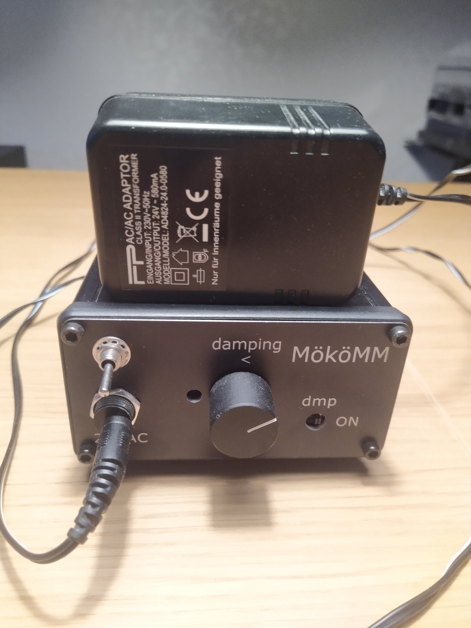

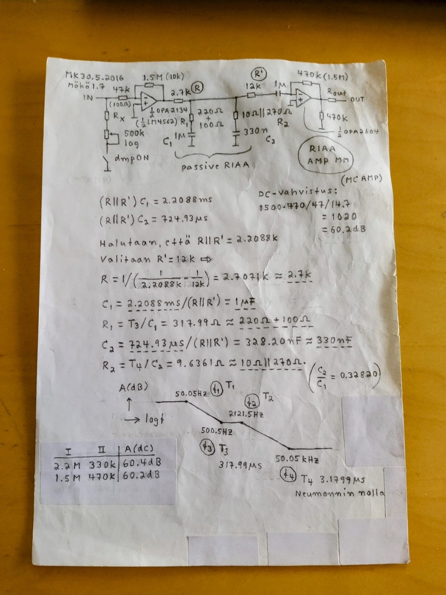

This is my latest version of RIAA amp meant for MM cartridges. It features a pot in the front panel for setting the cartridge coil load. As MM cartridge is highly sensitive to the load that it sees in the amp input, this option is well needed. Rotating the pot knob anticlockwise reduces the input resistance and makes the cartridge sound darker. Since there is no scale for the resistance value, the optimal setting must be judged by ear which makes the pot act like a tone control. Loading with 47k resistor is also possible by switching the pot off but this often results to sound that is too bright and restless.
