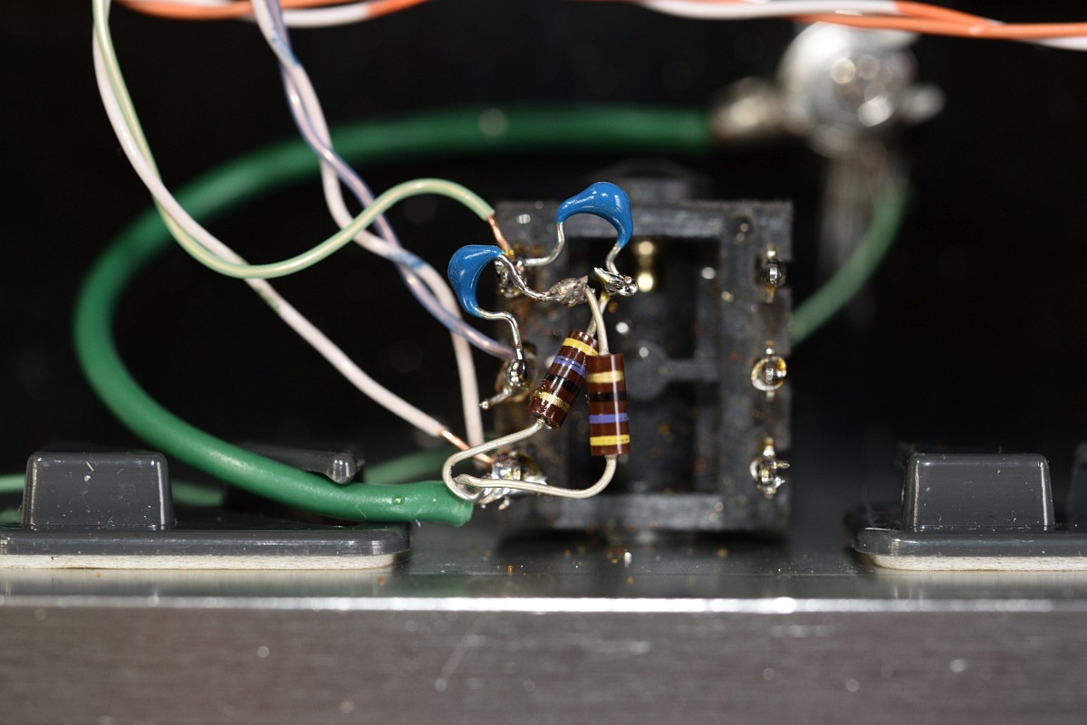

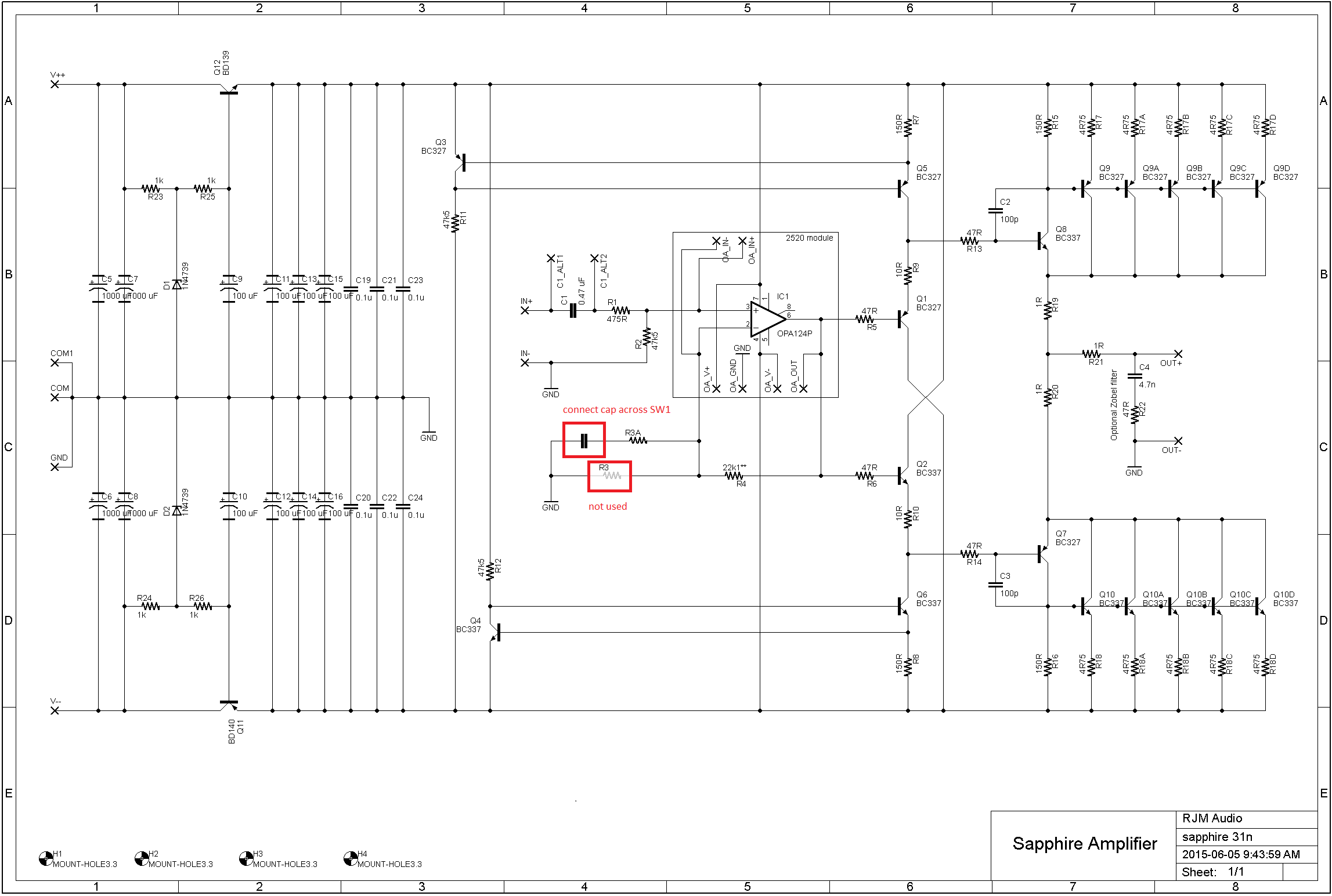

While anything with FET inputs is going to be fine, a discrete module with bipolar inputs isn't going to work without a modification to control the output offset voltage. Unlike ICs these circuits don't have the auxiliary function to cancel input offset currents and the input transistors are not sufficiently well matched do be capable of low output offsets without it.
There are several possible modifications, I think the simplest is to add a capacitor in series with R3A by connecting it at the SW1 pads. R3 is unused. This capacitor reduces the voltage gain at DC to unity, so there is no amplification of the input offset voltage.
Set capacitance as,
capacitance x R3A ~ 0.03 s
so about 22 uF for R3A 1.5k.

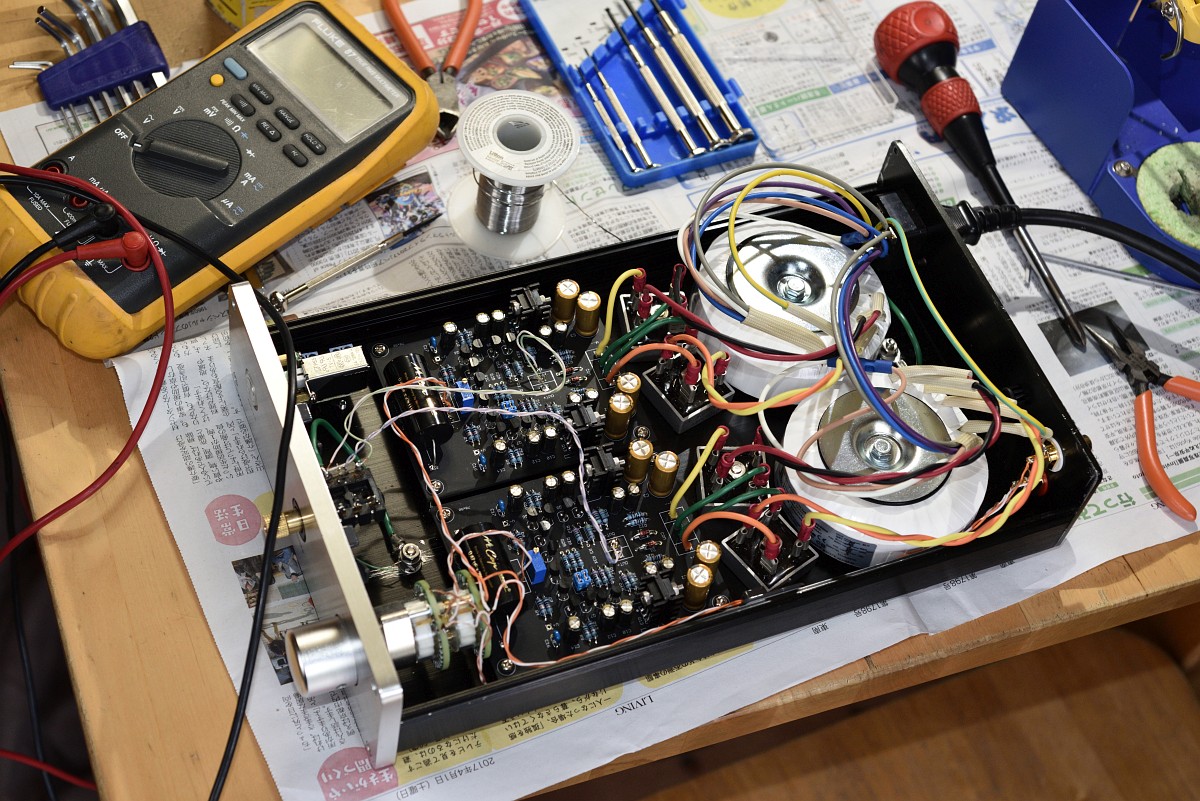

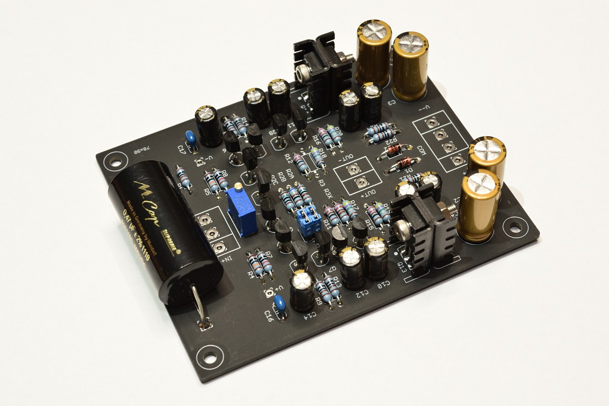

tada~
Beautiful! Makes me want to build them again. But these should be sonically the same as my 4.0b prototype, right?
tada~
Any planned changes on the event horizon?

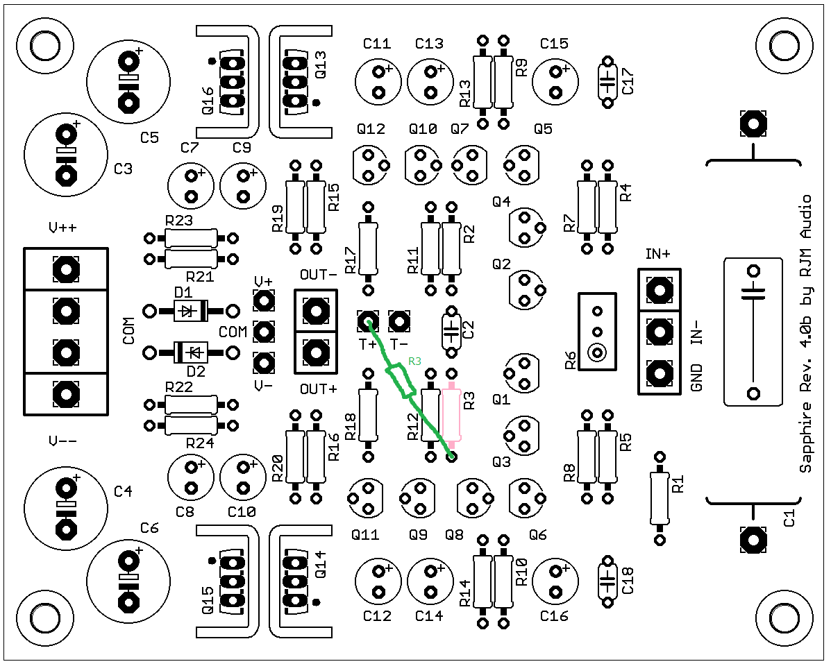

Definitely will sound no different from the prototype ... at least in the default. When you use R3X instead of R3 though the circuit has the buffer in the feedback loop and that's actually how I've wired mine up initially.
Connecting the buffer to drive the inverting input of the current feedback amplifier will theoretically lower distortion and increase bandwidth, at the expense of well, having to control that much more powerful negative feedback loop. So it will be interesting. I really liked my open loop 4.0b but felt that the second harmonic characteristics were a bit strong. If I could just tighten it up a little bit it would be perfect.
(note that version 3 with the op amp does not have the same need to put the buffer in the feedback loop as the op amp IC already has a powerful output stage designed to drive the feedback loop and the inverting input.)

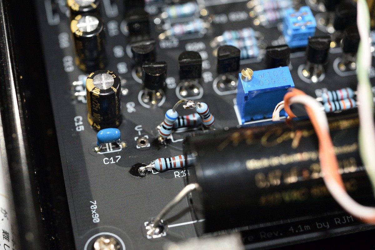

The closed loop configuration (what I'll call the "R3X mod") works great! As anticipated it's sounds something midway between the 3 and the open loop 4. Plenty of depth but more aggressive than the open loop 4.
Bench notes:
I ignored my own advice and instead of using a 5k trimmer as per the latest BOM figured I could get away with a 1k as before. Nope. npn/pnp difference means even with everything matched you'll see about -80 mV input offset voltage, requiring at least 2k trimmer to zero. I did a quick fix by adding 681 ohms to R5 to compensate.
I added a Zobel (47 ohms / 4.7nF) at the output "just in case".
One advantage of more feedback is a lower noise floor. It will be interesting to see what the measurements say but this thing is insanely "this is on right?" quiet even at maximum volume.

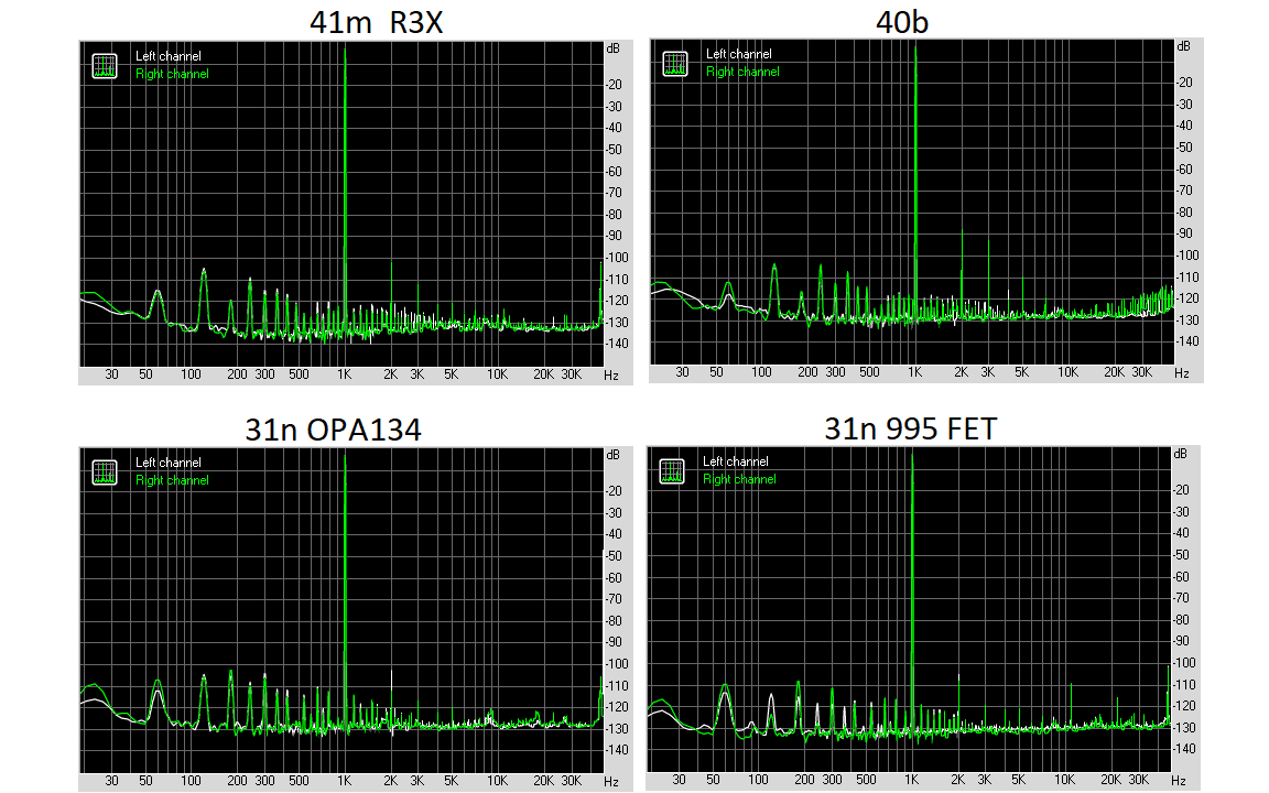

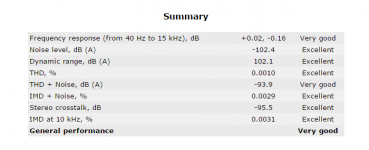

and the results are in...
The big story is the 41m has the lowest noise floor of all versions so far, by about 2 dB over the FET995 and 4 dB over the 40b and OPA134 fronted 31n.
(Unloaded) distortion is of course is big improvement over the 40b, but the surprise here is it matches even the discrete op amp versions of 3.1n and betters both in inter-modulation distortion.
All in all a *very* impressive set of specs.

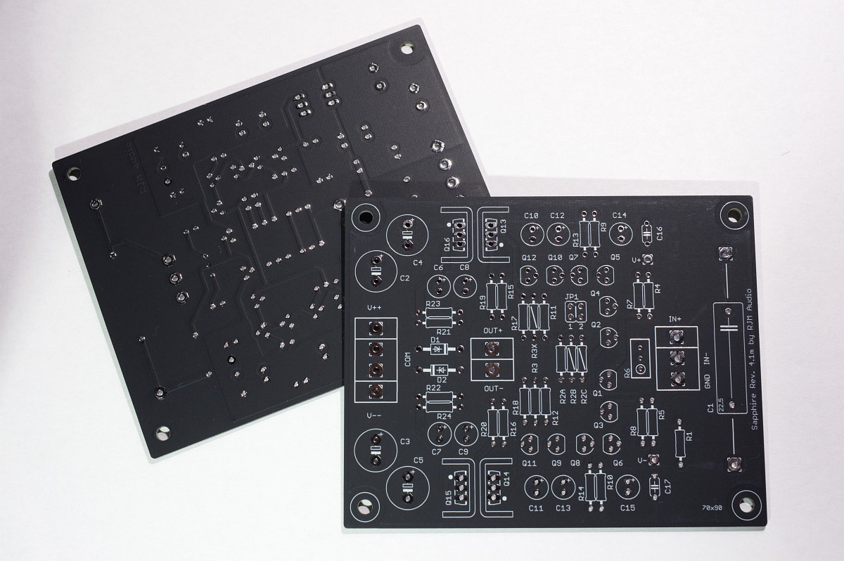

Negative feedback. It's-only-wrong-when-someone-else-uses-it.(tm) Seriously though after all the badmouthing it gets I'm a little shocked the R3X mod actually worked. (not that open loop sounds bad or anything, the opposite, its just so far as personal preference goes it was a bit too much of a beautiful lie.)
Stan: free set of 4.1m boards, reward for superior guineapigness. Drop me a pm to confirm you want them.
