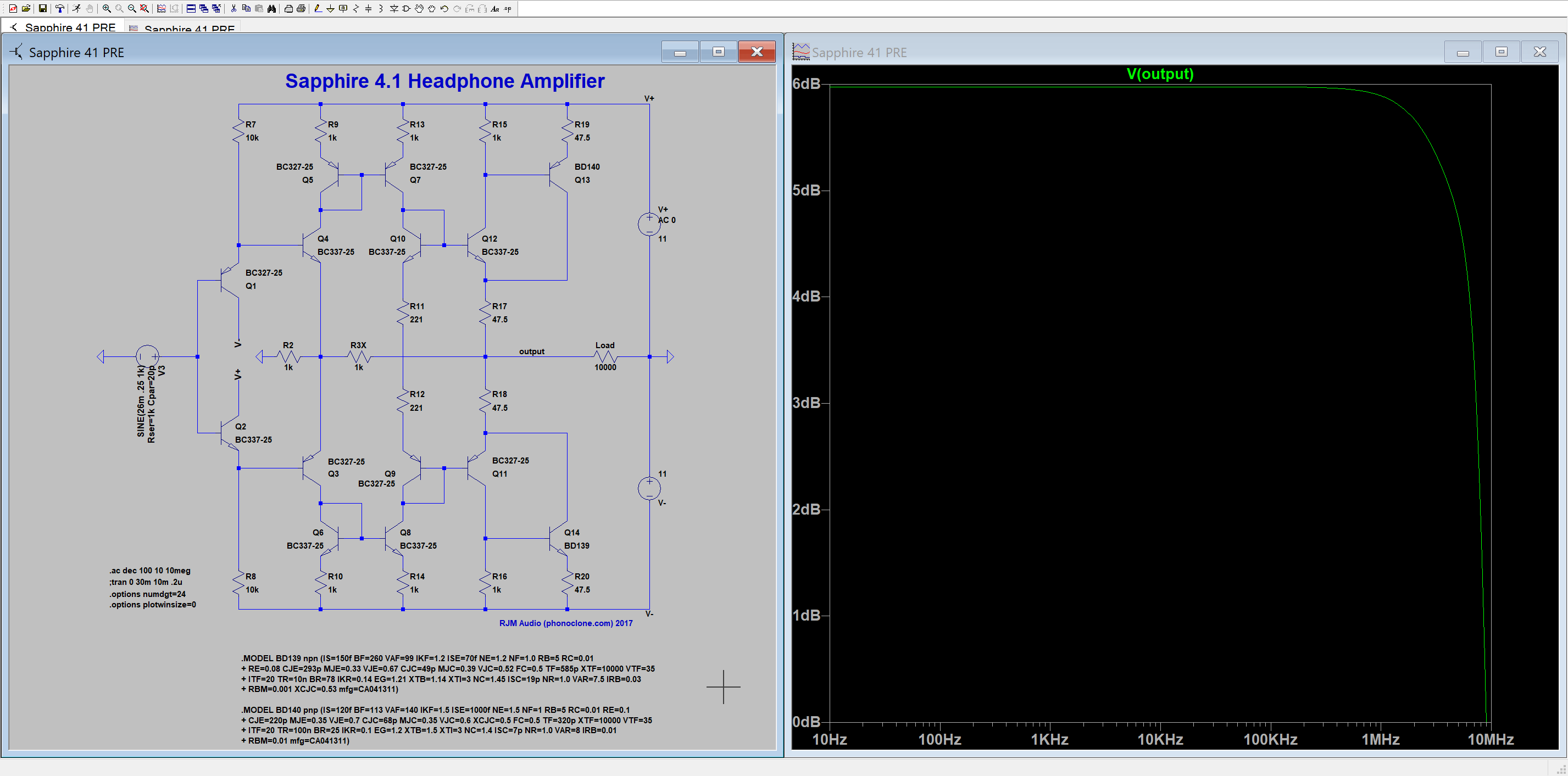

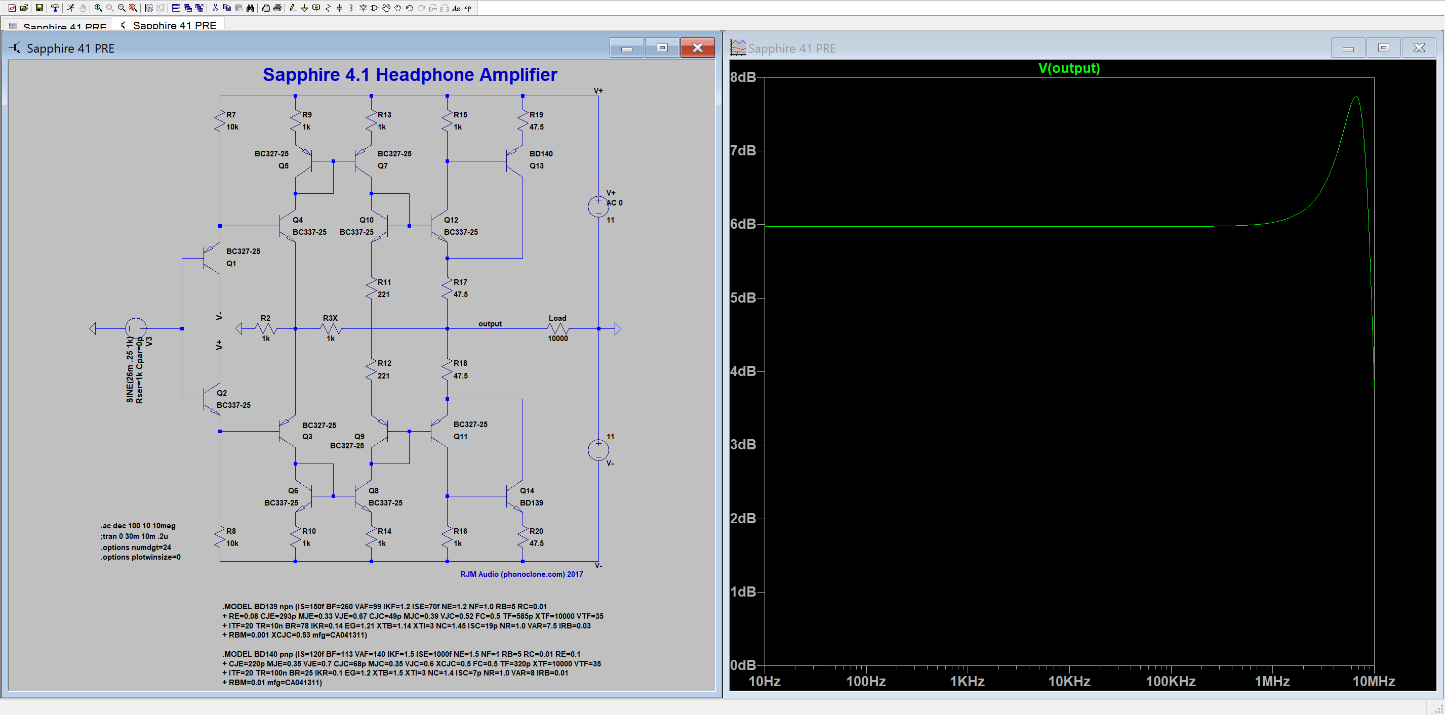

Nice one rjmI borrowed the BD139,140 models Mike used in his LTSpice simulation. BD135,137,139 and BD136,138,140 are the same but for the voltage rating.
Changing the output transistor from BC337/327 to BD139/140 has no material influence on the simulation output that I could see.
One of the more useful things you can do with the sim is compare open loop and closed loop distortion for different values of R2,R3(X). You can also remove R3(X) and look at the open loop gain and phase margin as a function of R2.

Richard, as you already know I assembled my 41m boards using 1k for R2A and R3X since that was the values listed for a earlier BOM.
It seems to work fine with those values, but I don't have a scope to verify if there are any issues with using those values or not.
So...what's the difference(s) between using 1k for both vs. using 2.2k, which are the values listed in the latest BOM?

1k-1k gives lower phase margin and less stability. While the simulated response shows a small amount of peaking, please note this is at high frequencies and easily damped out with the addition of 20 pF of input capacitance. I don't think it is worrisome or particularly relevant, but I changed the BOM to 2k to be on the safe side.
