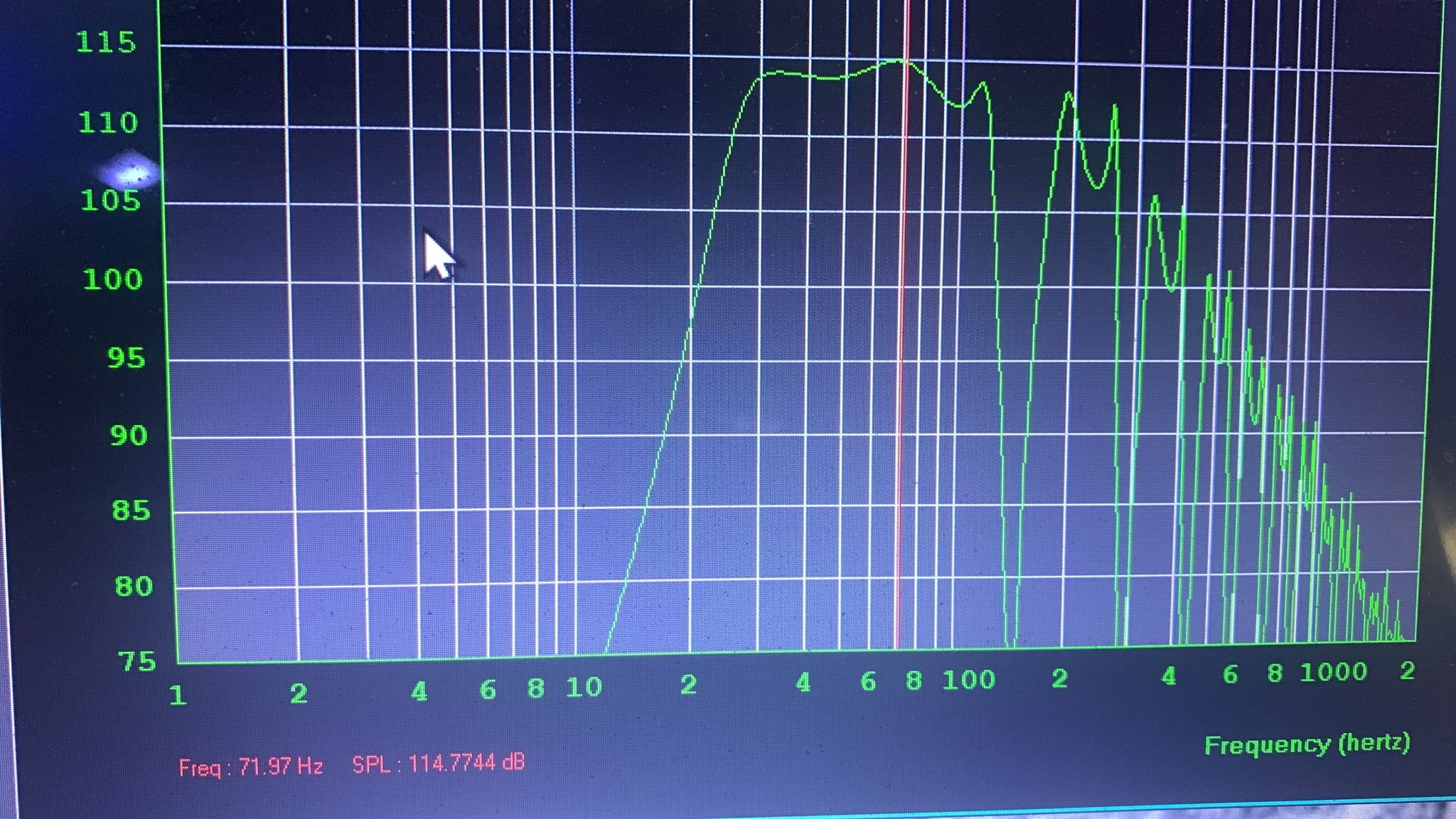

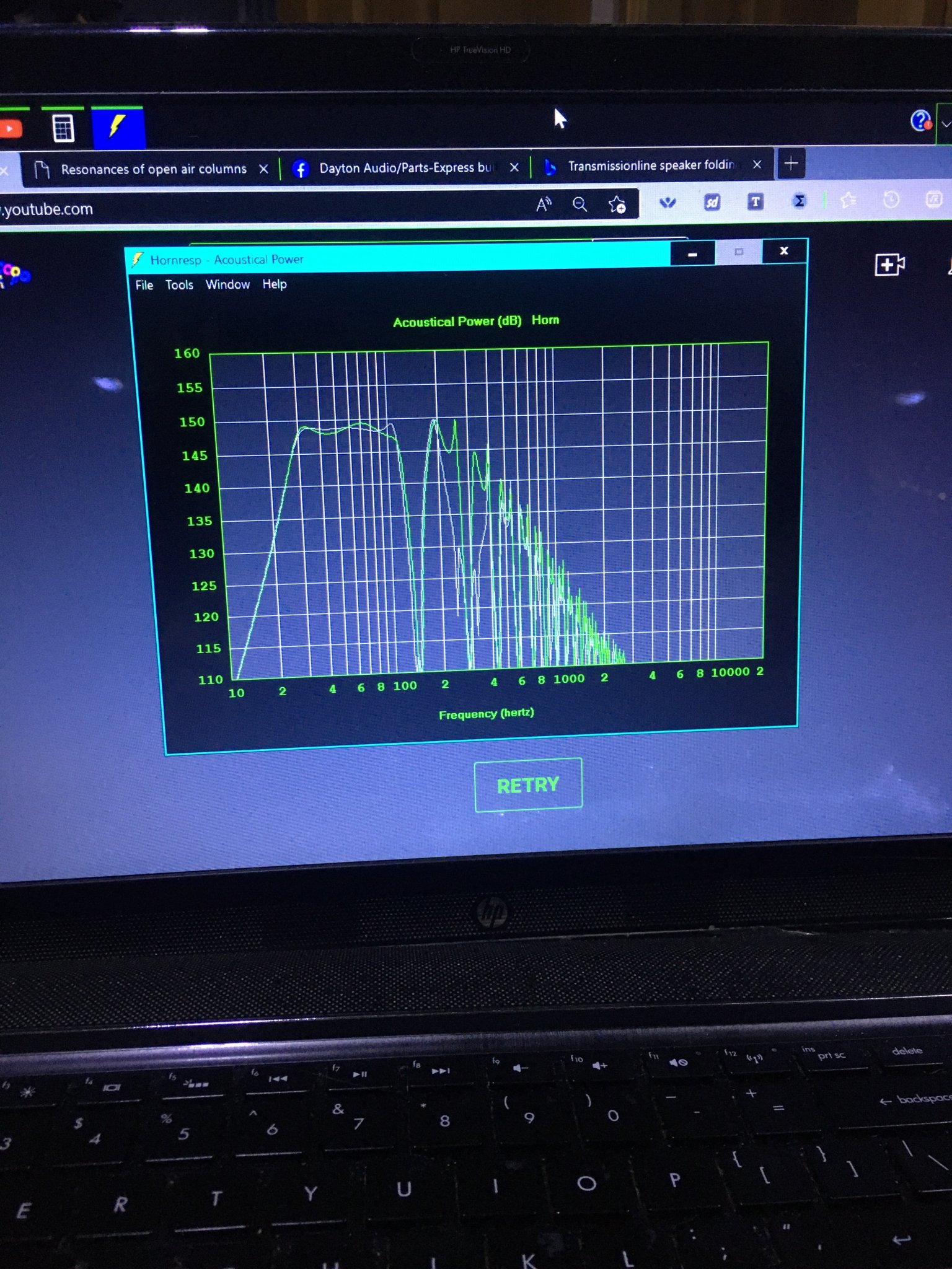

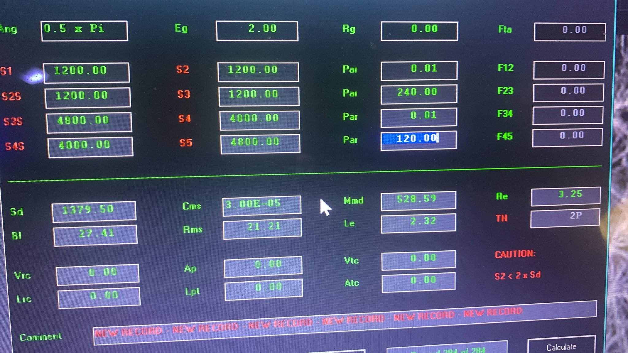

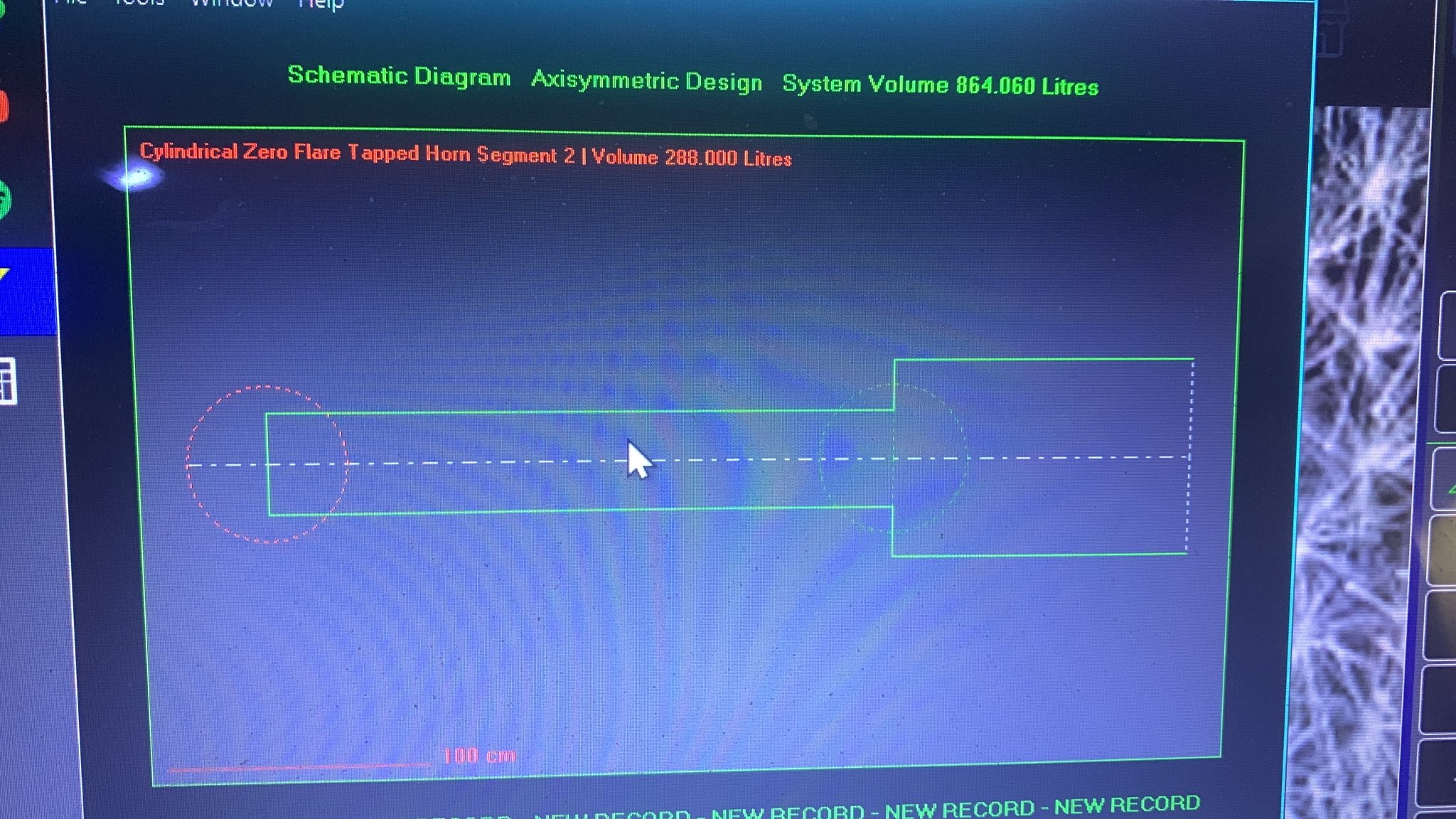

This is where i found some important detail to make use of. Two fold front skinny section and big single rear at 120plus 120 cm at x cm2, and 120cm at 4x cm2… but a variety of driver offset entry points from the Pmax (0 cm) at start and from the Vmax at rear 240 cm affectively by a 30,45,60 cm lengthStill typical bandpass response.
ROAR = BP6S.
TH = BP6S.
TQWP (TQWT) = BP6S.
T-TQWT (T-TQWP) = BP6S.
All 4 enclosures can be modeled in HR with the TH function.
The ROAR and TQWP can be modeled with any BP6S type function in HR.
